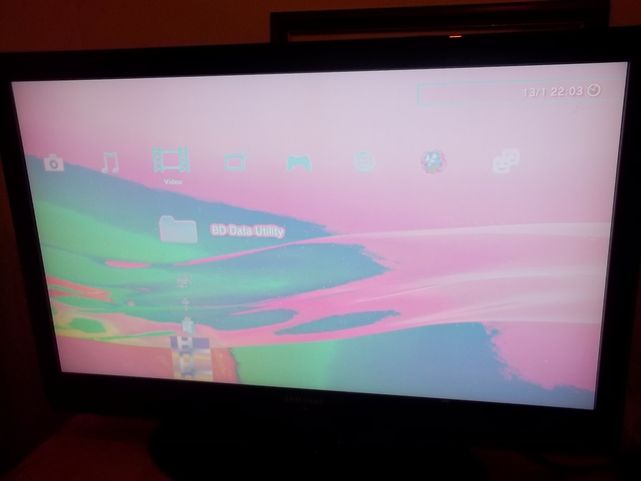

    Multi colours on Samsung LE40M86BDX.
    As you can see from the pictures it's just all over the place, my guess is a T-con problem. I've already been in the service menu but nothing is making any real difference at all.

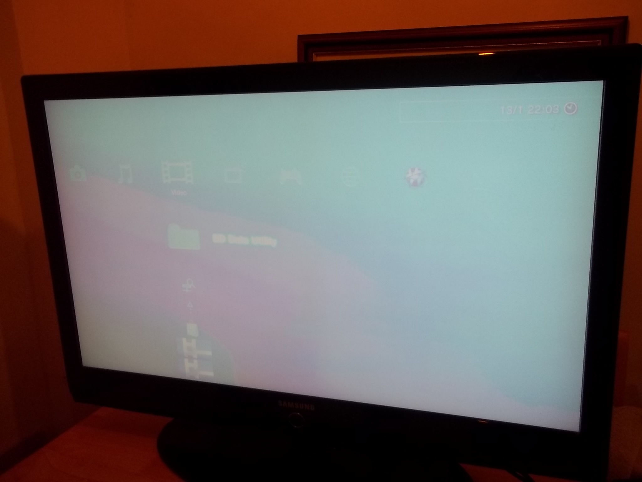

    The second picture shows bad image retention.

        replace tcon I would think or feel heatsink on av main if its burning hot I would say its that

          That's a tcon issue. More specifically on the tcon there is a gamma IC. AS15-F or G or thereabouts. It may be bad.

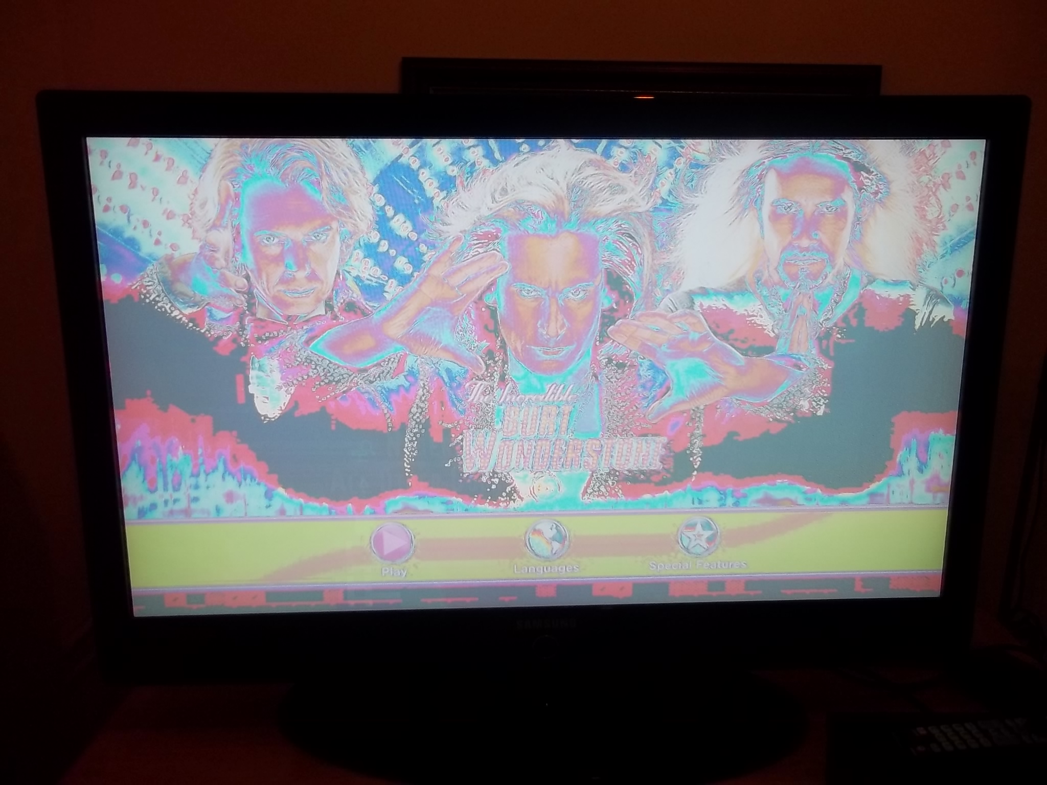

              yep,gamma issue,continued use will most likely cause it to go to a "negative" like a photo negative.
              replace t-con, for piece of mind,try reseating lvds cable,clean contacts with iso alcohol,at both ends,just to rule it out,99% sure gamma proccesor has though

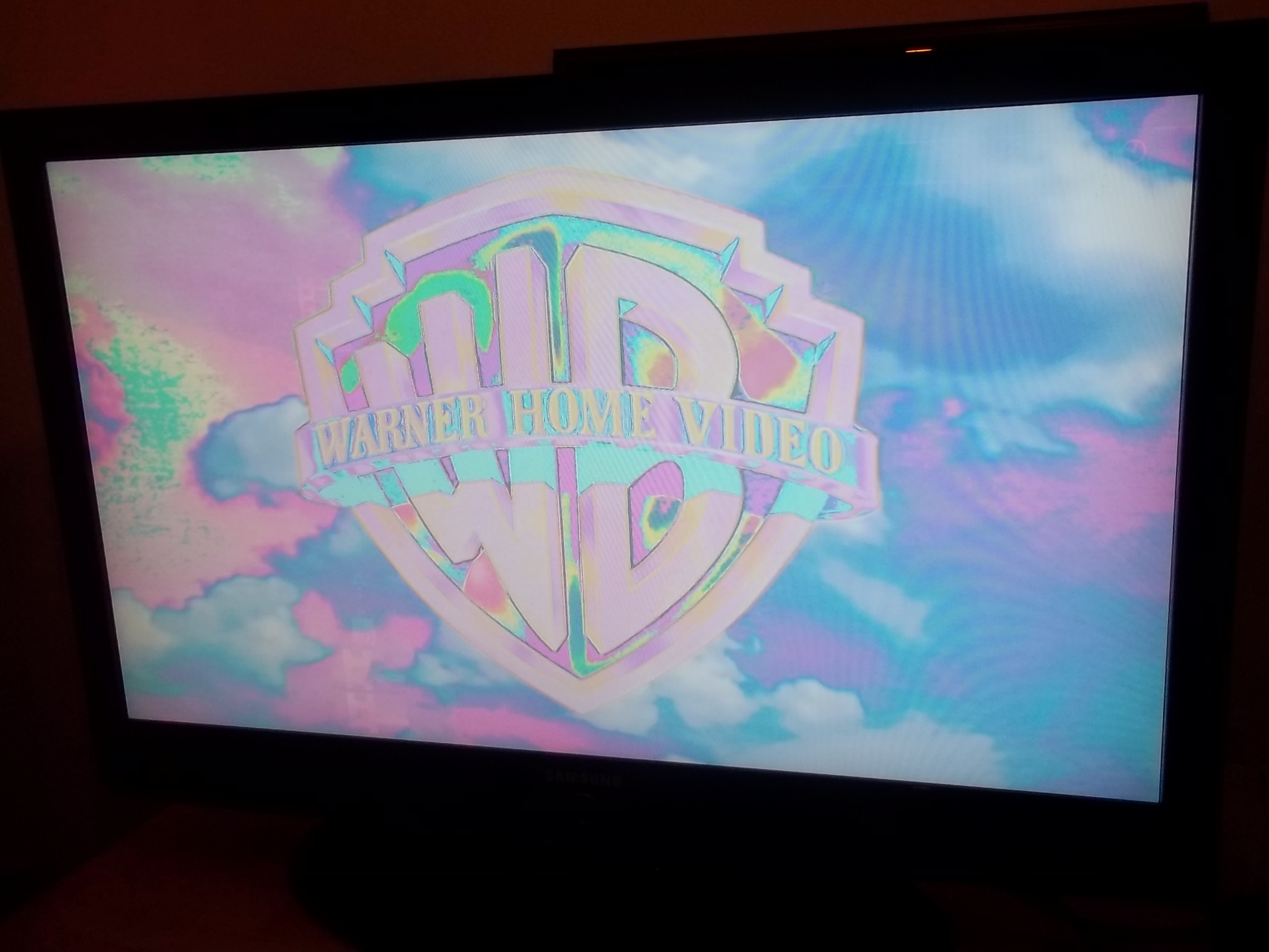

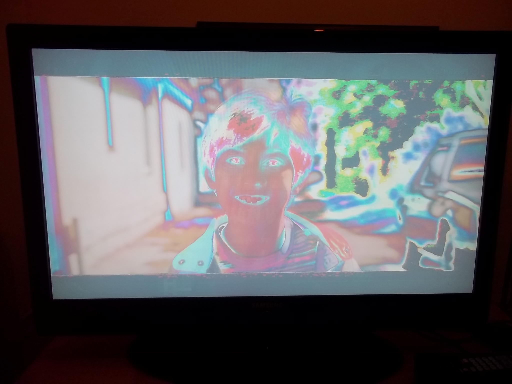

                                  I have an LE40M86 with exactly the same issue, powers up with a good picture then after 20 seconds the picture starts to saturate until eventually we get the full psychedelic effect.
                                  I tried the service menu changes and reseated the LVDS connectors but no difference so hopefully a t-con swap will do the trick. One thing I did notice is that the teletext image is unaffected, always sharp with the correct colours... does that help confirm that its not a main board problem?
