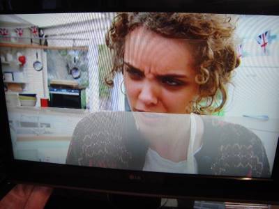

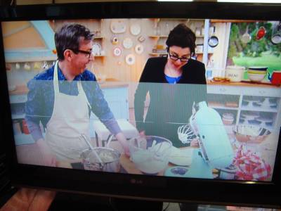

    Hi guys hope ypu can help .I have a tv coming in for me to look at.not got it at the moment but am looking for some pointer as to where to start looking.
    The tv powers on and runs, but after a short while the picture starts to flicker as shown in the photos. The image does carrying on displaying.
    many thanks
    Michael
    Re: LG 42LC46 42" LCD HD TV screen fault
    Probably a tab bonds fault -- though quite rare on these sets!
      Thanks was hopping that it would not be that fault.is that fixable
      • selldoor
        Slow Learner
        • Dec 2010
        • 7870
        Generally no but you can try see here is one way
        https://www.badcaps.net/forum/showth...light=tab+bond
          I'd say around 50% success rate LG & Samsung panels, 90% success rate with others.
