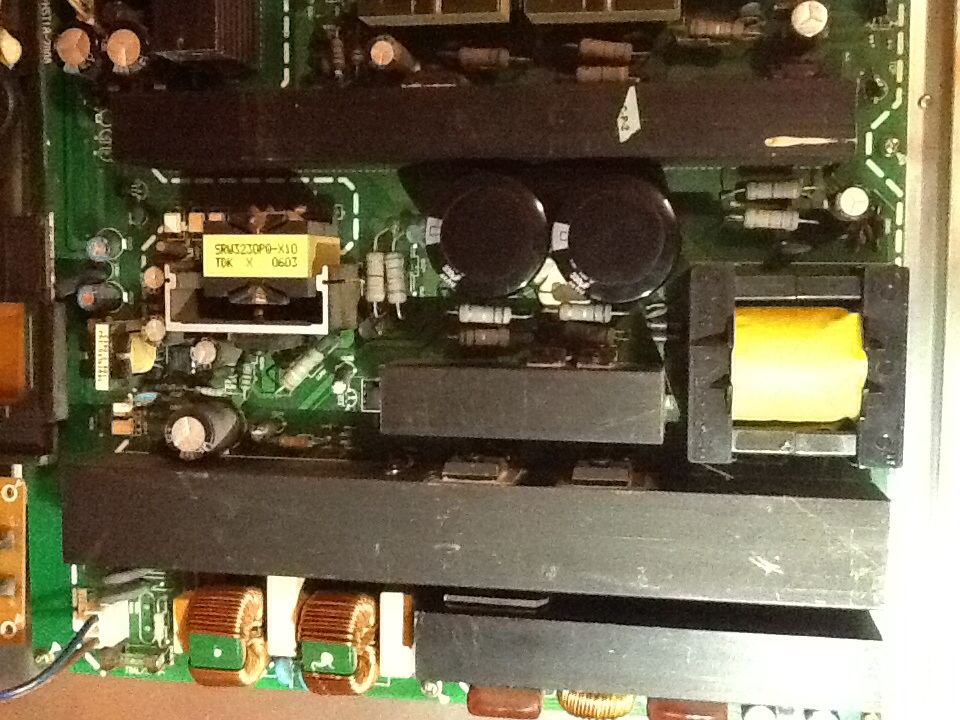

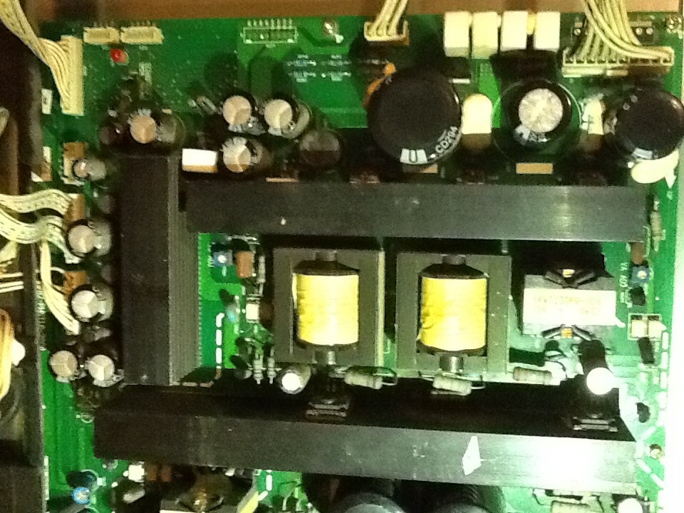

    My plasma tv (polaroid PLA5048) had a dark and hazy picture after hearing a loud pop. So far in trying to fix it, I have replaced 3 bad caps off of the main board (power board). I'm a little confused about the difference. Now I'm testing other components and when I test the SCK it reads .01. I'm not sure but I think this is for the thermistor, however when I look at them they all look good. Can anyone help me, I'm just trying to get my TV back.

    post some good clear pictures of all the board in the plasma then we can advise you where to check next thanks.

      Here are some pics of the boards the 1st 2 are the power(main) board

        Re: Polaroid plasma tv PLA5048 (bad picture)
        Sorry having trouble loading pics here's the 2nd pic of the board I talking about.
          Most likely ysus or zsus related..boards on each end of tv.
            How can I test these boards? Also why where there bad caps on the main board if it's the Y or Z boards?
