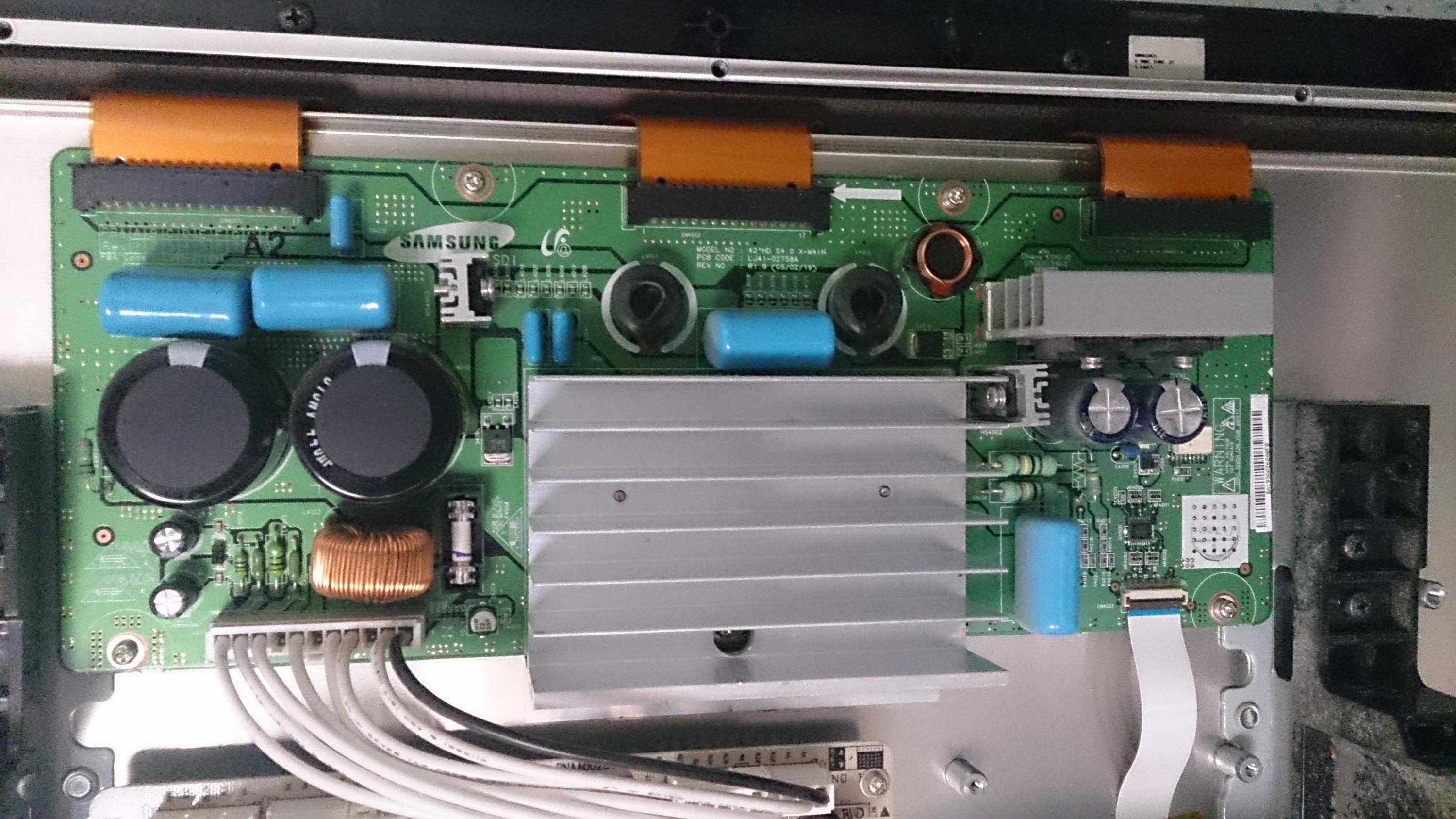

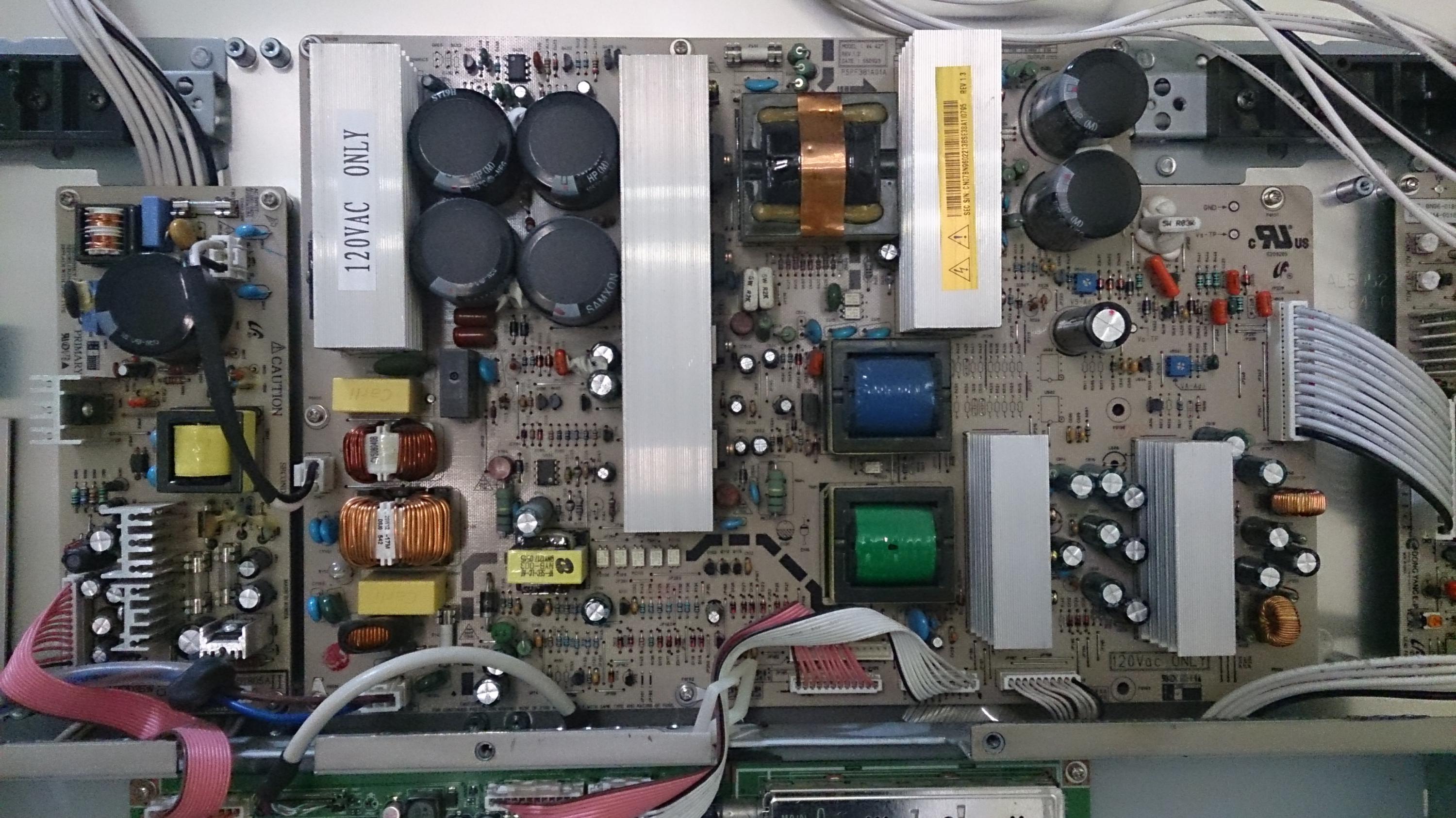

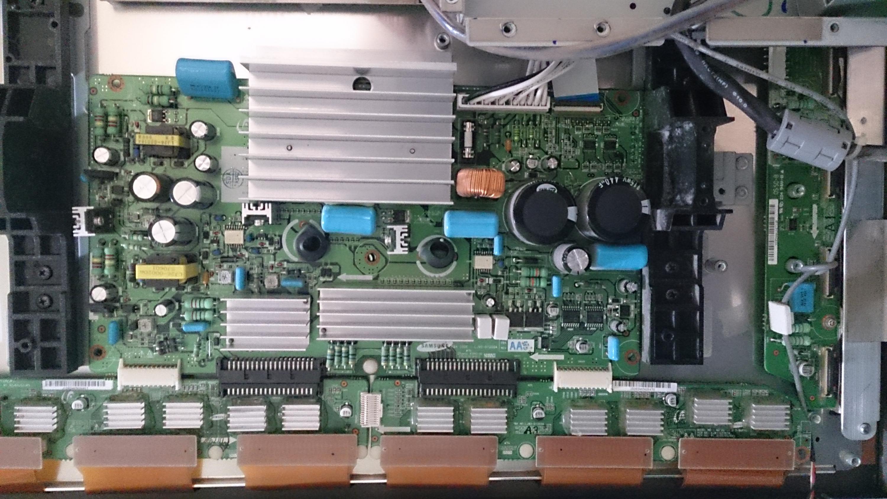

    Hello guys I am pretty new to repair TV..i have background in computer repair well i got This samsung plasma turns on blank screen...it makes the startup sound but no display...I have checked power supply board seems to be outputting all voltages to all boards and no visible blown caps...how can i confirm Y or Z board is issue...i dont hear any sound but the start up tv sound

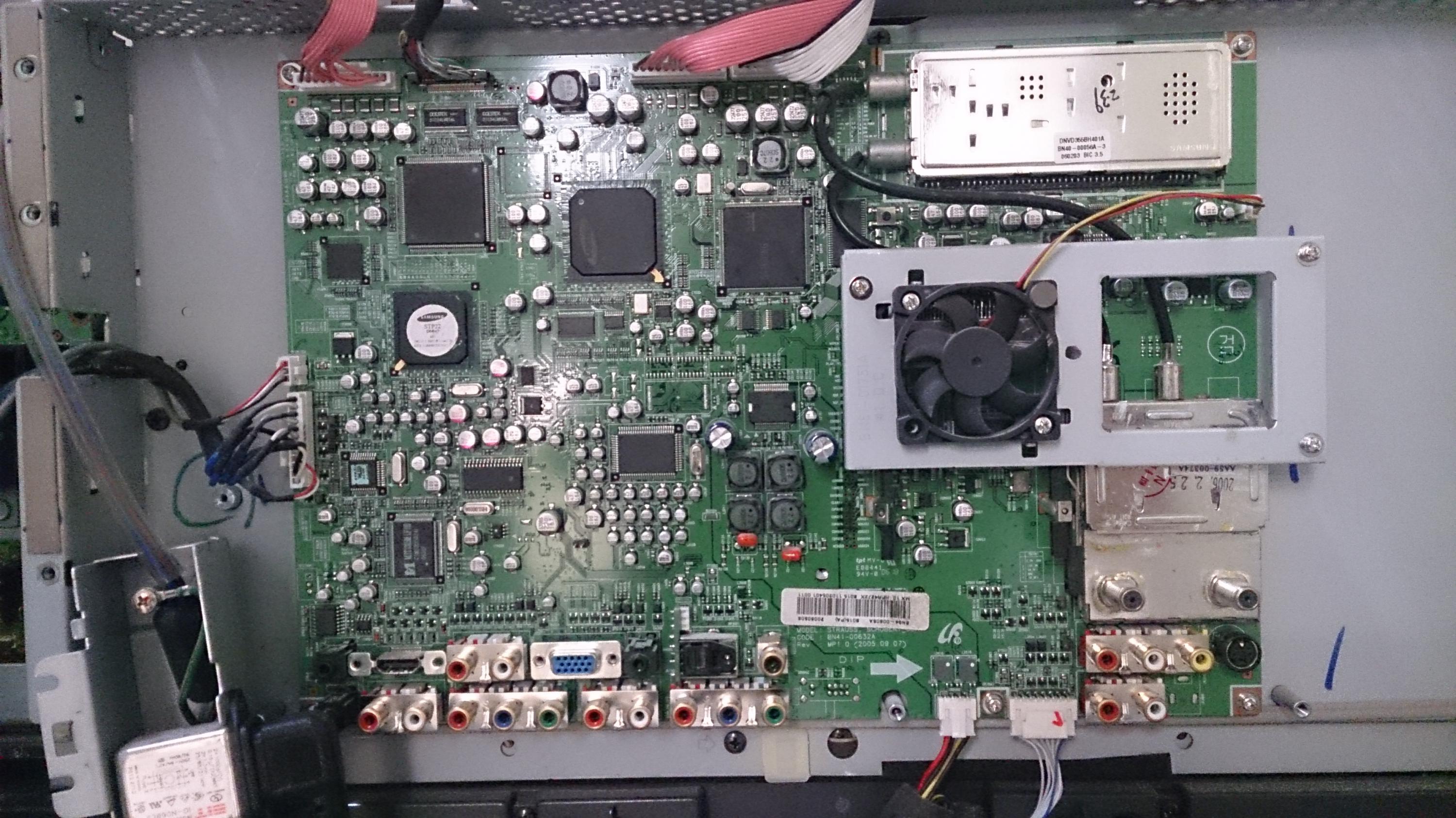

        ok so here are some pictures...
          Re: Samsung Plasma hpr4272
          there seems to be a crystal on logic board that has a dent in it…in laptops a faulty crystal causes no display..not sure if this the case with PLASMA tv….i read somewhere to check Y OR Z BOARD for no display issues after powerboard has been cleared..powerboard seems to check out…dont know how to go about troubleshooting the rest of the boards..any help would be greatly appreciated.

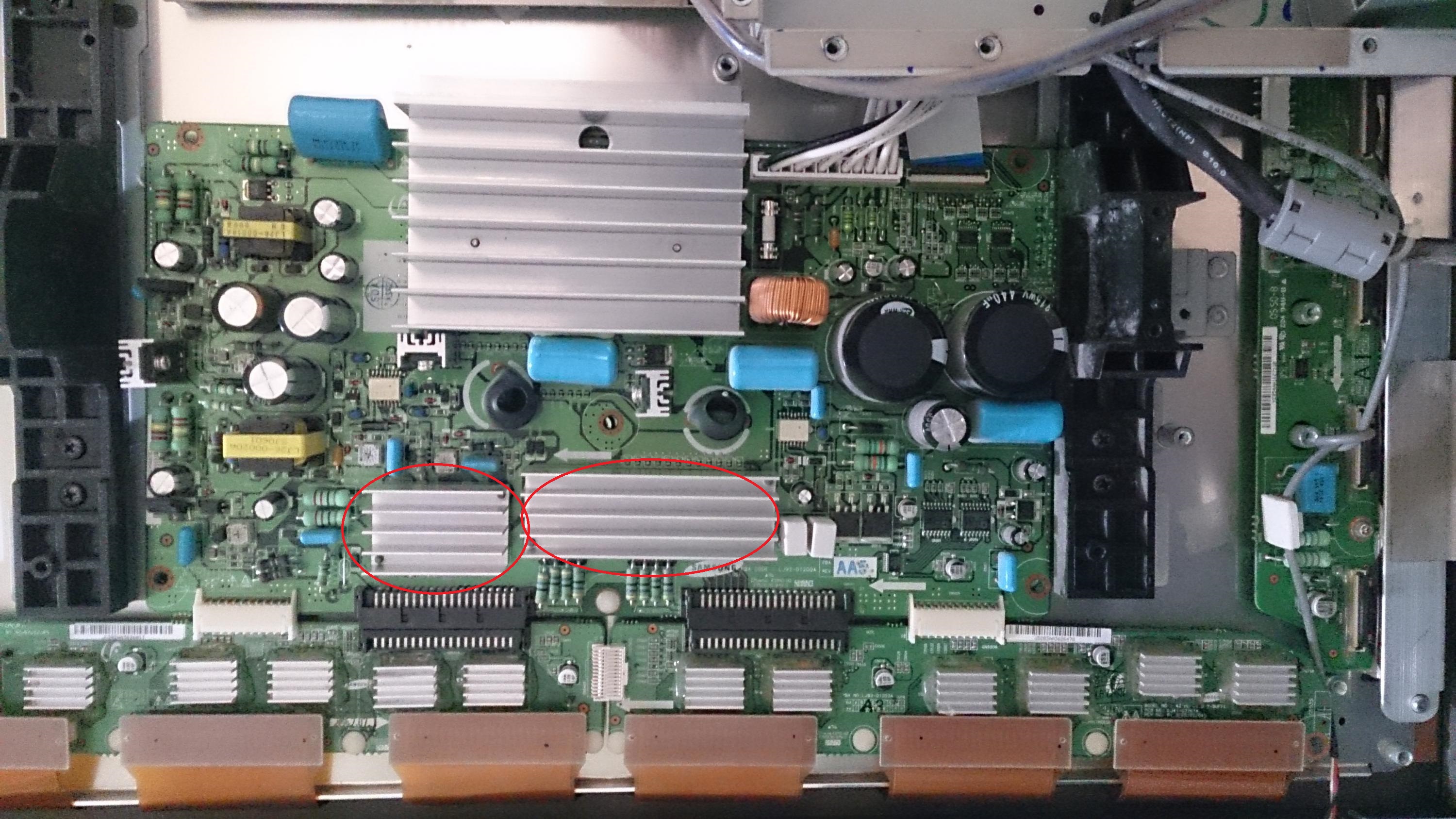

              Common components to check on y sustain ? I suspect it the y sustain board but dont know how to verify
                Have you checked the white ceramic fuse to the right of the larger heatsink? If its good than the main IPM circuit under it should still be working. If so move on to the next step.
                Check the MOSFETs under the circled heatsinks, you may find than one or more of them has gone bad. You will have to desolder the heatsinks to get to them. They are in parallel so you will have to lift the legs of each one to test if they are shorted.
                (Not as common) But there may also be some shorted diodes, you can test them in circuit if they are shorted or not.
