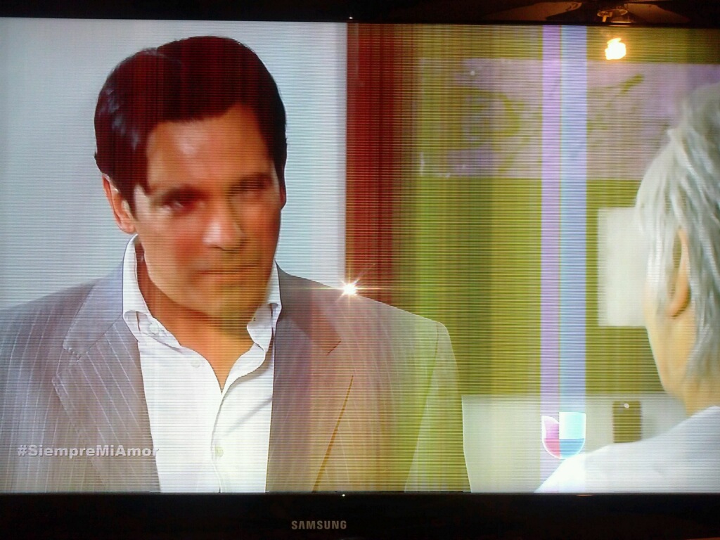

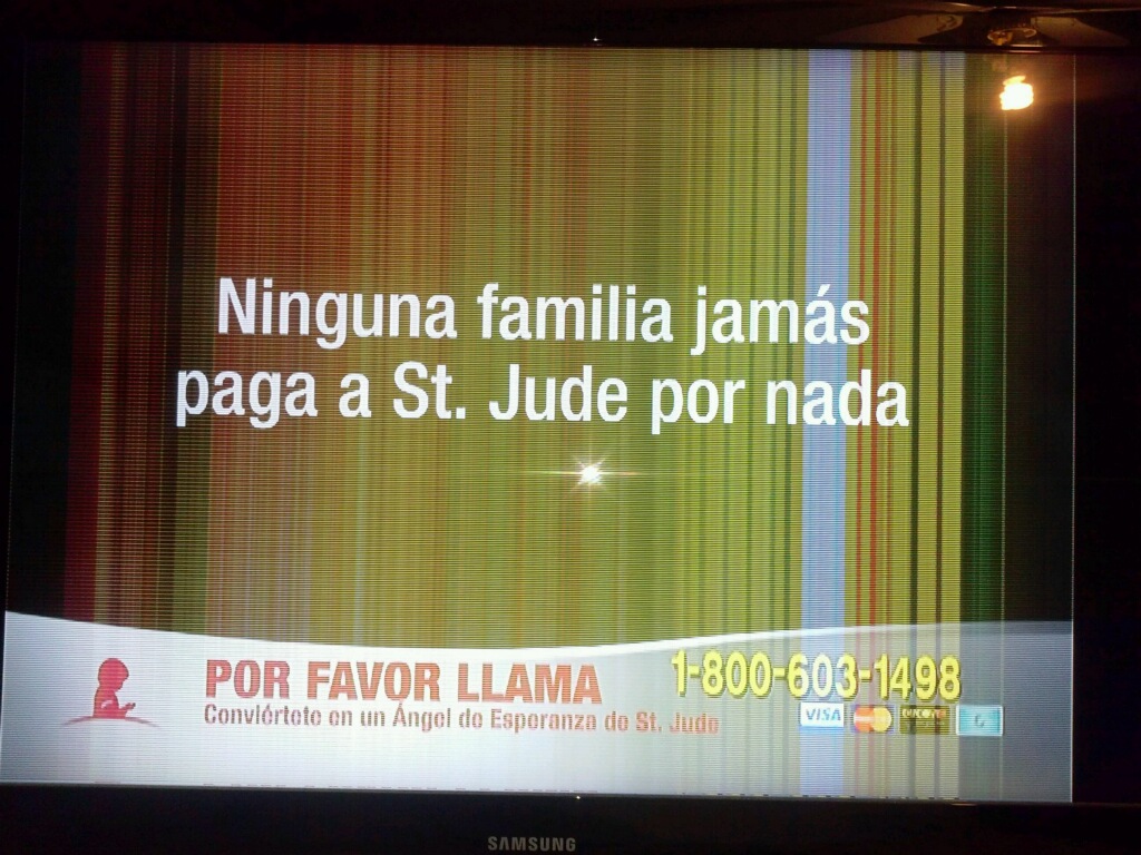

possible buy Samsung LN46B650 SCREEN PROBLEM
  • whatusername
    • Dec 2013
    • 456
    What do you guys make of this? he calls it shadow lines
  • johnboy1313
    • Nov 2012
    • 1959
    Re: possible buy Samsung LN46B650 SCREEN PROBLEM
    bad panel
    • whatusername
      • Dec 2013
      • 456
      like a tab bond issue?
      • freakaftr8
        • Oct 2012
        • 3743
        Just had one delivered today. Same model same problem. Don't know if it's fixable or not but I'm going to try tab bonds
        • whatusername
          • Dec 2013
          • 456
          when do u think u will know? im curious to know what u find out and see if this thing is worth buying or not for resale
          • freakaftr8
            • Oct 2012
            • 3743
            Probably Saturday morning or afternoon. I'll post my results in a new posting. Watch for it.
            • whatusername
              • Dec 2013
              • 456
              ok will do
                I have seen this before it's a bad panel and AFAIK no one has yet fixed it. Tab bonds don't seem to be the cause. T-con is not the cause.
                • freakaftr8
                  • Oct 2012
                  • 3743
                  Agree with tom66. Took panel apart. Tab bonds not the issue. No fix. Probably will not be a good investment.
                  • whatusername
                    • Dec 2013
                    • 456
                    agreed i passed on it
