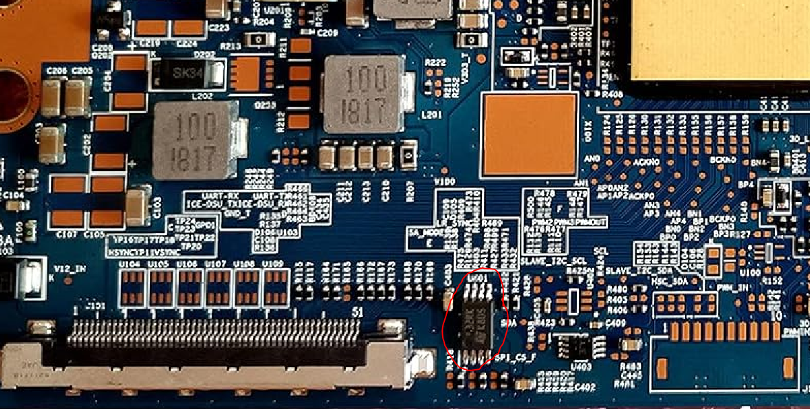

    Transfer eeprom 24c32 from the original t-con to the new one.

      Thank you for your answer, I already done that too, but it stayed the same.

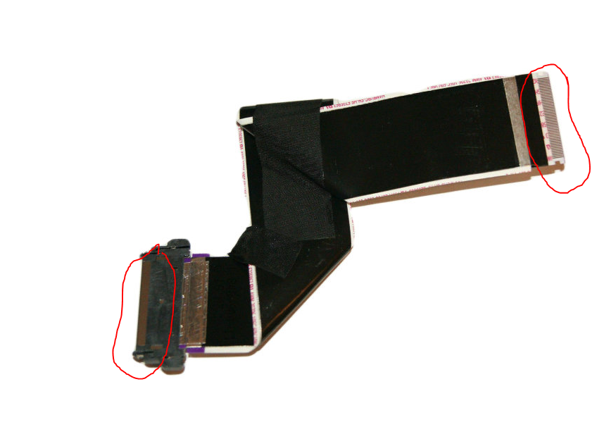

        Check these contacts on the LVDS cable to see if they are bent during manipulation and for their cleanliness under a magnifying glass.
        Did you re-solder the eeprom well?

          The EEPROM chips were all soldered correctly/good, but of course I resoldered them just in case, its perfect still.
          The LVDS cable doesn't have bad pin, and I cleaned it.
          Unfortunately nothing changed.

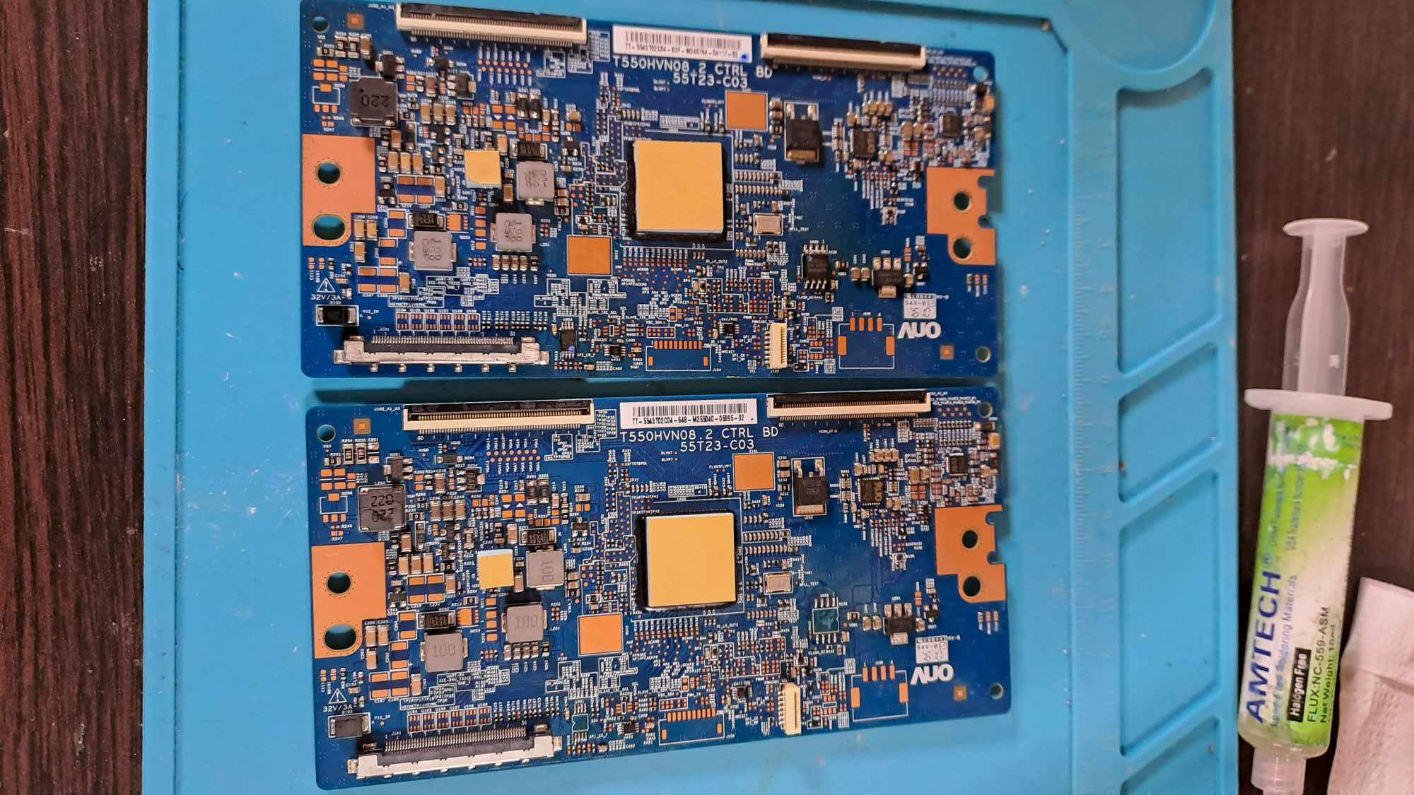

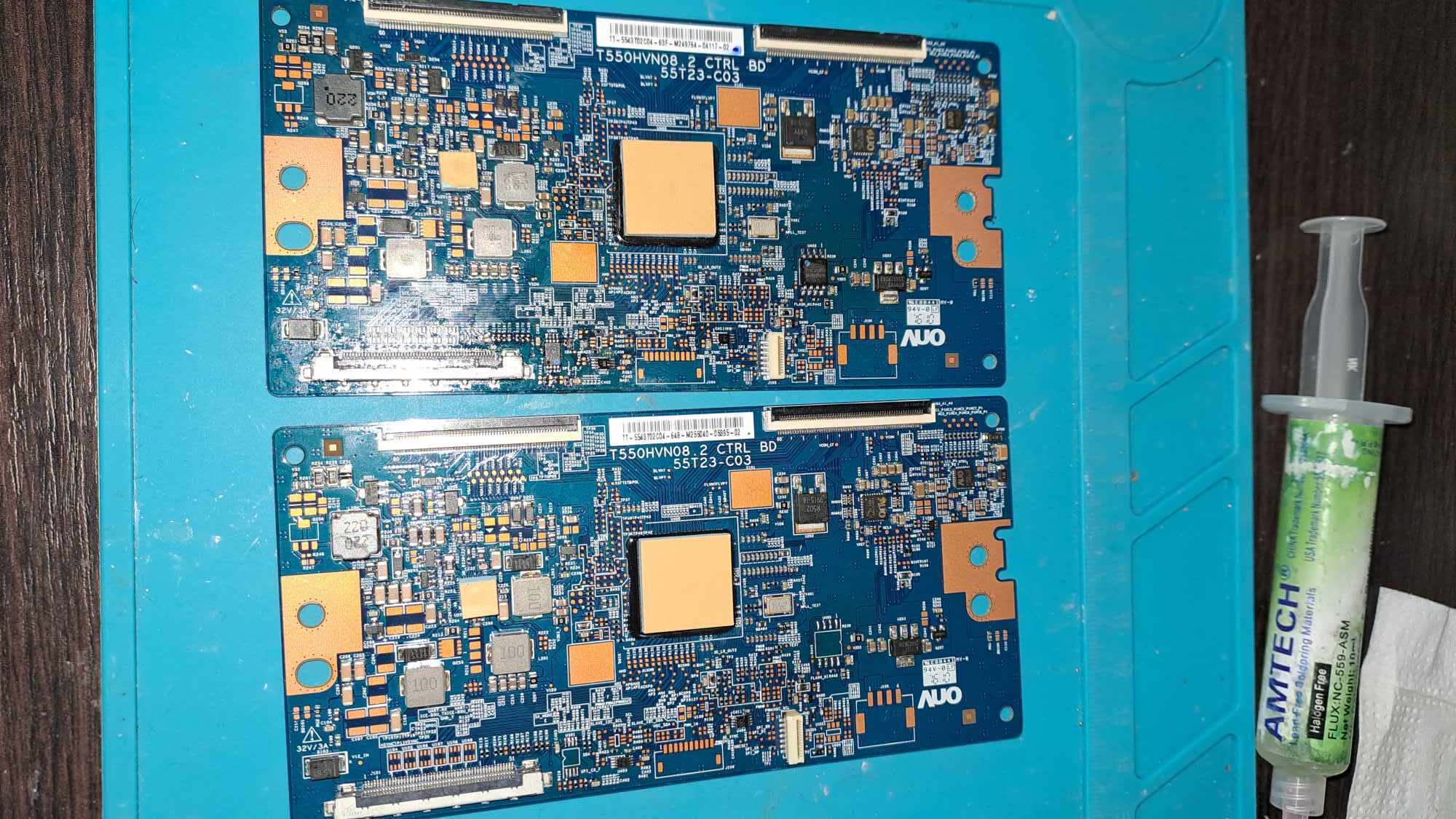

          I'm out of ideas right now. I attach images of the boards, maybe you can find some differences between them, although I could not.
          The top board is the new, and the bottom is the old one.
          2 SPI/NAND and a capacitor were missing from the new one, they were placed on from the old one, so it's like a perfect clone of the old one.
