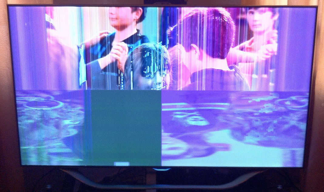

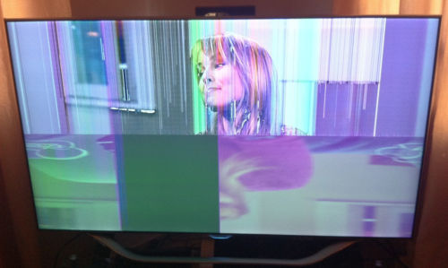

Bad Panel ?
  • mmartell
    • Oct 2013
    • 3189
    Bad Panel ?
    Bad panel or T-con maybe ?
    The lines on the top half running vertically through the picture make me think bad panel.
  • freakaftr8
    • Oct 2012
    • 3743
    Re: Bad Panel ?
    That is most certainly a bad panel. It's liquid bleed. Also happens upon extreme pressure hitting the panel without breaking it. Seen it before.
    • freakaftr8
      • Oct 2012
      • 3743
      Re: Bad Panel ?
      Oddly enough though if it were bleeding it.would run further than center point. That is really a strange one. I'm still tthinking panel but hey if it's cheap enough you might consider.putting a tcon in to see if it cures it.
      • mmartell
        • Oct 2013
        • 3189
        Re: Bad Panel ?
        No can do as I don't own it. It's on ebay and it's not cheap but it is "cheaper" than usual as it's a Series 8 Samsung.
          Re: Bad Panel ?
          Looks like a digital processing failure but couldn't rule out some water damage to panel given the lines.
