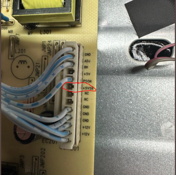

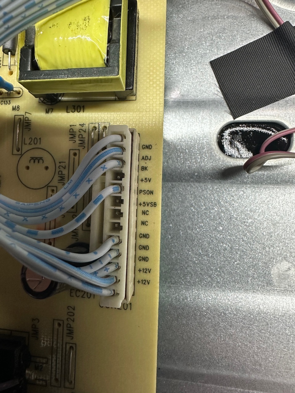

    Voltages on PSU board with main board and led disconnected:
    3 large main caps - 380v DC
    CON201
    GND
    ADJ -
    BK -
    +5V - Not Connected
    PSON -
    +5VSB - Not Connected
    NC - Not Connected
    ND - Not Connected
    GND
    GND
    GND
    +12V - 11v
    +12V - 11v​

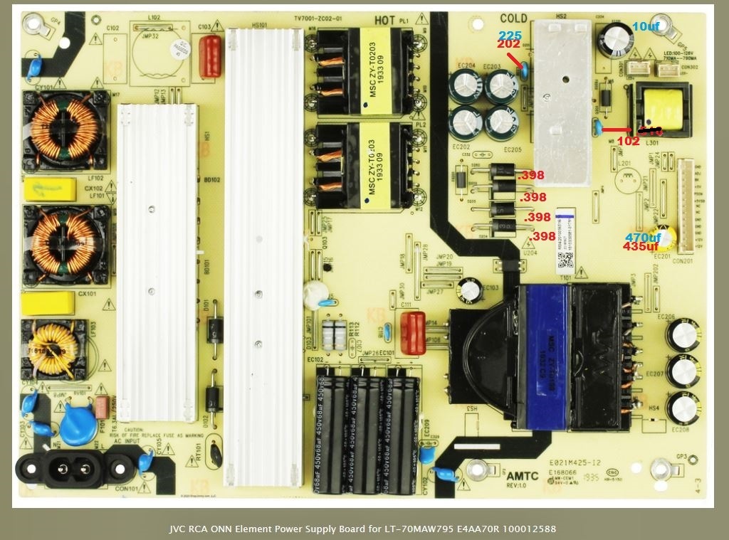

                  Check the diodes on top of the board, looks like there's six, diode checking is done with tv unplugged from power. Another easy test, with everything hooked up heat the electrolytic caps with a hairdryer for a couple minutes then try turning on tv, see if there's any difference if only for a bit.
                  • nomoresonys
                    • Jan 2013
                    • 12206
                    • U.S.
                    Also check those two resistors, maybe switch out EC201 right by the connector if you have one handy and no way to test the caps.
                    • nomoresonys
                      • Jan 2013
                      • 12206
                      • U.S.
                      Quite often when you have those fluctuating voltages it's because of a faulty capacitor.
                      • itronic
                        • Sep 2015
                        • 82
                        • usa
                        Thanks . Already replaced the LED Capacitor (EC210).Will test further

                          Results from following test:
                          4 diodes- D203-D206= .398 they all read same. good
                          2 blue caps :C338=202PF(replaced with 221pf) good now. C133= 102PF (GOOD)
                          EC210- 5UF REPLACED- READING IS 10UF NOW.
                          EC201 - (448UF) REPLACED -READING IS 470UF NOW.
                          VOLTAGE READINGS.
                          BEFORE CHANGED THE 4 DIODES READING:
                          D203 =5DCV
                          D206= 5DCV
                          D205=320DCV
                          D204=320DCV
                          VOLTAGE READINGS.
                          AFTER PARTS REPLACED, THE 4 DIODES READING:
                          D203 =25-45DCV- FLUCTUATING
                          D206= 25-45DCV FLUCTUATING
                          D205=320DCV
                          D204=320DCV
                          Leads placement:
                          black on frame ground
                          red on bk connection
                          voltage is .1vdc in standyby
                          pushing power switch they are no change in any voltage​
                          red lead on pson
                          voltage is 2.3vdc to 2.5vdc it flucuates in standby but not as bad.

                                This board don't have 5Vbs. Well it don’t produce 5vdc.

                                      • itronic
                                        itronic commented
                                        Editing a comment
                                        Even though its shows it on the label. It doesn't produce the 5vdc voltage

                                      UPDATE. TV IS WORKING FIND NOW.
                                      Tv is power on and working. voltage is steady
                                      VOLTAGE READINGs
                                      D203 =135DCV
                                      D206= 135DCV
                                      D205=270DCV
                                      D204=270DCV
                                      Big Caps 382v
                                      led 115v on each
                                      CON201
                                      ADJ- 2.27VDC
                                      BK- 3.02VDC
                                      PSON- 3.32VDC
                                      +12V- 12VDC
                                      REPLACED:
                                      R355,R002,C338,EC210,EC201
                                      THANKS FOR THE HELP nomoresonys AND lotas
