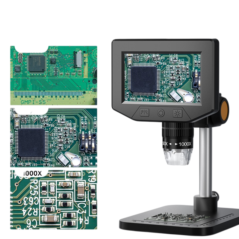

                Would it be an issue to change CC772 with a 15pF 50v 5% capacitor instead of the original 12pF 25v 5%?
                I would absolutely purchase a 4k model with proper c-mount optics if I could afford one, really! We've got a distributor for mechanic brand equipment here in Ecuador that has nice trinocular microscopes but they cost $300-$600 each. Just mentioning that minimum wage here is $450 and most of the time I struggle to earn even half of that each month, that should give you an insight in how high of an investment it would be for me. At best I am going to be able to afford one of these $100 1080p ones that I can hook up to my pc:

                    Understood. We should barter for some of your hot women. SMDFlea is hording all the good ones.
                    Pretty sure that Mechanic will be at the electronic trade fair next month in HK. I recall seeing their CEO last time. Their staff noted that he is loaded. I think the new trend is to have a 4k microscope camera module AND thermal sensor in one unit. Not sure if we like that because to us, it is a royal pain to take thermal shots of larger boards like iMACs while they remain inside of their enclosures. Better, IMHO to have a thermal camera that is mounted to a phone. Will share what we see at the mobile fair.
