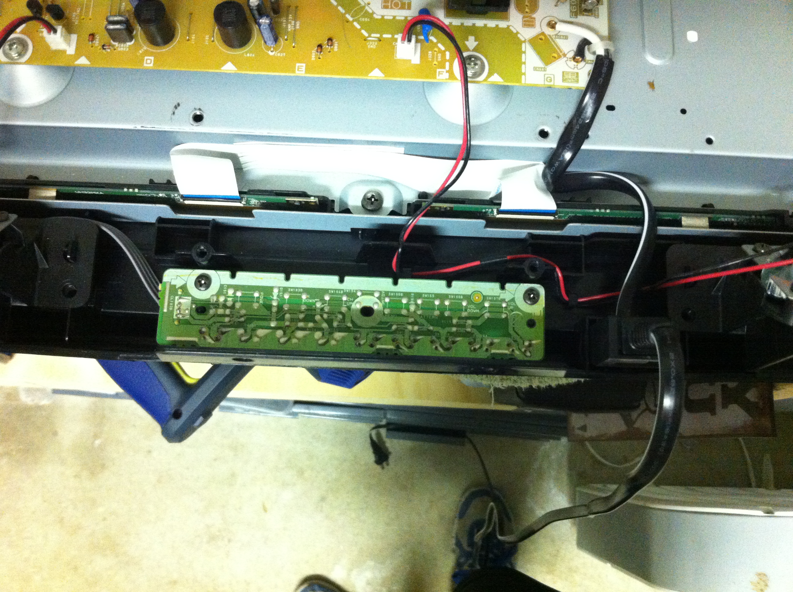

    Got a 32" magnavox that will not turn on no lights nothing. Fuse ok, caps look ok. Any suggestions are greatly appreciated? Thanks

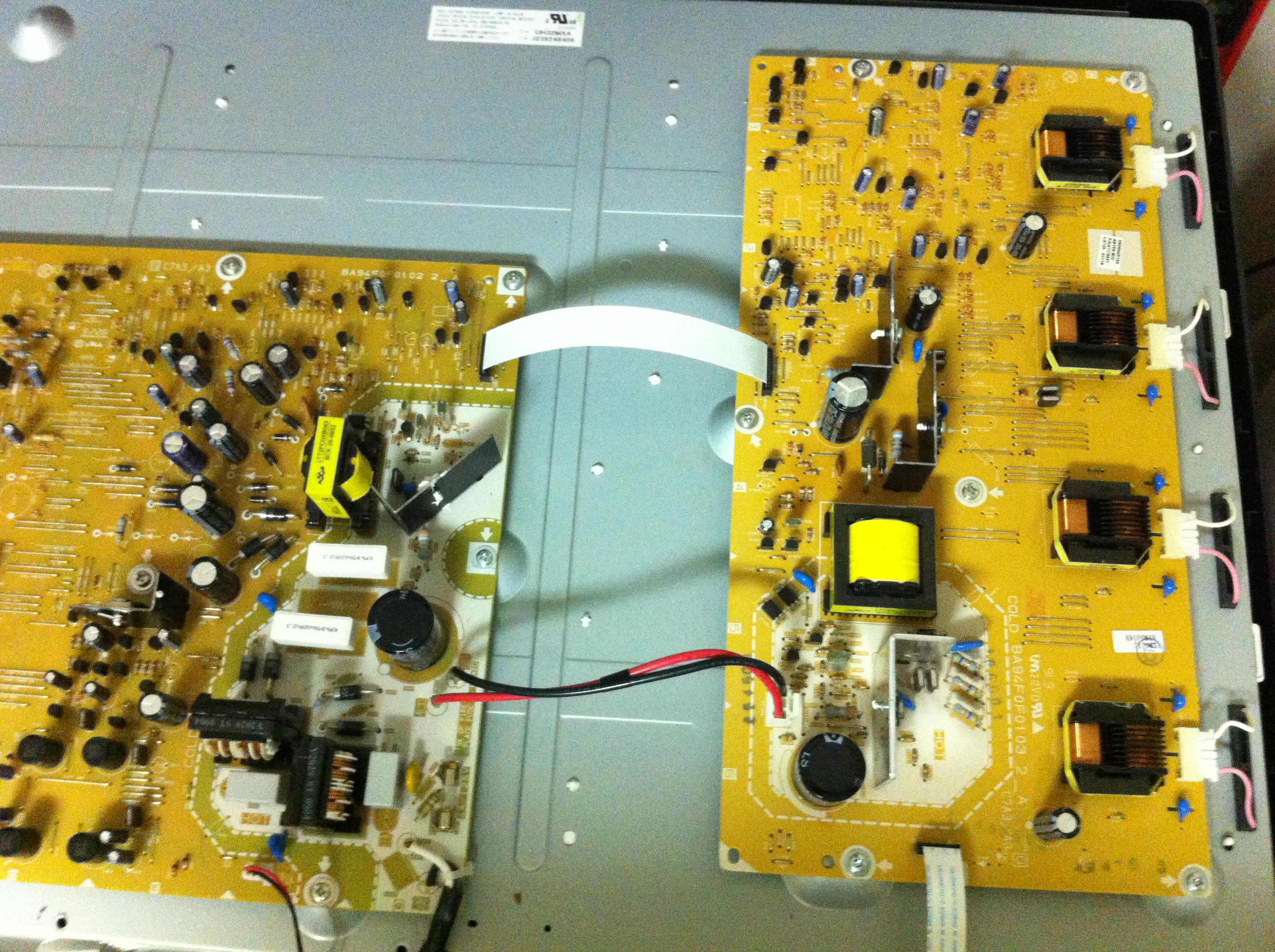

    What is the Voltage on the Red and Black cables near the big cap in the first picture.
    CARE Very high voltage 1.41x mains. so set meter on 600vdc

      Re: Magnavox 32mf339b/f7 no power
      169 vdc
        ok well that is spot on for120vac so now you need to test for low dc voltages
        somewhere on the links to the main board section of that board - I just hate them.
        If they are not labelled and you dont find a schematic service manual I would just try testing for vdc voltages up to 50v on the diodes radiating out from the yellow transformer ( on the secondary (cold) side)

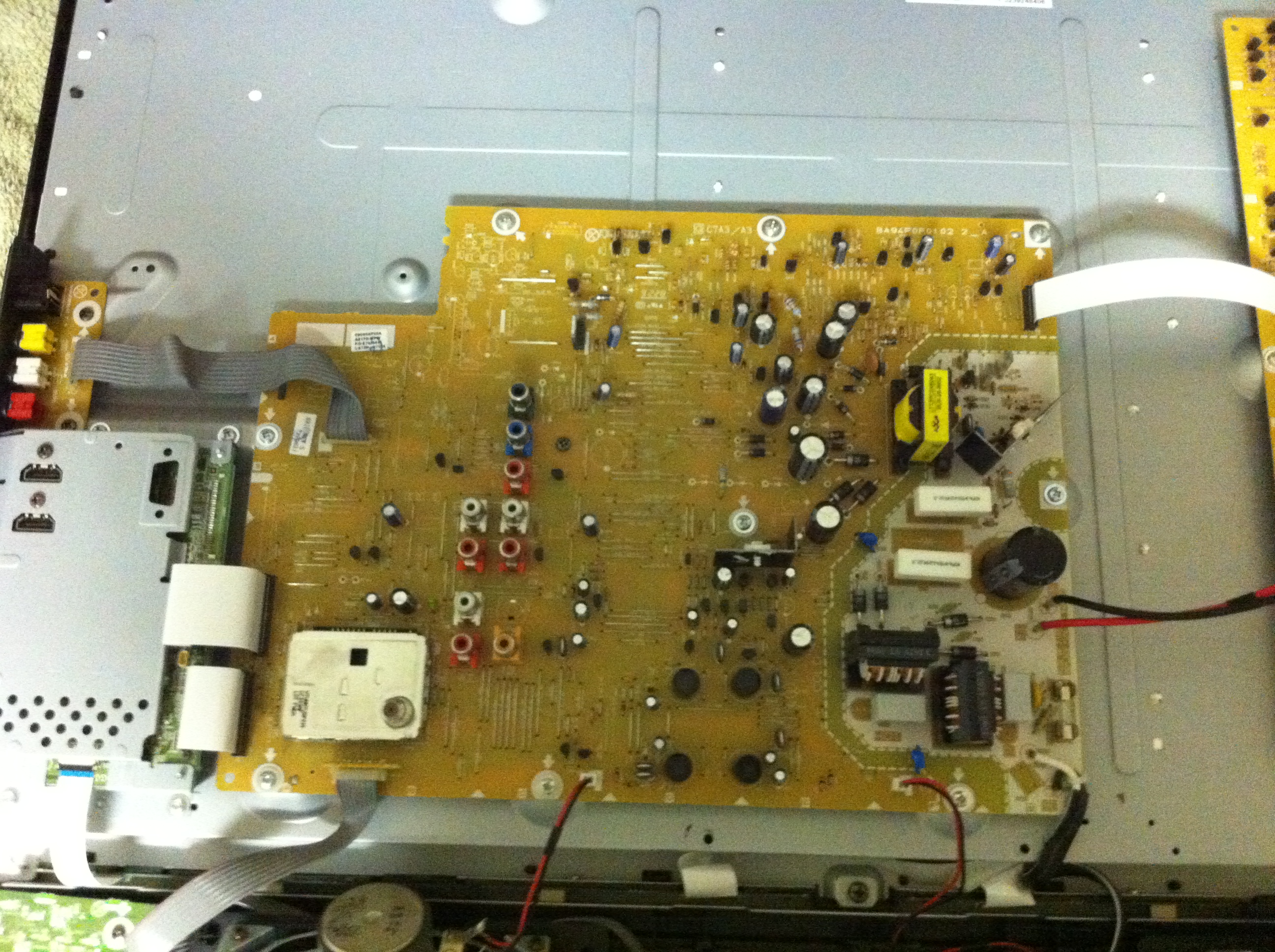

            I just fixed this model, in my case it was SB390 Diode (D642 on my board). Borrowed the same diode from different board and it fixed it. Now I need get replacement, but closest match that is available for shipping is SB3H90 - will it work?
            http://www.digikey.com/scripts/DkSea...14663043682765
            This is link for original diode http://www.digikey.com/product-searc...376383?k=SB390
