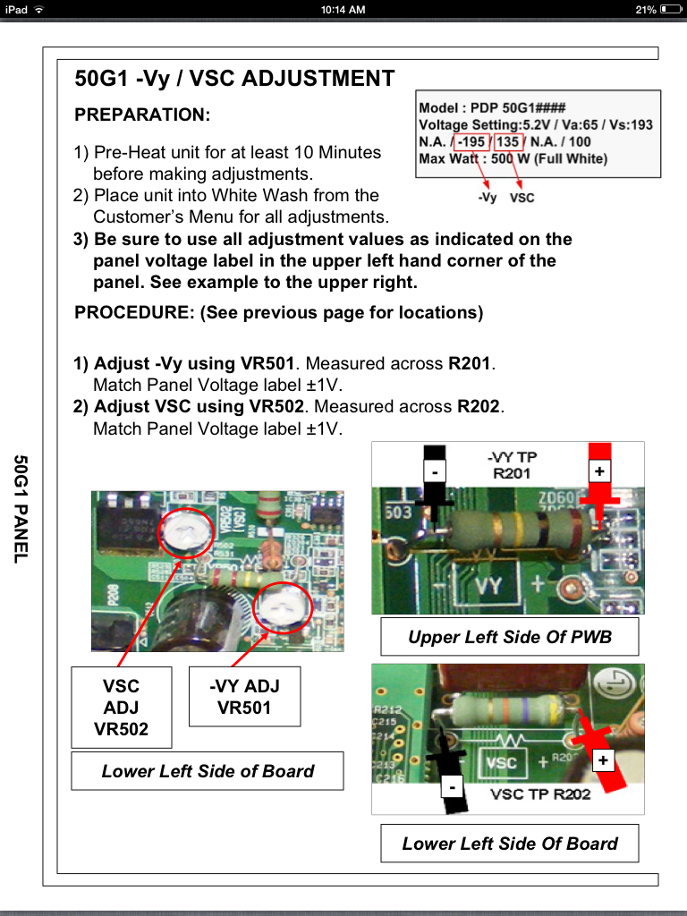

    PD50G1 -Vy Testing Positive Voltage
    Troubleshooting a plasma with no picture. Looking at the YSUS, the -Vy target is -195. My actual is +195v with only the bottom buffer board attached. There is no voltage on VA or VSC with upper buffer board in place.
    I'm thinking, I have a bad upper buffer board. What would cause the -Vy to test positive?
    Thanks for any help that is offered
    Re: PD50G1 -Vy Testing Positive Voltage
    Such a positive -Vy would certainly be explosive to any capacitors nearby, so I doubt it's the case. Just need to reverse probes.
    • ChrisV
      • Dec 2013
      • 66

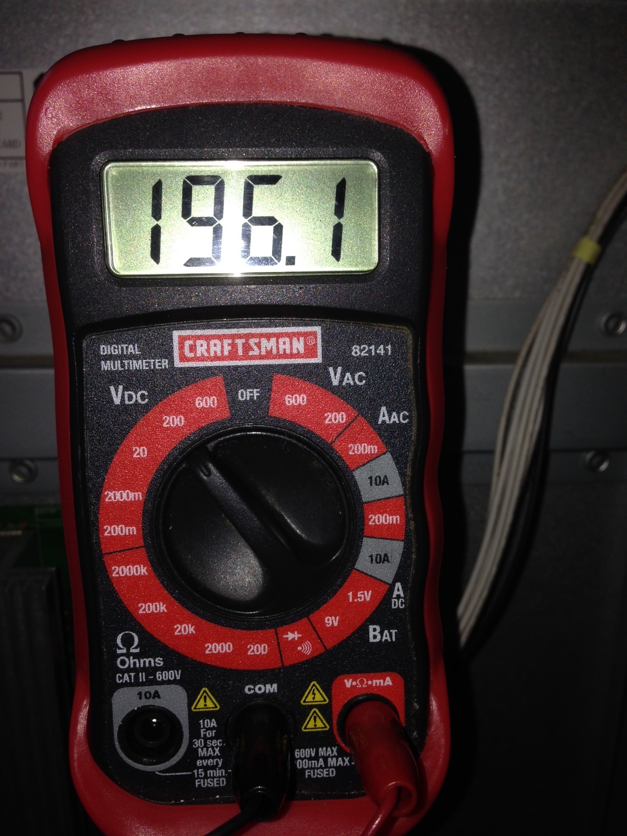

      Thank you for the reply Tom66.
      Just for clarification, if I check voltage in the way that is described in the photo above, with red probe on + and black probe on -, it is a positive voltage. If I reverse the probes and place the red on the - and the black on the + it has the correct negative voltage.
      Could there be something wrong with my DMM or would this indicate correct voltage at this test point?
      Thanks again.
      PS - Thanks for making the service manuals available
        I think it's a mistake in the service manual. Nothing to worry about.
