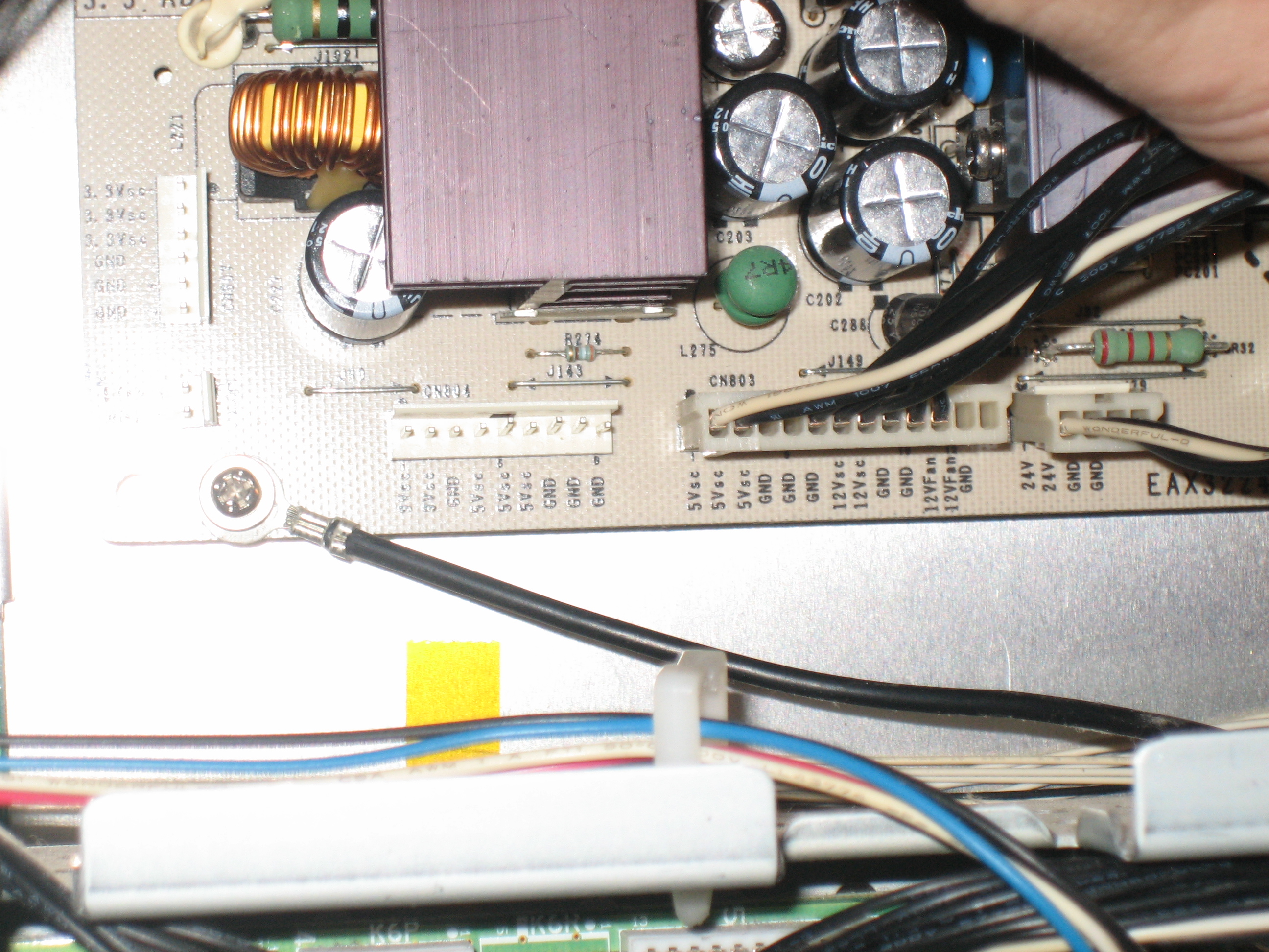

      Actually, to make sure I know what pictures you're looking for, are you talking about taking pictures of the actual circuits that I was testing on in the power fail circuit chart?
        Re: DP50747 Question

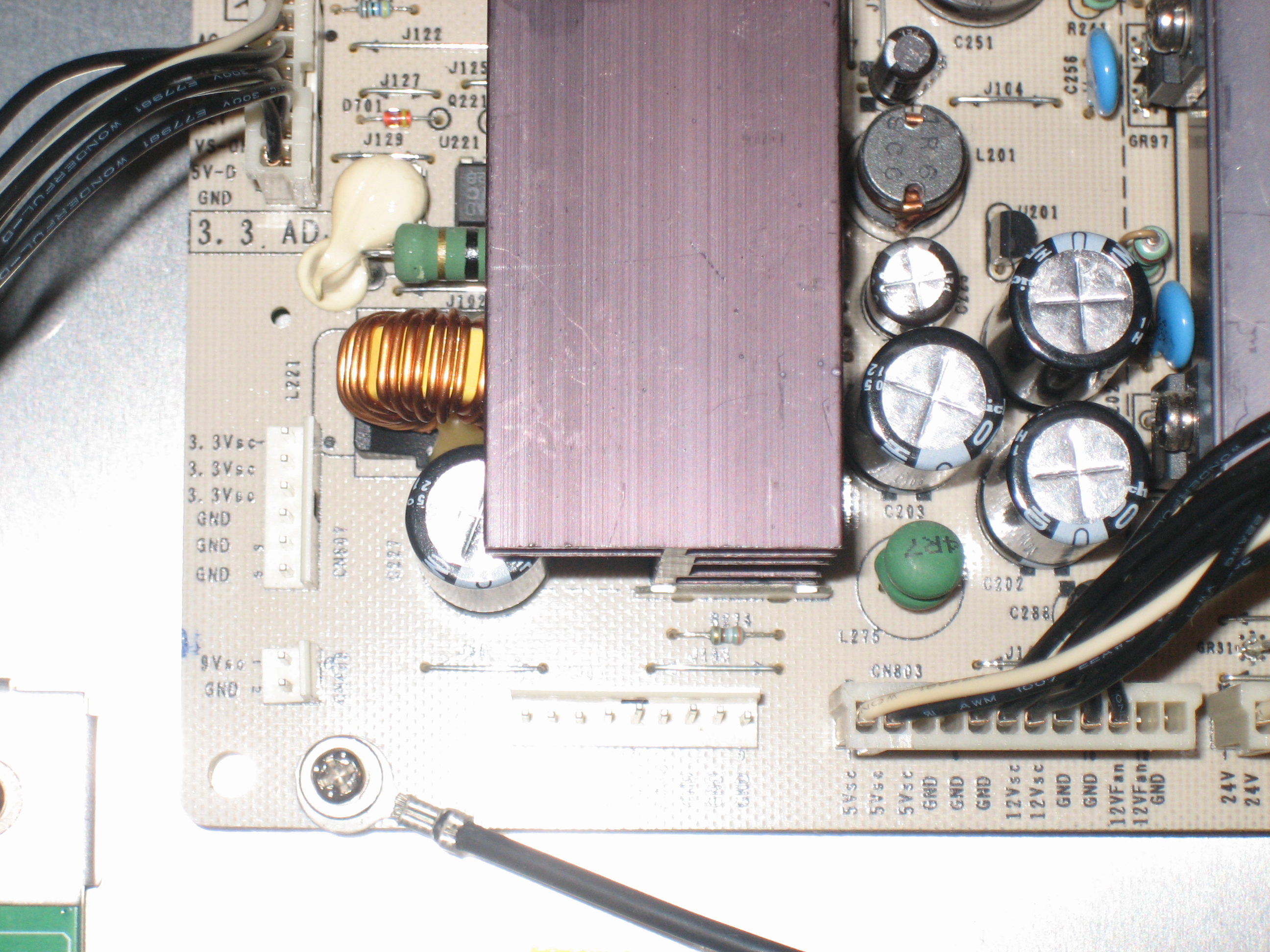

        No No, If you look at the PSU and filter board near any connectors you should see voltage references etc, 2 seconds I will give an example
          look for the print that is highlighted, take a close pic so i can read them... do this to all the connectors on the PSU
          As your board seems to be a different revision than the one in the manual I need to figure what is going where so i can trace the circuits via the schematics and pinpoint where the failure is occurring

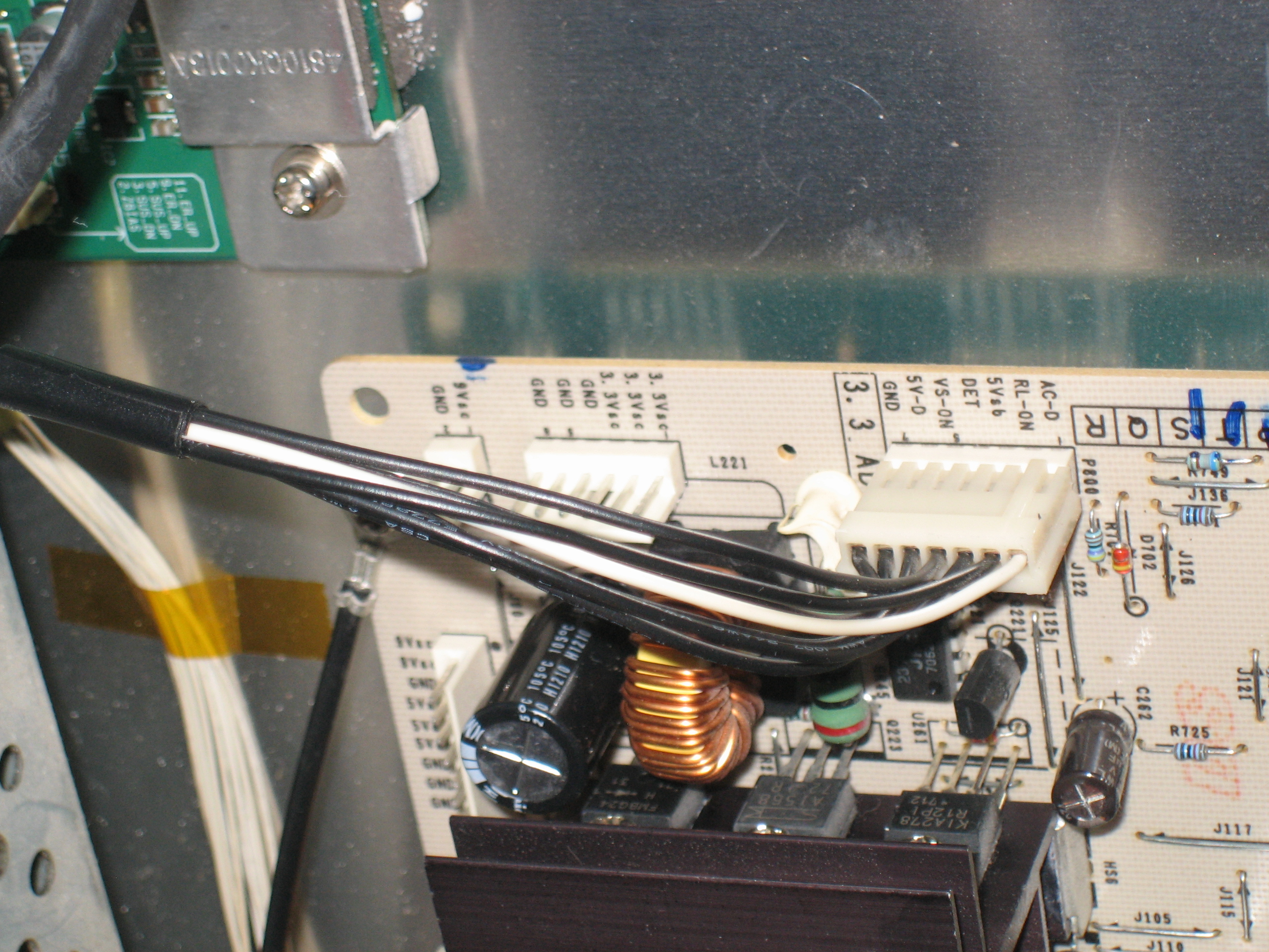

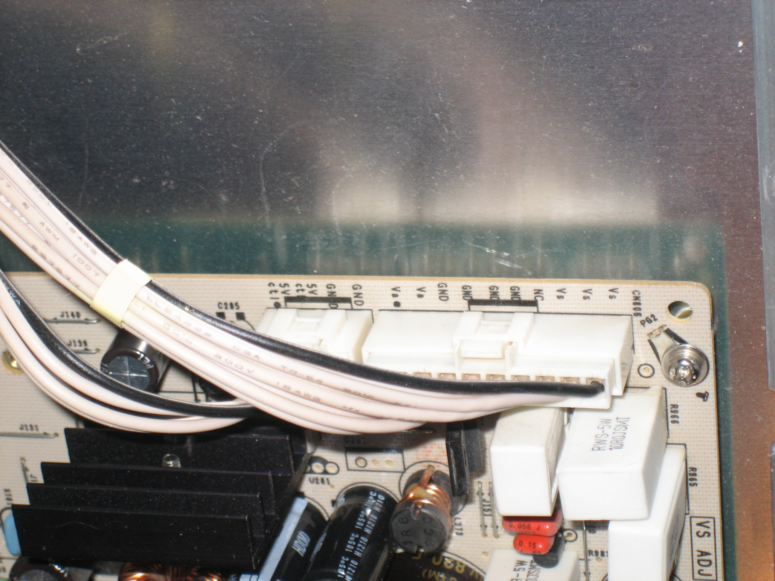

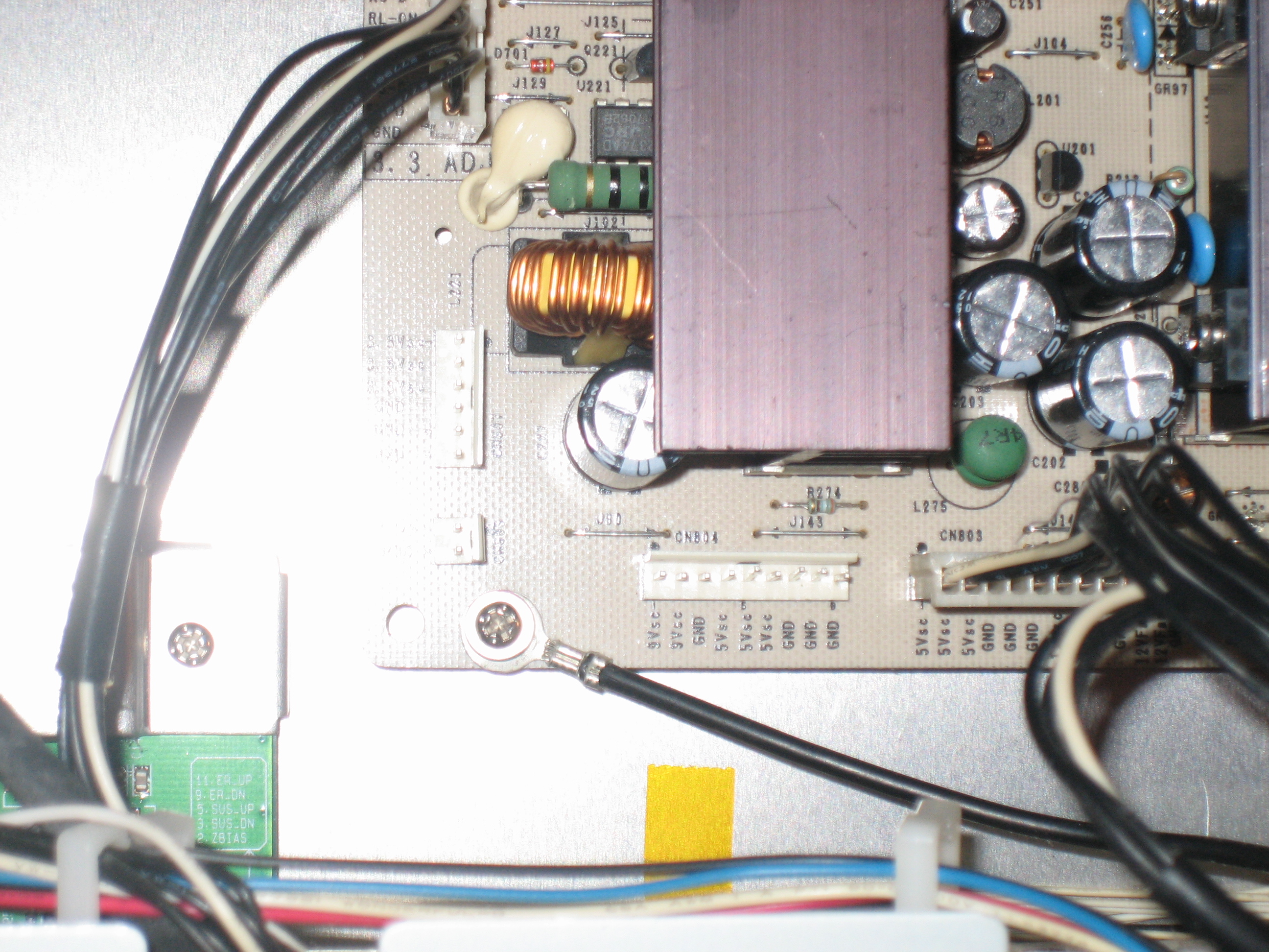

                OK, here are some pics of the power board connections. I left all plugged in so you could see which ones cables aren't used on if that's helpful (there are multiple connectors that aren't used).
                  Let me know if any of these won't suffice for now or if you think any other board pics would help.

                    Does the fact that we're good on Vs but nothing on Va point us to something on the power board for sure? A short somewhere? I'm just not sure how to proceed. I've read some people say that there was another common piece outside of the caps that goes bad on this board and needs to be replaced, but could never find out exactly what it was.
