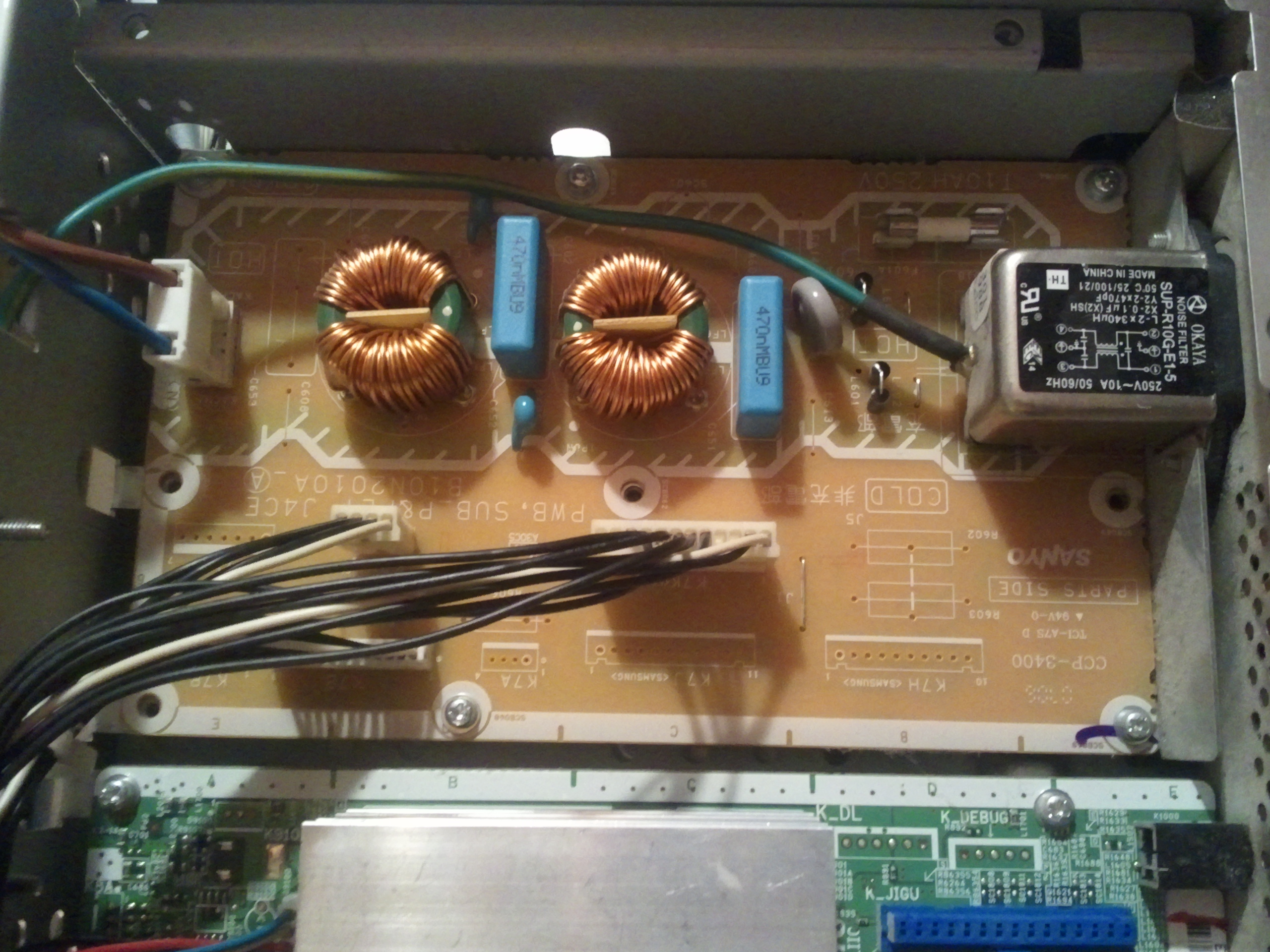

              Re: DP50747 Question
              Connector from filter board, Throw some pics of the boards and chassis and I will point them out if needed
                Here's a picture of the board, I see the points you're talking about, but there are no connectors in place there.

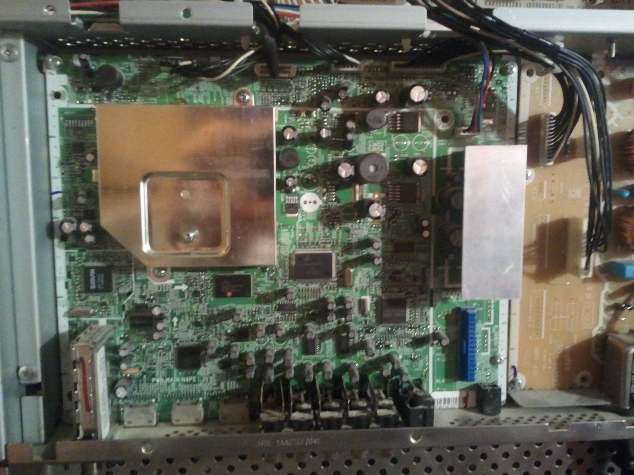

                  Different revision of board.
                  Ok lets test voltages on main board for the Power Fail Circuits...
                  Picture of main board

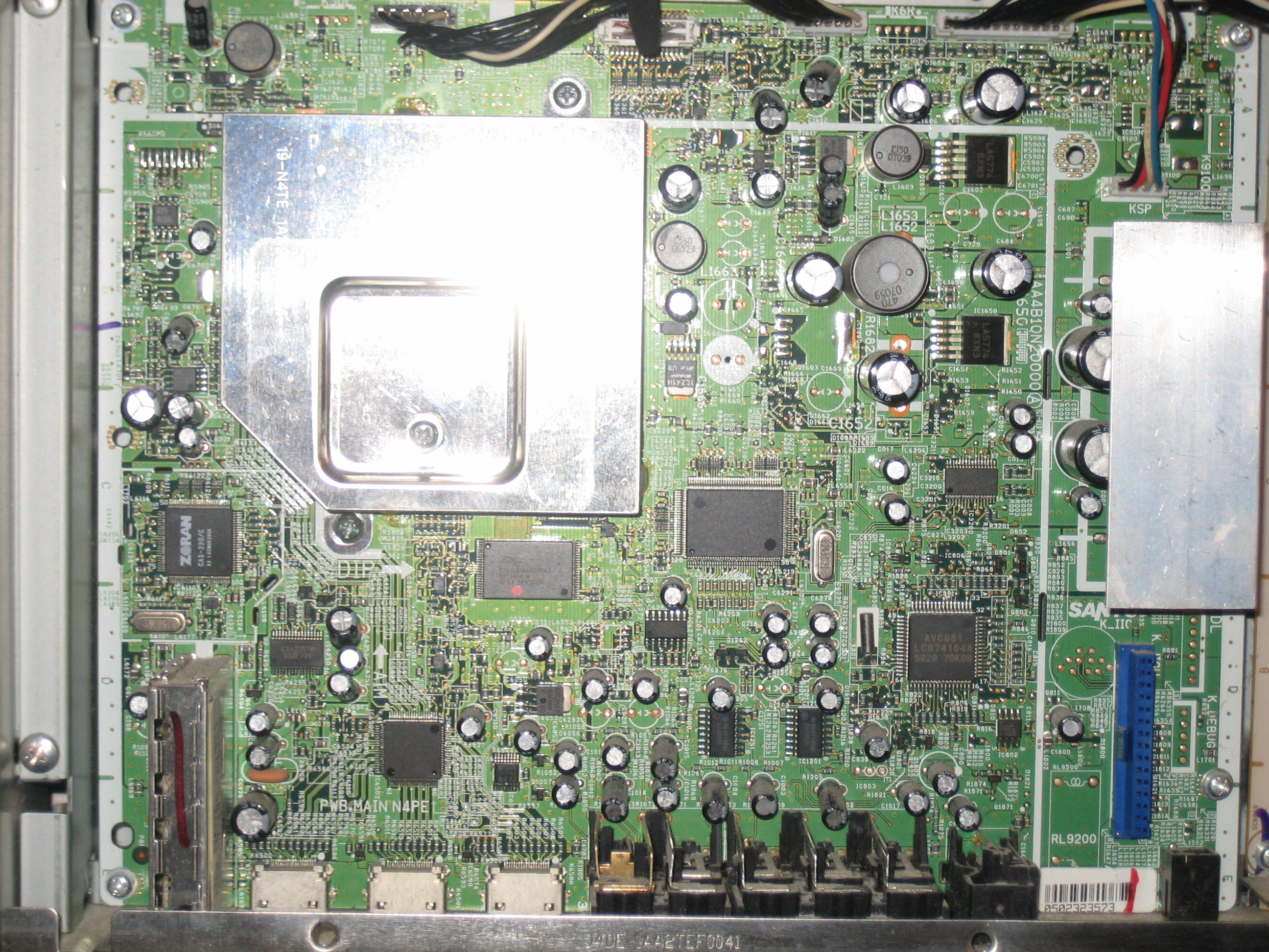

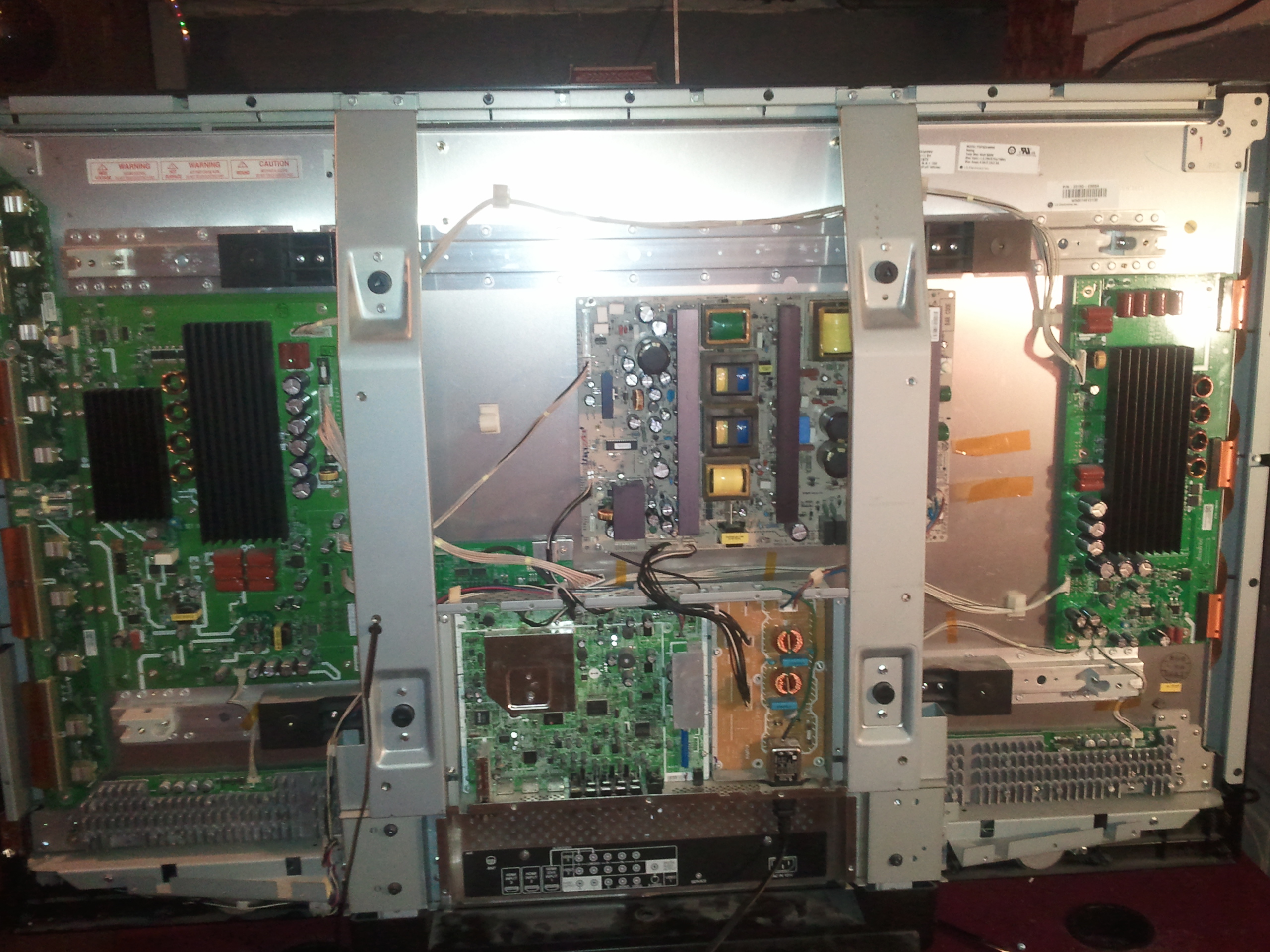

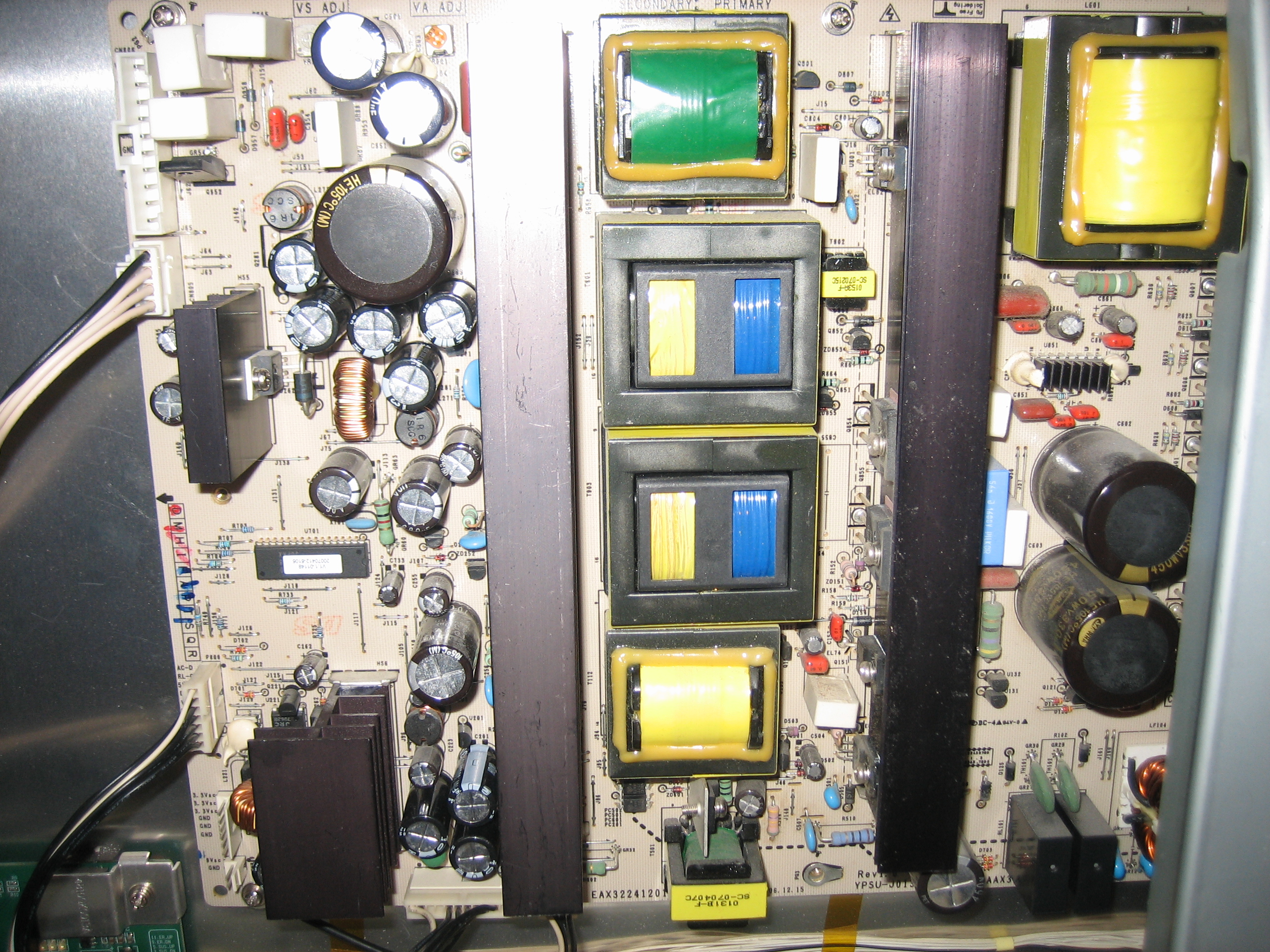

                    OK, here are a few pictures that may help. I currently have the power board still mounted, let me know if you need me to get a picture of the full board.
                      Very hard to see with these pics.
                      Need them clearer so we can see reference printing on the boards... so good high resolution with good focus.

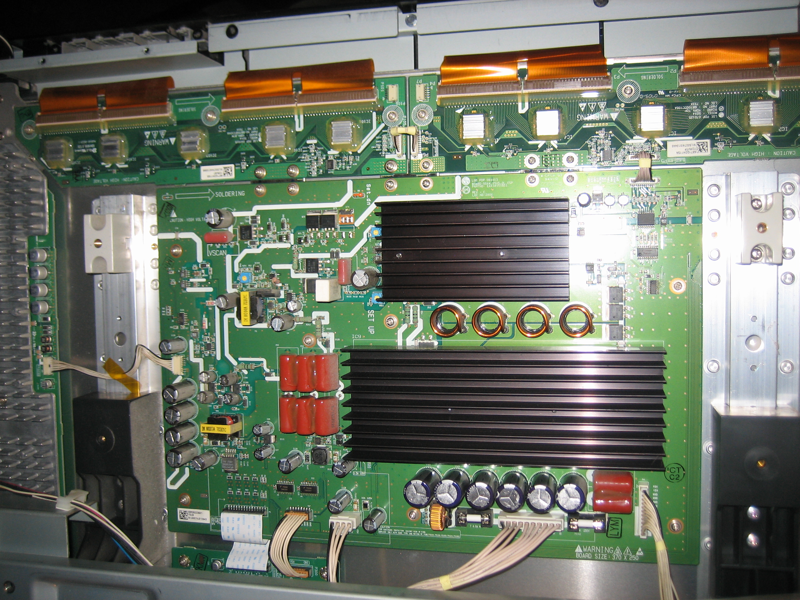

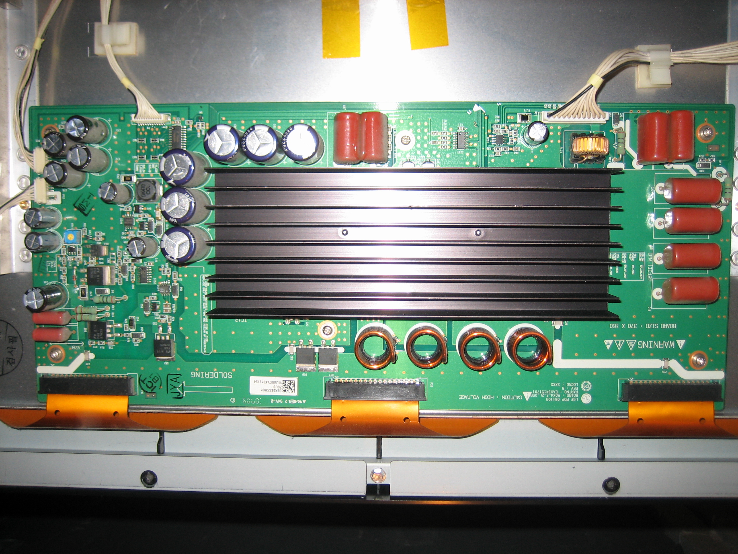

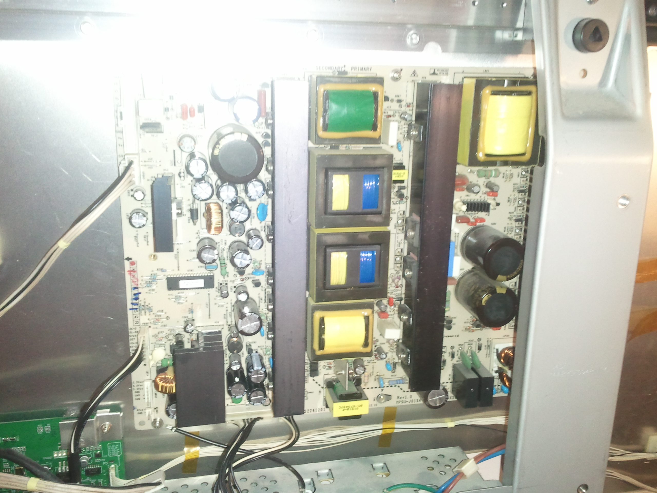

                            Here's pics of the Ysus, Zsus & the left portion of the power supply board (since it's still mounted in the TV).

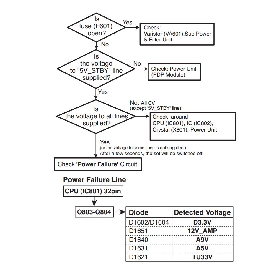

                              Thanks for the reference manual, it looks like I'm getting 5 volts at pin 32 and nothing at pin 36 (if I'm reading that right that I'm supposed to be testing 36 too).
                                  OK, I tested all of the points that were referred to in that manual you sent me, and the only 2 things that didn't come back correct were the pin 36 on the IC801 CPU (pin 32 was correct, and I'm not sure if I was supposed to get a reading on pin 36) and also the D1621 on IC1620 is coming back at about 7 volts (instead of 33v). These were all tests on the Power Failure Circuit page. I did notice that there was no chip in the D1683 spot (on K8B at 12V) but I did measure the little solder pad that was in its place and got about 5 volts (the manual said I should be getting 12V).
                                  I believe I'm testing these right...black lead on ground and red lead on the chip's solder point, like D1621.
                                      Can you take some close up pics of all the connectors on the PSU so i can see the reference labels next to them please
