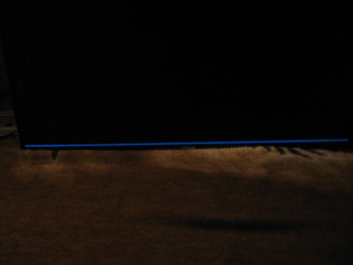

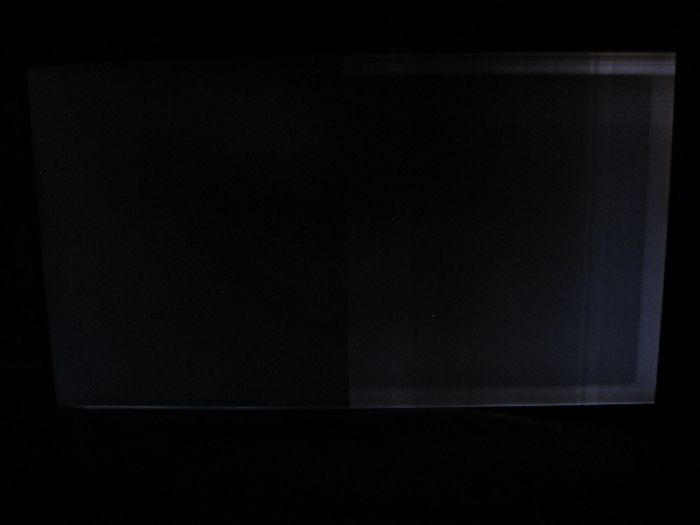

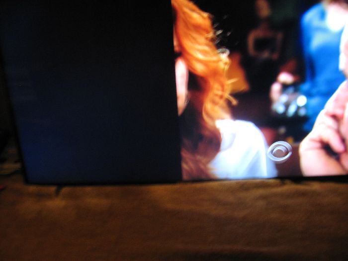

    Samsung UN46d6400 Tcon/Display
    The display pulsates a line on the bottom of the display when turned on.
    I can sometimes see some picture in the pulses
    I get perfect sound and right half of the picture if I unplug the ribbon
    cable from T-con to the left half of the display.

      Re: Samsung UN46d6400 Tcon/Display
      Bad side plugged in good side unplugged = pulsating picture brighter on good side may upload pic if that would help

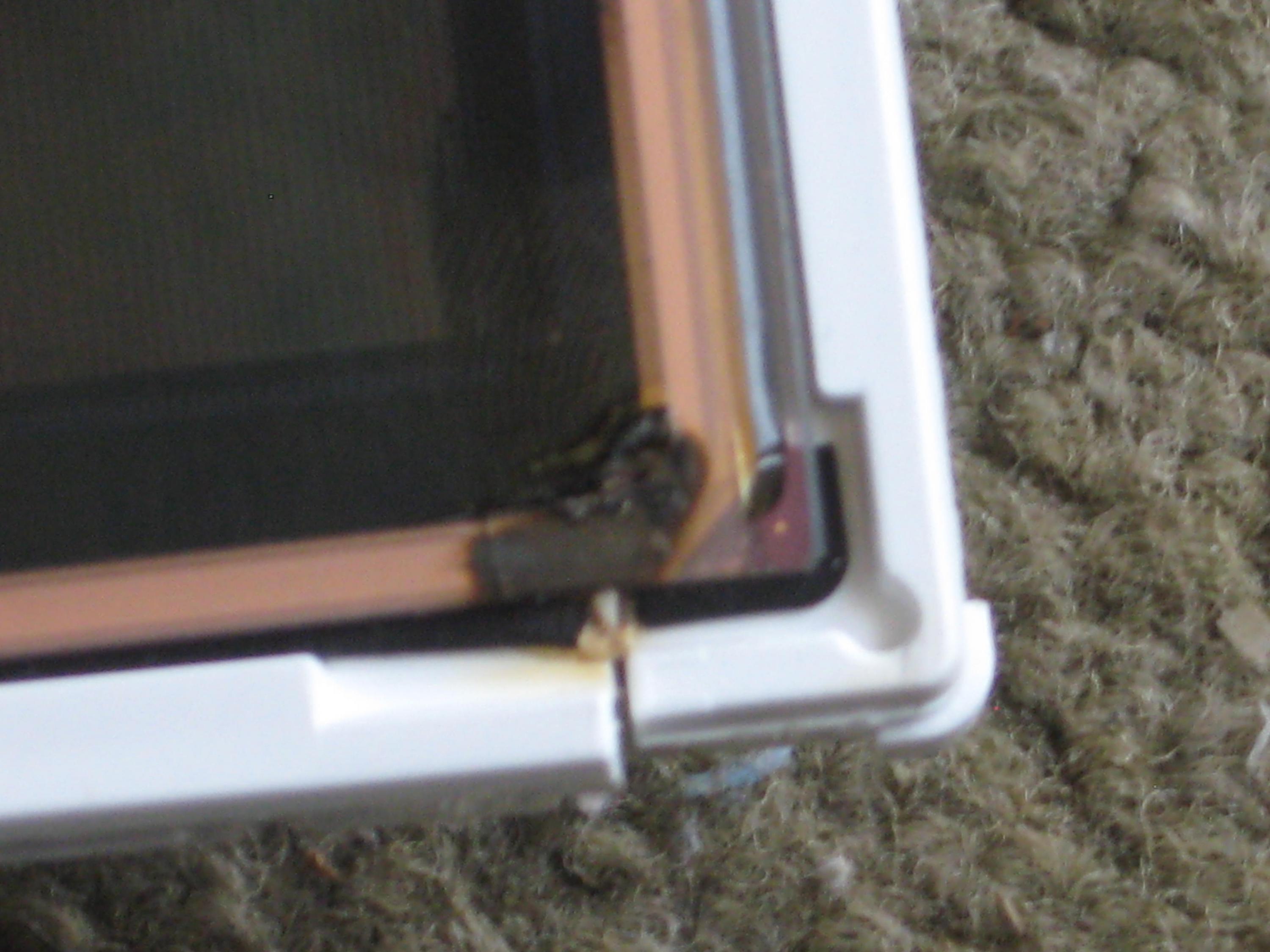

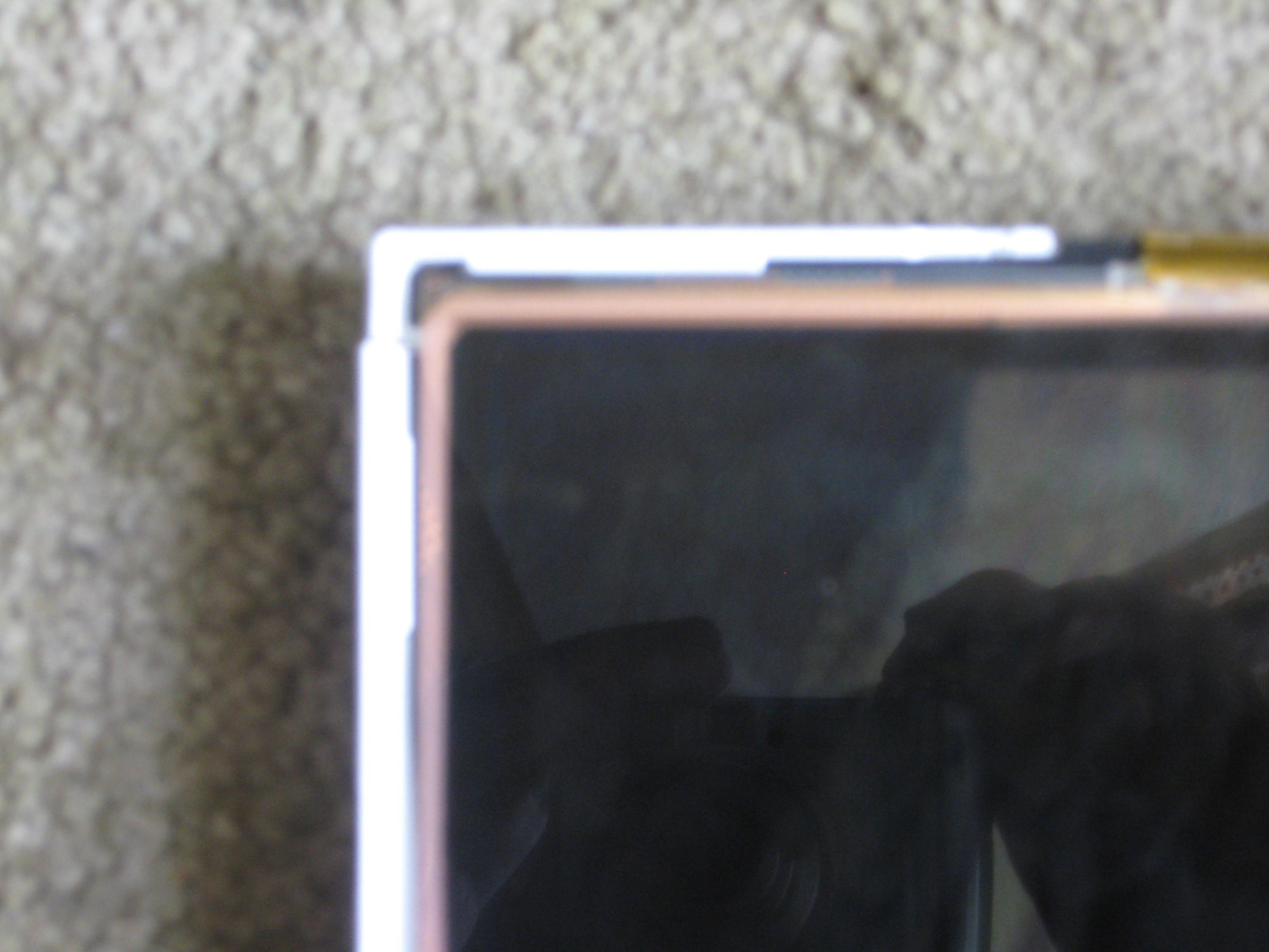

                      Update Info Swap T-Con Same problem
                      Tv = Junk
                      Took Panel frame apart and found the problem
                      Burned Panel Wires on bad side (see pics) not the best quality pics But I show you the Good side of the Screen Versus The Bad Side
                      Every Samsung tv I work on have bad panels and I tell my customers
                      to never buy Samsung
                      I have had good luck with my Sharp Brand Tv's and wonder if anyone
                      else finds them to be a better Quality Or Not
                          Wow that one actually shorted to melt!
