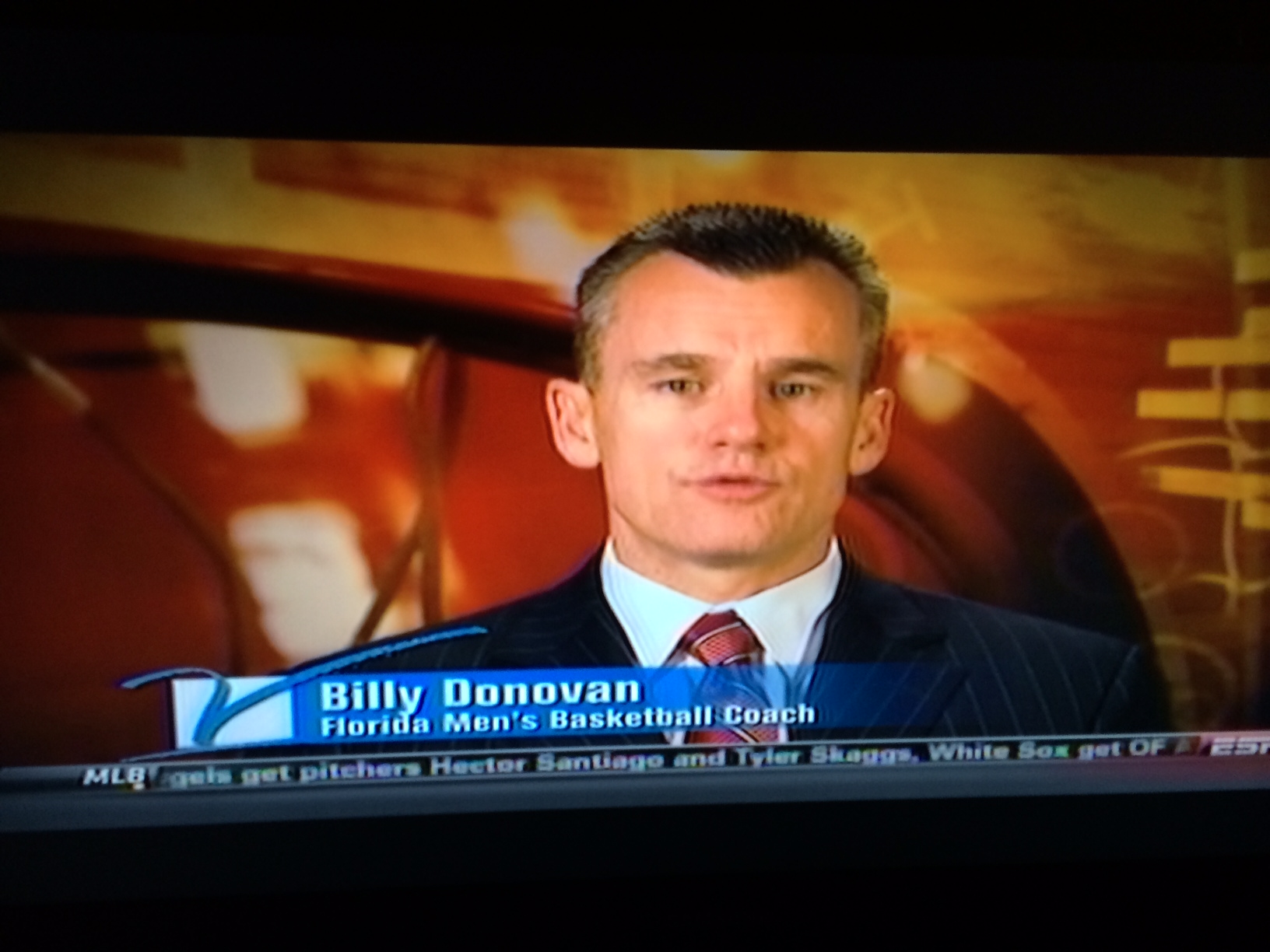

    samsung LN40A530P1FXZA Solarized distorted pic
    My Daughter bought this tv 4 yrs ago and this problem has come up, We bought her a new tv for xmas but i cant seem to bring myself to throw this one away as i could use it,
    ive done a little research and they seem to point towards the main board or the t-con board so i was gonna replace the main board first but cant seem to find one. The part # on the main board is BN94-01868E,
    I guess my question is am i heading in the right direction and is there a different board that i can use in the tv.
    here is what the tv looks like
    Tim
    Re: samsung LN40A530P1FXZA Solarized distorted pic
    First I would try re-seating the cable between the main board and t-con board.
        Mr tom66
        I just unplugged and replugged the cable between the 2 boards and that seem to do the trick, is there some kind of silicone i should put on there or leave it alone?
        i feel kinda of silly it was that simple,
        But many thanks to you sir
        if your ever in my part of the country dinner is on me
        Here is a updated pic after unplugging and replugging the cables
        Tim

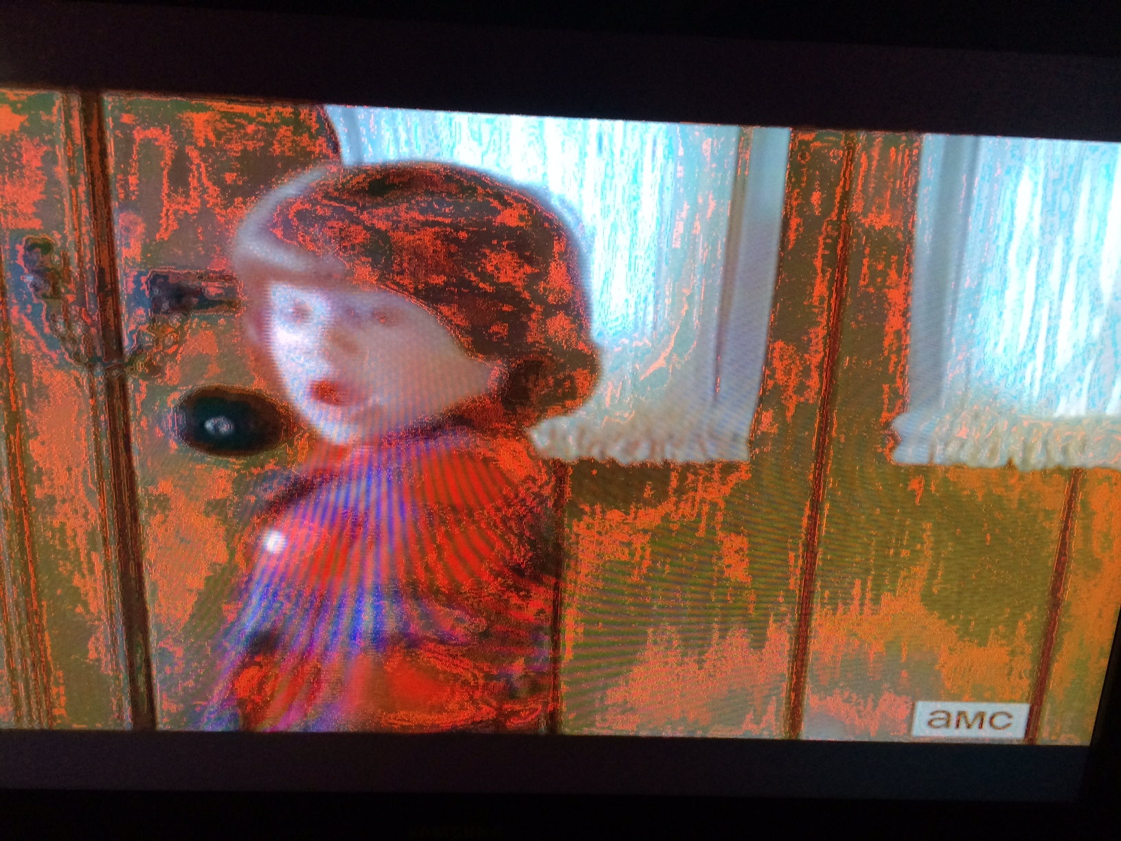

              I have same model tv with the same problem, tried reseating the cable and does not seem to do the trick. Tried all inputs, played with service menu, factory defaulted. However, ystrday for a second it came back to normal then quickly went back to solarized colors. Any help would be appreciated
              • mmartell
                • Oct 2013
                • 3189
                Appears to be a bad tcon due to a defective AS15 or AS19 ic, depending on which panel you have. The part is $5-10 if sourced in the US but replacement is not easy if you haven't done that type of work before.
                There are repair services for this on ebay. Type your tcon part number in and have a look. Good luck.

                      • CDGraves
                        • Apr 2013
                        • 21
                        I had the same solarization problem with a Samsung LN40A530P1F.
                        I got a new T-con board from a Chinese seller on ebay. Part number V400H1-C03. $44 including shipping.
                        That fixed the problem.
                        If there is abnormal color assignment with the new T-con. You can fix it in service mode. In the "Option Byte" menu, the "type" should be set to 37LC.
