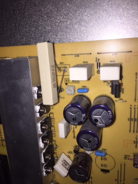

You used the wrong resistor, you need to use a pulse rated one.Last edited by tom66; 07-07-2014, 01:06 PM.Please do not PM me with questions! Questions via PM will not be answered. Post on the forums instead!
For service manual, schematic, boardview (board view), datasheet, cad - use our search.Comment
Re: Lg 60PK550 Problem
I don't understand
What is pulse rated?
What should I buy?
http://it.rs-online.com/web/p/resist...sante/1997703/
or
http://it.rs-online.com/web/p/resist...sante/6252437/
ThanksLast edited by rinoronie; 07-07-2014, 01:45 PM.Comment
I have a 60PK540 LG plasma that is doing the relay clicking thing too. I just checked the R929 resistor and it's bad. It has 5WJ10(ohm) and FU078WW printed on it. Does anyone know a source or equivalent for a replacement? I don't see anything on Digikey or Allied's site. ThanksComment
I have done a lot of reading about the problem of TV turning on and then turning off with the clicking relay etc. and in my case with LG60px950 and power supply EAY60968901, replacing R297 did the trick. As everyone else has stated, there are 3 ceramic resistors at that end of the board and I simply metered each of them while in place and on the board and two of them registered 10 ohms and the third measured "zero" which indicated an "open". Once you get that far, you will then realize that getting the exact replacement resistor is a bit of the problem here in the United States. So I went on Ebay and found some in the UK or China....both of which would have meant probably waiting about 2 weeks....not a good thing! On top of that there was no way to know for sure that this would be the 100% fix...so waiting for the part was not an option for me. I looked at the trace on the back of the circuit board carefully and realized that the three resistors were wired in series. While I normally would not recommend putting in a resistor with a higher rated wattage, in this case and since they were wired in series, putting in a 10 watt instead of a 5 watt would have no bearing because if there was a problem, one of the other two good resistors would presumably blow since they are wired in series. The 10 ohms matter however, is critical. As it turns out, Radio Shack sells a 10 watt 10 ohm ceramic AXIAL resistor in a 2 pack for $2.49. I wired one of these in place (a bit awkward because of the much bigger size of the resistor and also because it is axial type and not radial........see picture below and how I did it) and as luck would have it, that was the quick fix and that did the trick. So at least for now I know I have the problem licked and my TV is working perfectly. I still ordered the right part (5WJ10 ceramic resistor) but at least I am back in business while waiting for the right part to come in.
I had one of these come to me with the clicking/no start problem. I checked the 3 10 ohm resistors and sure as shit one was measuring 275 k ohms. When removed from board it measures open in continuity mode. I found one in my junk bucket, replaced it, and the tv is back to working order.Comment
