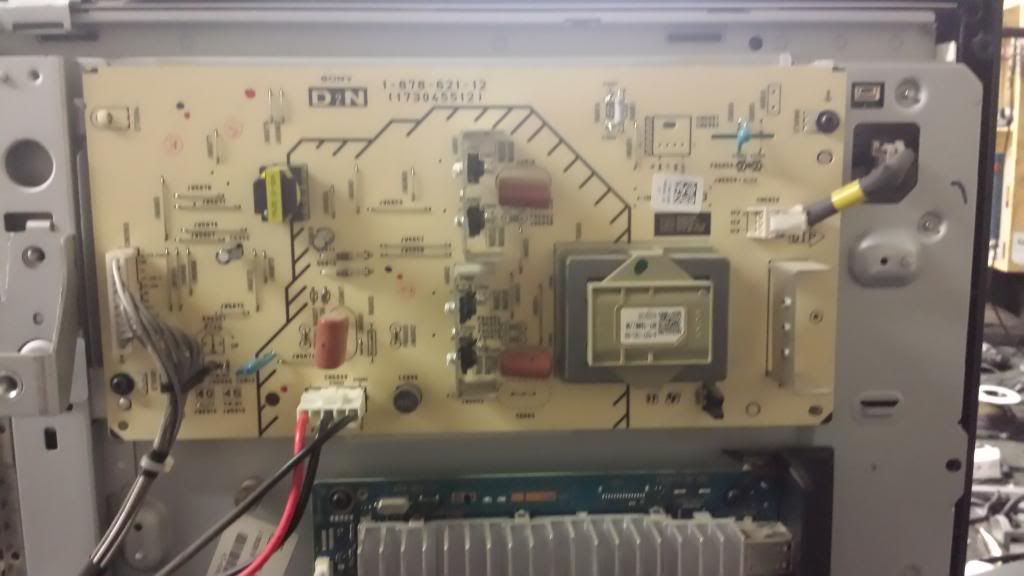

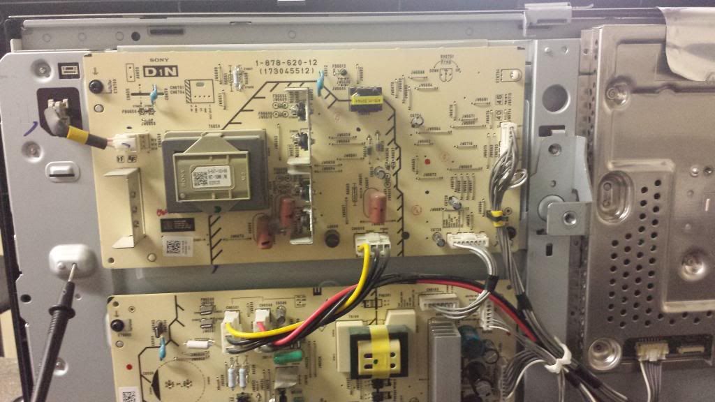

                  Re: sony kdl-40z5100 14 blinks
                  Also there is no voltage to backlight on no voltage to balancer error but there is 1.9v on inverter error. Groynded it and still same issue. Tcon is receiving 12v and there is bo power on the big wiires to the inverters. No 12v on the yellow wire or no pfc out 395v.
                    Scratch that. There is pfc and 12v going to the inverters. Had to use pfc ground to measure. Thinking bad mainboard

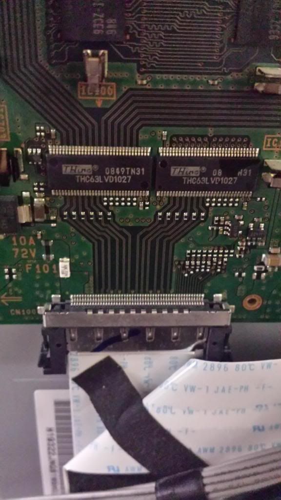

                        okay I figured it out I took a heat gun and started heating up the t-con board TV immediately came on perfect picture now I just have to figure out what are the t-con board is bad most likely a capacitor
                          Holy cow, that is one big T-CON board with about 9 switching power supplies on board. I would try heating those two Lytics SMD on the left side first. I am not sure how good your meter with frequency counter function, you can try to see what you read right at the tow legs of each caps.
                            Yea it is.
                            Well here's where the problem in lies.
                            The left ic has to be heated for it to turn on. These pick up off the lvds cable on the tcon.
                            http://i845.photobucket.com/albums/a...ps5077d5bd.jpg

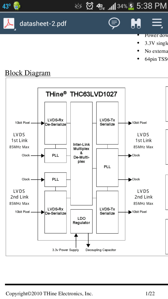

                                Here they are. They are lvds repeaters.
                                https://www.thine.co.jp/en/products/...63LVD1027.html
                                • freakaftr8
                                  • Oct 2012
                                  • 3743
                                  Looks to have a ldo regulator and the decoupling cap I have a feeling is bad.
                                  http://i845.photobucket.com/albums/a...ps99d43610.png
                                    Well the decoupling cap is good. Here is a close up of the ic pinout. Im getting good vdd. Im thinking it would be cheaper to replace the tcon than repair it.
