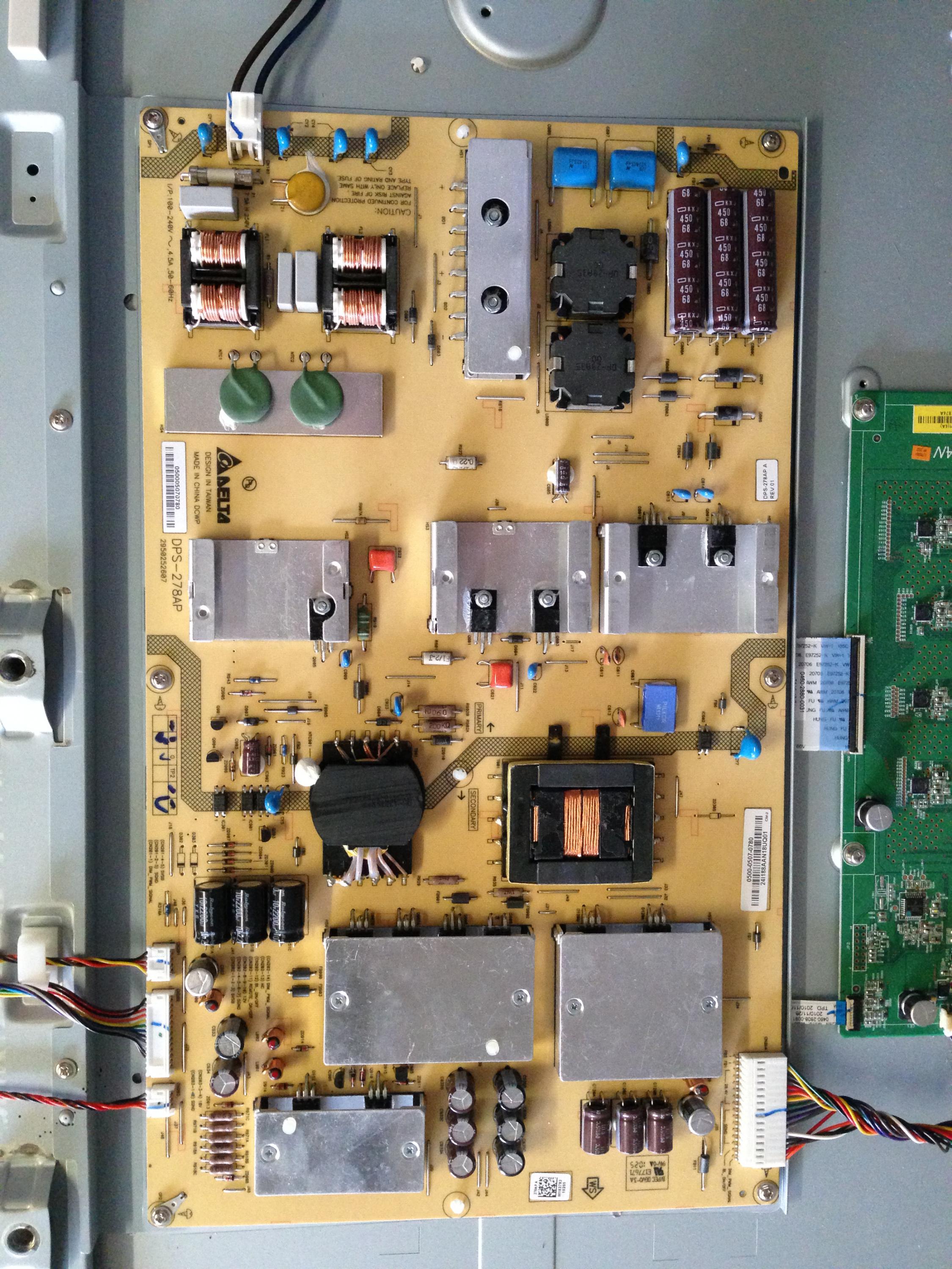

    Hello everyone. I have had this TV for a few years and it has given me a lot of trouble. It has been replaced by the factory once while under warranty and then a year after it was replaced that unit went black. I had a company repair the TV. They installed a new main board and I think the T-con. Now it has gone black again. It stays in the standby mode and will not fully power up. The little vizio light on the front stays an amber color and pulse's to a dim amber after hitting the power switch. It should light up bright white. Does anyone have any ideas for me. Thanks in advance.

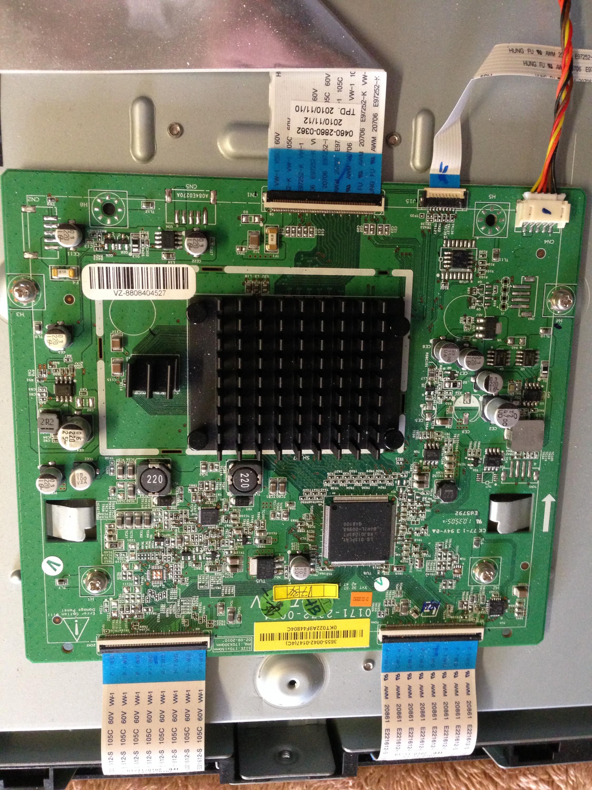

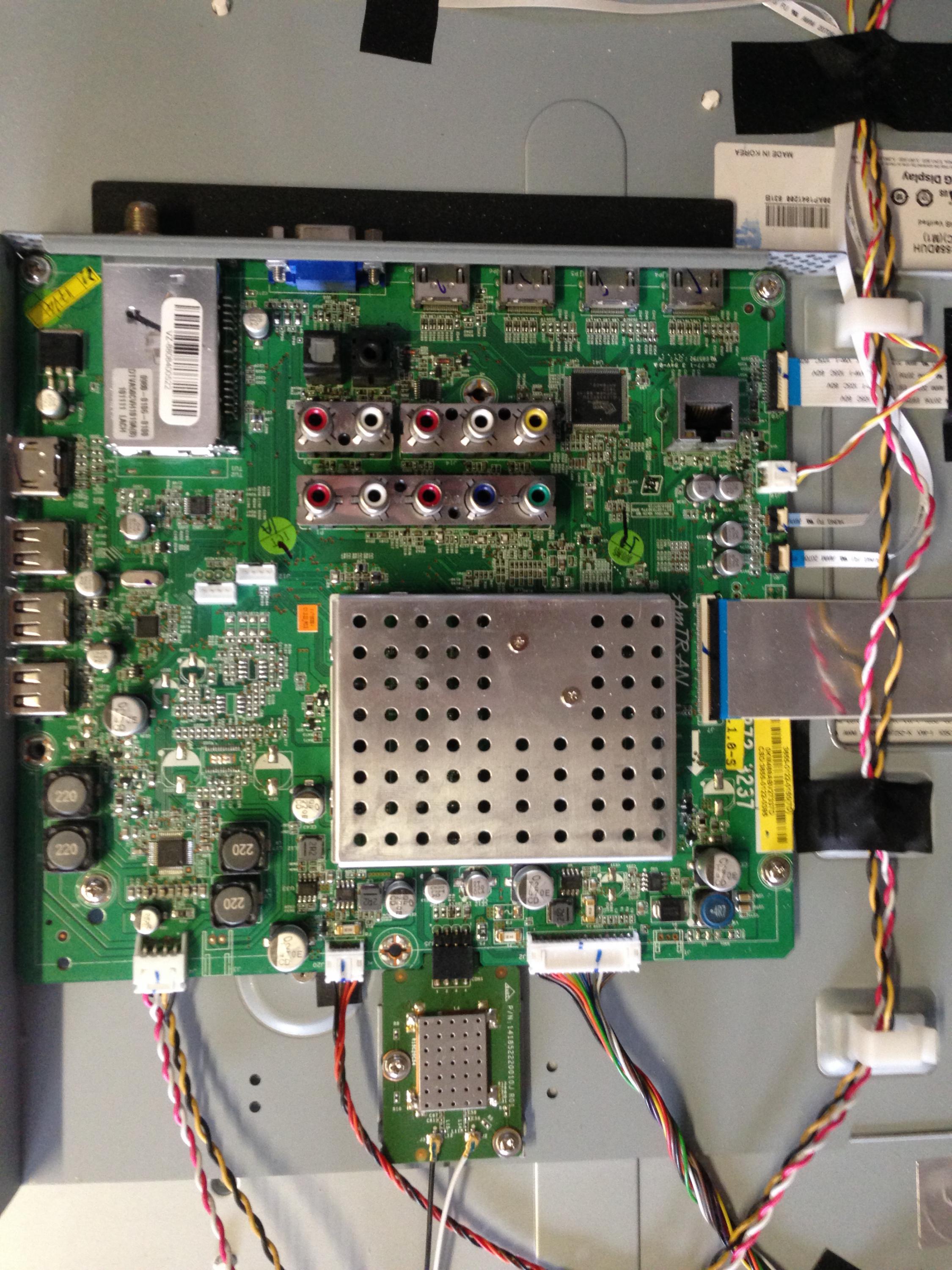

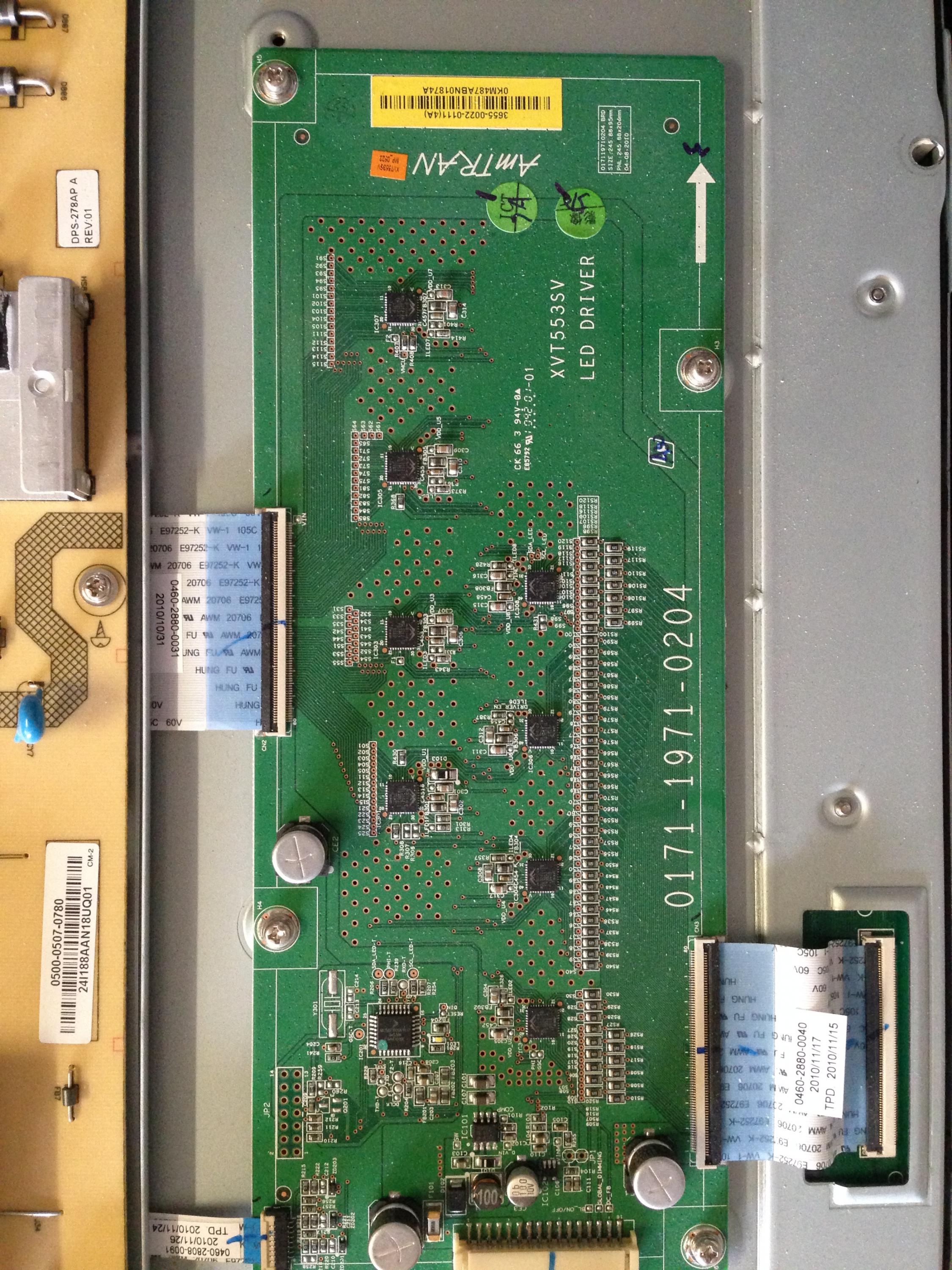

    Open the tv up and take pictures of each board individually, one up close of each connector on the power supply board so we can see any markings and one of the entire back of the set.
    Do you own a multimeter?

      I do own a multi meter. I have also attached the photos. Thank you.

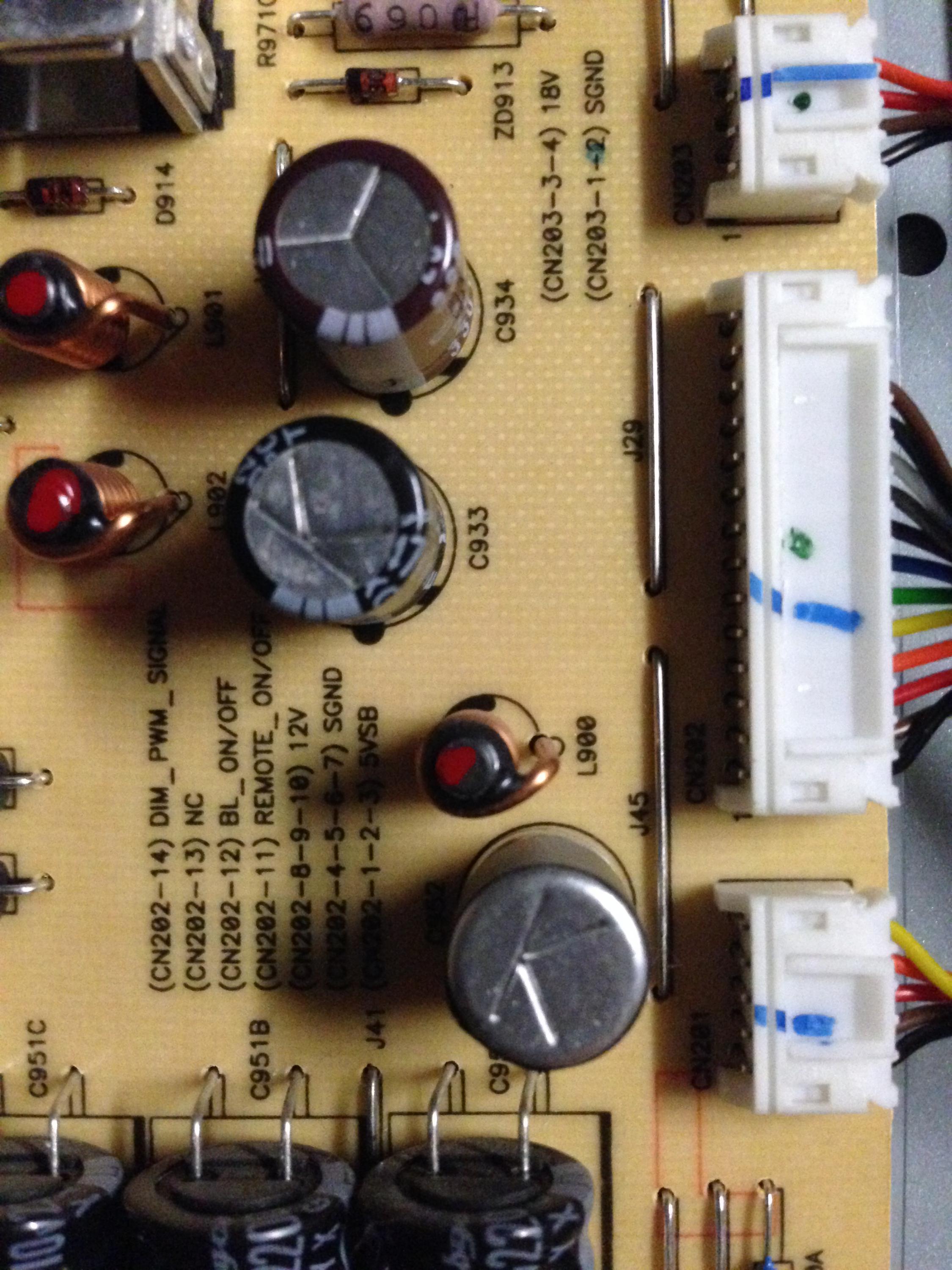

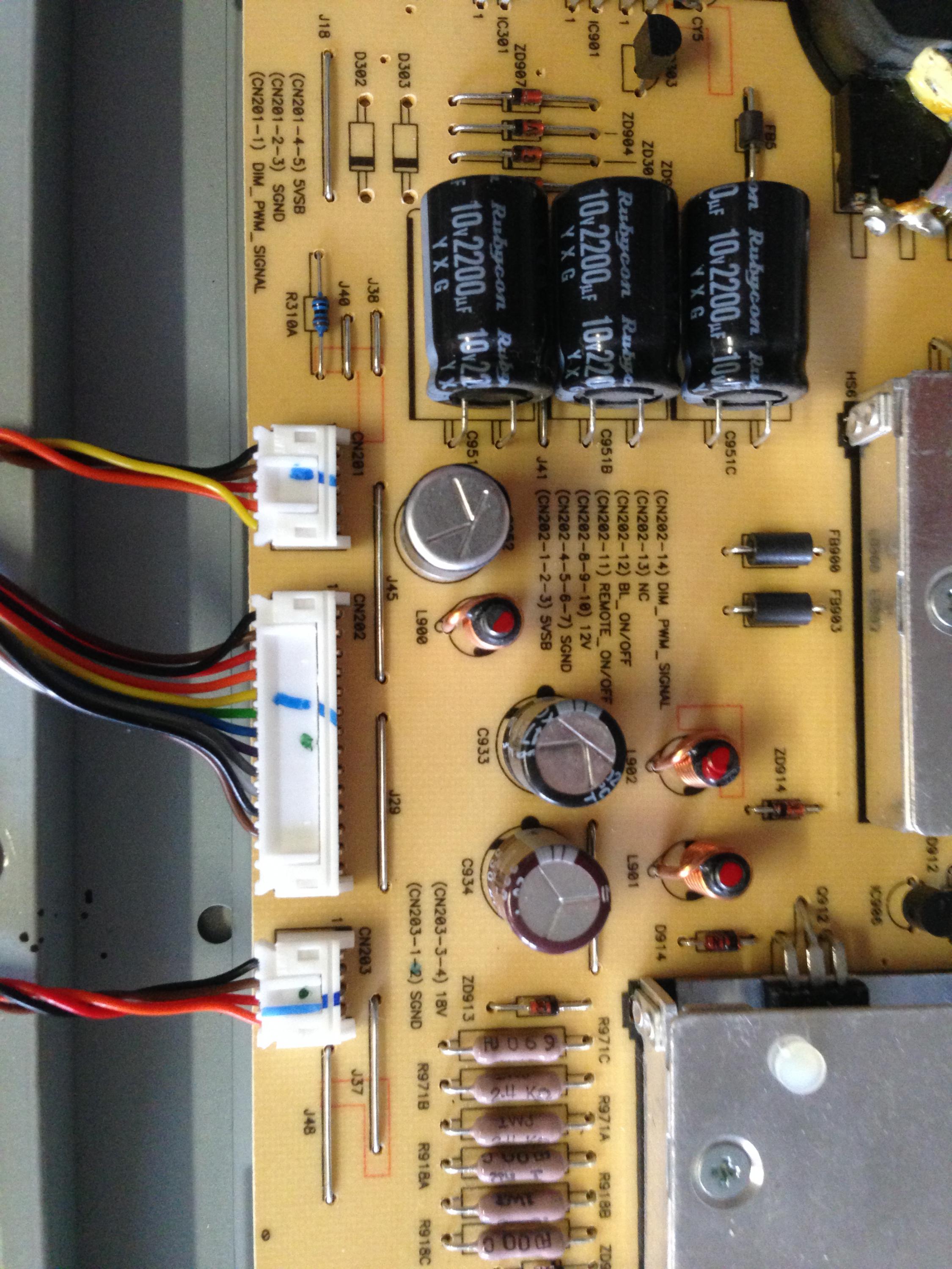

        Connector CN202... DMM set to 20VDC, Red probe into the 3rd wire (red, PIN 3) connection (just push into top of connector where wire goes) and black probe to chassis (screw hole is good)
        Reading before and after you try powering up the set?

          It reads 5.17v before and after the switch is pressed.

            CN201, Same as before on pin 1, 4 and 5

              The readings were the same for before and after pressing the power switch.
              Pin 1: 2.1v
              Pin 4: 5.17v
              Pin 5: 5.17v

                      Can you take a closer picture of the connector from the PSU to the mainboard please

                        Here is a closer pic
