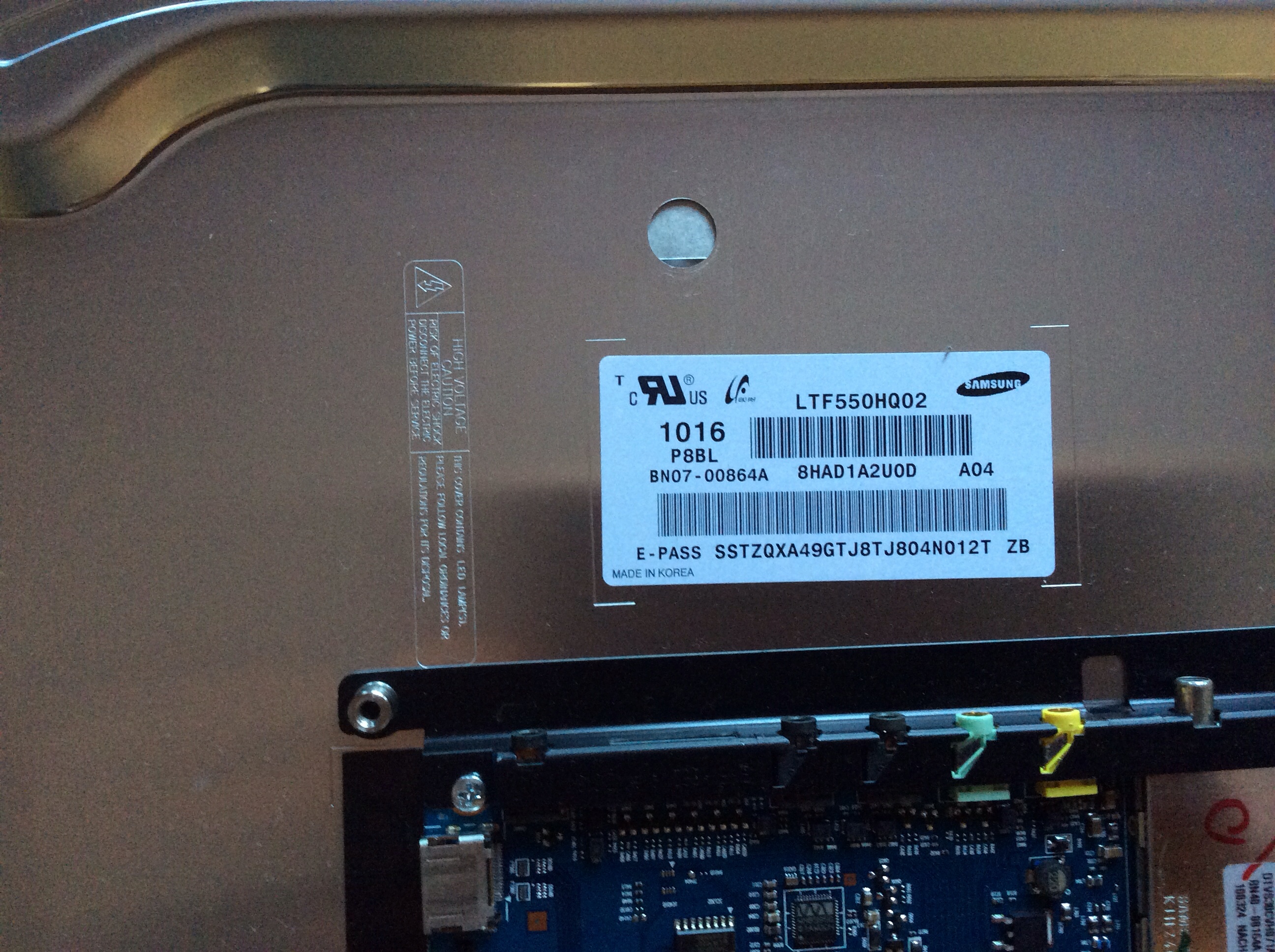

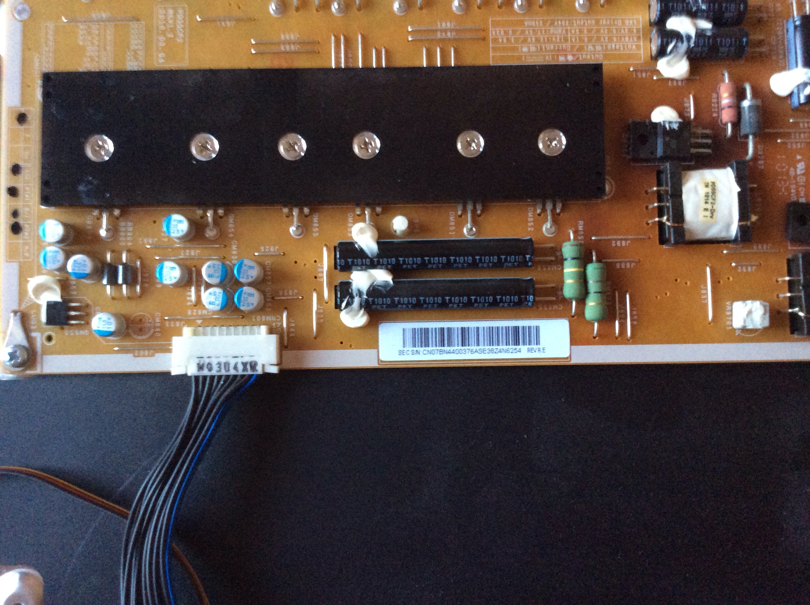

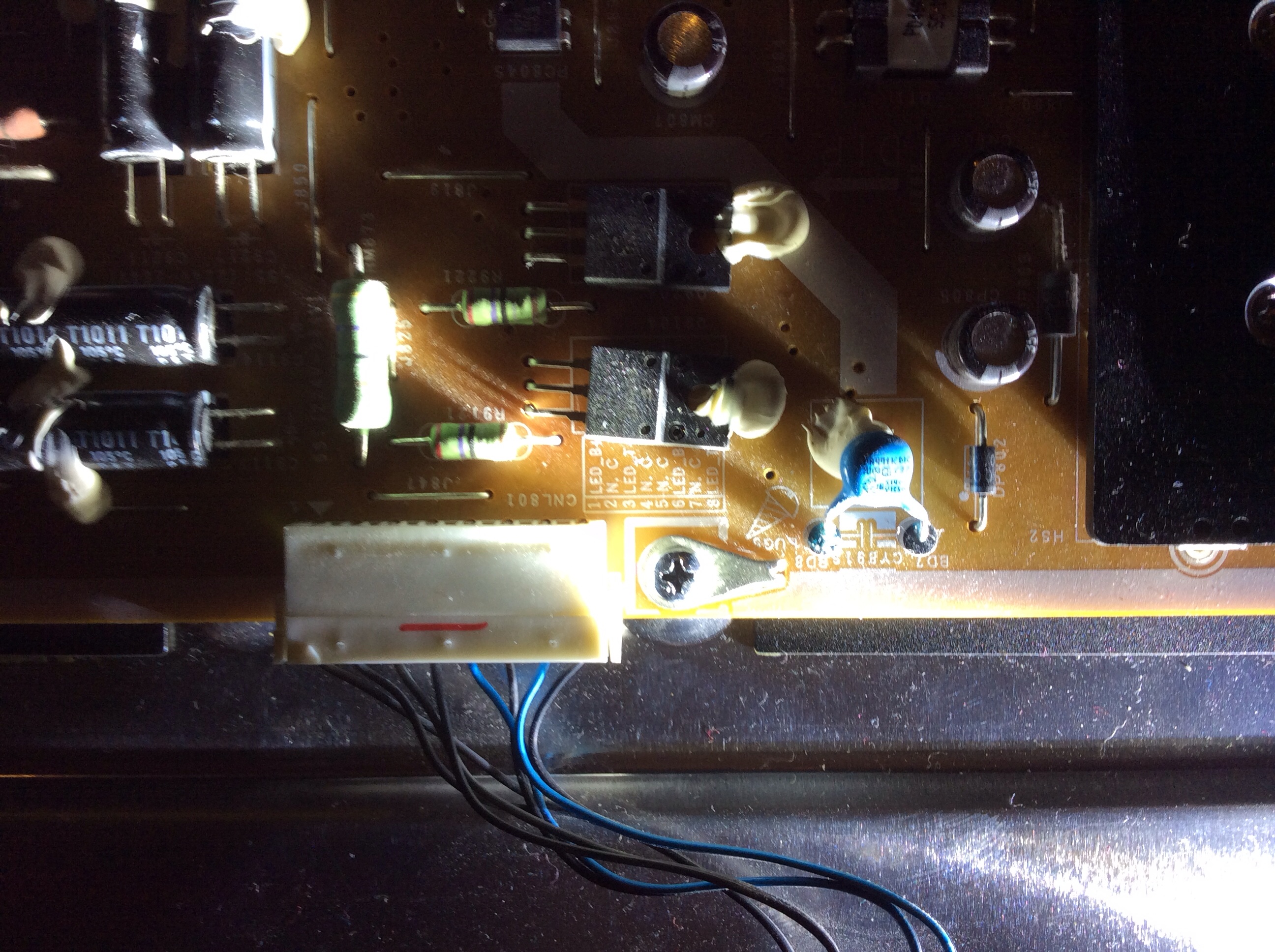

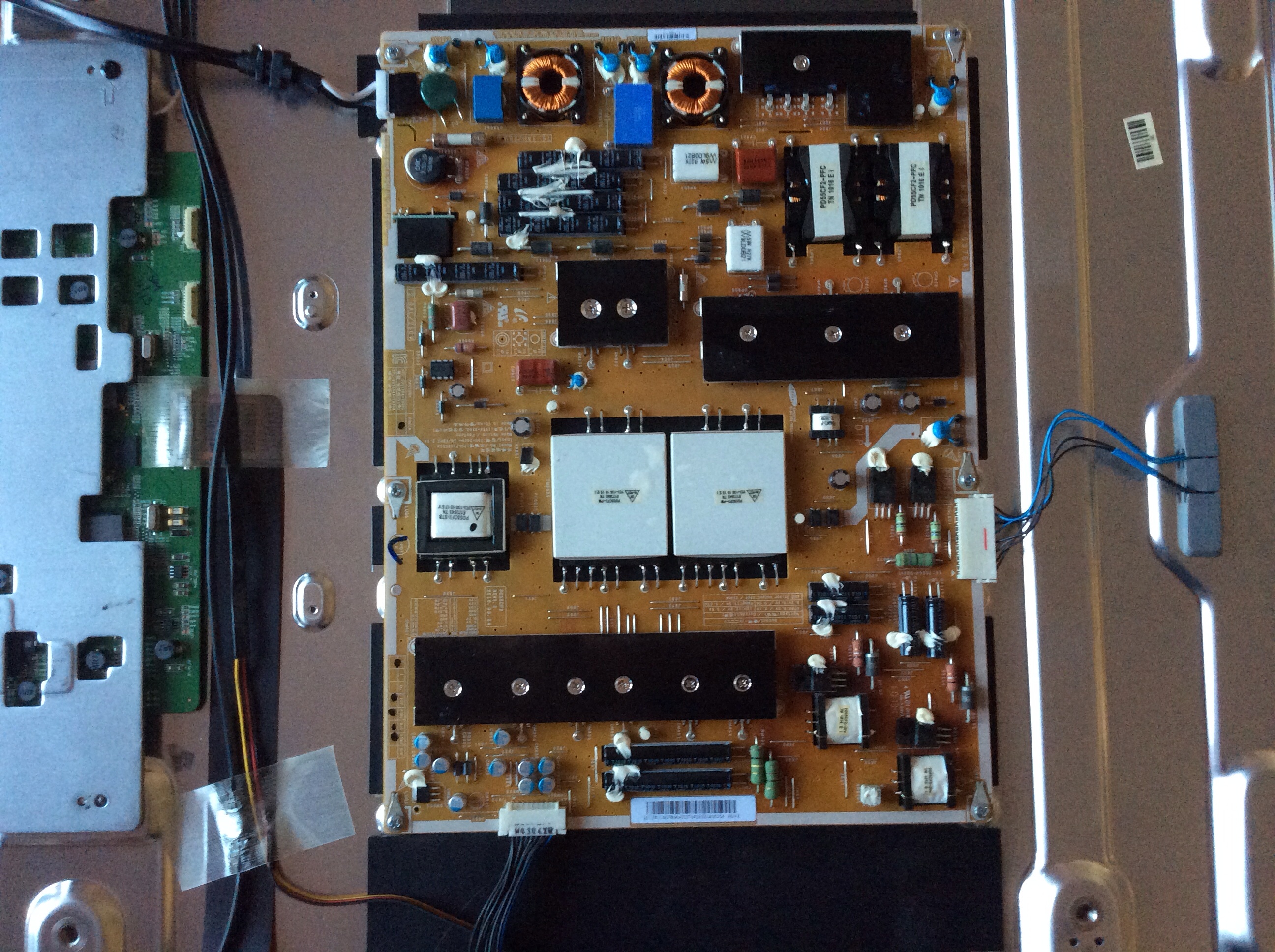

    Hello all,
    I am seeking your help diagnose my TV Samsung model UN55C7000WFXZA, the picture and sound working fine but without the backlight, I discounted the cable between main board and power supply the backlight didn't come!
    I think the problem is with power supply board, I searched in the database looking for PS diagram model BN44-0376A I couldn't find it.
    I am posting few pictures here to let you know the boards and appropriate your advise and help
    Thank you

    Another photo for TV part number
      Re: Samsung LED TV UN55C7000WFXZA no backlight sound is ok
      Picture of whole power board?

          Right hand connector going to the LEDs in the panel. Using multimeter, with black probe on chassis, and red probe on each pin, what do you see? (use 200V DC range.) Set should be switched on.
