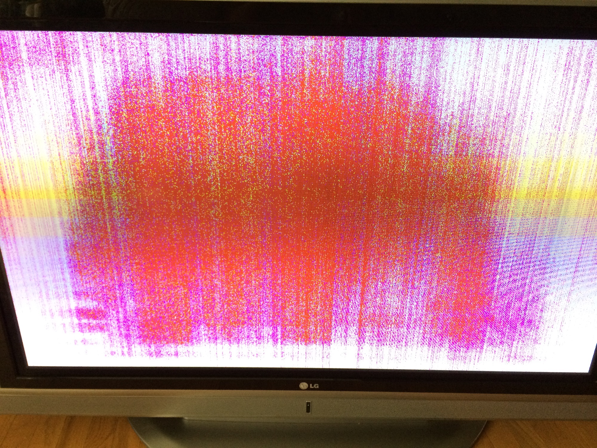

    Hey guys I just got this older LG plasma with those pesky IPMs. Once turned on there's a pinkish distortion but I can hear sound (this is on the TV input, see the photo).
    I noticed if I change the input the screen goes black except for a wide vertical bar on the screen. If I press any buttons (menu, volume up down) the bar would change positions or get wider.
    Opening up the TV I first expected a bad Y-sus or Z-sus. I found the usual one bad mosfet (FQB46N15) on the Y buffers. I gave it a shot just replacing it since I bought a bunch of extras from a previous repair. Put everything back on, plugged it in, expecting some smoke (or the mosfet to blow again) but turned it on and the TV is repaired and back normal!

    Nice. Yeah, that looked like a bad buffer to me. It seems like a shame to strip this perfectly working TV, but you have to do what's best for you.
