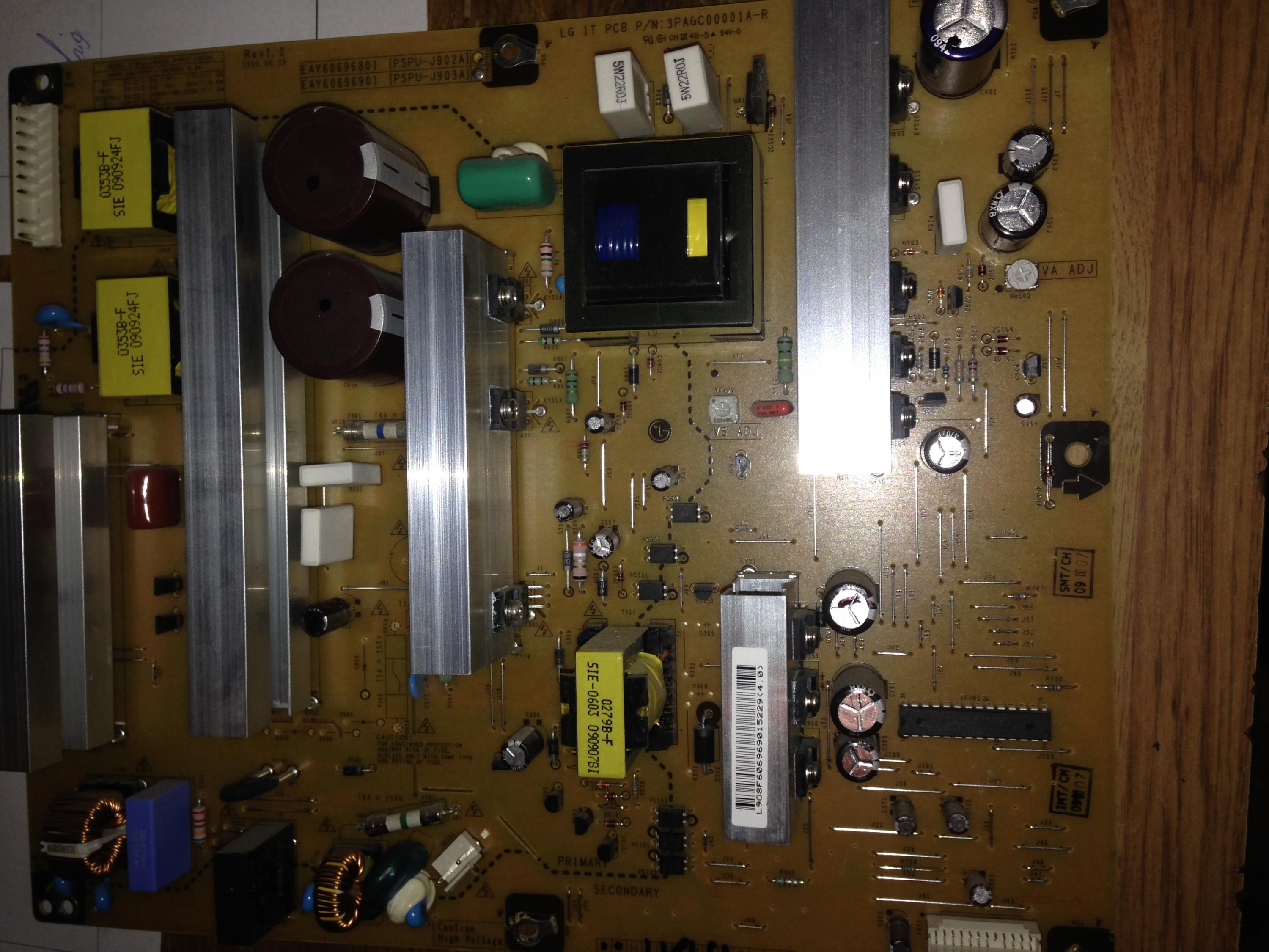

    Hi Everyone
    I have a LG 42PQ20 with no standby voltage, obviously a power supply problem, but i am having trouble narrowing it down , anyone have a similar issue with the power supply (3PAGC00001A-R)
    Ken

    Re: LG 42PQ20 No Standby Voltage
    Voltage at primary filter cap?
      Input fuse good? Pictures of board?
        Both fuses are ok.. here is a picture
          Whats the voltage at primary cap?
            Pretty common fault with these is IC301.
              Ok, im not seeing IC301 on the board
                Check on the heatsinks
                  Found it, Checked it and it is bad
                  any sources online to purchase?.
                      Ok I have replaced IC301 - STR-W6252. I have 2 more components that are short, R305, and ZD303, does anyone know the values of these 2 components
                        Resolved.
                        Replaced IC301, R305, ZD303, D305, C307.
                            check these components
                            F301
                            F302
                            IC301
                            R305
                            ZD303
                            D305
                            C307 (33u or 100 u)
