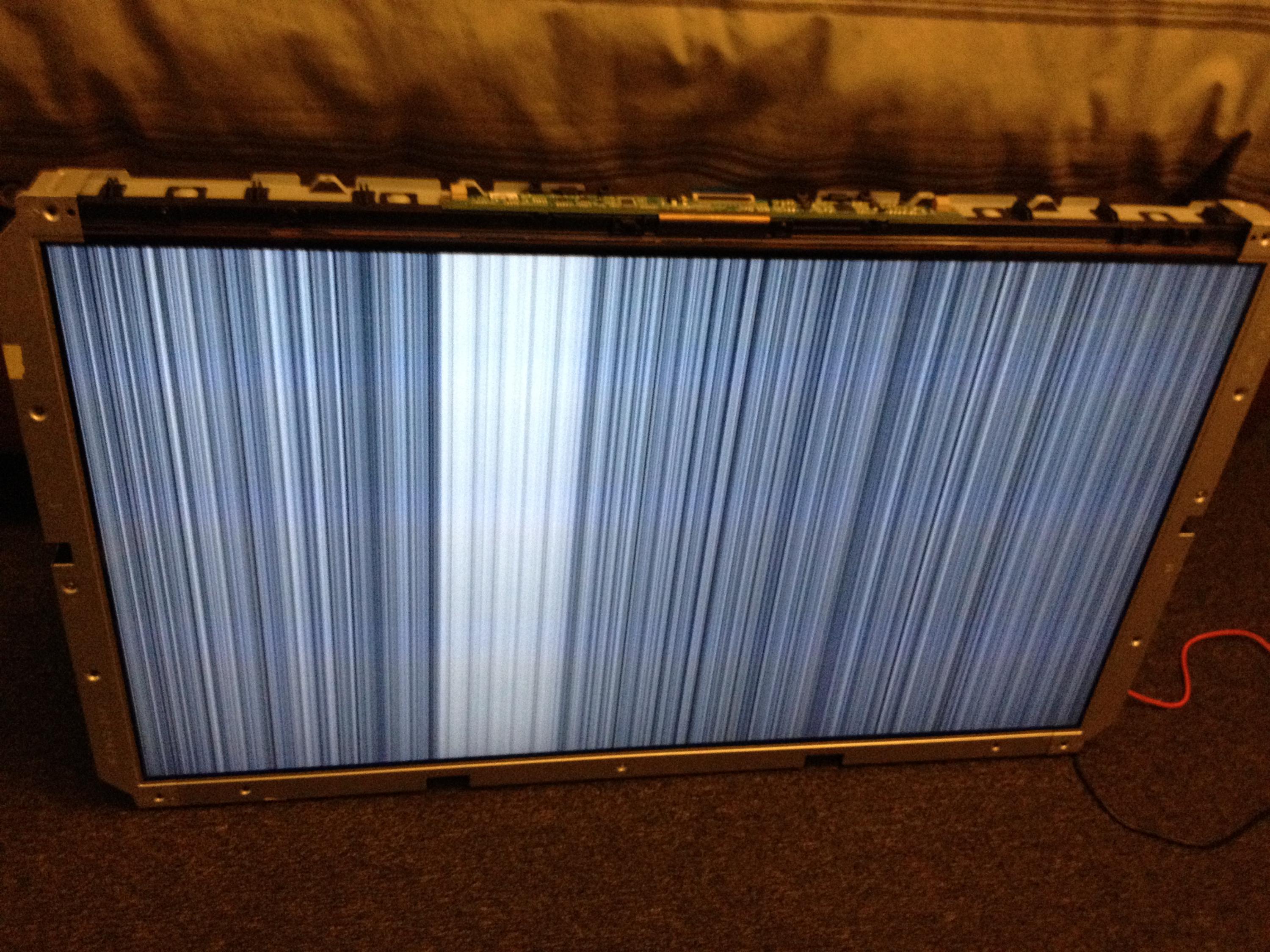

              Any good? Also, why can't I find more than one tab bond on this. Doesn't make sense there'd only be one for the entire panel
                Re: Samsung LN32D403E4D - Jumpy/Double Image
                Those look reasonable.
                I'm guessing it's an unrepairable fault.
                As for one bond, it's a new direction LCD TVs are going in. All the panel drivers (all 4,098 columns) fit into one bond now to save money.
                Previously I've seen as few as two, never just one until now.

                      I directly cooled the tab too and picture was only affected by cooling the transistor. Don't have a scope
                        #31
                        What happens to VOFF and VONE if you cool that transistor?
                          VOFF: -18.54 when sprayed and quickly goes up and stabilizes to -11.37
                          VONE: stays the same when sprayed at 27.6V
                          Voltage drop across the transistor from B to E is -0.6v
                          Also when the voltage at the base of that transistor drops to -6.67v is when picture is 85% better (when freeze sprayed)

                                        • ohmmy
                                          • Jan 2013
                                          • 182
                                          #40
                                          So I have no idea what happened, but now the picture is way worse!
                                          The gamma chip is super hot to the touch now but the measured voltages from it aren't all over the place, they give steady lows/highs
                                          If I cool that same npn transistor now, there's no affect. Here's a pic
