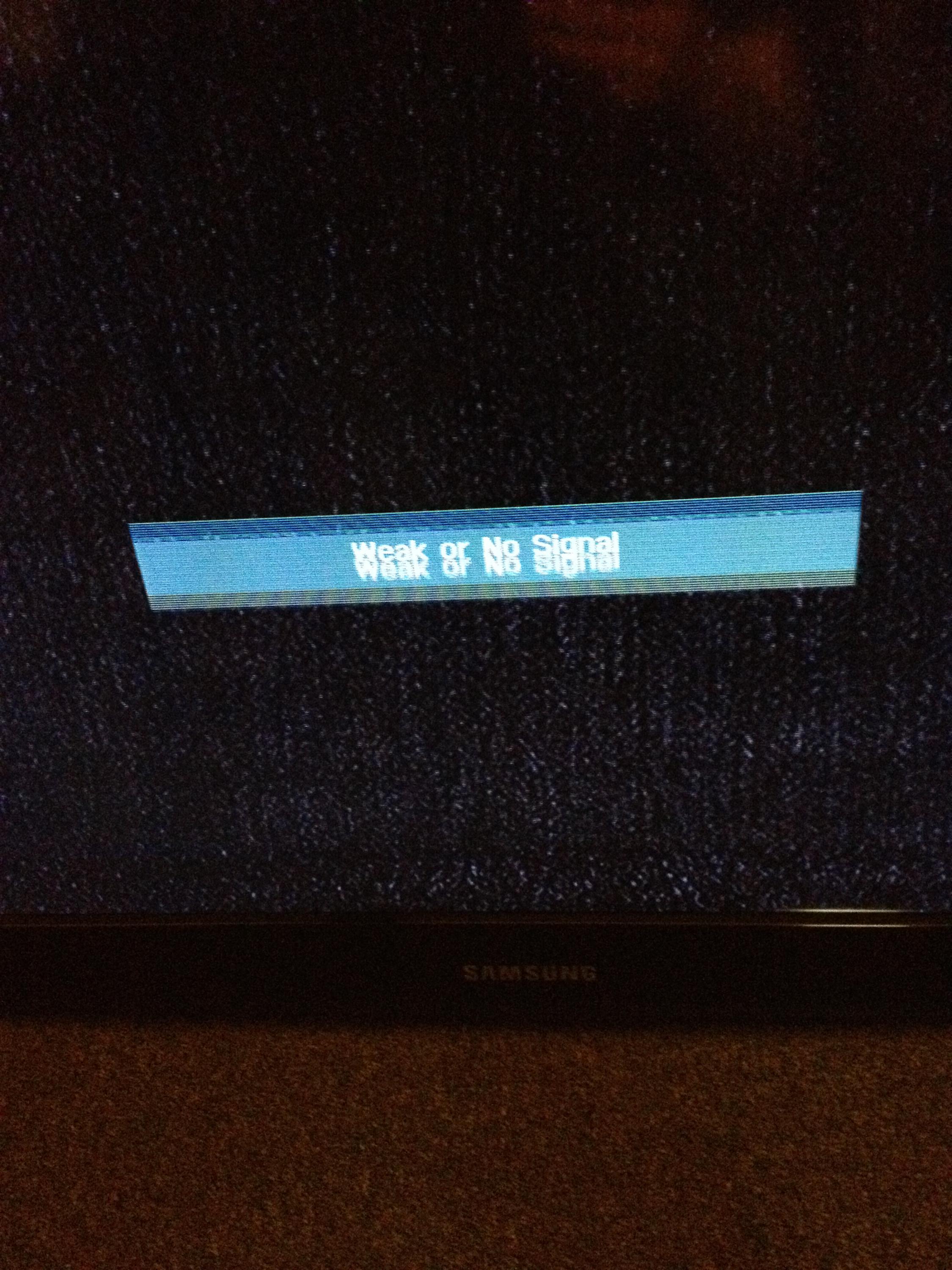

    Samsung LN32D403E4D - Jumpy/Double Image
    Haven't taken it apart yet, just wondering if it could be a panel problem just from the symptom.

          Re: Samsung LN32D403E4D - Jumpy/Double Image
          Is there a horizontal line in the picture and everything under that line is normal?
          • ohmmy
            • Jan 2013
            • 182
            No, any display is doubled. I just used the no signal picture to show the effect more clearly

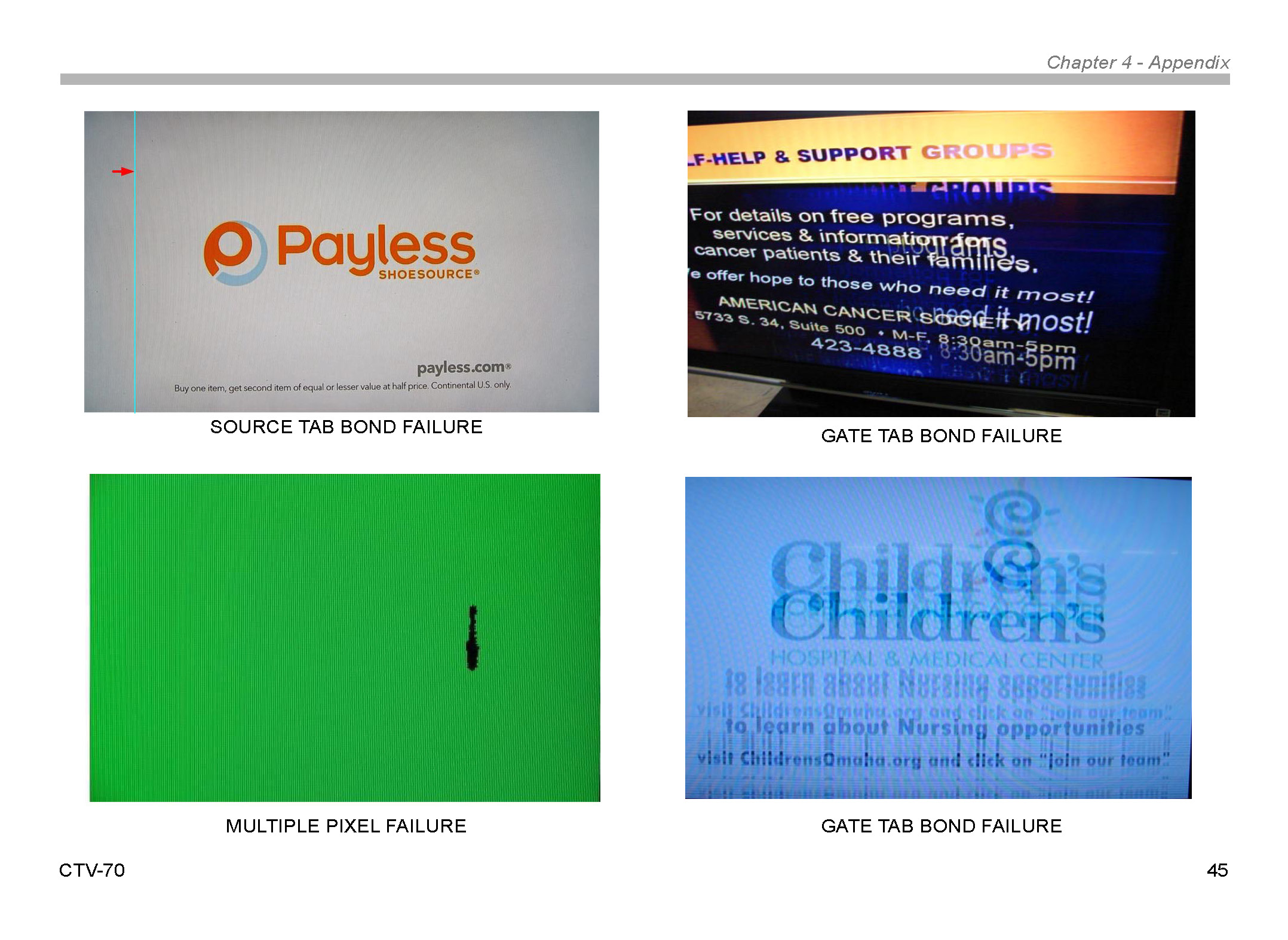

                  Bad tab bonding?
                  • ohmmy
                    • Jan 2013
                    • 182
                    The gate tab bond failure looks like my problem. Is that fixable?
                    • ohmmy
                      • Jan 2013
                      • 182
                      What are the differences in tab bonds?
                        Which document is that image from Budm?
                          From Sony T-CON training manual.
                            Useful, will keep that for future reference. Thanks.

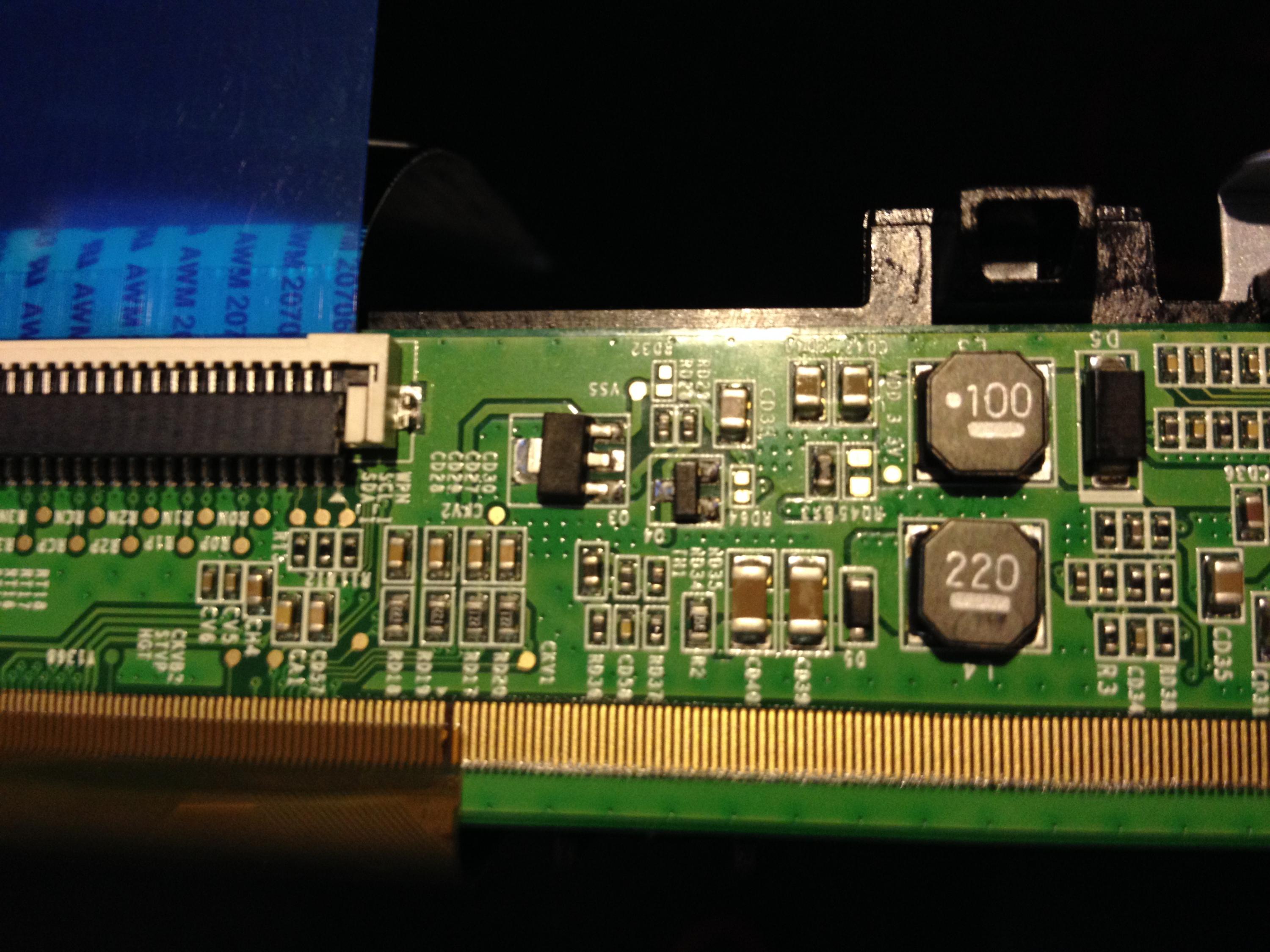

                              Took panel apart, and this one is unusual. Tcon is on bottom of the screen and there's only one tab bond going to the panel. Did not see any others along the edges or top of display
                              • ohmmy
                                • Jan 2013
                                • 182
                                So I sprayed some freeze on the t-con and noticed when I hit a small ic that looks like a regulator labeled 03 in the picture I provided, the split/double image attempted to re-join but quickly spread back out as freeze dissipated.
                                I measured the voltage on the far right pin and it was a steady 7.43v even when the ic was sprayed.
                                The pin in the middle and back tab were 0v (guessing ground) and the tab on the left measured 8v but after being sprayed dropped to around 6.68v and slowly climbed back up which is when the image was completely doubled.
                                The only marking on the ic itself is "N2"
                                Could it be bad?
                                  Is the VSS test point what you are measuring? SAMSUNG panel?
                                  • ohmmy
                                    • Jan 2013
                                    • 182
                                    Yes its a Samsung panel and the VSS point is the 7.43v reading
                                    • ohmmy
                                      • Jan 2013
                                      • 182
                                      I went ahead and replaced that ic with an adjustable 1117 regulator out of curiousity as the original one seemed to be a smaller regulator.
                                      Same result with double image and voltage outputs as well as same thing happens when I spray it, picture tries to rejoin
                                        Think this is the device
                                        If it's working, and conducting, voltage between B-E (outer two pins) should be approx 0.7V.
                                        ...and it's not a 1117; replacing it with one may cause damage...
                                        Is VSS definitely positive? I suppose it could be what SAMSUNG call VCOM. It would not cause jumpy image.
                                        Jumpy image could perhaps be caused by VGH/VON or VGL/VOFF going bad.
