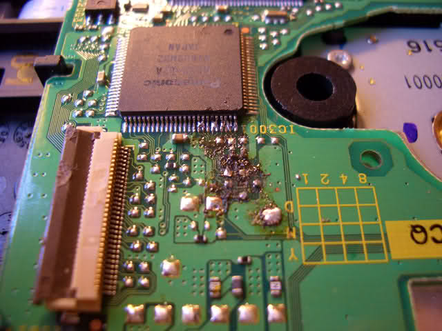

    Here is one I got from the net wow...

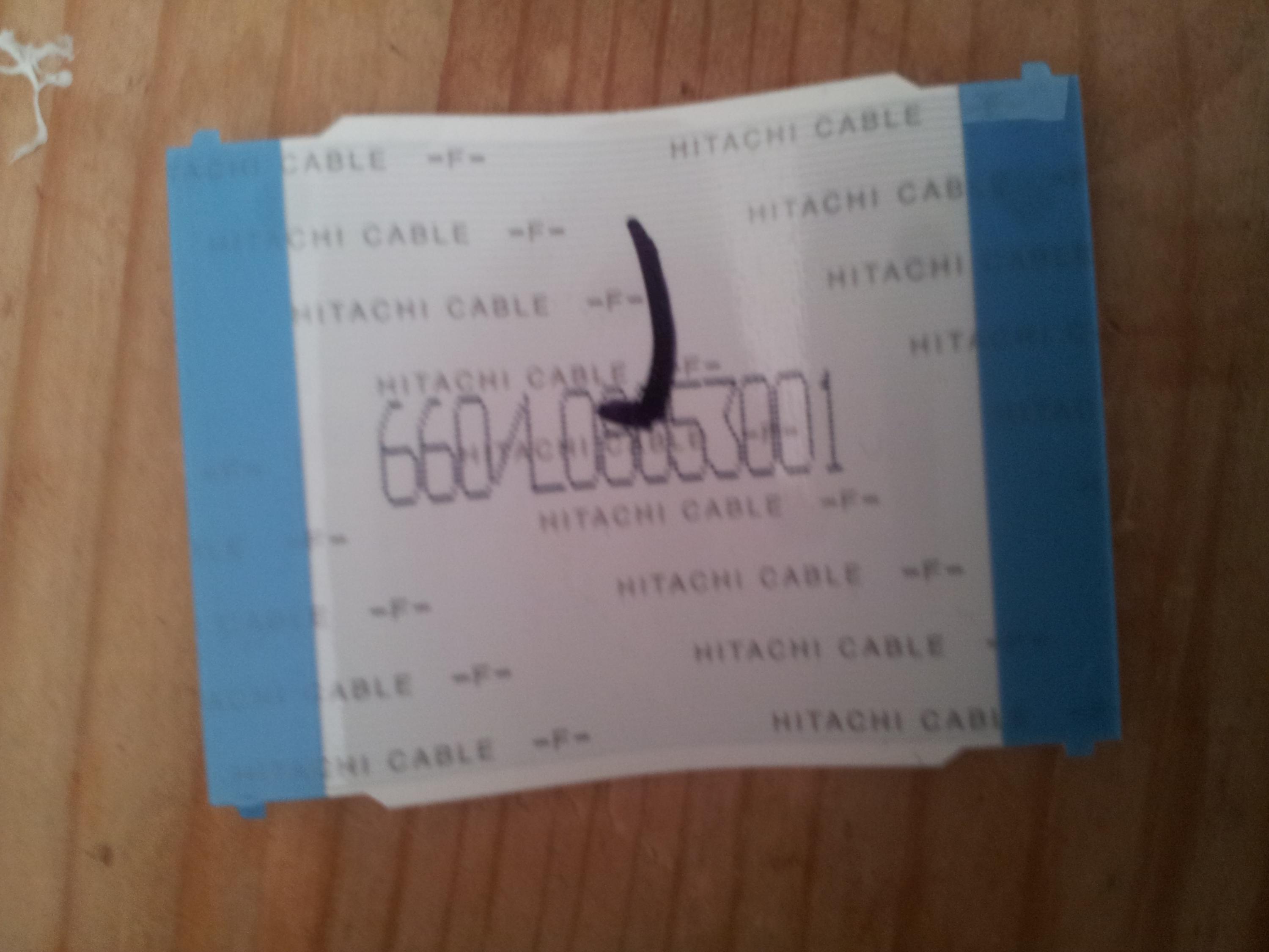

      TV is now (mostly) working with a new power board kindly provided by another member on here - that power board had the common 10 blinks fault which was the original fault with this TV although with different causes (the cause on the original being of course the complete fuck-up of a job the original guy did, which damaged who-knows-how-many parts...) After repairing that power board the TV now powers on OK. However I accidentally damaged one of the ribbons going from the D board to the C boards, so I need to replace that. Anyway, it's MOSTLY working now . It's been in my room for 3 month+ so I want to get it out of here... as nice as it is!

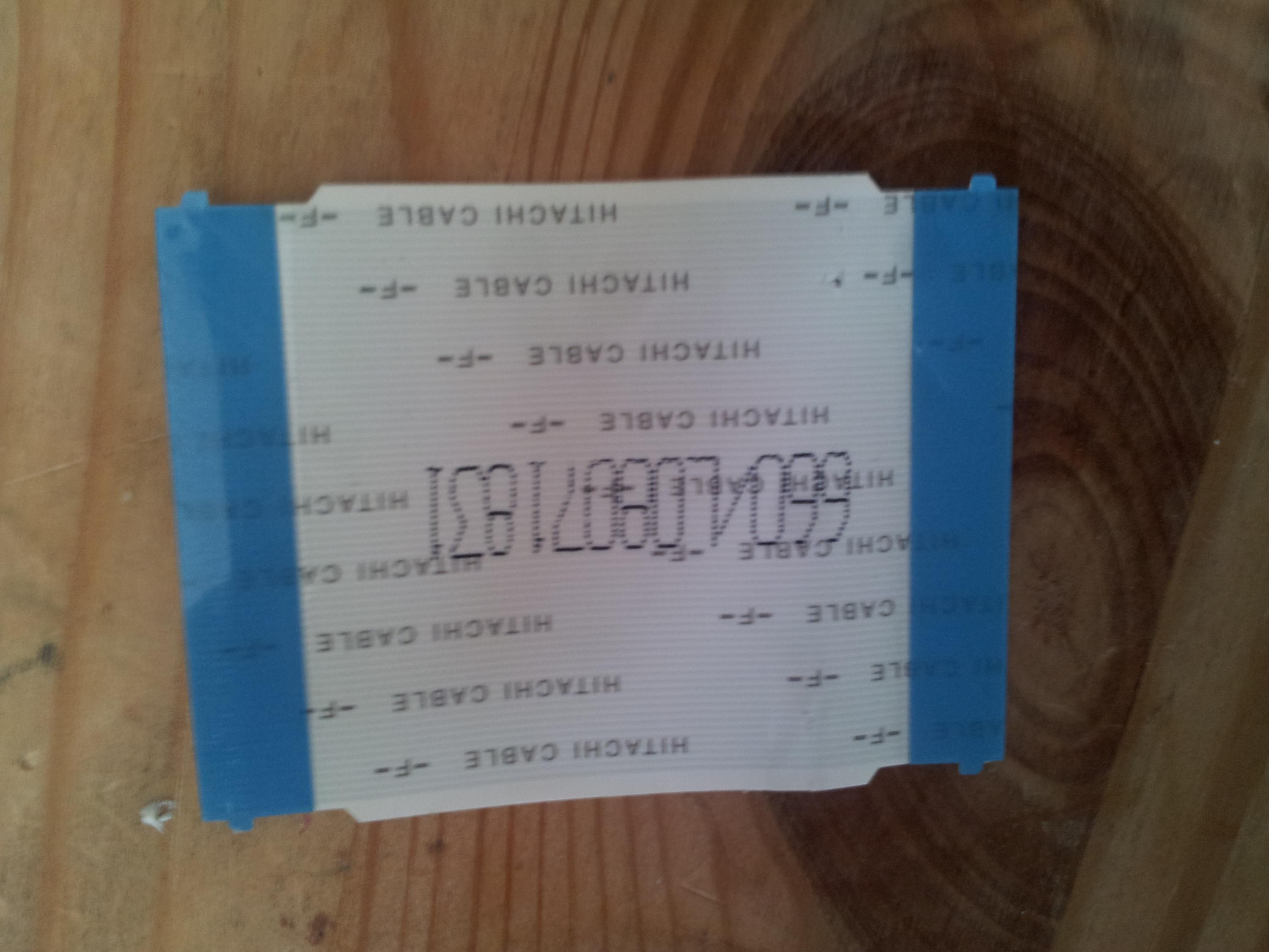

          TV now lives thanks to sordids999 who kindly sent me a faulty power board (10blinks fault), which has now been repaired, plus some spare ribbons from him too.
          A long success story, after 3 months!
          Photo shows bad ribbon with hole in it due to my error, and OK ribbon.
          Anyone need any spare ribbons for this set - I have two now - will kindly pay it forwards for anyone who finds themselves in the same situation as me.
