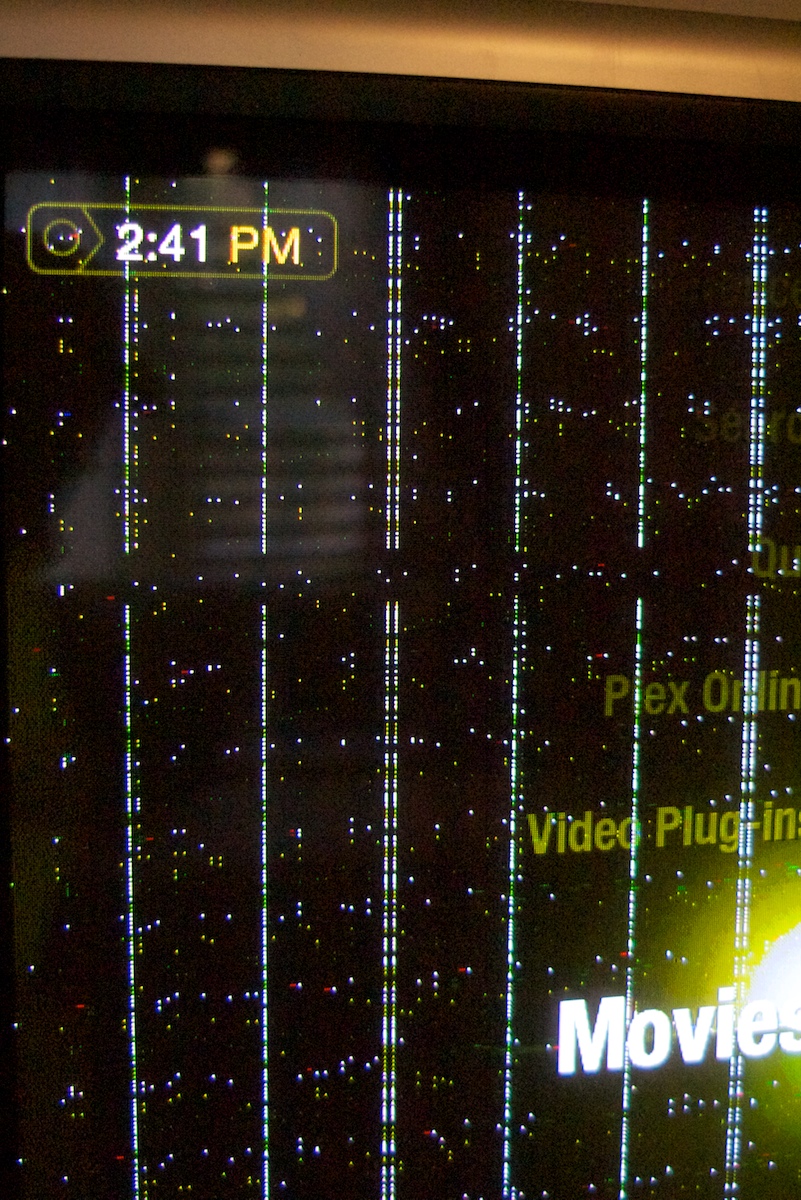

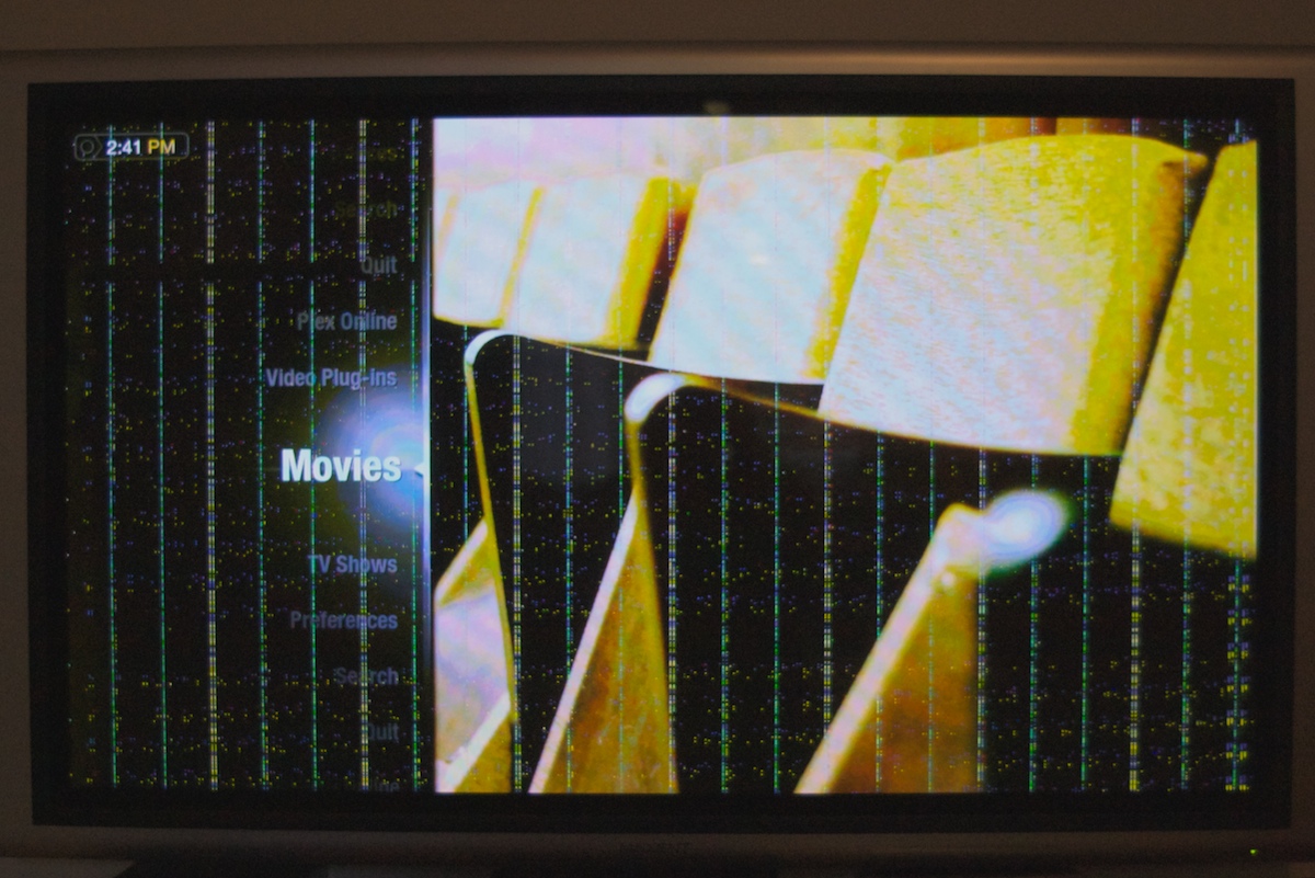

    I purchased this set in Jan '06 and have recently had an issue with the display. The first sign of trouble was several months ago: The image on screen would flicker a few times from cold power-on before recovering and then remaining clear. That behavior persisted until last night when after being on for ~50 minutes we suddenly started seeing vertical bands of noise across the whole display. (See attached photos.)
    This noise will start after the set warms up with a few dozen pixels going wonky across the whole display and within seconds progress to what you see in the photos, sometimes with more or less noise. It is a pretty consistent pattern once it appears, though it sometimes disappears entirely for brief periods (a minute or two at most).
    Another clue to whatever the issue is: If I "tug" on the set (wall-mounted) the noise will sometimes disappear entirely. Alternately, it will sometimes increase in proportion to how much I move the set.
    The noise does cover the OSD. It appears on all inputs, but only while searching for and displaying a signal. If no signal is detected after a couple seconds, the set displays a clear blue screen.

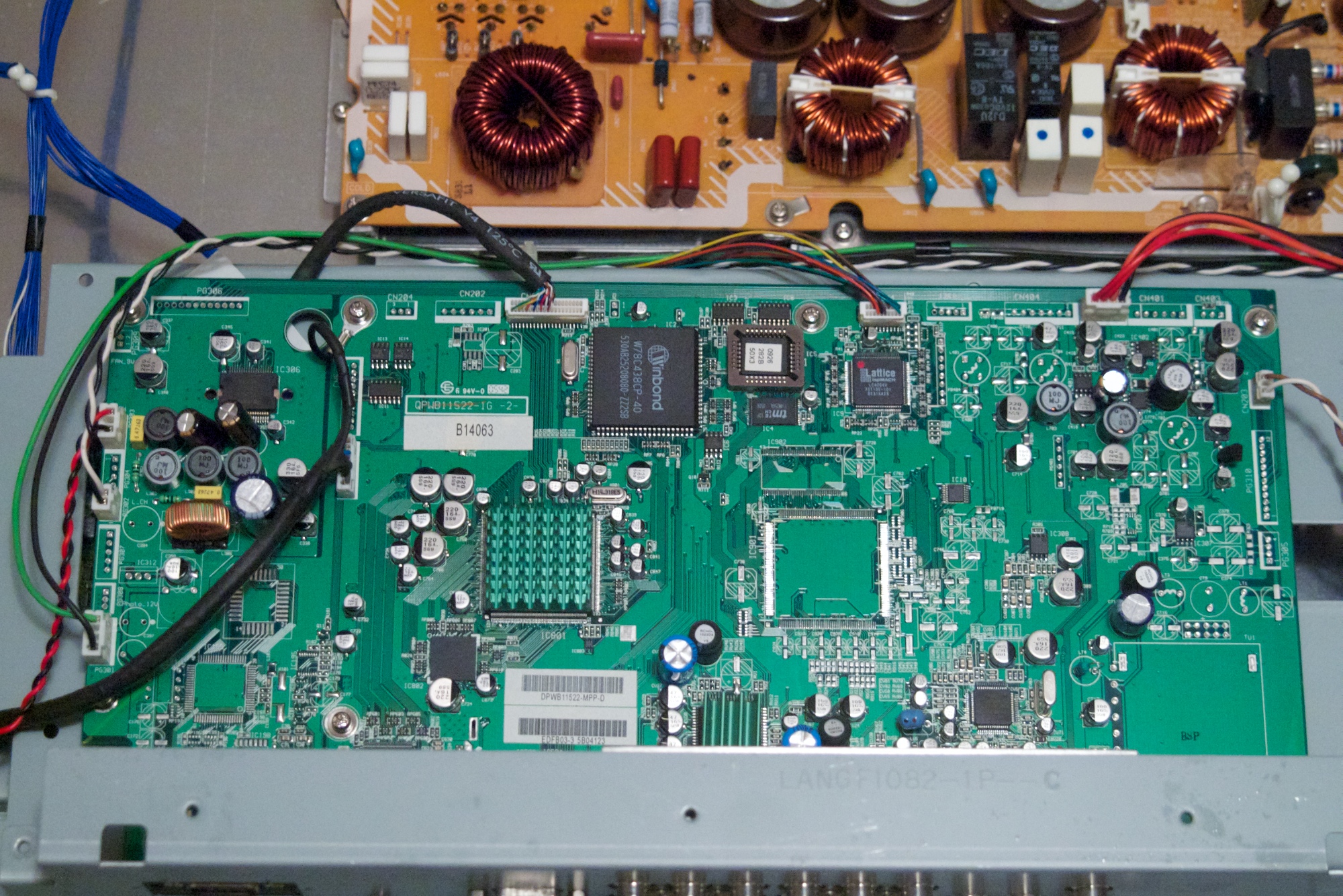

    yes if you remove the back cover not the hole cover but the that small cover covering up the mainboard for all the input connections you will see an IC with a green heatsink on it it'll be the hottest of all of them push on that heat sink and see if it goes away if it does you have a bad solder connections between that I see in the board itself this is a known problem with this model.

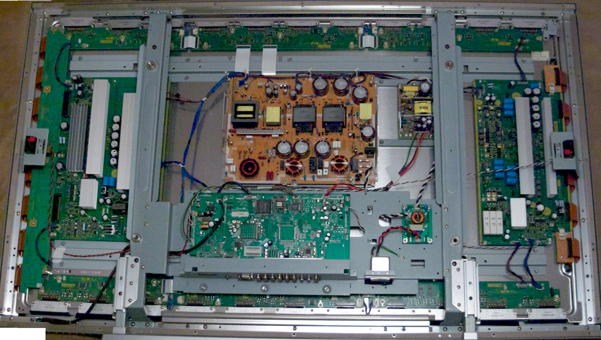

      Pictures of the chassis will help - this will most likely use an LG or Samsung panel and could have a control board defect, usually cheap to fix.

            A pic of the whole back of the TV would be best.

              @freakaftr8: Alright, I've started seeing noise again, and yes, I can confirm that pressing with moderate force on the square green heatsink causes the noise onscreen to disappear. Sidenote: I removed the frame that the mainboard is attached to so I could get a picture of the board underneath it., and now that I'm seeing noise again, it's no longer vertical but instead horizontal blue lines.
              @capkid: Photos of the whole unit and the mainboard specifically are attached. I have close-ups of the other components too if it would help to have a clearer look at any one in particular.
              I gather then that the mainboard is the issue. I see full boards available starting at ~$90 and going as high as ~$300. I also see a repair kit for ~$20. What's my best option: buy the whole board or buy the kit and find someone locally to assist with the repair? Or is there an option C?

                I would say that it's best to have the board repaired, since this. is a common issue
                LG Plasma Mal-Discharge Correction Service
                  Re: Maxent MX50X3 [P500550HM8] 50" Plasma - Vertical bands of noise
                  I would focus on that RAM chip next to the green heatsink (surface mount no lead BGA), more likely that is the issue. Looks like EtronTech?

                    @tom66: You're spot-on. Yes, the module is manufactured by EtronTech. Where a moderate pressure on the heatsink corrects the issue, only the slightest touch to the RAM chip has an effect. From what I've seen you post elsewhere on this board, it sounds as though reballing a BGA is a delicate task – How do I go about getting this repaired?
