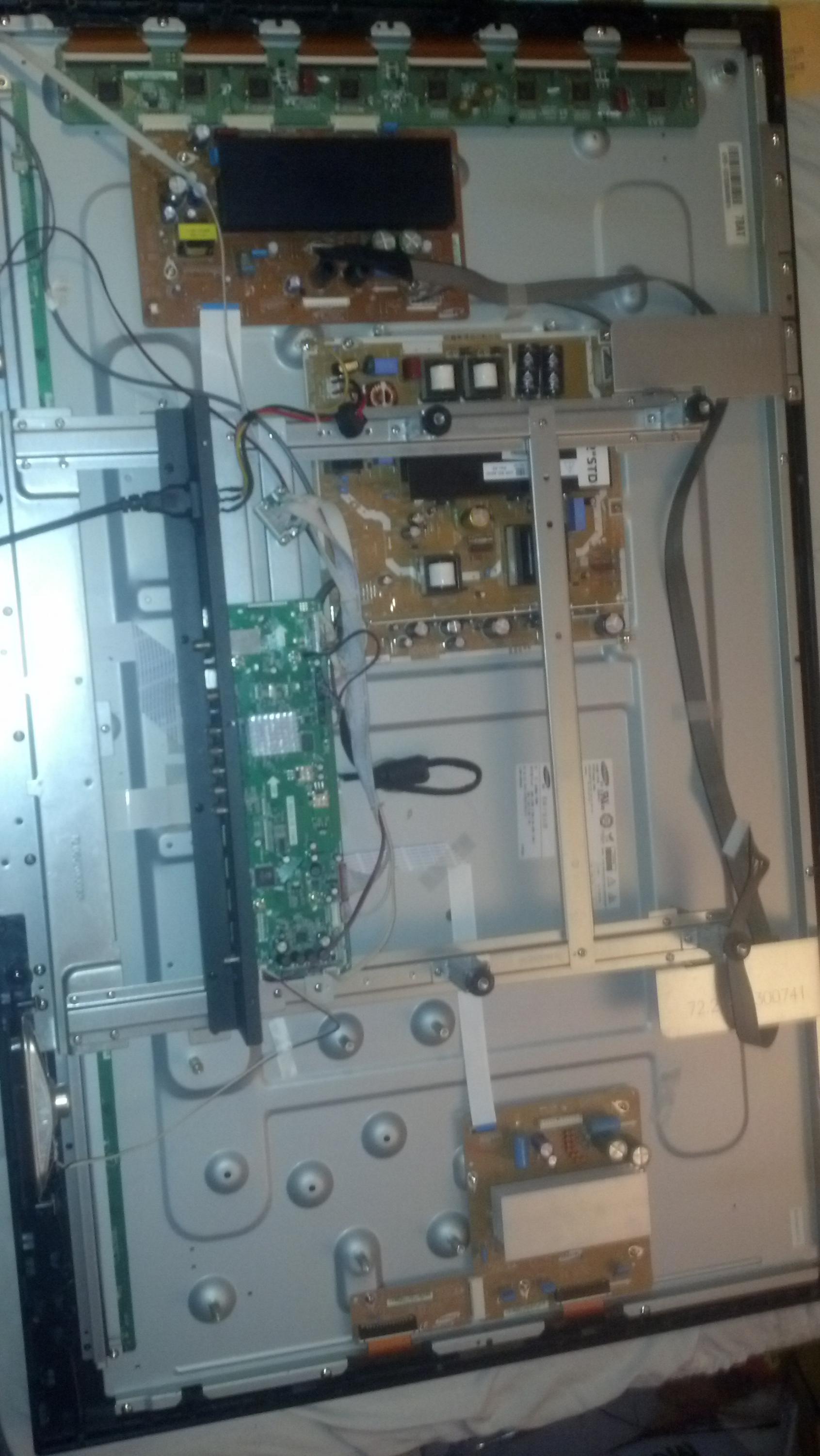

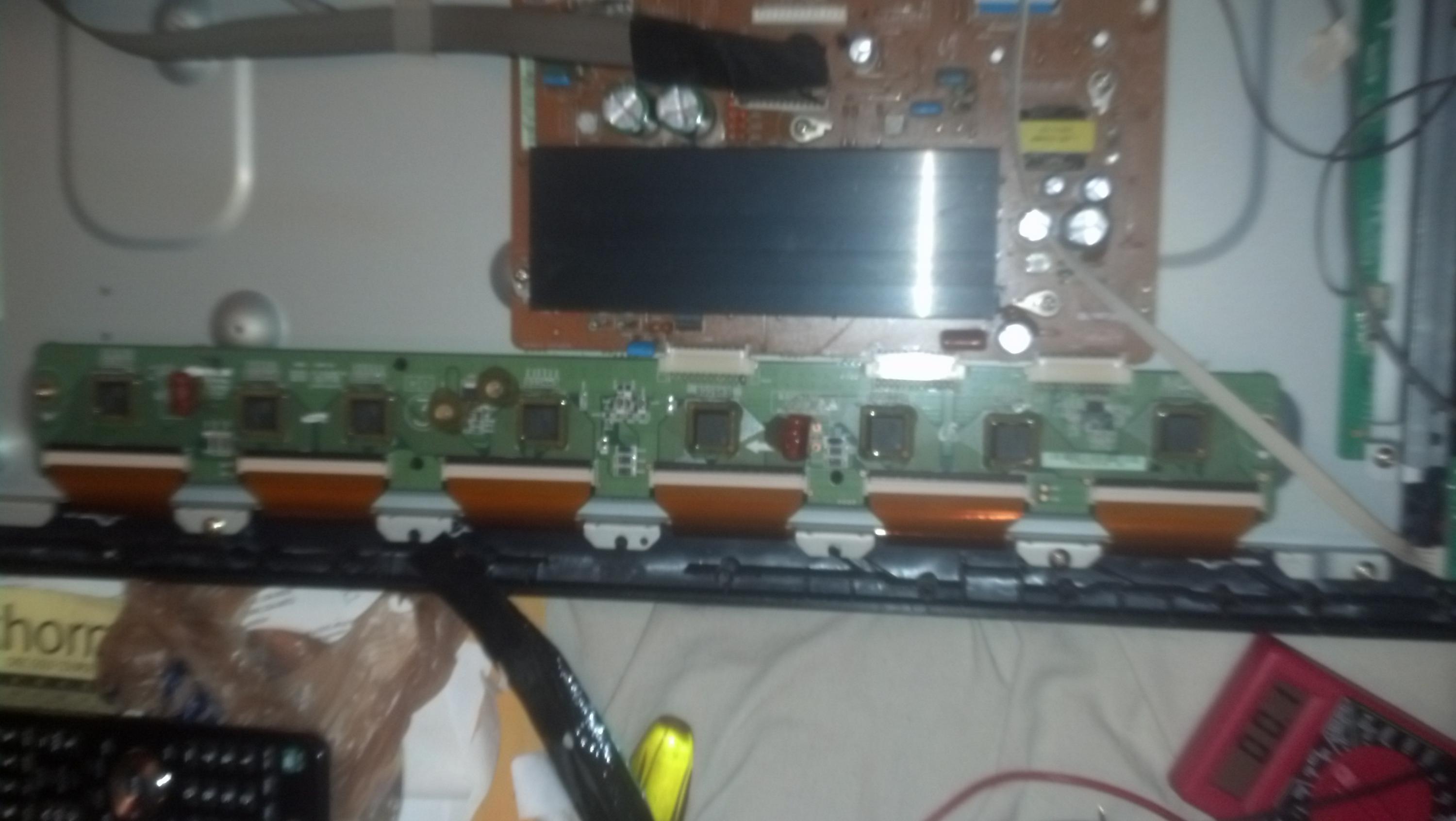

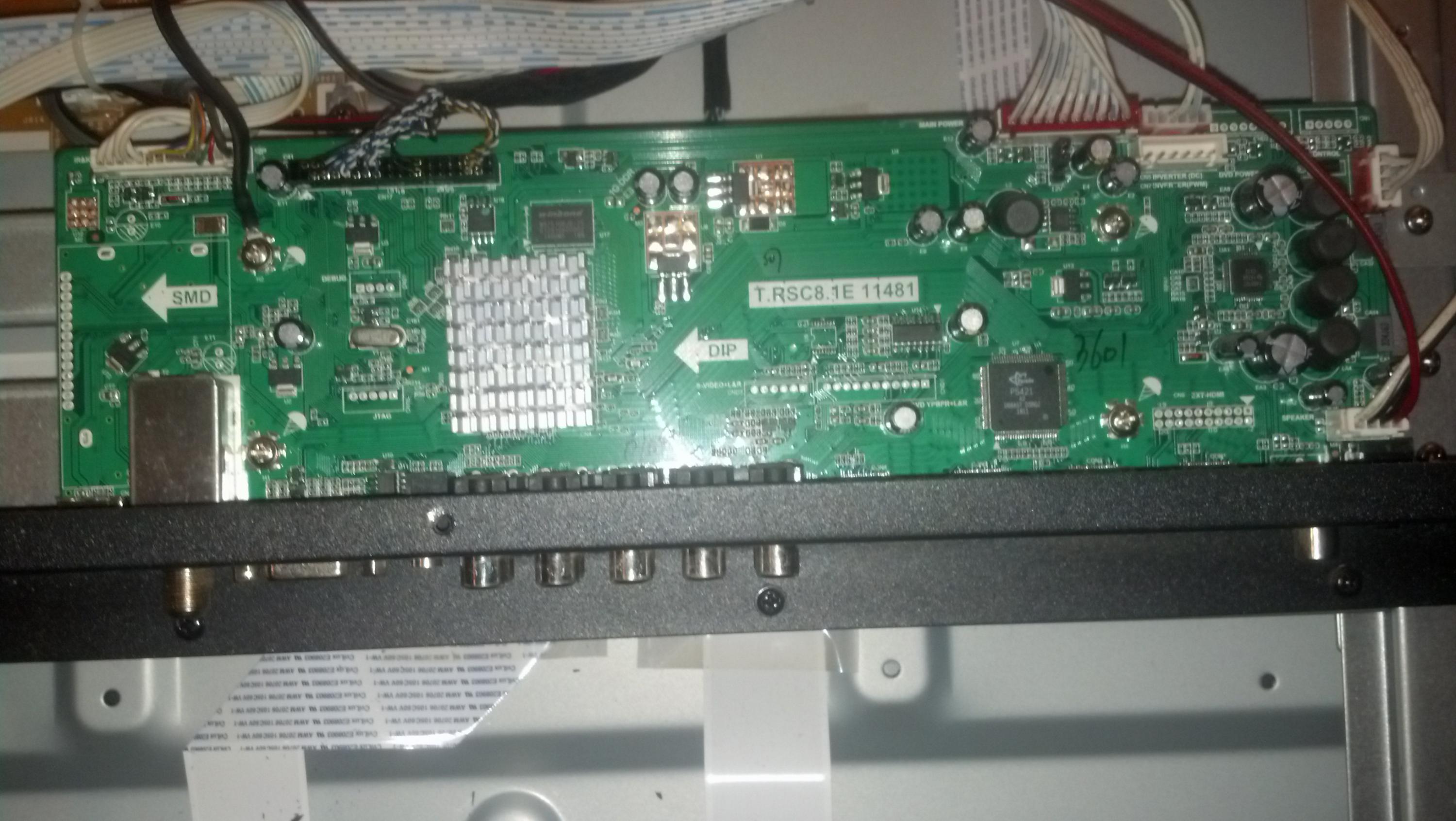

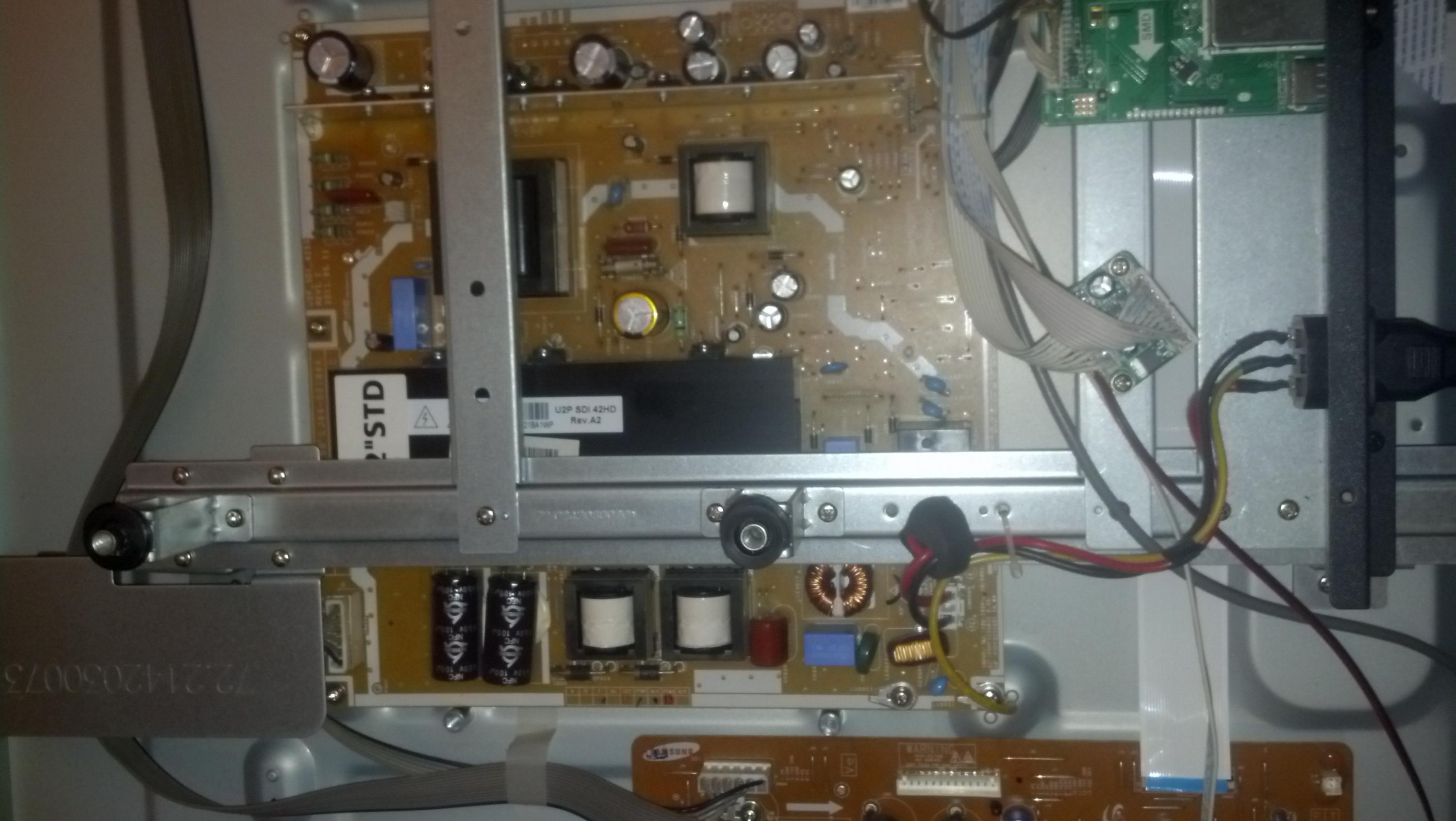

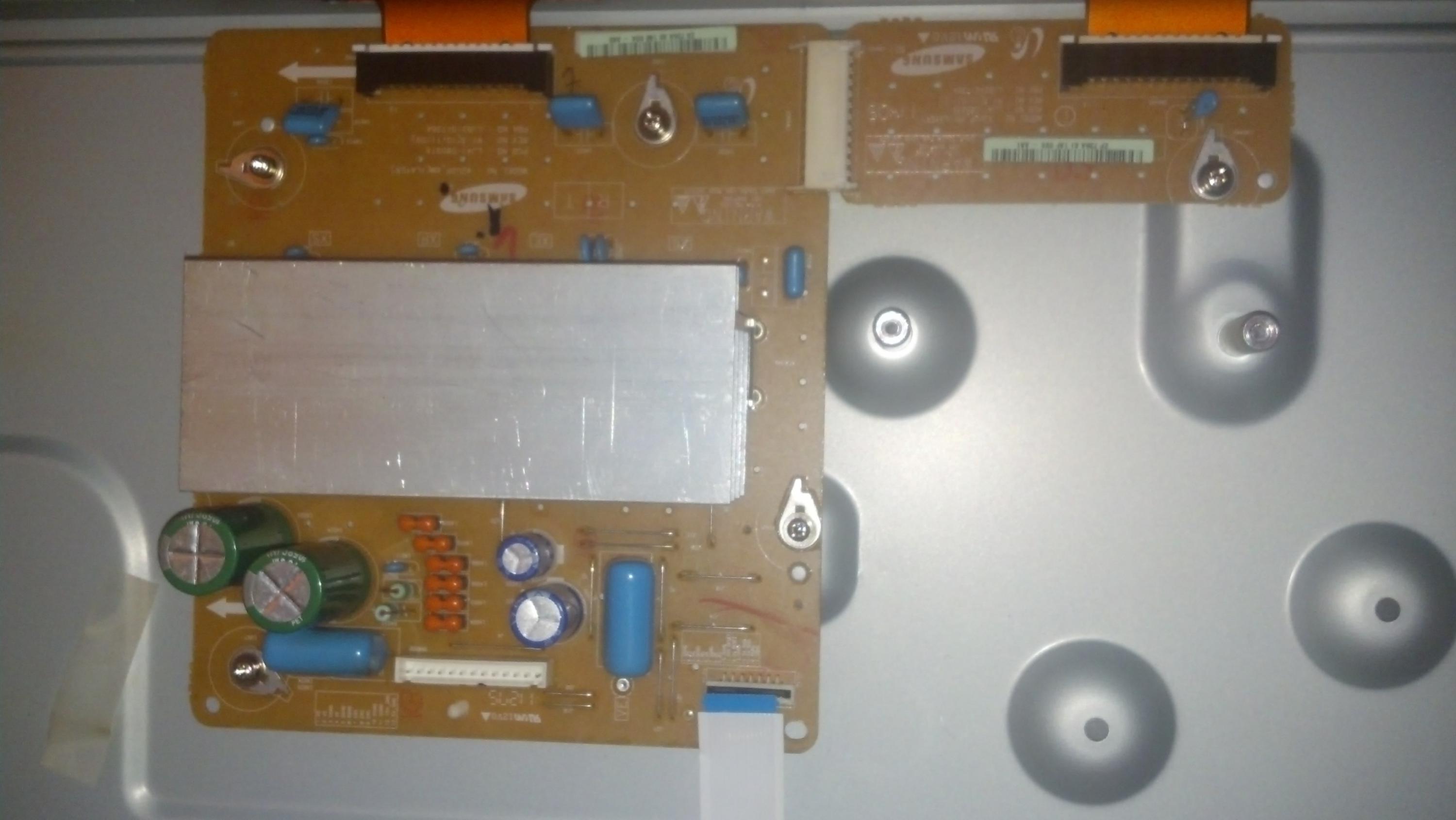

      I have a similar problem with my RCA 42PA30RQ. I've read various posts but none of them cover my exact problem. I am also unable to create a new post as I just became a member today..
        Re: RCA 42PA30RQ plasma tv problem
        Ok whats the issue?
          My VA with everything accept the Y buffer unplugged is staying steady at 120..
            OK I think Tom66 would be best at helping with this...
            Take pics of each board and then one of the entire back of the chassis so we can see everything.
              Here is the pictures..
                If you'd said the opposite was happening, you could probably point to the Y-buffer as being the issue. Otherwise, the Y-main being disconnected pretty much means the Y-buffer is disconnected, too. How does your VS voltage look?
