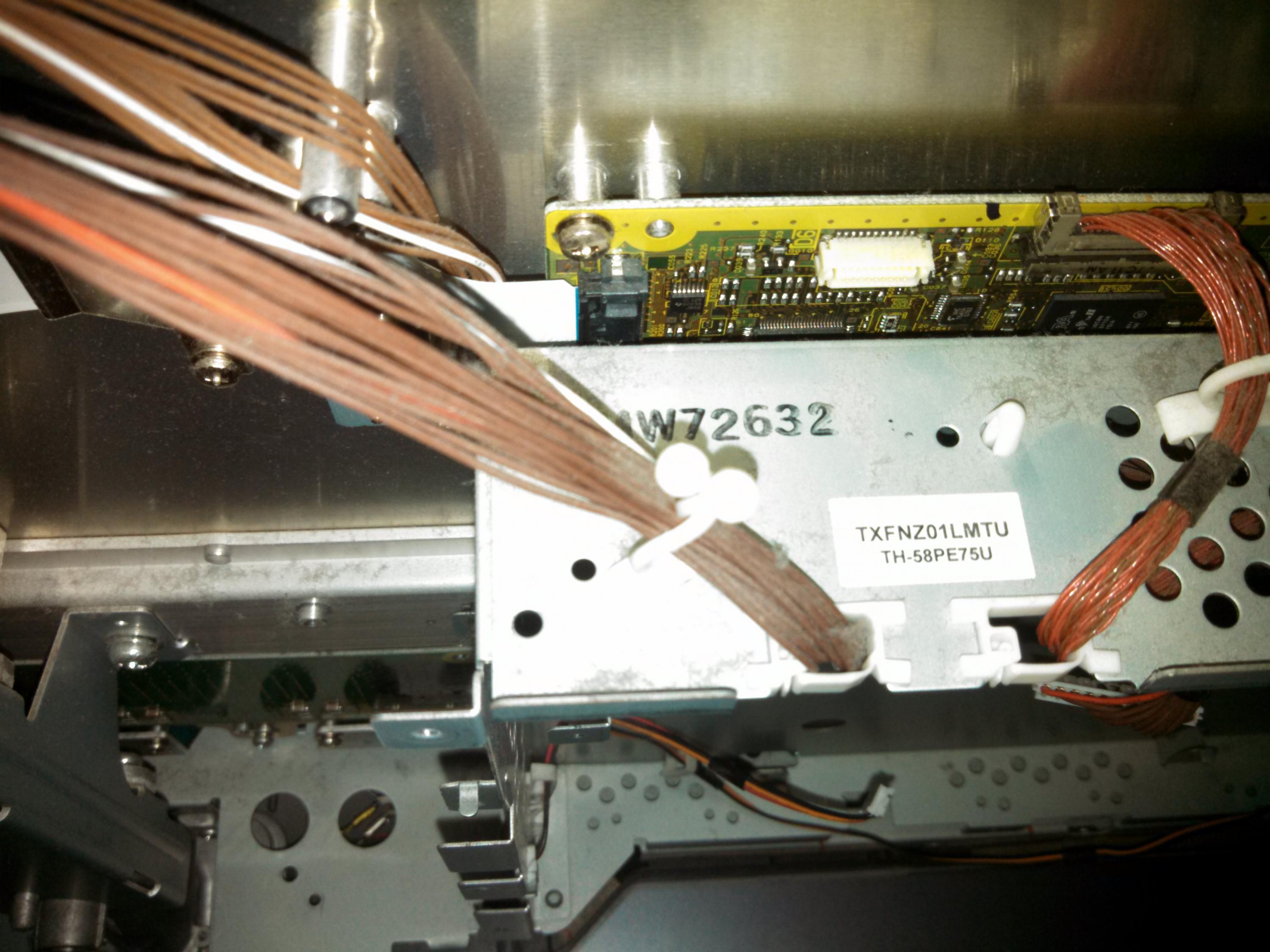

      Thanks...model no. of TV is TH-58PE75U.
      Board A in question part no. is TNPH0692(1)A
      No there is no label on or near connector...

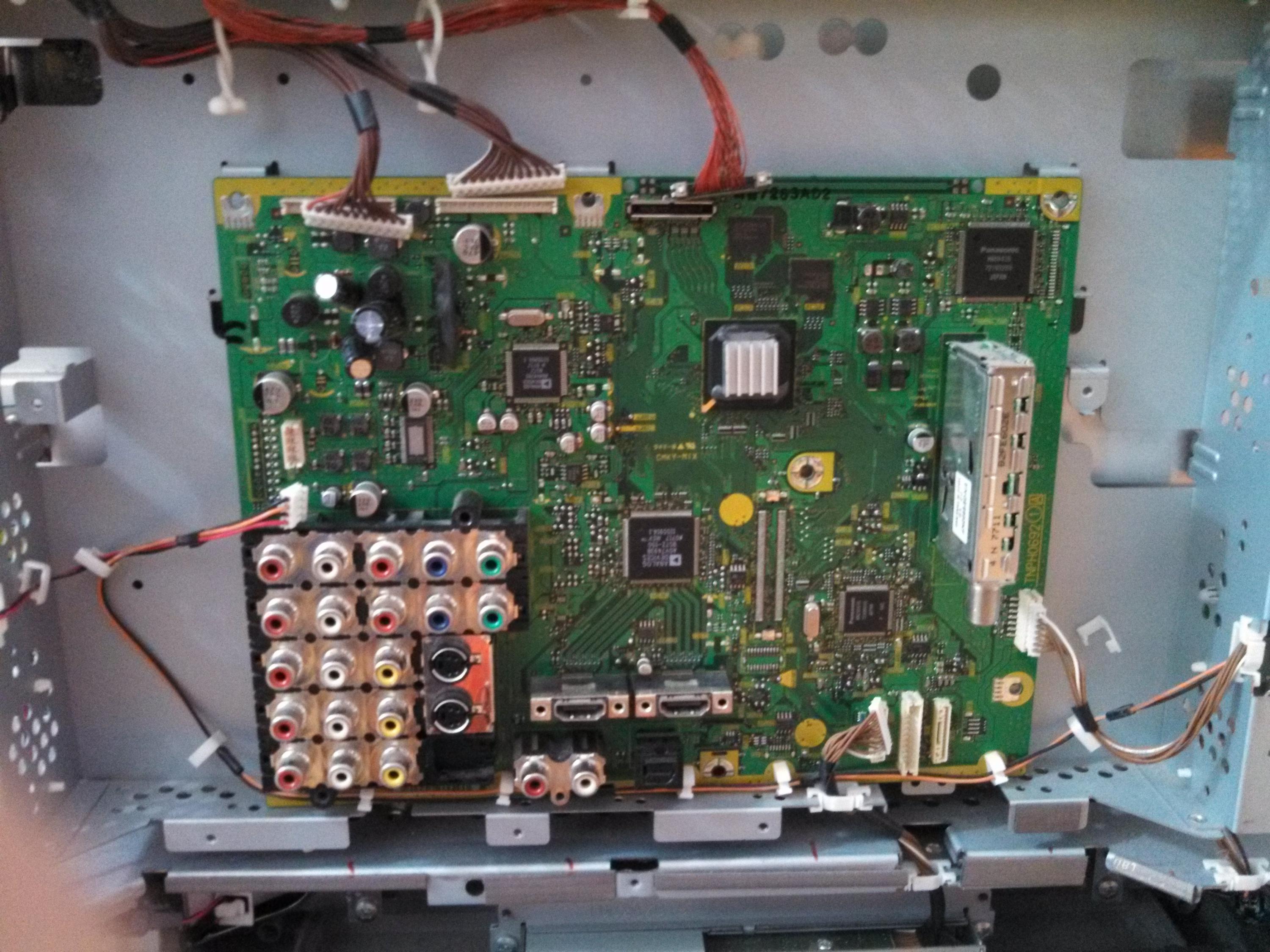

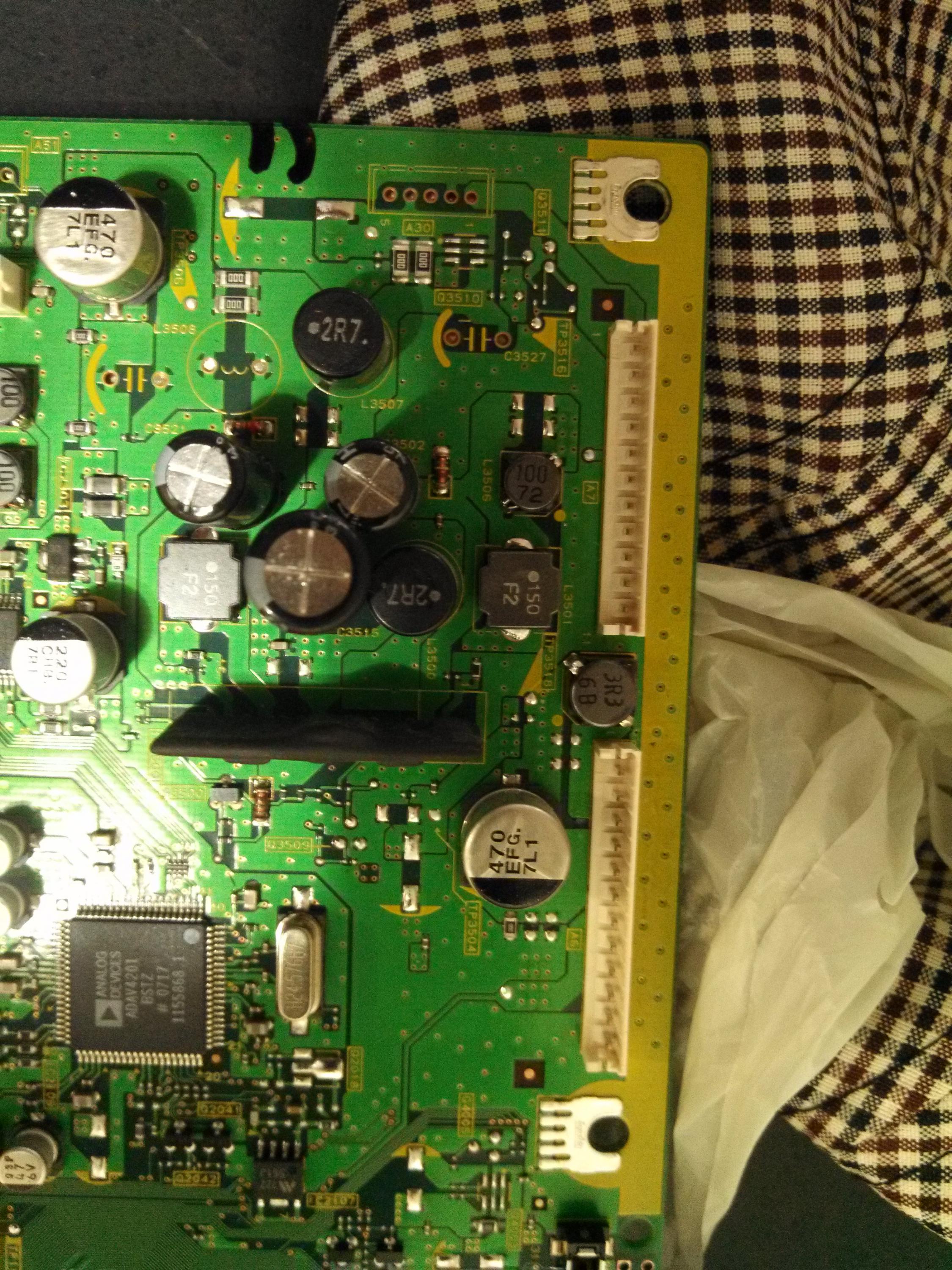

      There is a label in metal box where this A board fits in ..and that no. is txfnz01lmtu as attached in picture.....also attached few more pics showing actual board those two connectors I am talking about ...they are A6 which has 12 pins and A7 which has 11 pins...also power supply board picture...

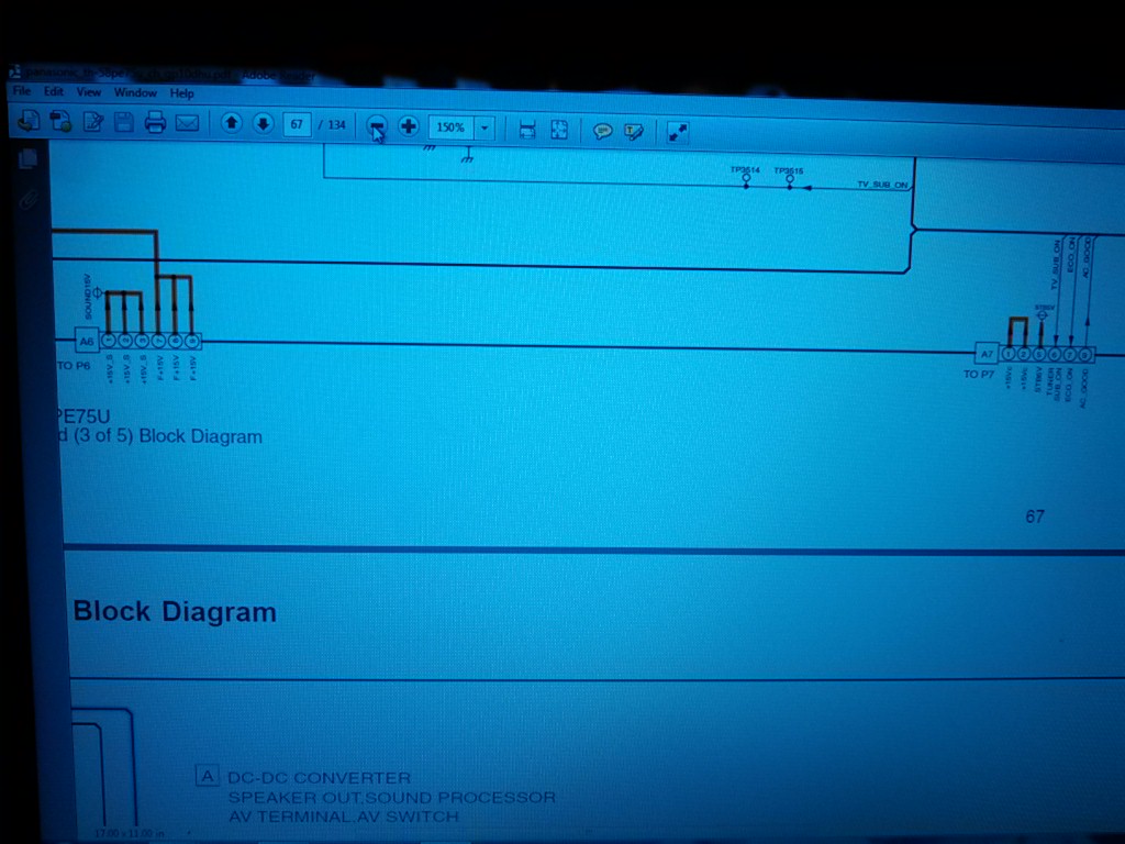

      I have also uploaded page from Factory service manual showing A6 and A7 connect and concerned voltage..
