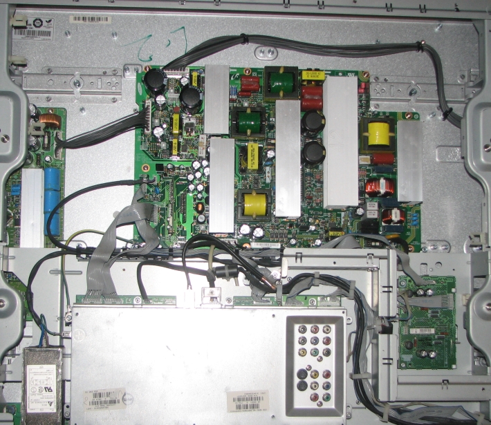

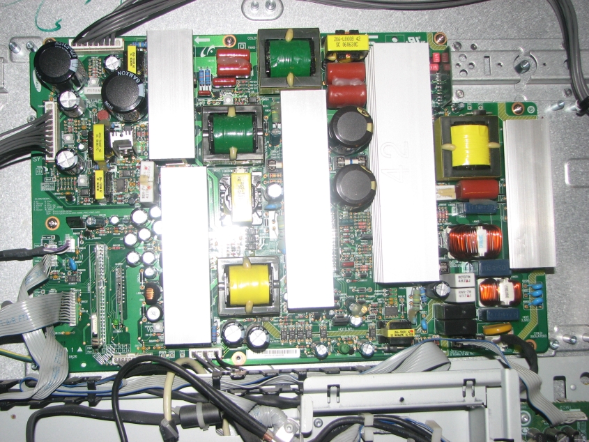

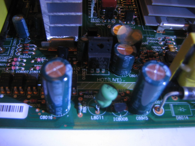

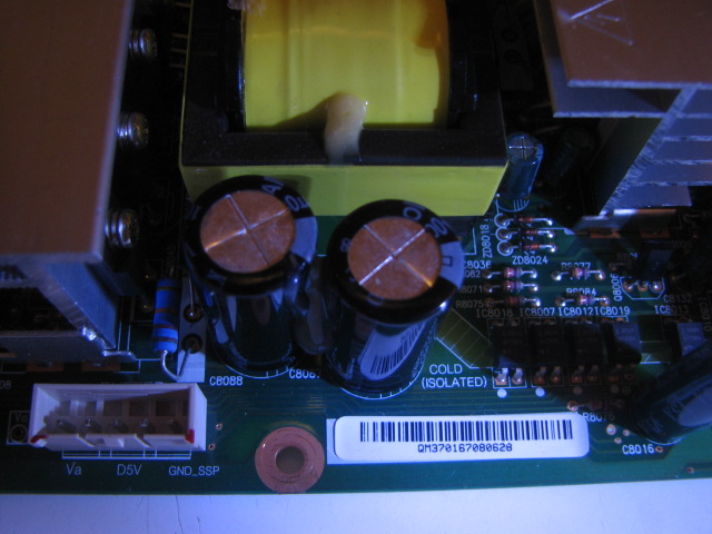

                    Picked-up the tv today. Was in garage, had not been powered-on in months. We took it inside, but it would not power-on. Instead the led on the front of the tv blinked 6x slow, then 3x fast. I brought it home, took off the back access panel, took some pictures, then tried to power it on. Now, the led on the front of the tv blinks 7 times slowly and that's it. In addition to this, there is an led on the power supply board that blinks 3 times slowly.
                    I can't find any obviously faulty capacitors on the power supply board. I understand that this doesn't mean that none of them are faulty. I don't see any 3300microF caps on the board. I've included a few pics. Two of the close-up pics each show a pair of caps. C8088 and c8087 are both 680microF 100V, while c8016 and c8015 are both 1500microF 10V.
                    The back of the circuit board is very dusty. Should I try cleaning it? With what? I have some 90% isopropanol.
                    On other forums, some people have reported similar problems with Phillips plasma tvs and most of them say the problem is solved by replacing capacitors. Others say replacing a fuse (there are a few on the different boards) or just the mains power cord fixes the problem.

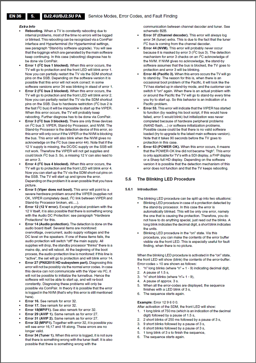

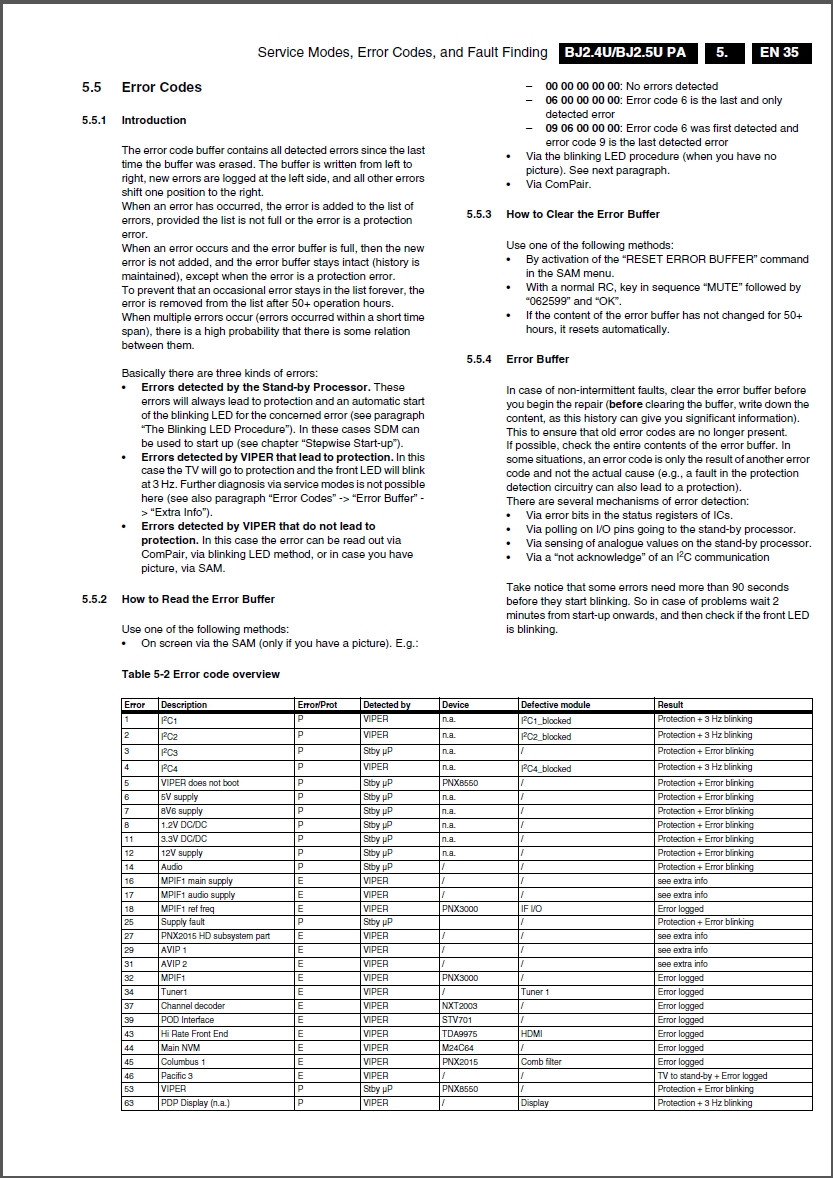

                                      According to the service manual, (if I'm reading it right, which is unlikely), my tv is indicating Error 63:
                                      "(Power OK). When this occurs, it means that the POWER-OK line did not become "high." This error is only applicable for TV's with a SDI display, a FHP display or a Sharp full HD display. Depending on the software version it is possible that the detection mechanism of this error does not function and that the TV keeps rebooting."
                                      Since the tv powered-on and worked perfectly for a few hours (until I turned it off), I'm thinking the problem may lie with a "detection mechanism."
                                      I've included a couple of pages from the service manual which I think are relevant in the hopes that someone knowledgeable in the jargon could come to my aid because I don't know where to go from here.
                                      When I had the psu out again, I checked for shorts or any obviously faulty components. I didn't see any with my untrained eye.
