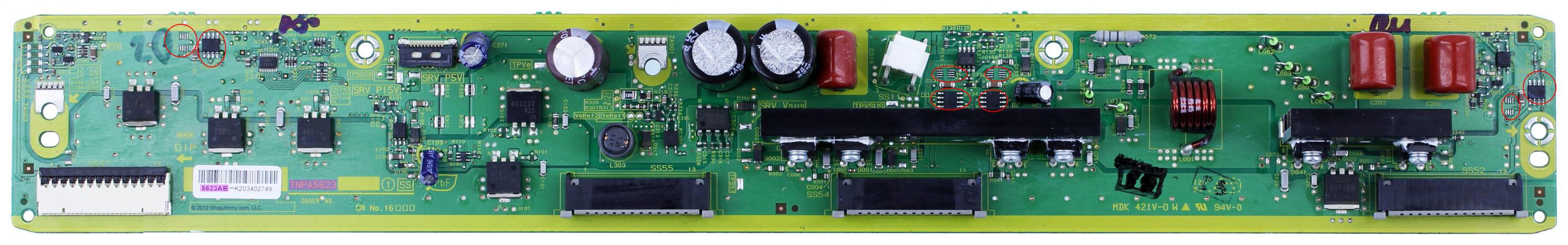

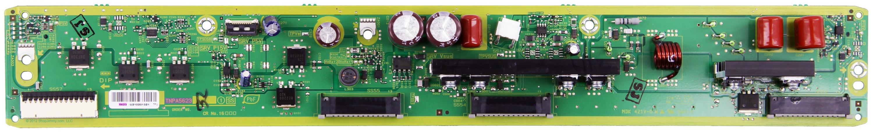

      Originally posted by freakaftr8
      that's all I found too. yes this board is failure prone. Looj for thus model ir tc-p55ut50 ss board. Same part number.
      Better have a good look at that 55 SS, is UT 3D and U just std FHD? I'm seeing ICs missing from the 55 board. I would not use it unless the component layout is the same.
      Both TNPA5623 but no rev for the 55UT50, AB for the 50U50

        oh crap I guess I shoulda looked better before I put the board in the 50 inch last night. But it has been running for about 5 hours nonstop and it looks perfect. Go figure I wonder what the revisions about....

          Re: panasonic TC-P50U50 8 blinks
          Ok, well I don't know maybe to do with 3D. I've circled some obvious ones. This is a guess but I wonder if they're the FET driver ICs and one type maybe a heavy duty one. I know that sounds like crap but with out part numbers etc it's a guess.
          Good chance some of the capacitors and coils are different . Anyway it works so who cares.

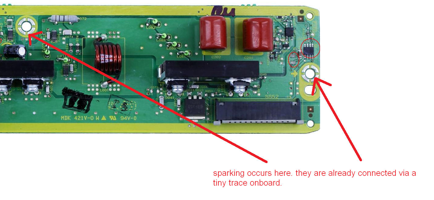

                                        The guy with the repaired TV called me back and said there is noise coming from the TV. So I opened it up and yes, the solder pads from the screws where black again, so there was sparking.
                                        The two solder pads for the two screws right next to the parts that blow up are already connected via a tiny trace on the board. That means the trace's inductance causes a voltage drop on it. When we tighten the screws the two solder pads are connected via the lower impedance path of the chassis.
                                        Clearly a design failure.
                                        I used dented washers now which should assure a good contact from solder pad to chassis/screw.
                                        When it starts again I think a good way to really solve this is to connect those two solder pads with a thick wire onboard.
