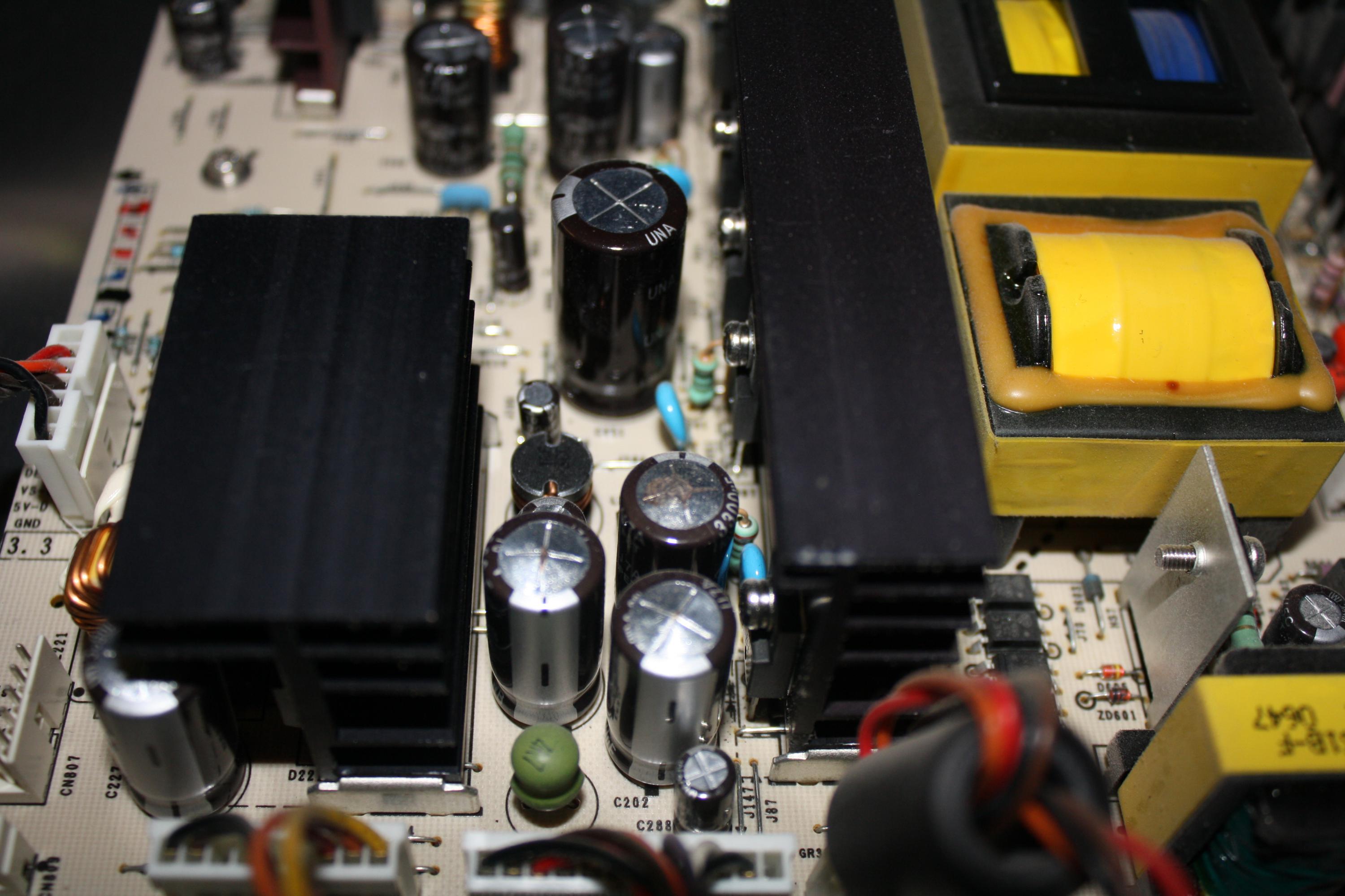

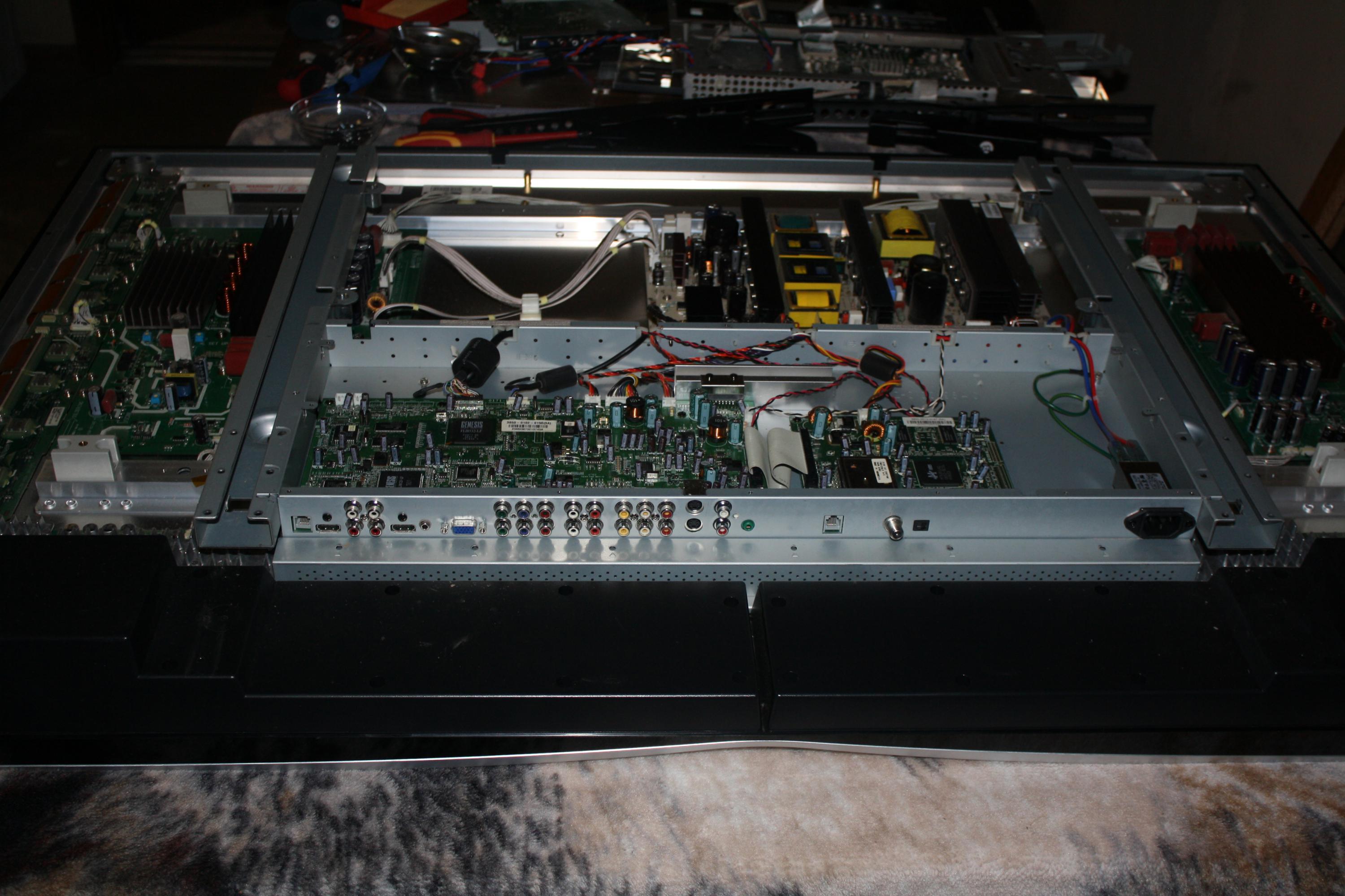

    Bought this TV off CL with an issue powering up. The owner said it would take 2 or 3 times to get it started, and that progressively got worse. Once the TV got going it would work fine so long as it was left on, but if it was turned off, it would take a long time to get working again. The owner had some success putting a small space heater in the back, and managed to turn it on that way after warming it up, but it recently stopped powering up all together.

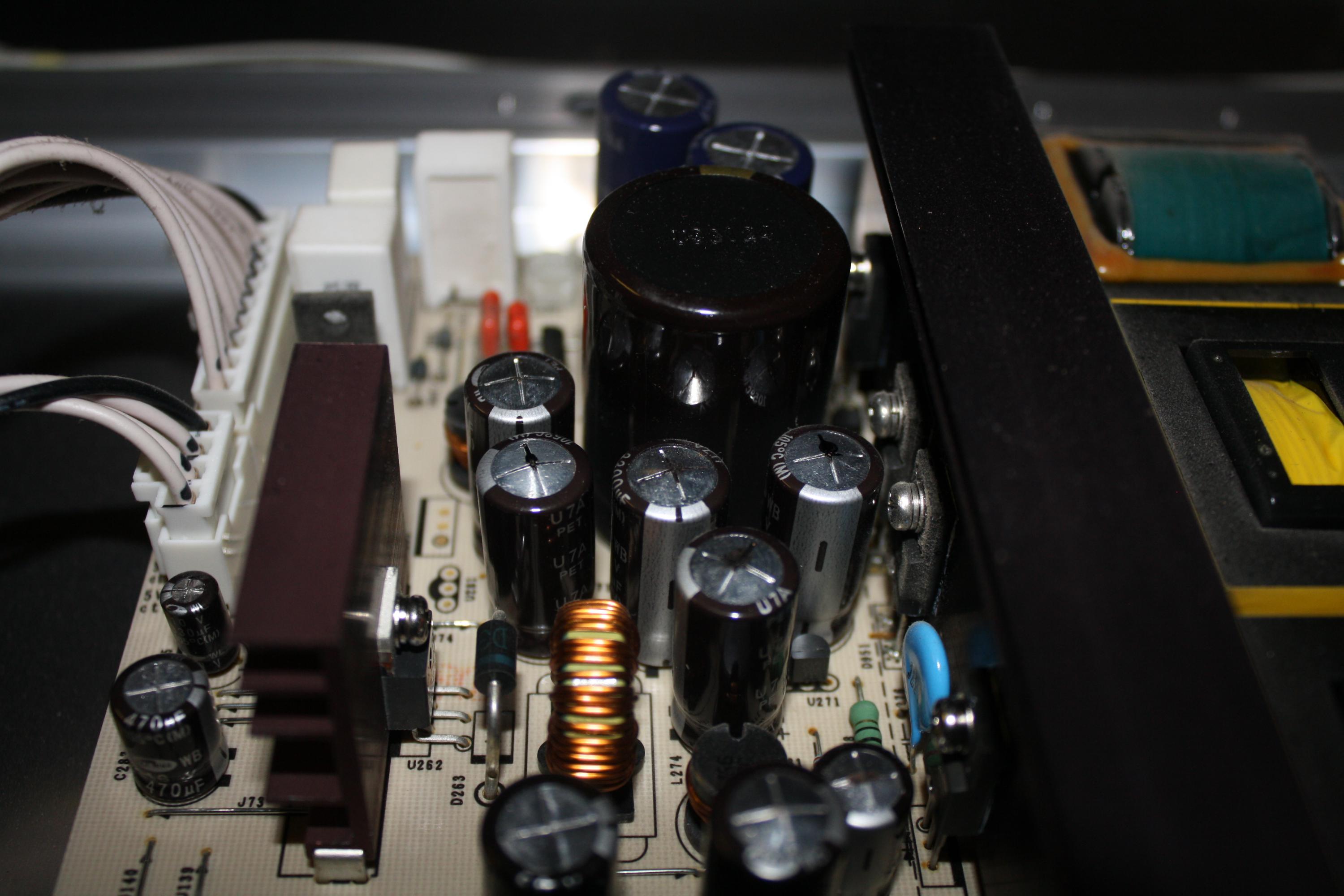

    After looking up the model, saw that bad caps on the PS was a recurring theme. After taking it home and opening up, low and behold about 10 bad caps bulging, 2 with leakage on the PS.
    Will be replacing caps, and let you know how it goes. Any other possible causes other than PS caps would be welcome of course, in case the cap replacement doesn't do the trick

      Okay, I replaced the caps (Cherry popped!) and now the TV starts up almost instantly!
      Which would be great if it wasn't for the red snow, and ghost like "reflection" of the No Input image. Now this may be caused by the panel being loose ( I may have undone more screws than required.) I see Ysus boards are likely culprit, but the owner indicated it wasn't having any issues except for the slow powerup before it stopped, and the PS cap replacement resolved that issue.
      Any suggestions?
