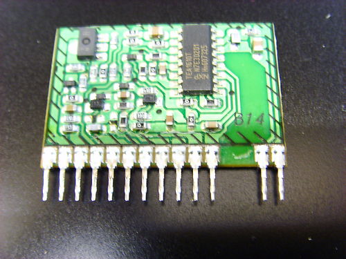

    I have a Panasonic TH-42PZ70BA open on my table. Symptoms are no power and the standby LED blinks ten times, but sometimes it works fine. Right now it's working, making the problem a little difficult to pin down.
    The power board is ETX2MM681MF and I have searched around for other people's experience repairing this TV and power board and found not much. I have found 10 flash repair kits and repair services for this board, and similar problems with other Panasonic models lead me to suspect the MC201 & MC301 modules.
    I've seen the information regarding replacing the TEA1611T and capacitor on MC201&301 on other models but my modules are a different layout and use a TEA1610T chip, so although I could guess, I'm not sure I'd be replacing the right things with the right values in this case. Does anyone out there know?

      I've seen that video and thought to replace the capacitor. But does this also work with the modules with the TEA1610T, and is it still the obvious capacitor to the top left of the IC as shown in the pic I attached? Is it a still a 1uF capacitor?

        ^That video is sadly not relevant to this 2007 PDP, only 2008 PDPs.

                  You should check if D401 is s/c or leaking. You should also replace MC301 and MC351.
                  Also check if T201 termal fuse is open.
                  Hope this throws some light in.
                    Re: Panasonic TH-42PZ70BA 10 blinks no power - intermittently
                    Thanks Blanqui
                    D401 tests fine. T201 is fine and must be as the TV does work intermittently.
                    I'd prefer to change individual components on the MC301 as it would work out a lot cheaper than replacing the whole module.
                    Btw everyone, I found out that the NPMLQNFA refers to the MC301/201 module. It is printed on the back of the PCB. So the ebay product looks to be a replacement MC301.
                    I have ordered a couple of TEA1610Ts from China for less than £5. My current plan is to replace those and the capacitors on both modules.

                                Funny story...
                                So I got the TEA1610s and meticulously soldered them in place. Tested the TV and no.. still 10 blinks.
                                So after trawling google yet again for anything slightly relating to TVs like this I started testing voltages around the TV to narrow down whether it was really the P board at fault or if it was the D or DG board or whatever. Long story short I noticed when I probed a pin on one of the connectors to the DG board the TV worked, but when I pulled away it switched off. So it turned out that connector was not seated correctly. After pulling out and re-seating the connector all is good.. hopefully for a good long time.
                                So... moral of the story is, before assuming you've got a common fault you read about on the internet, maybe try the basics first. Like checking all the cables and connections and testing voltages.
