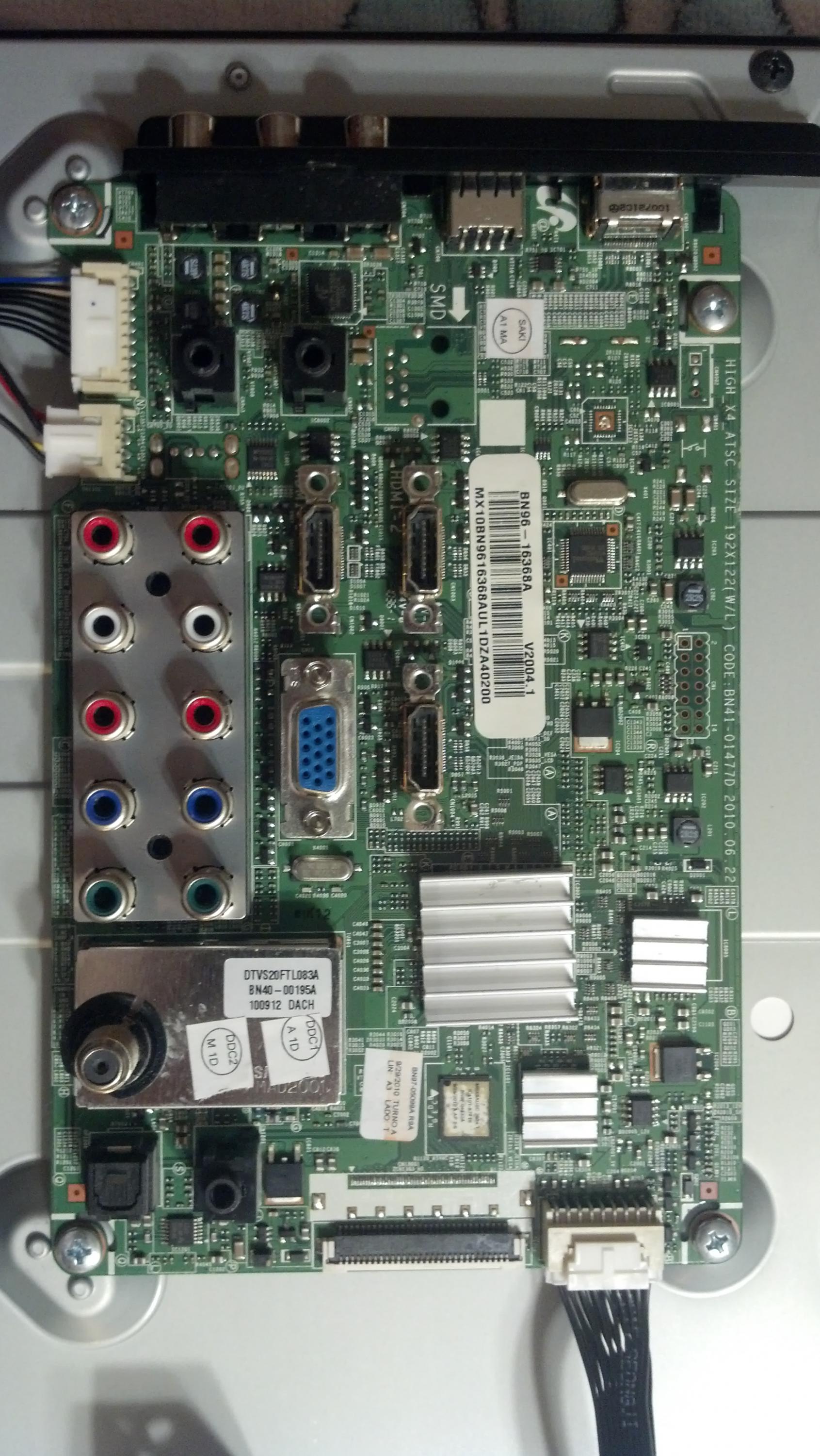

    I have a Samsung LN32C540F2D, Ver CN05, that will not power up. I was watching it a few days ago and it shut off like i hit the power button. The red standby light is illuminated. I visually inspected the power supply board, and main board, and found nothing interesting. All of the caps looked good, no bulging, leakage, etc. I checked the P_ON line for the 5V feedback from the main board and it was at 0 volts. I kept my meter on that pin at the power supply and touched the power button on the face of the TV. The P_ON input to the power supply board jumped to 1.35 volts for a couple of seconds then went right back down to 0 volts. This happens every time i hit the power button. The main board is part number BN96-16368A V2004.1. The power supply board is part number BN44-00338B and the date on it is in 2010 if that matters. Thanks for any help!!

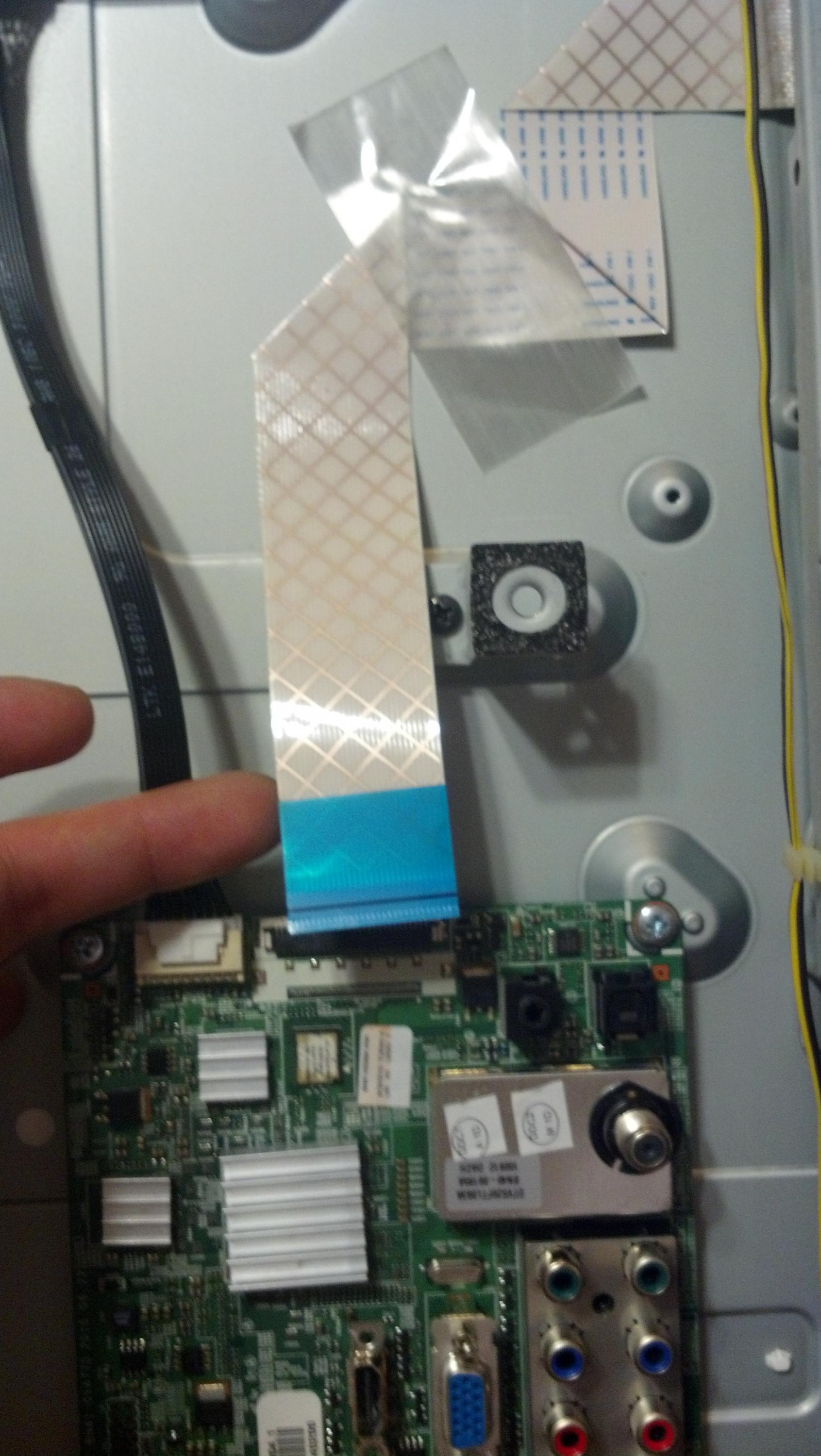

    Try disconnecting the LVDS cable between the main board and the T-CON board to see if it will power on OK.

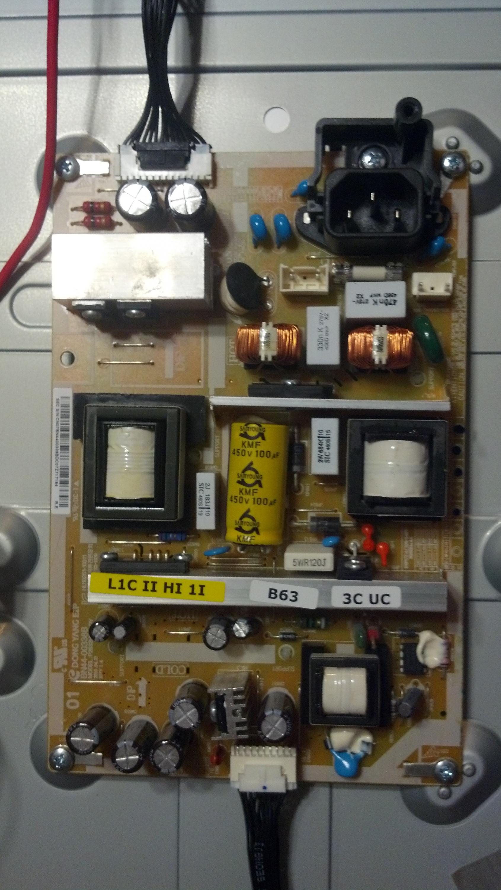

      I believe I disconnected the cable you suggested and still no change. To be sure i disconnected the correct cable I have attached a picture of it as well. Here are pictures of the main and PS boards. Thanks!
        Re: Samsung LN32C540F2D will not power up
        After doing a little more research I think that the T-CON is part of the main board in this model. The only other board on the back of the TV other than the ones in the pictures is the high voltage board.

                        Well it took me a little while, but after taking the readings at the power supply they seemed odd like in the string you posted for me earlier. I purchased the chip and capacitor and replaced them today but it didnt work, still standby light on, but no power on, any more ideas? Now however I have no output from the power supply board at all. I triple checked my solder joints and all, everything looks great. wondering if i got a DOA chip?? Thanks!

                                  Thank you for the link! Martino, i had 5V on pin 16 of the power supply output connector and I jumpered it to pin 18 which was indicated to be the PS_ON pin. I have a bit of new info. The leftmost pin of the IC801 that I replaced is fluctuating between 140V and 280V. The rightmost two pins fluctuate between -3V and approx 15V. The fluctuations are simultaneous from input and output. Sorry I am not a TV repair guy normally, just trying to help out my mom. I will definitely tale a picture of what i am doing tonight when i get back home if that will help. I have downloaded the PS board schematic so that will help. Thanks for all of your help!
