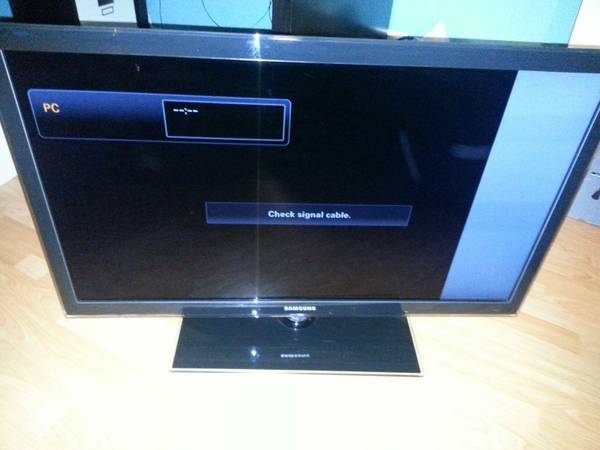

    samsung with white vertical line UN40C6300
    Im thinking of picking this tv up for 75 bucks
    Is it worth the fix?
    I want this for my bedroom
    I think I read in other posts that it can be a bad buffer board I think or a possible loose connection
    I haven't had time to read old posts yet
    But I think it should be an easy fix
    Re: samsung with white vertical line UN40C6300
    Bad panel - likely water damaged. Avoid.
      Thanks tom can always count on you and this forum for help
