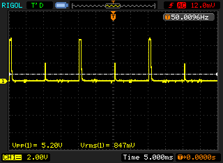

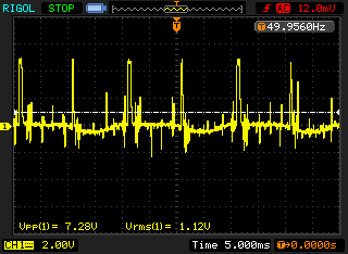

              ...The mystery deepens.
              Here, I was able to get a scope shot of the AC detect signal both during fault and after it (with set operating and producing interference.) Unfortunately, as can be seen, it is not a DC signal, therefore my idea of using a relay will NOT do the trick.
              I think that one of the small ceramic caps on the AC detect board may be bad, one of the ones on the input AC lines, because it is asymmetrical. It appears to be on the negative edge of the AC wave.
