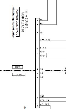

    I had this nice 42 inch 1080p Panasonic plasma working in my bedroom for 5 months (it was the one with the cold joint on the power board.)
    I decided 42 inch plasma is way too big for me so I got a 32 inch 1080p Sharp Aquos cheap for fixing up and sold this one, but a day later it came back with the original fault (talk about bad luck!) So I gave the guy his money back...
    I've since traced it down to the AC detect board, which tells the PSU if the AC is present. I've found that when I freeze spray it, the TV will power up and work fine. Once it warms up, it only powers up intermittently.
    I believe it's one of the ceramic caps on the AC detect board, but I can't be sure because the only schematic I have of it is the one I've reverse engineered (see below.)
    https://www.badcaps.net/forum/attach...8&d=1367795705
    I drew the PNP Q3 backwards in that by mistake. The emitter faces BIAS-9V and the collector is the output. C3 is the suspect. It's the biggest cap on the board by far, and it appears to be the only one where if it failed leaky, it would cause Q3 to stay off. It would have to fail very leaky (probably shorted.) But I cannot know it's value unless anyone else can measure it.
    If I can't fix this part, I may have to think of an alternative AC detect circuit design... ideas coming soon.

        Unfortunately that's not the issue with this model, that would be too easy! Though the cause seems to be the same (leaky ceramic cap.) My set does NOT have a 10 blink or 2 blink code. It is completely dead. No power LED, no relay clicks, until you give a freeze blast to the AC DETECT board (which is an MC MODULE but it's not the TEA1611T boards.) Then it fires up and works perfectly until it warms up and the AC detect signal goes awry, causing it to intermittently shut down and restart as if the power cord were loose.

          Will check when I open it up but it's one of the few that crosses the PRI-SEC boundary. Has two optos on it.

                Ok, so we're talking one of those module boards that they give no info on in the standard schematic for the PSU. I've got the 46" PSU I'm yet to do for the 2/10 blinks on, probably similar PSU but I have no capacitance meter. Would have to pullit out and track down a meter at work to measure it next week if you're really stuck.
                  Re: Panasonic TH-42PZ80B - Completely dead again
                  I appreciate it. I've got an idea though involving using an 230V AC coil relay. I'm going to take 230VAC from the input and connect it to the relay, lift the opto and wire the relay's NO switch terminals to it.
                  I need to find a good AC relay with a sub 16ms release time. (~1 cycle AC.)
                  I'd like to do a proper repair though just replacing that capacitor, so I'll have to see if I can narrow down the fault any further.

                      This board?
                      how critical would the value of the cap be do you think? Would it be worthwhile just finding a ceramic physically the same size from a scrap board?
                      Worst thing that could happen is it still does not work, surely?

                          Yes, that one. MC501...
                          It's much worse unfortunately.
                          If the AC powers off and the TV keeps the VDA high while the 5V collapses, the panel goes BANG. And you get a dead driver chip and a dead panel. (Secondary breakdown due to overstress of IC, reverse biasing the diode between 75V and 5V in the IC substrate.) There is something like 3000uF of Vda capacitance (@75V) and only 1500uF of 5V capacitance so it's possible that the Vda will hold out while the 5V collapses. (I believe there's a discharge circuit which detects if AC turns off and dumps the Vda energy quick.)
                          It is documented in many PDP datasheets, I did not realise it until recently, but it's very important for the power voltages to be sequenced exactly, they specify it on the voltage page. If not, the panel can be damaged. I remember doing AC detect bridge on LG 42" plasma and others have done it on 50" plasma. Those seem OK, I tried that TV hundreds of times with no issue, but they did not engineer them as overkill-ish as Panasonic with only about 500uF of capacitance on Vda and 7500uF+ on 5V. So I could get away with it on the LGs, but I do not know if I can do so on a Panny and I don't fancy finding out...
