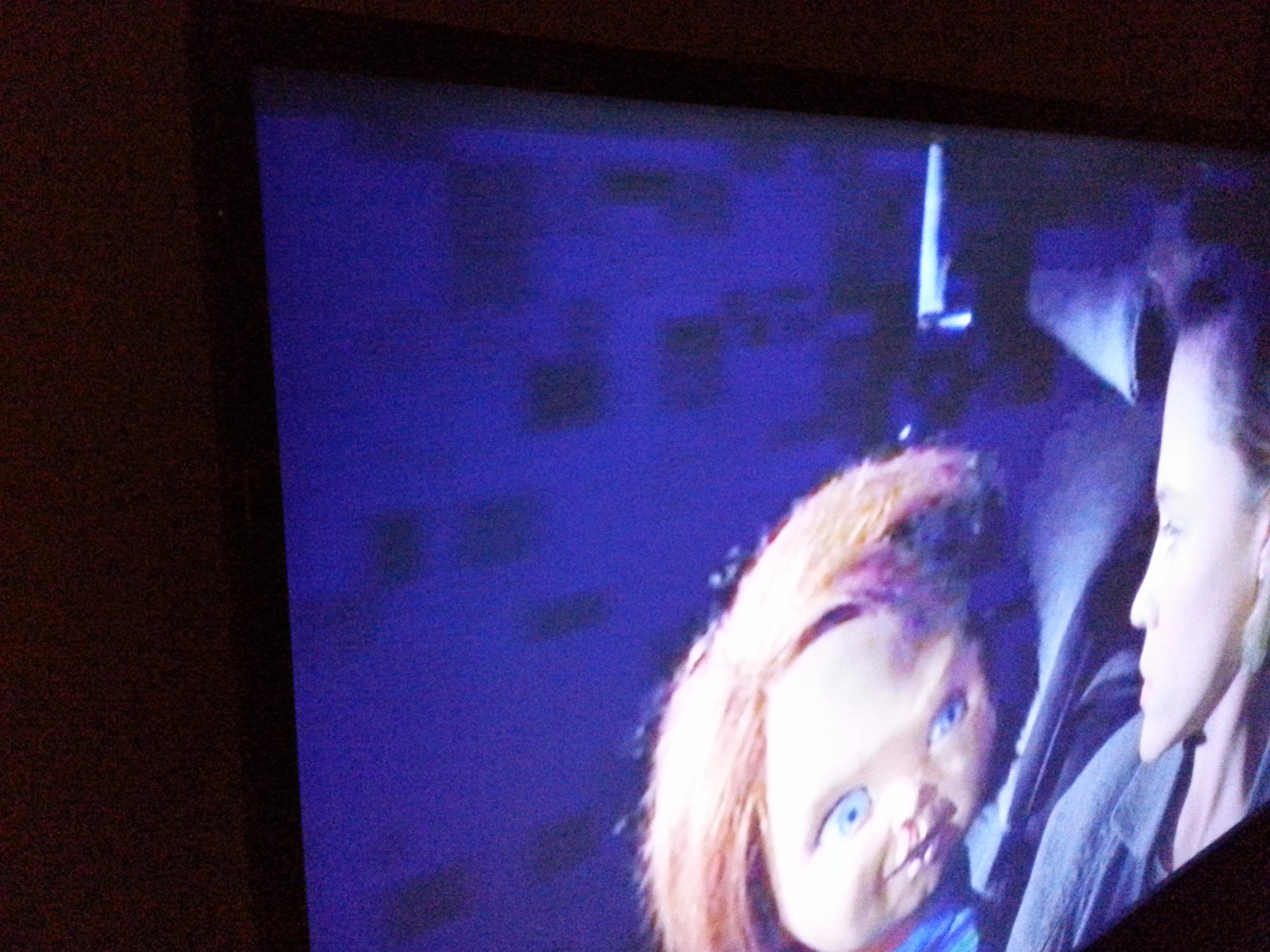

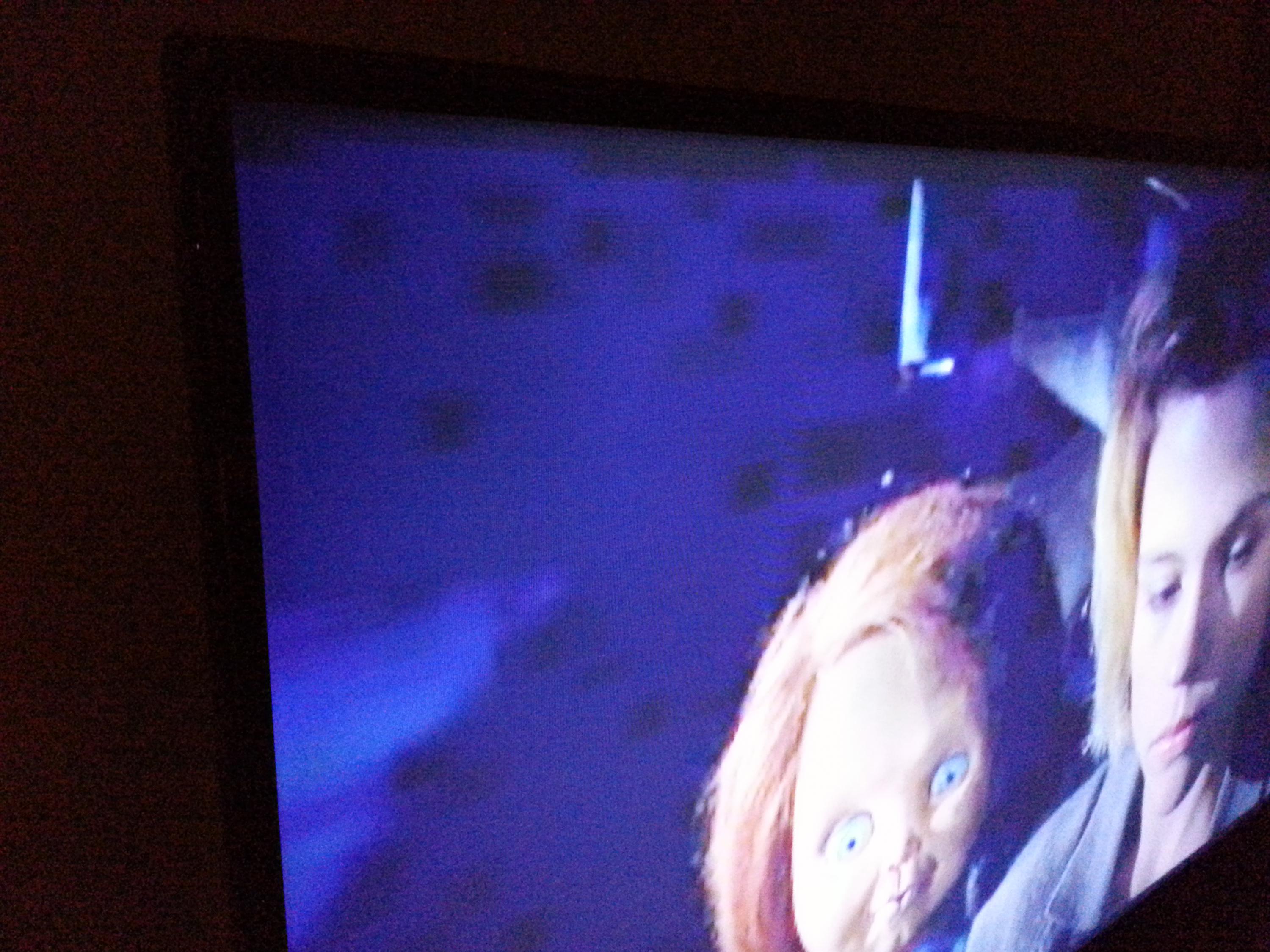

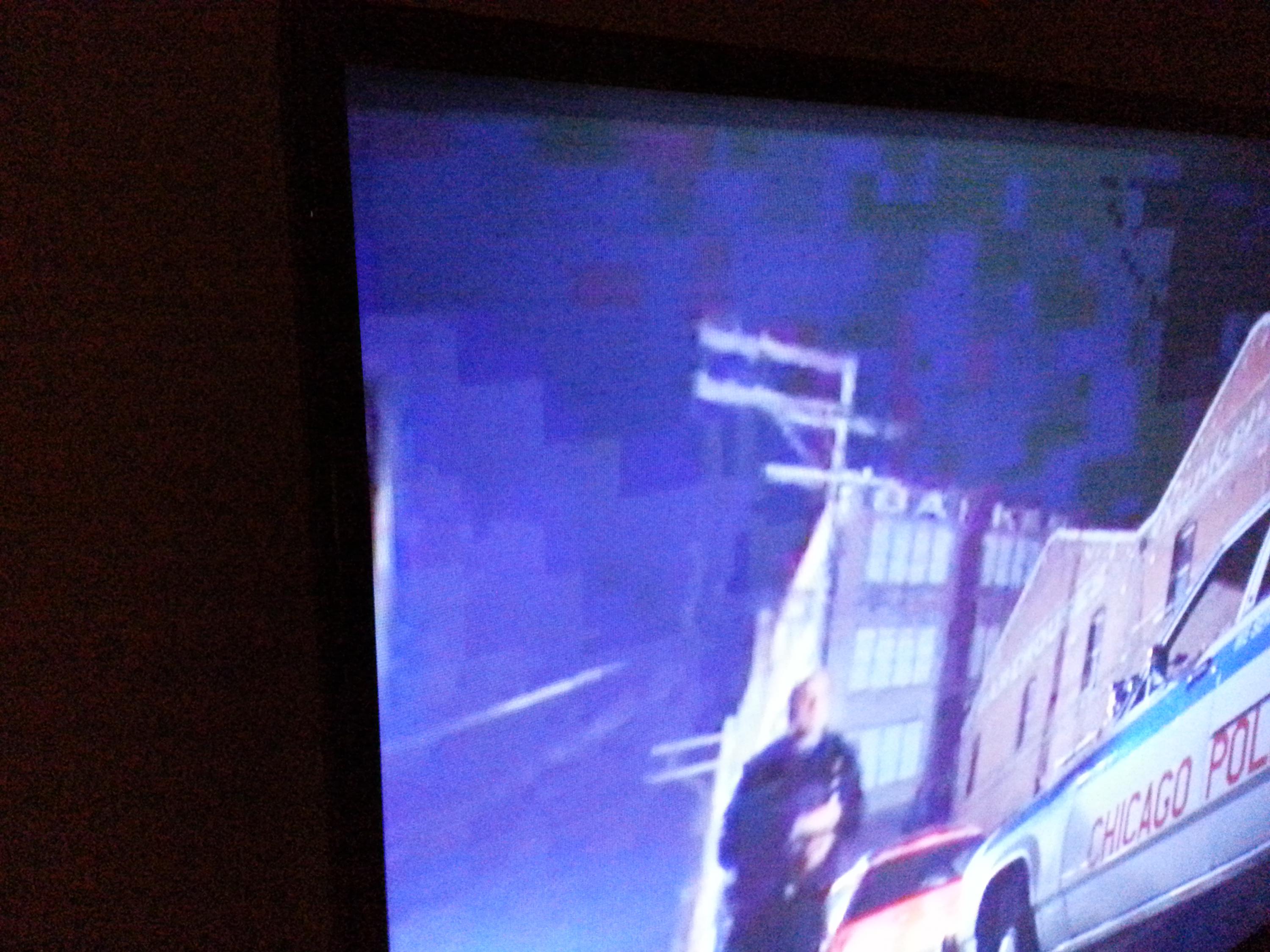

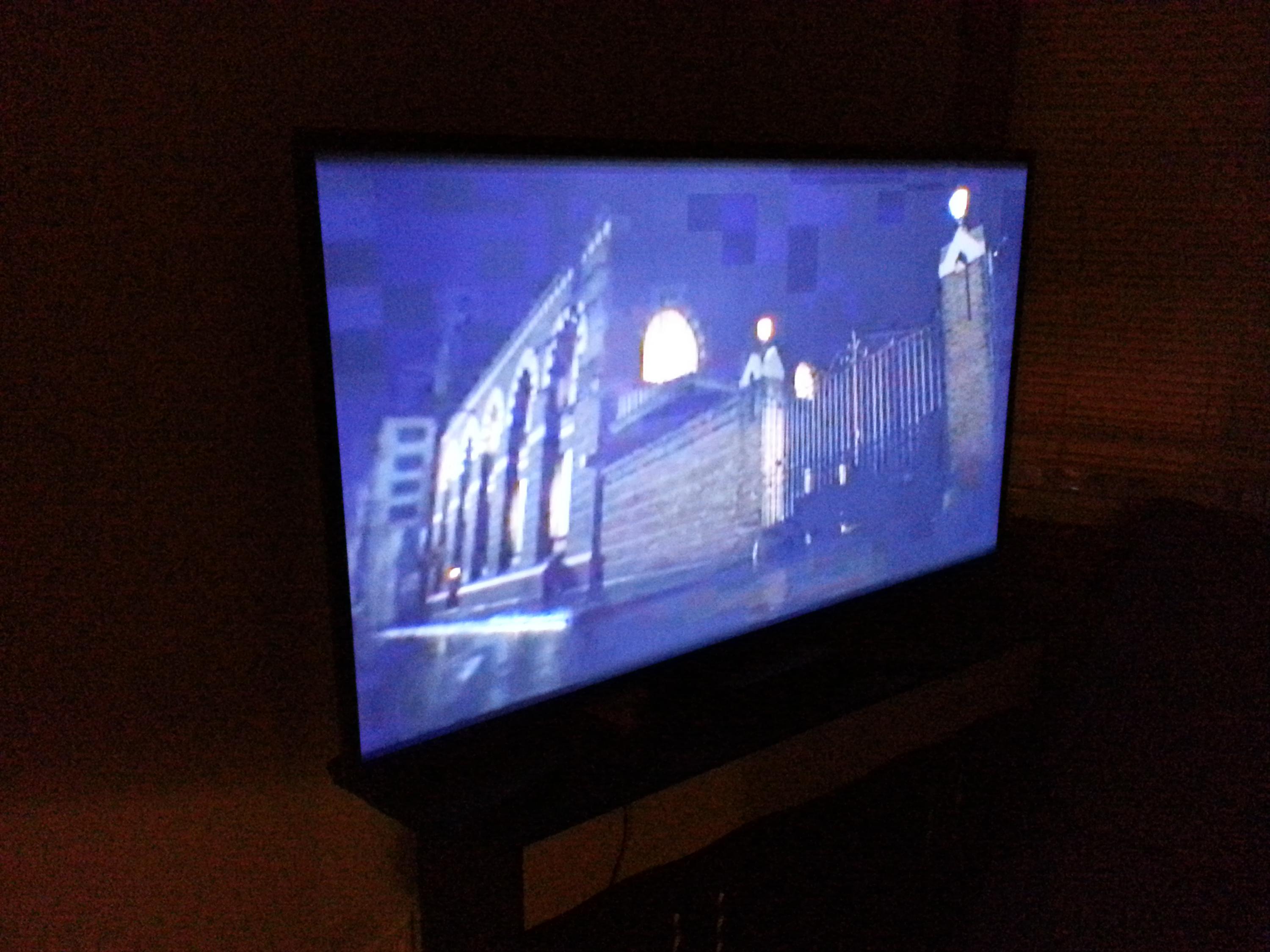

    Anyways I have a 60inch that I bought last year November and the mfg warranty is about to expire
    So I wanted some input if my panel is going bad or its just the pic quality
    When im watching any movie or show and there is a night time scene or just a very dark scene the blacks look pixelated (if thats correct terminology)
    Please see pics

    Re: bad panel or just poor pic quality Samsung UN60ES6100F
    Signal processing issue on the mainboard. panel seems okay
      Could just be crappy MPEG compression. Try with gradient pattern maybe available in service menu. Also try pure HDMI with bluray or other near lossless source.
        i forgot to mention this happens when im using a wifi signal to watch netflix. not sure if that matters. but when i watch 1080p tv shows it still does it. also i dont have a blu ray player but i do use an hdmi cable for the dvd player.
        i will check the service menu if i can find it
        thanks
          Should i just call samsung for a warranty claim?
            Yeah it's under 12 month old.
