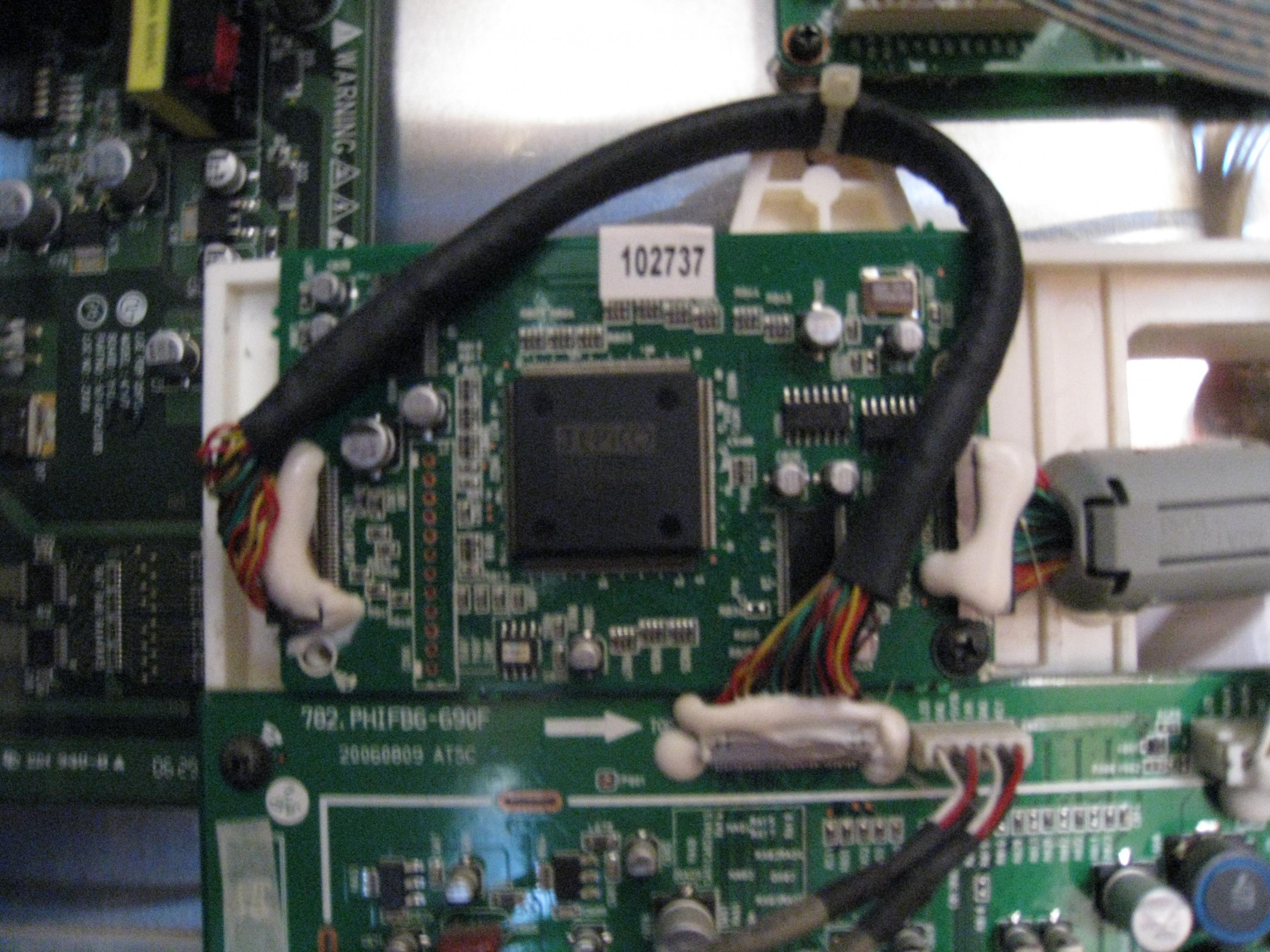

                    • MacCormac
                      • Sep 2013
                      • 18

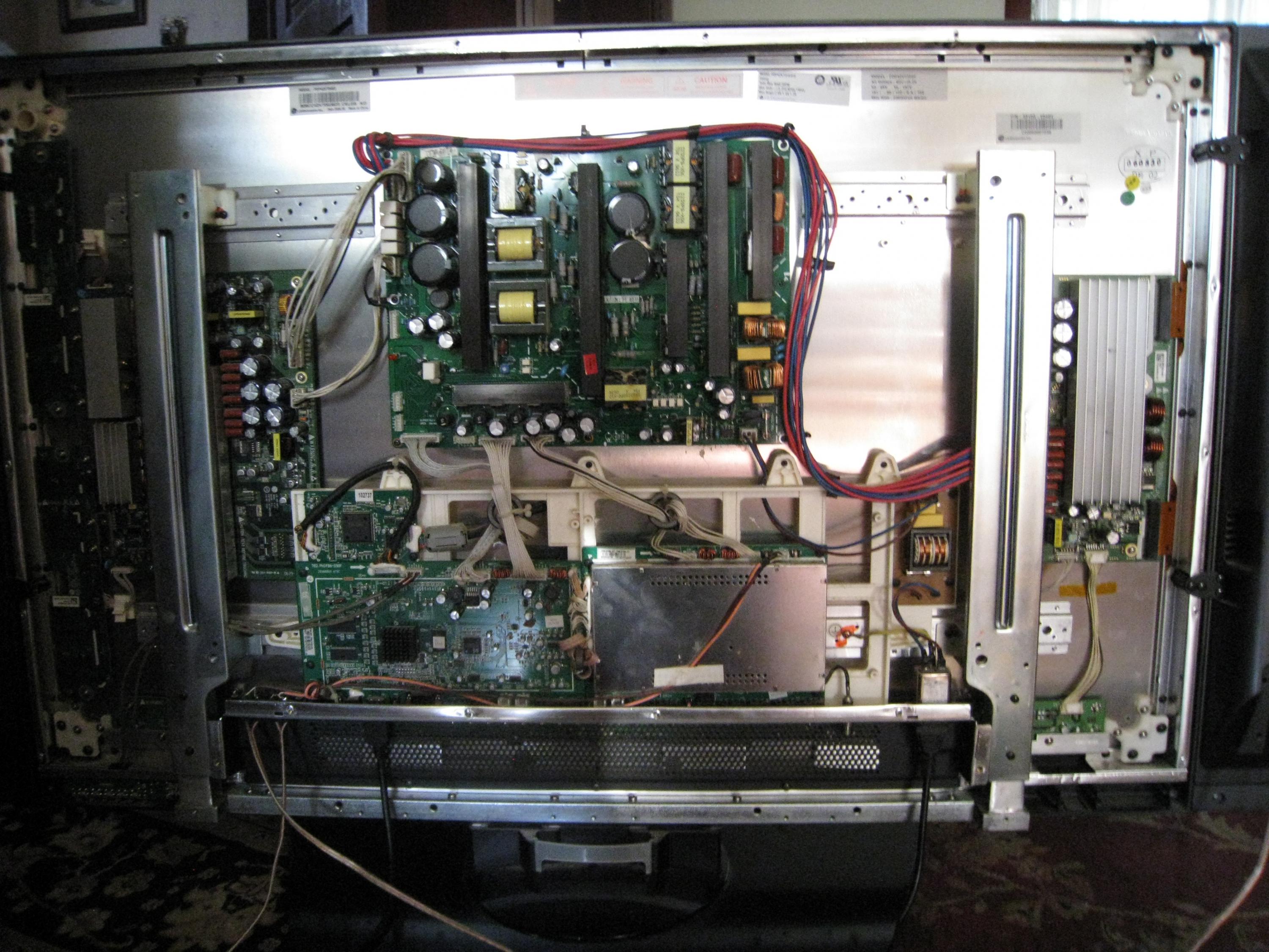

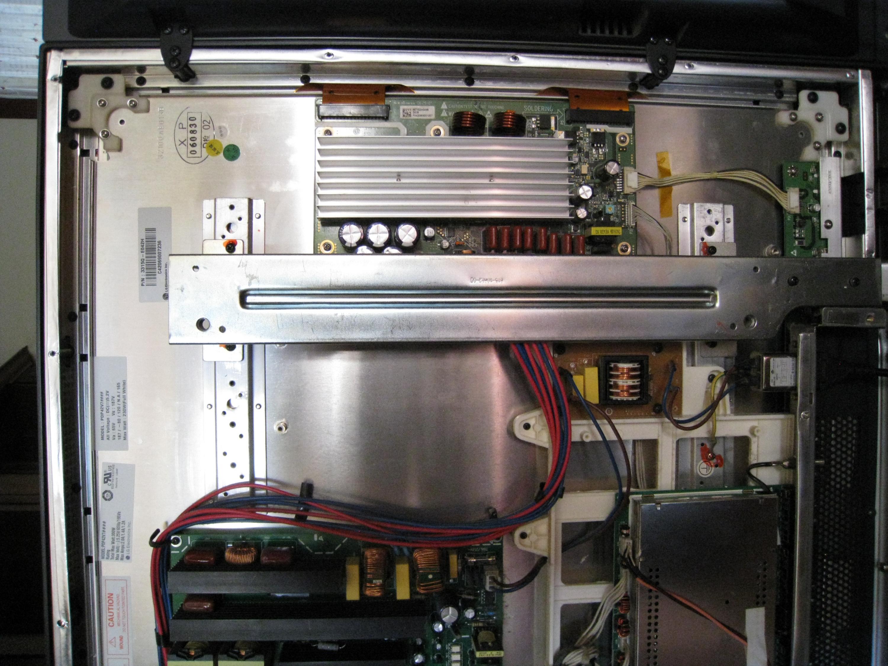

                      Re: Problems with Insignia 42" Plasma

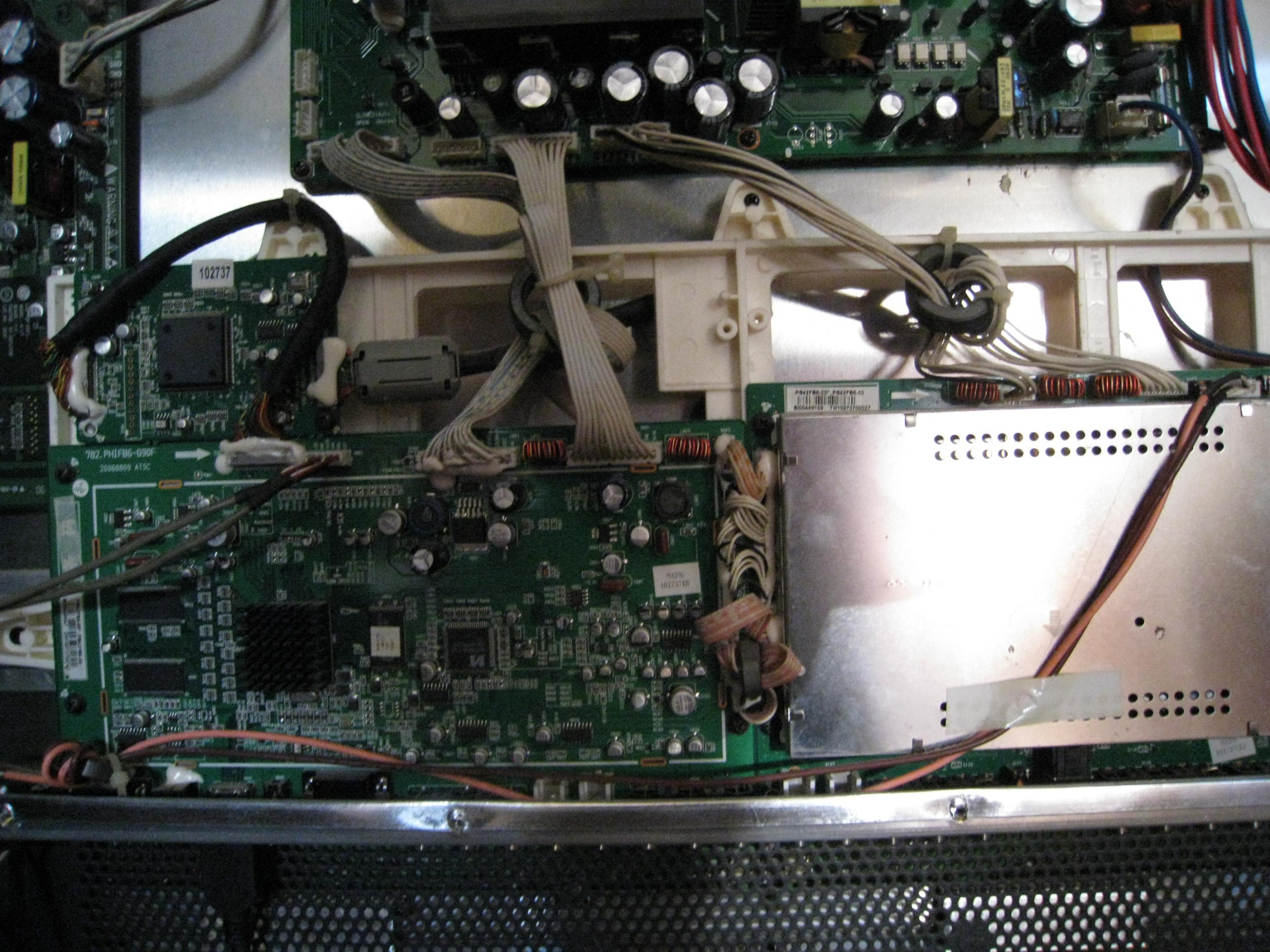

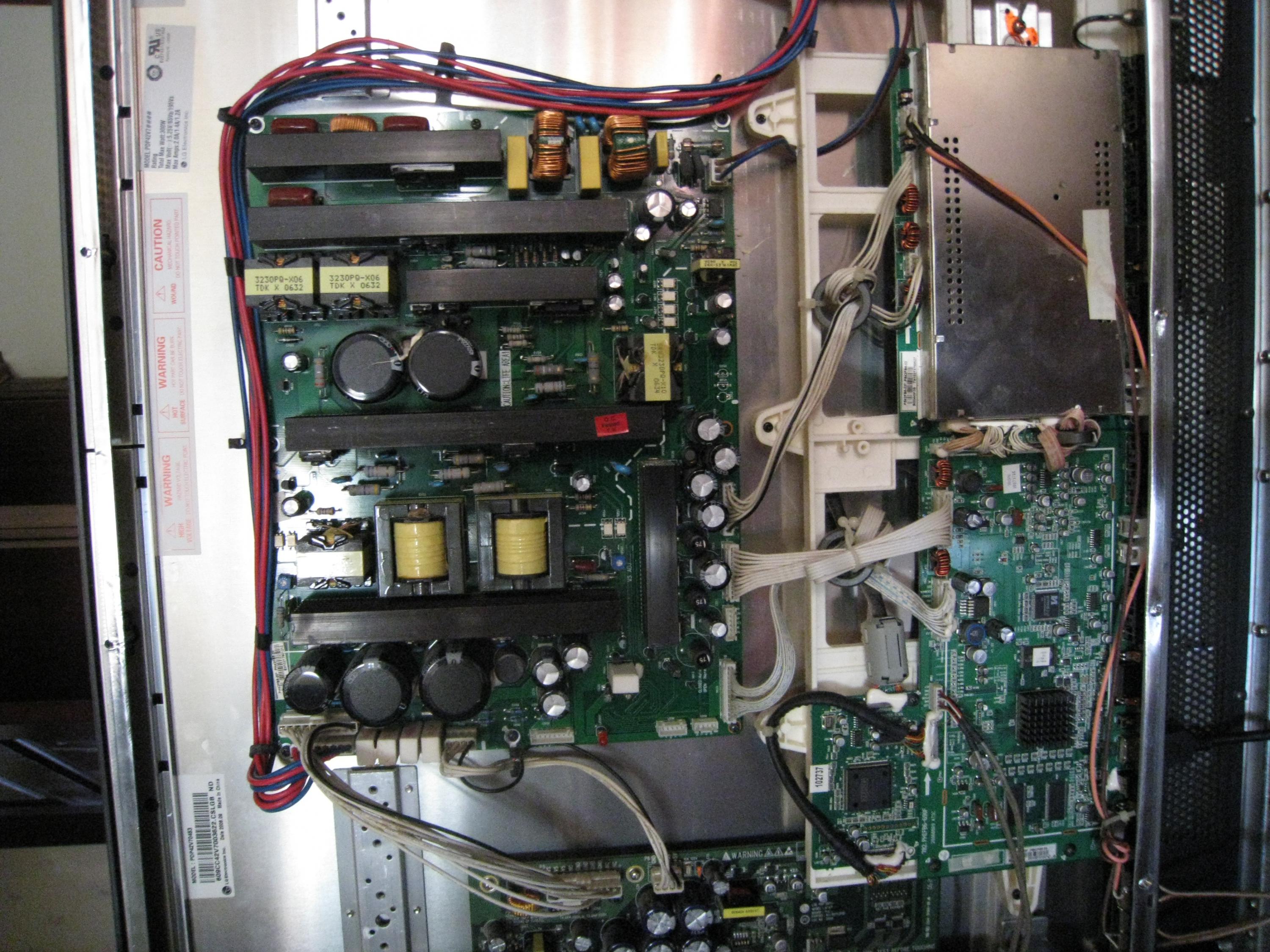

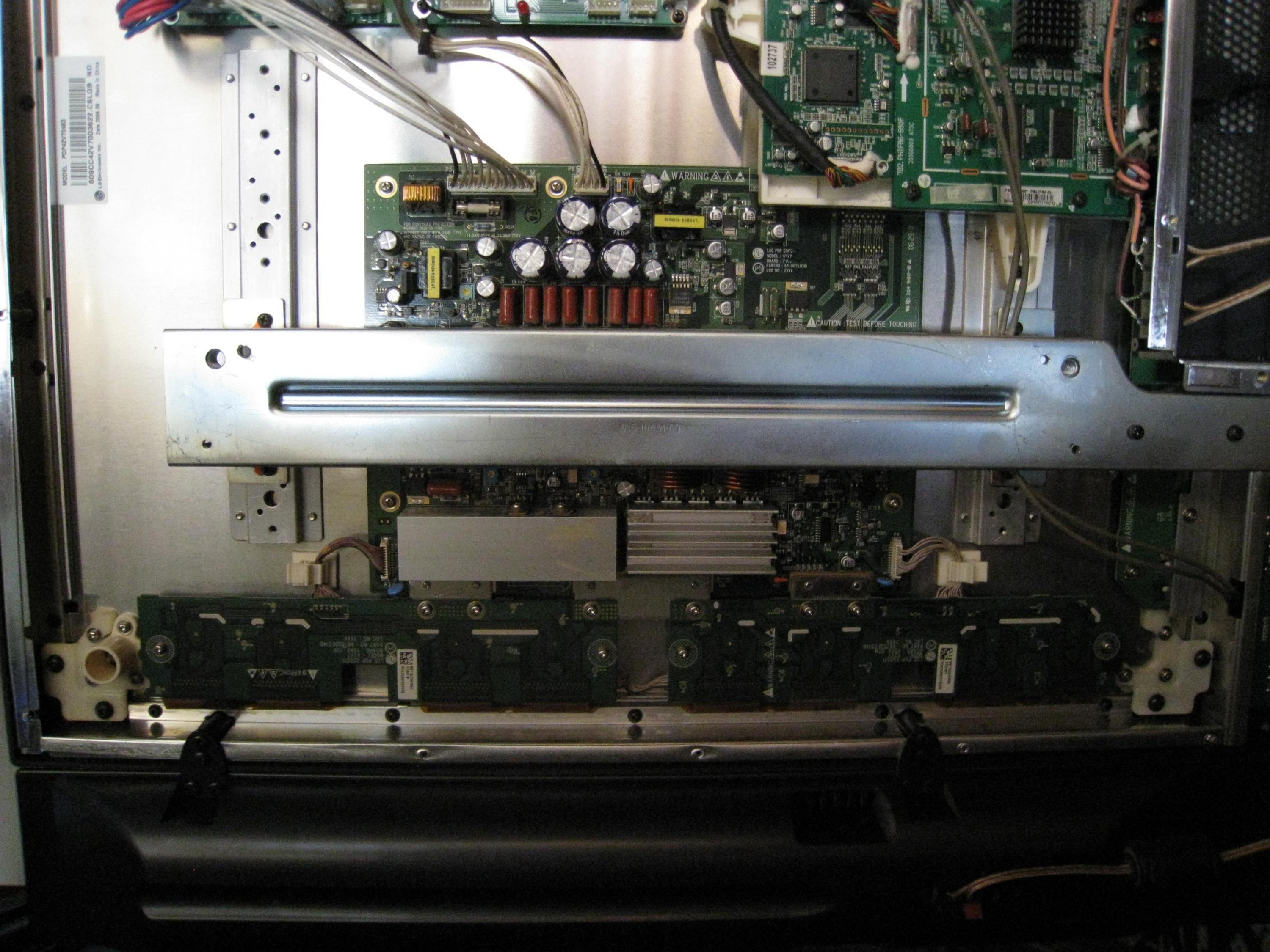

                      I've attached chasiss and board pictures
                      hope this helps
                          All Pictures
                          • MacCormac
                            • Sep 2013
                            • 18

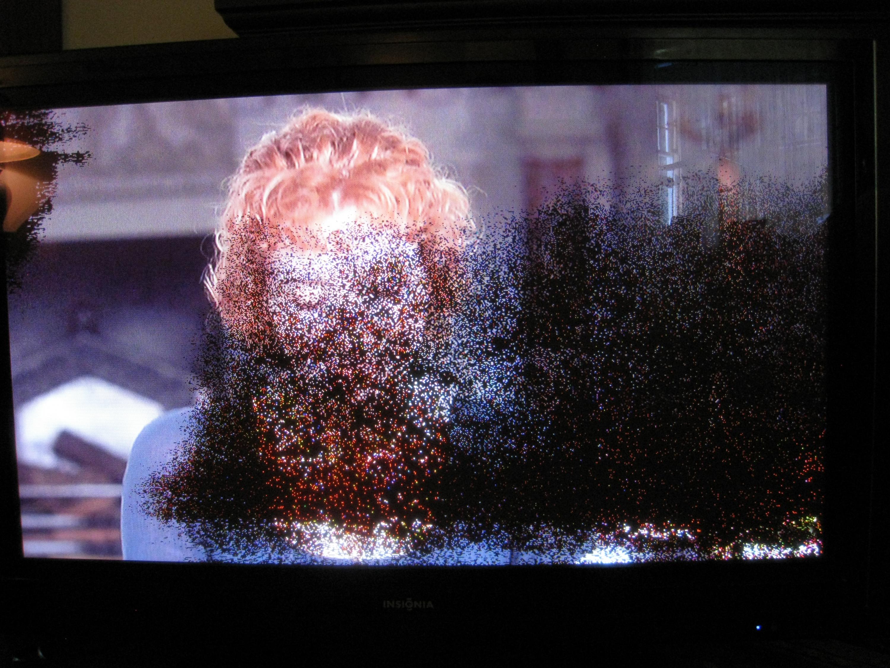

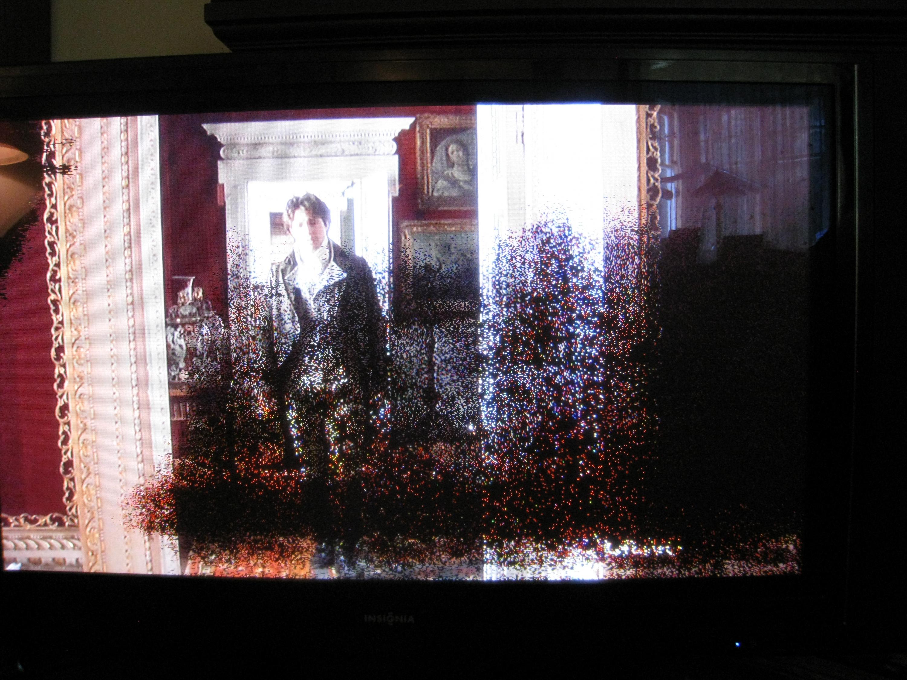

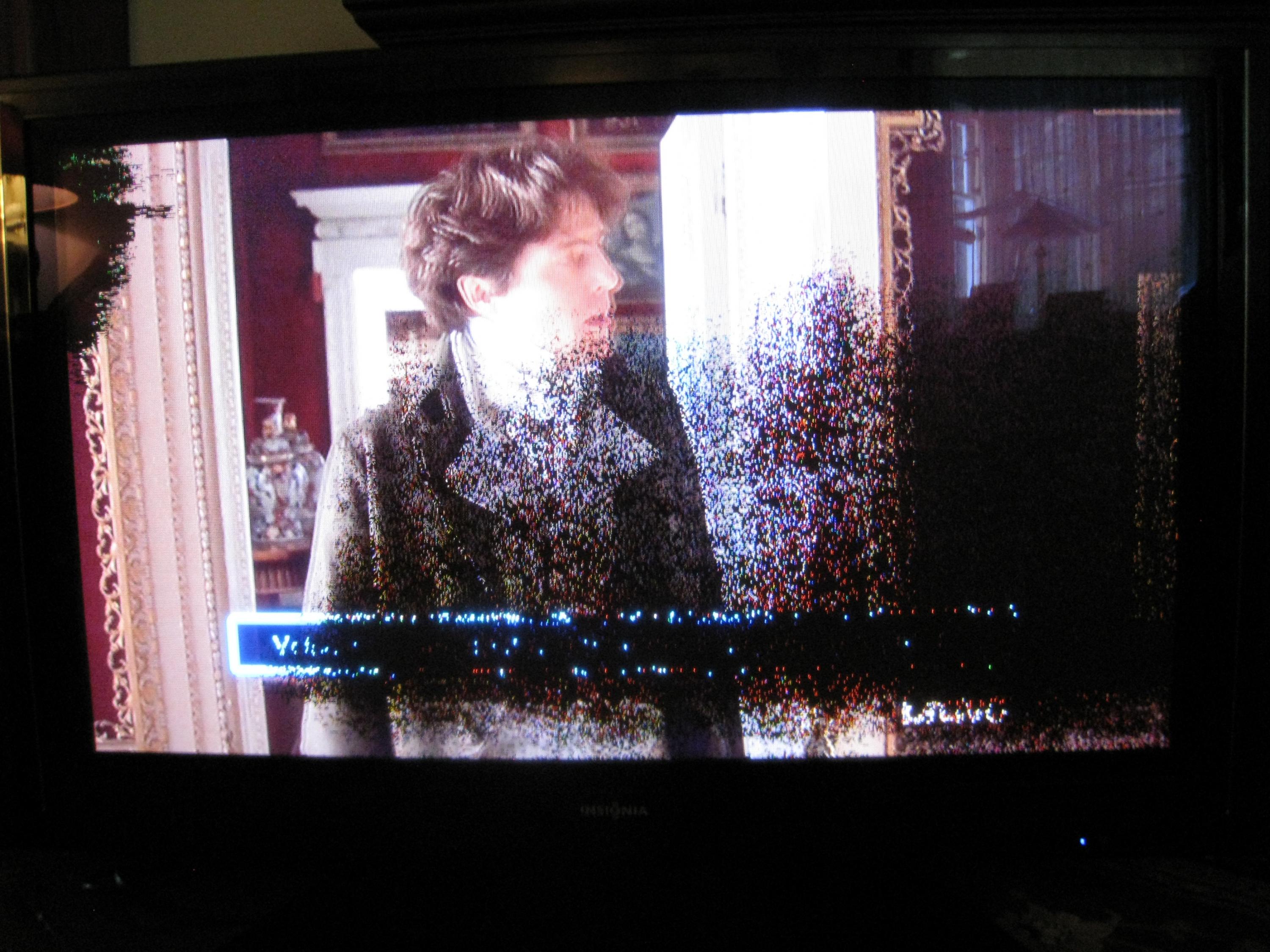

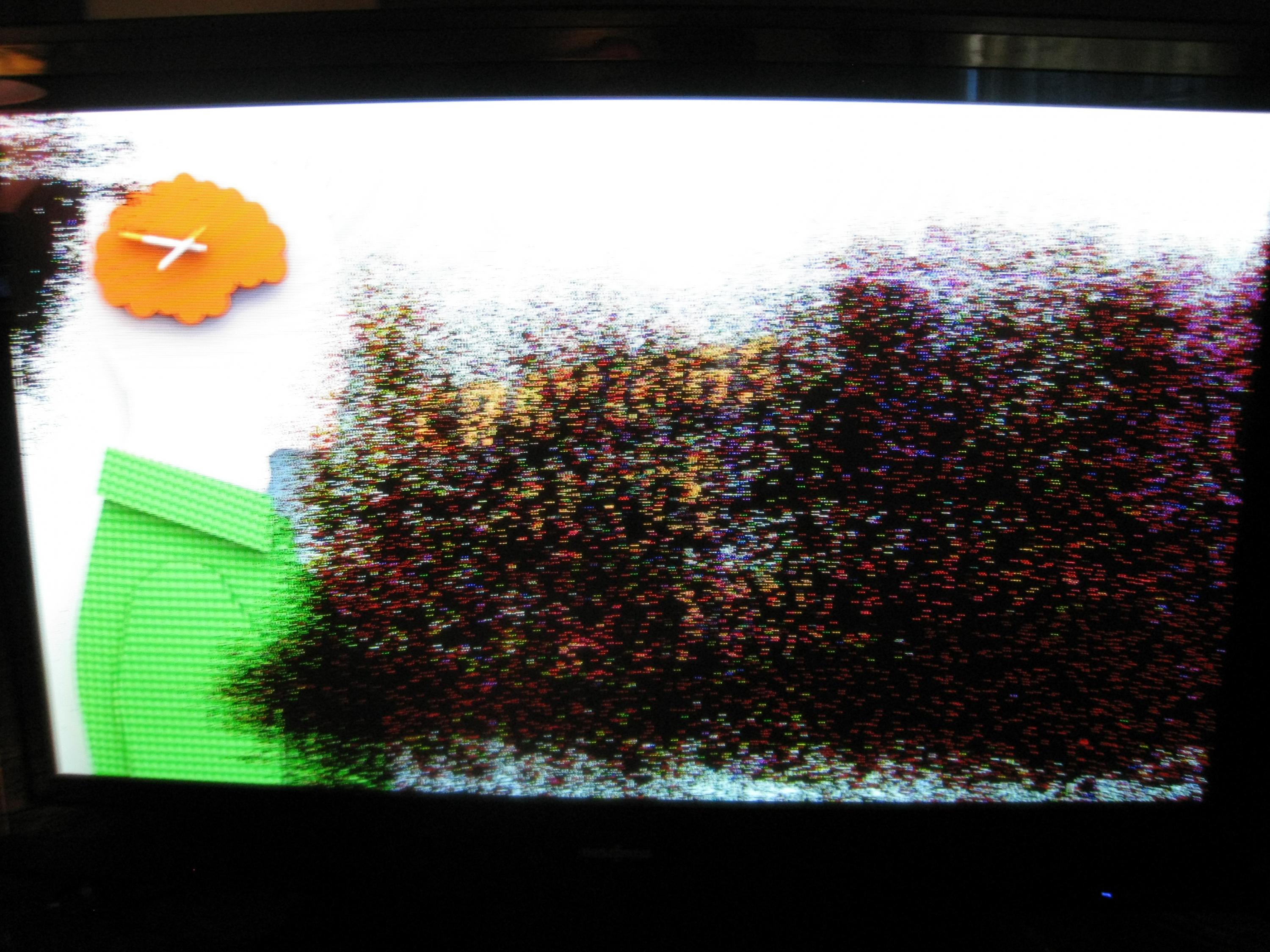

                            Hi
                            Ive gotten the plasma working again, after resoldering the Zsus and Ysus boards
                            and tweaking voltages slightly.
                            Now I'm back to the original problem of having the black spray painted look at power up ,which will disapear after approx. 4-5minutes of being on.
                            any Idea's?
                            See pictures below
                              Looks like a Z-sustain problem, check Vzbias voltage.
                              Could also be low Y-sustain Vset voltage.
                              • MacCormac
                                • Sep 2013
                                • 18
                                Also note the volume control OSD is also smeared in the last picture

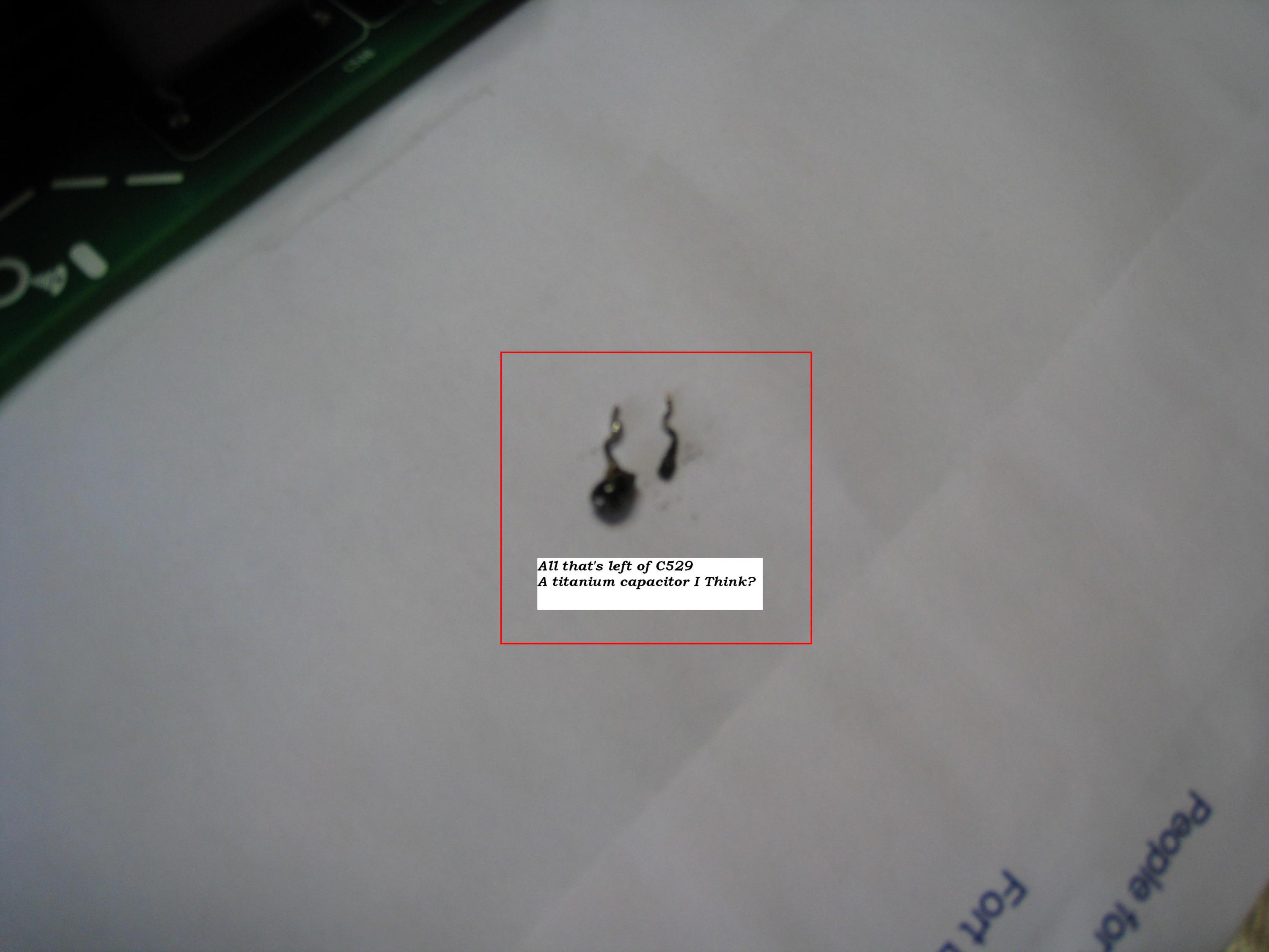

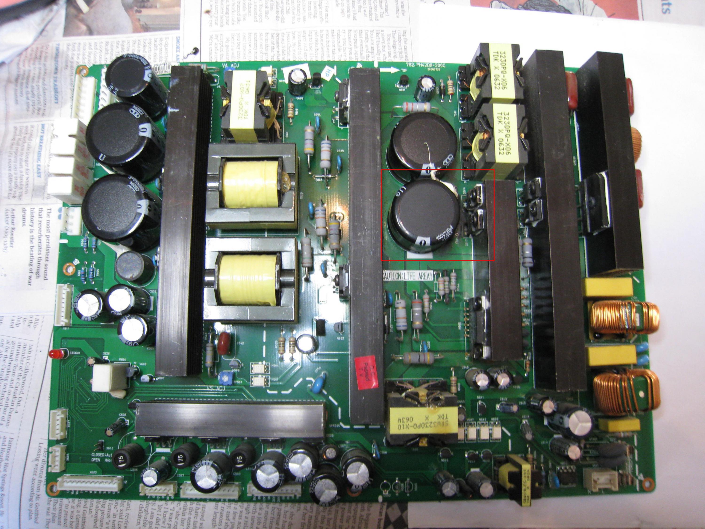

                                        Hi Again
                                        I finally had time to look at the TV again.

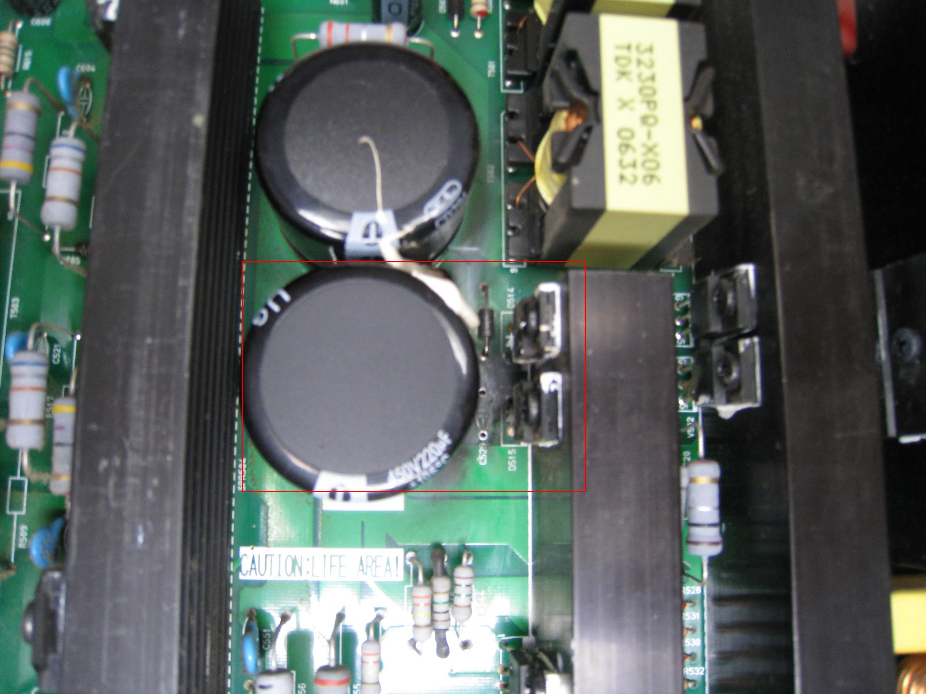

                                        This time I removed the PowerSuppy Board to try resoldering.
                                        I found that a small (titanium cap ?) capacitor C529 had burnt up on the board.
                                        I cannot identify its type and or size/value.
                                        Im posting some pictures to see if anyone can give advice.
                                        Note Diodes D511,D514 & D515 are all OK.
