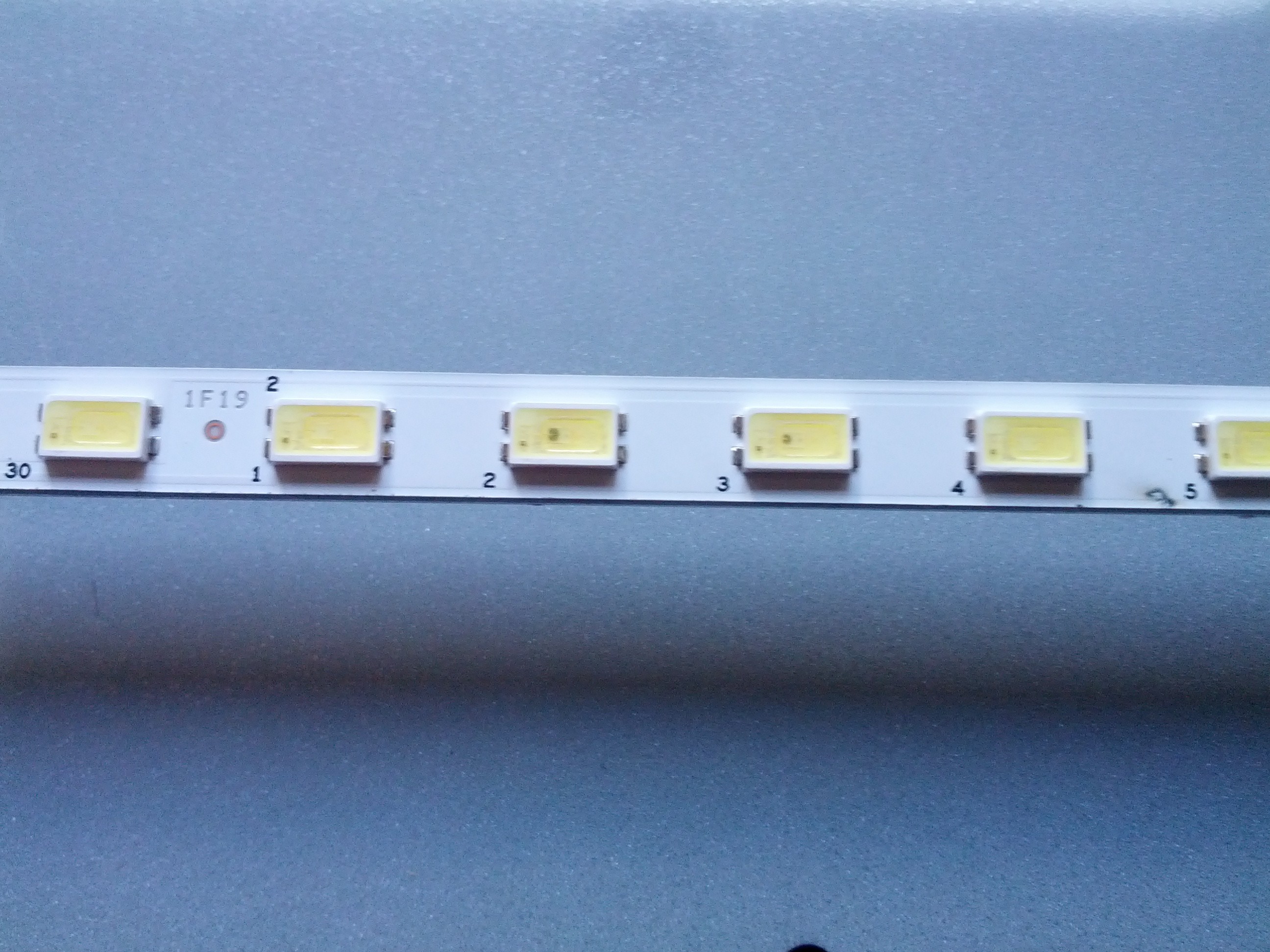

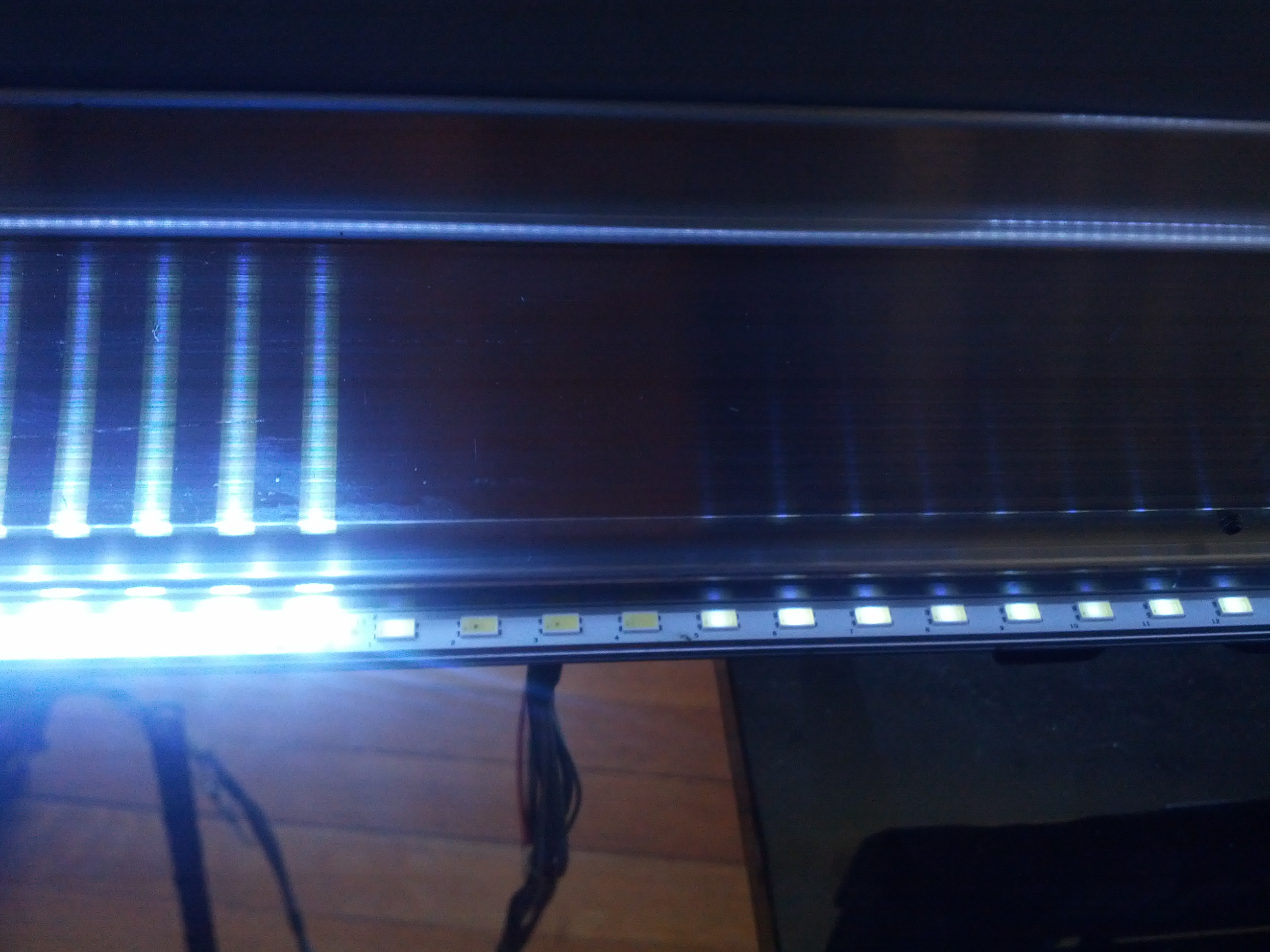

    So, definitely an led problem. Looks like led # 1, 2, and 3 are burnt. Now would it make more since to replace the whole strip, or just the burnt led's...looks like theres a slight burn mark near led #5 so that may have caused it. not sure. But where cold I get something like this. ether just the leds, or whole strip?

      Thats interesting to say the least. A chain reaction of some.type. current goees up and the draw from each led goes higher thus taking them out one by one. Look for rubbing from the panel ground. Id replace the strip if possible.

        My experience with these edge lit LEDs is that there are usually 'sections' on each strip that are hooked in series. In other words you may have 30 LEDs on one strip with 5 sections of 6 LEDs that are hooked in series. So basically if you loose 1 LED in that section, then the other 5 go out too. Regardless, I'd agree and replace the whole strip. Especially with that burn mark.

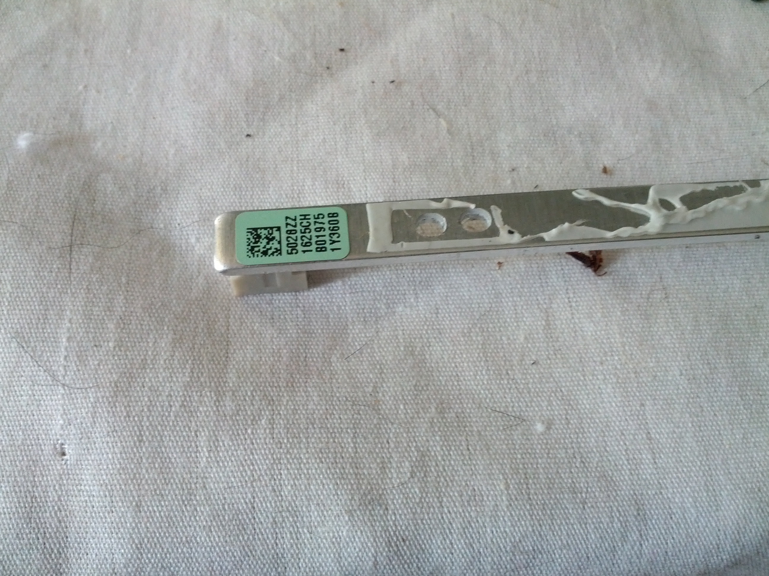

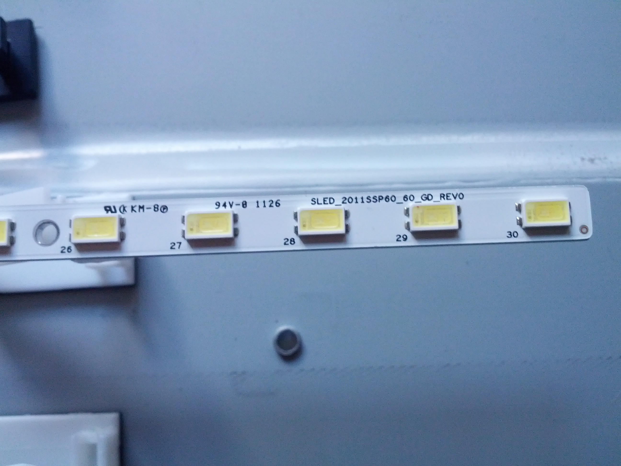

              Theres a couple of them that i could find theres a sticker on the back:
              5028ZZ
              1625CH
              B01975
              1Y360B
              and then on the front I have: SLED2011SSP60_60_GD_REV0
              For whats its worth I also have a 1f19 after the 30th LED printed on the board

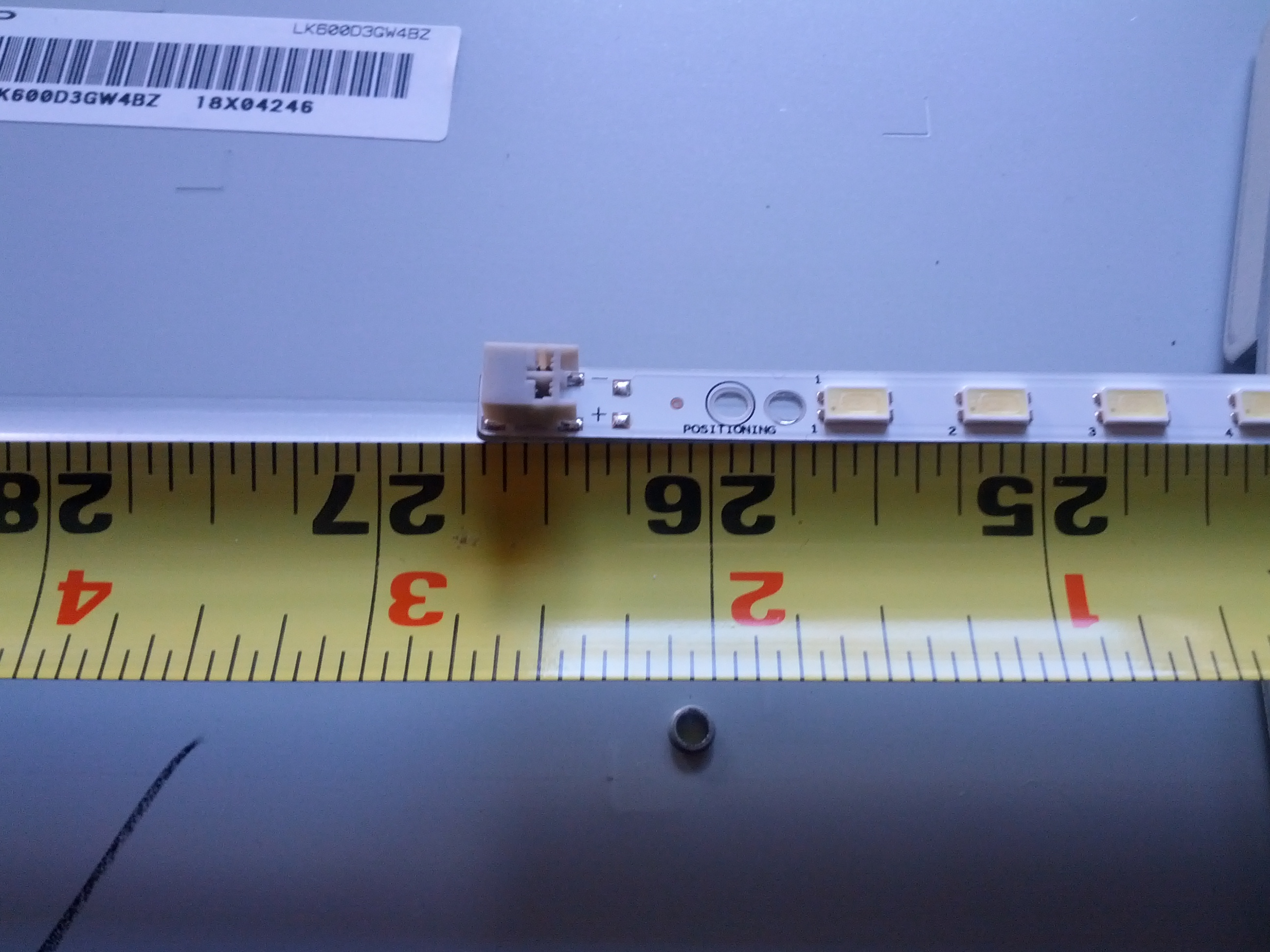

              Its about 26 and 3/4 long with 60 led's split into 2 phases of 30 leds each
              EDIT: does anyone know what wattage these LED's are.

                  No, its two strips of 60 led's each, one strip on the left side and one strip for the right. The one on the left is what i need, and the strip is about 26.75" long including the power connector.

                    No go on the strips. These are on the side and only about 11" long. LEDs look different too.

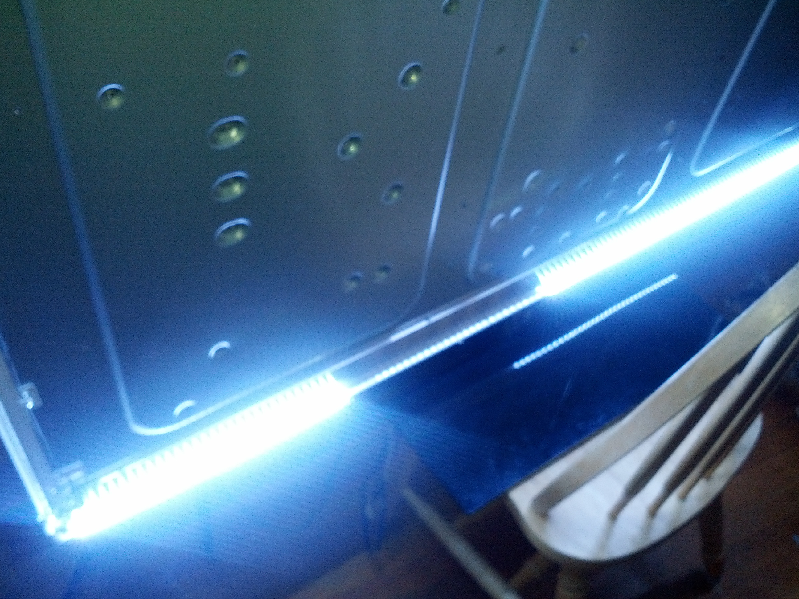

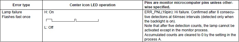

                                    So......I may have done a stupid thing......This backlight is on special order and am told could be up to 3 weeks before I get it. So i tried plugging in my tv without the led strip, it lit up for about 30 secs, and the went out with the 1-1 error....thought no problem, when i get the new one it will come back(this thought was before i would later find out it would be 3 weeks) so once finding out it was going to be 3 weeks, I just said while im waiting il plug in the old one and use it till the new on comes in.....well i cant get this 1-1 error to go away with the old let strip plugged in.
                                    I have tried every reset combination out there (Vol-/Menu/plugging in, Vol+/Chan-/plugging in, Vol-/plugging in, Input/Vol-/plugging in) and so far nothing. This all from the buttons on the tv its self, which are btw touch sensitive. Iv done some reading on line, and a couple op other posts say that i need a new main board.....but i don't believe that since i plugged in without an led it would blow my main board...at least id hope not.
                                    The service manual was no help...tells me to clear it out in the "monitor process" what ever that is...also the manual makes some references to "process A" and "process adjustment remote control".
                                    So is there anything I haven't tried?......I really hope I just didn't blow my main board.
