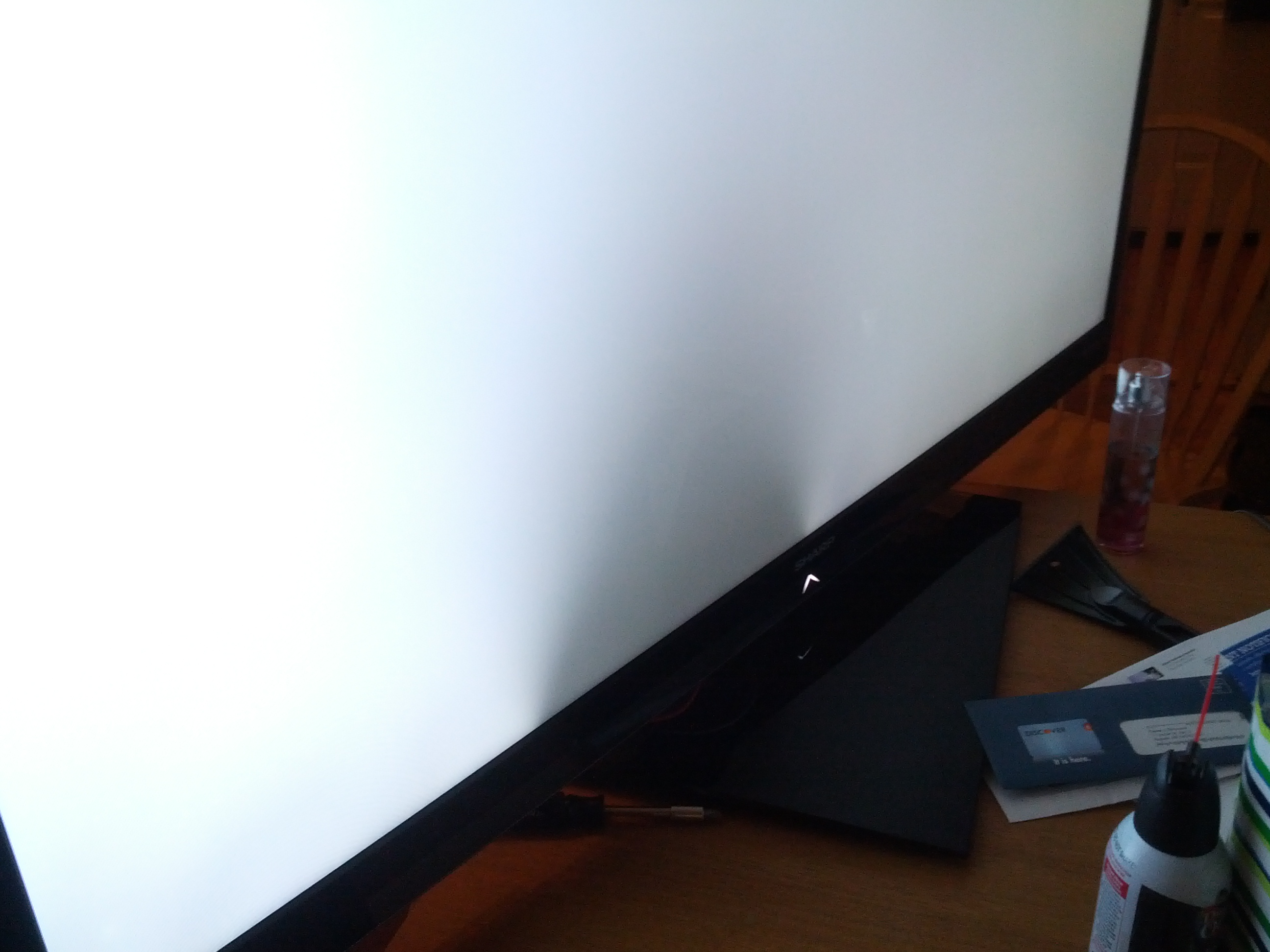

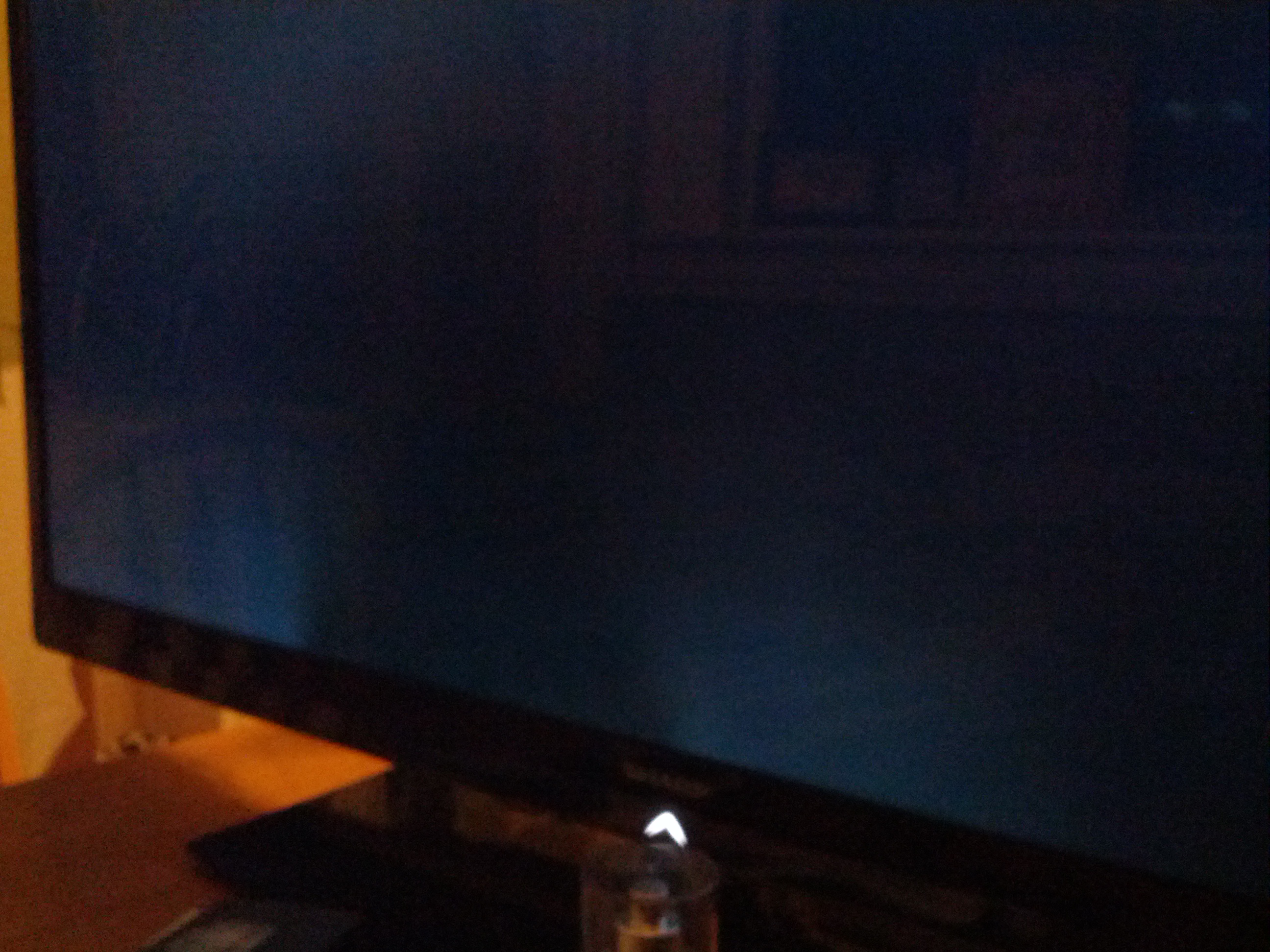

                Got the main board in today and replaced it, and its working, yay.....but now another slight problem.....I have a brown are in the bottom left-center where it looks like maybe a set of led's or went out. Would this be a t-con board issue, or bad set of led's? And if it is the led's, how hard is it to just replace, or repair the led's in the section? Or is is just going to cost me to much, and to just live with it?
                TIA
                  Re: Help with a Sharp LC-60LE835U
                  Yeah that looks like bad LEDs to me but double check all panel connectors from the LED driver board.
                    Damn......I'll look at that later....how hard is it to replace/or fix led's.
                      It's like Xmas lights. One LED goes bad, all in that strip go dark. You can use a coin cell battery or a good multimeter (Fluke et al) to test them. Most cheaper meters don't give a higher enough open circuit voltage for testing white LEDs (3V minimum, 3.5V~4V ideal.)

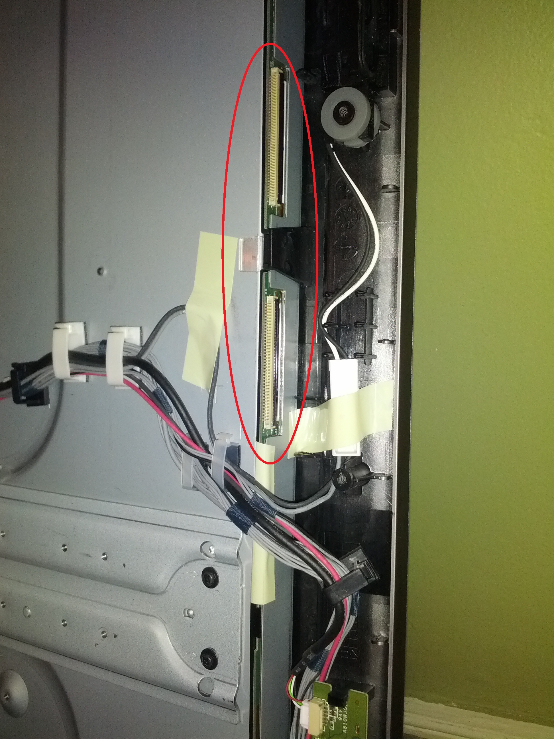

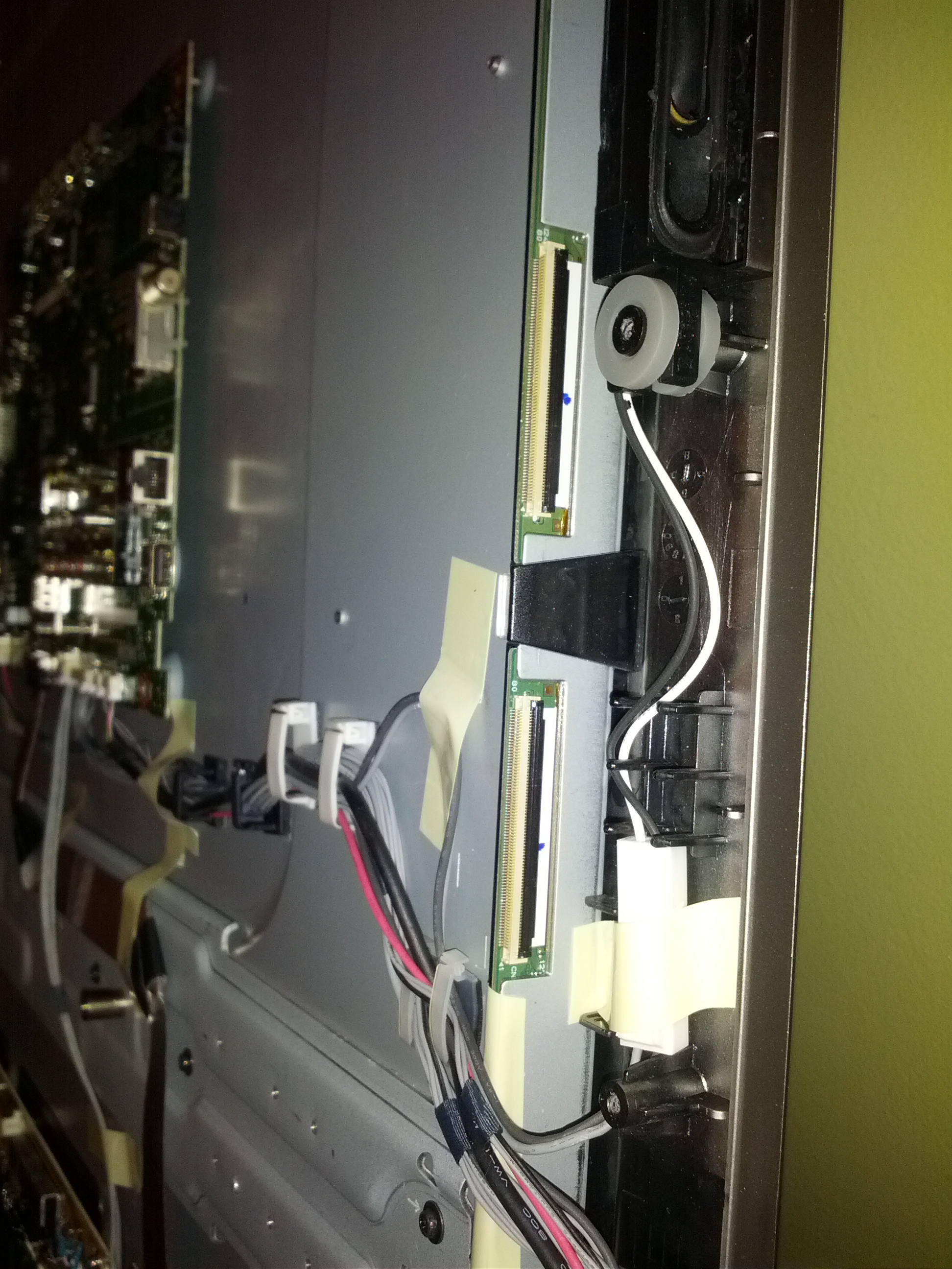

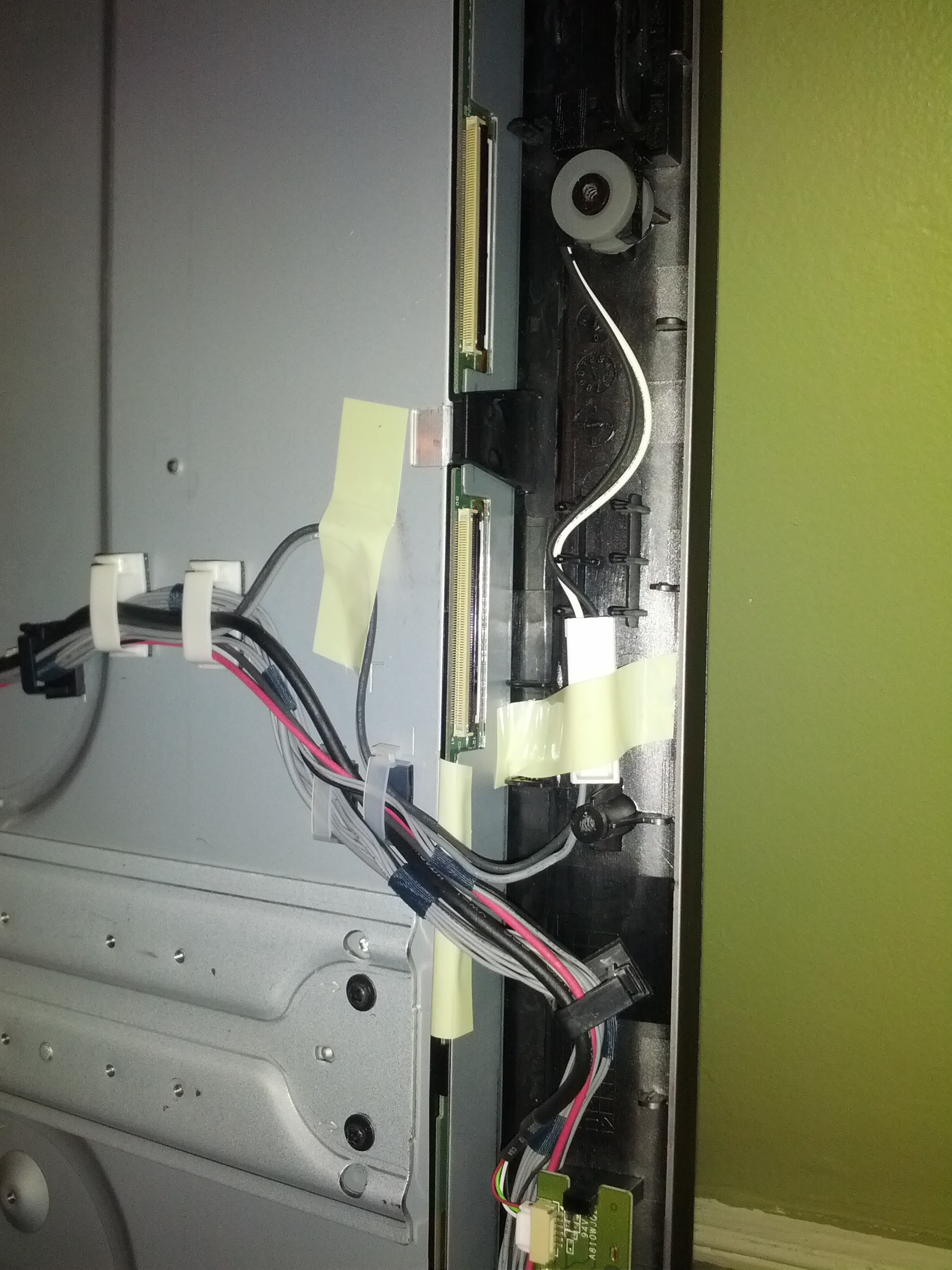

                              ok now im confused..I believe i read somewhere that this is an edge lit led. I have 4 ribbon cables going to the panel its self from the t-con. Which are the only cables connected to the panel. I unplugged the cables, and re-seated them but still nothing, actually got it to do a 5-2 code, but that went away after i plugged back in the cables. now on the underside it looks like there are two more ribbon cables, which im going to assume do directly to the led's, but couldn't actually re-seat the cable, because its under the metal housing of the tv frame its self... iv attached a couple of pics to show what im talking about.

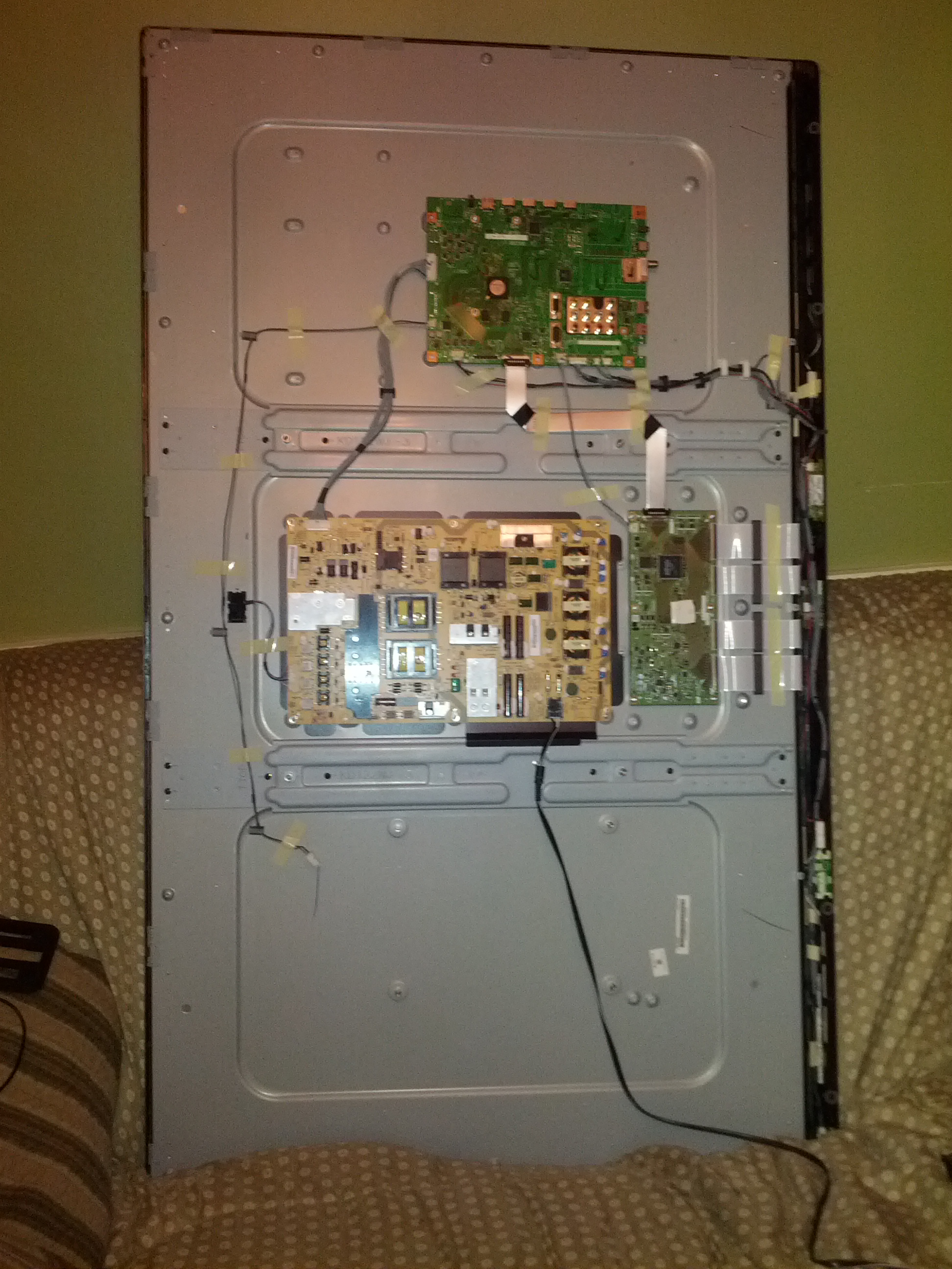

                                Disregard what I said about the blue and whire connectors. The 5-2 code is a tcon error. Thats normal if the connections are removed from there. maybe I'm missing something but I'm not seeing where the led cables going to the panel on your pictures at all. That's an interesting chassis

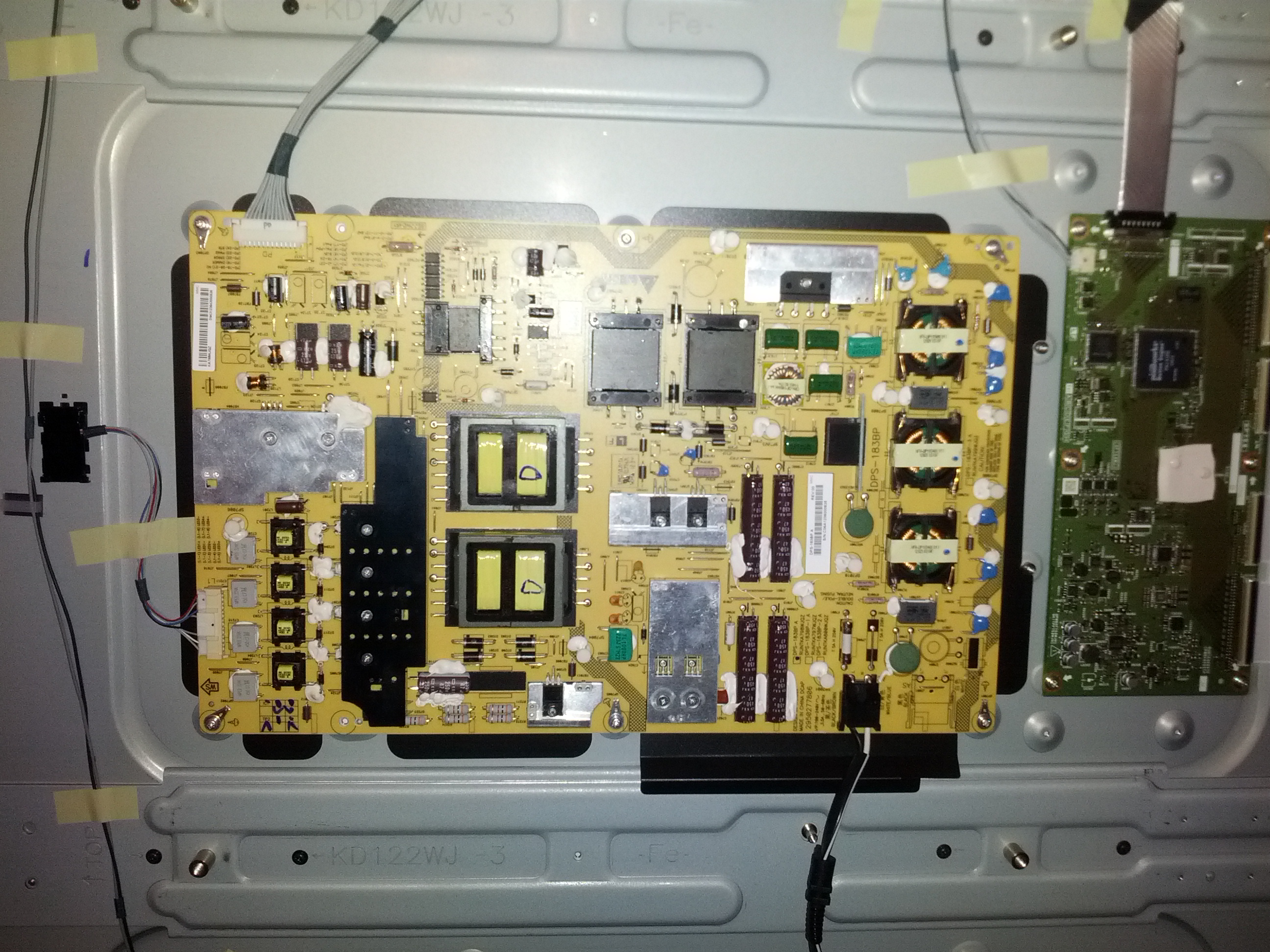

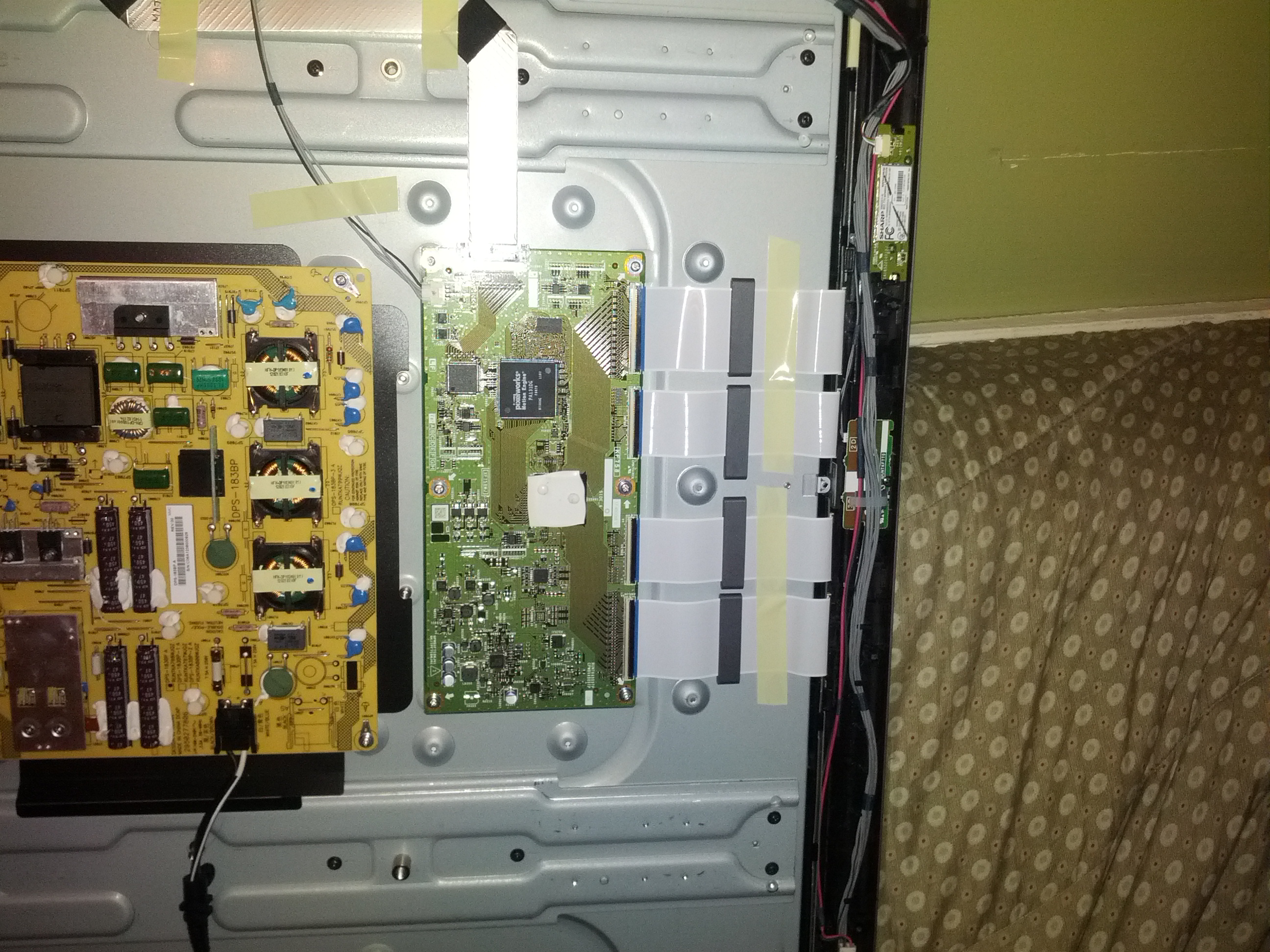

                                  I believe it was the white and black connector that you removed from the tcon. Thats power to the tcon. That will give you a 5-2 code. can you take a full picture of the power supply please

                                      I got a pic of the whole chassis, and one of just the power board.
                                        Heres a pic from before with the highlighted area of where I couldn't get to, and another at a different angle to get a better picture of it.
                                        EDIT. this is the same area on the lcd of where its dim.
