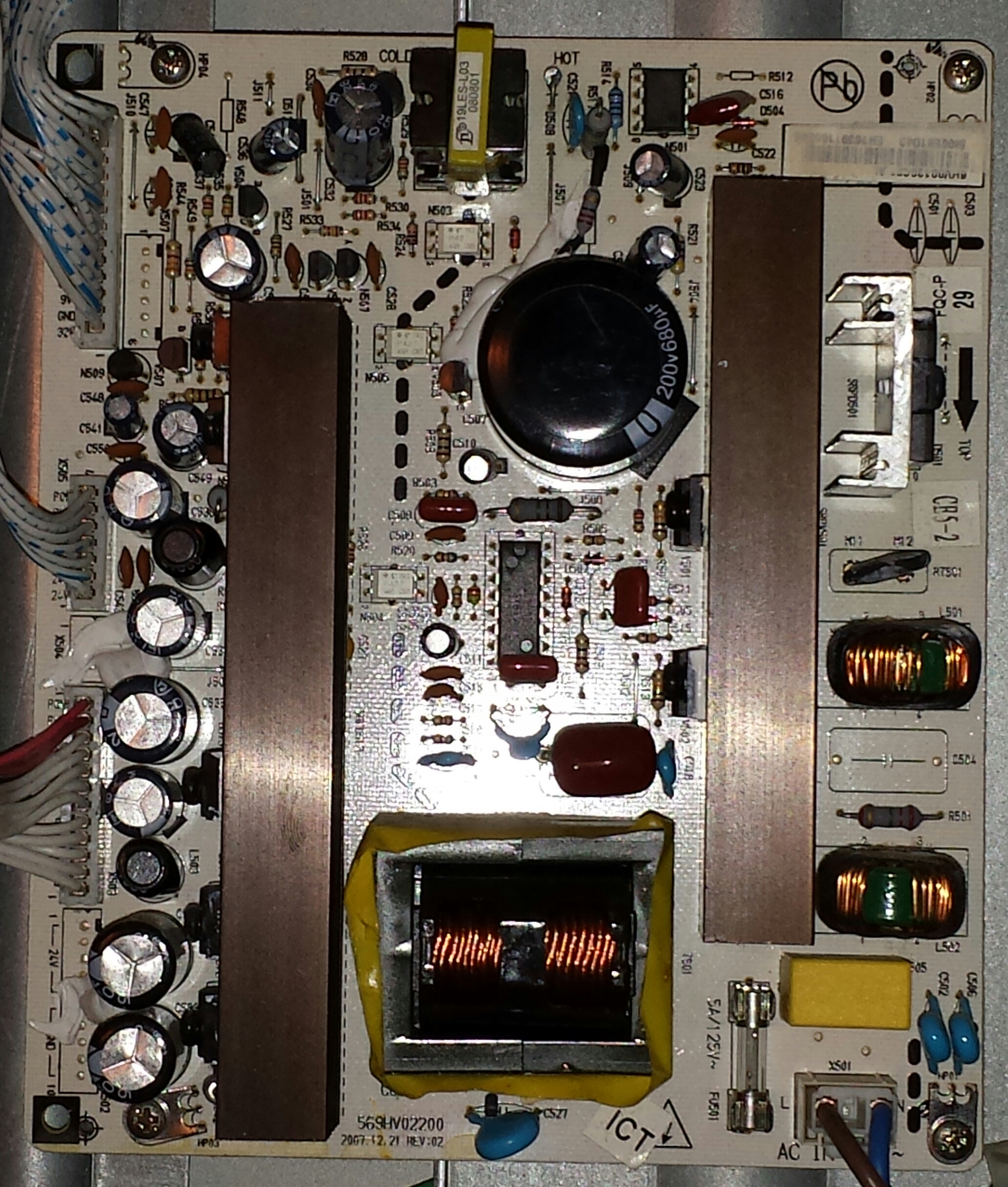

    Starting with the power board.
    Top connector
    PON. 2.4v
    Gnd. OK
    5v 5.15v
    Gnd. OK
    Gnd. OK
    16v. 15.5v
    16v. 15.5v
    Gnd. OK
    5v. 5.09v
    Gnd. OK
    9v. 9.09v
    Gnd. OK
    32v. 32.37v
    Middle connector
    PON. 5.166v
    PWM. 3.39v
    Gnd. OK
    Gnd. OK
    Gnd. OK
    24v. 23.75v
    24v. 23.75v
    Bottom connector
    PON. 5.166v
    PWM. 3.39v
    Gnd. OK
    Gnd. OK
    Gnd. OK
    Gnd. OK
    Gnd. OK
    24v. 23.75v
    24v. 23.75v
    24v. 23.75v
    24v. 23.75v
    24v. 23.75v
    Can't check voltages across PFC without flipping the power board and I don't think its necessary. Voltages all seem correct. Getting P/ON signal from main. 24v is present so power board is coming on. I was pretty sure it was an inverter problem when I first plugged it in. Certain of it now. I'm just trying to develop a protocal I will follow on every set I work on.

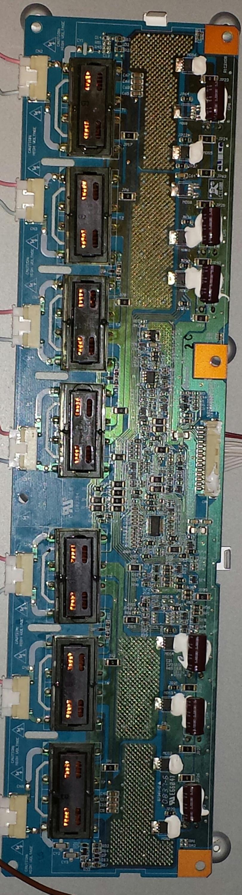

    Beginning testing on inverter board now.
    PWM. 3.38v
    PON. 5.16v
    Pin 4. 3.23v
    Gnd. OK
    Gnd. OK
    Gnd. OK
    Gnd. OK
    Gnd. OK
    24v. 23.75
    24v. 23.75
    24v. 23.75
    24v. 23.75
    24v. 23.75
    Voltages all seem correct. P/ON signal present.
    Beginning testing resistances on transformers now. Since the pins are not numbered I'll call the top left (connector side) pin 1 and go clockwise to 8. From what I can tell from the resistances, testing should be across pins 1 and 8, and, 4 and 5.
    T7
    1-8. 966 ohms
    4-5. 975 ohms
    T6
    1-8. 974 ohms
    4-5. 968 ohms
    T5
    1-8. 977 ohms
    4-5. 973 ohms
    T4
    1-8. 971 ohms
    4-5. 973 ohms
    T3
    1-8. 969 ohms
    4-5. 1090 ohms
    T2
    1-8. 968 ohms
    4-5. 974 ohms
    T1
    1-8. 951 ohms
    4-5. 956 ohms
    At this point I'm thinking maybe T3 is bad. Maybe T1 as well. I'm going to post this now to get feedback. Meanwhile, I'll look for a service manual or at least a data sheet for the PWM IC.

    T3's readings do seem a tad high.

      Over 100 ohms higher than the rest. Yes, I think that may be it.
      ------------signature starts here------------
        Re: Dynex DX-LCD32-09 wont turn on. Lights for half second.
        I agree that T3 dose look bad.

          I'm going to look for a replacement. I looked into just replacing the board but its $60-$70. I'll look and see what a new transformer will cost.

            Wish I could pull one from a different board just to see if it is the problem. I have some with the same number of pins. Footprint probably different. If the resistances are the same, could I just solder wires to it and the board just to test it?

              Sometime it is cheaper to buy a board so you will have spare transformers, more likely the other will fail too, if you can find the board real cheap or if the transformer can be had for less than $5 then you can see which way will be cheaper. If you going to sell the TV then buying the transformer will be cheaper than buying the board.

                  Other transformers. I did that before, replace one transformer, the a few month later another one failed, I should have bought replacement board to have spare parts from the old board.

                    These are both the exact same inverter boards. One is from an Element and is about $40. The other is from a Dynex and is about $70.
                    http://m.ebay.com/itm/251279072662?nav=SEARCH&sbk=1
                    http://m.ebay.com/itm/190882564273?nav=SEARCH&sbk=1
                    Transformer number is 2874015400. Its about $9 plus shipping.
