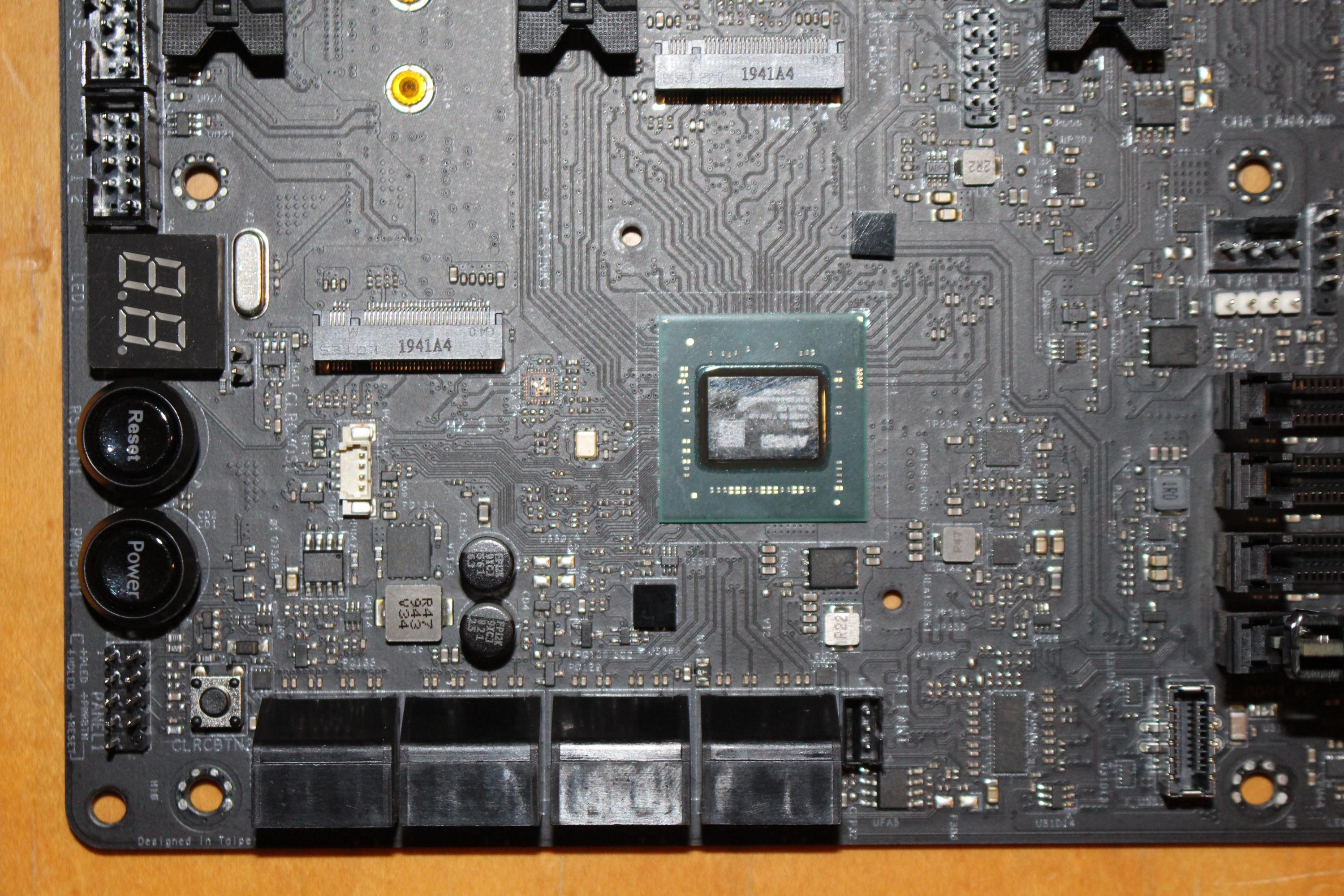

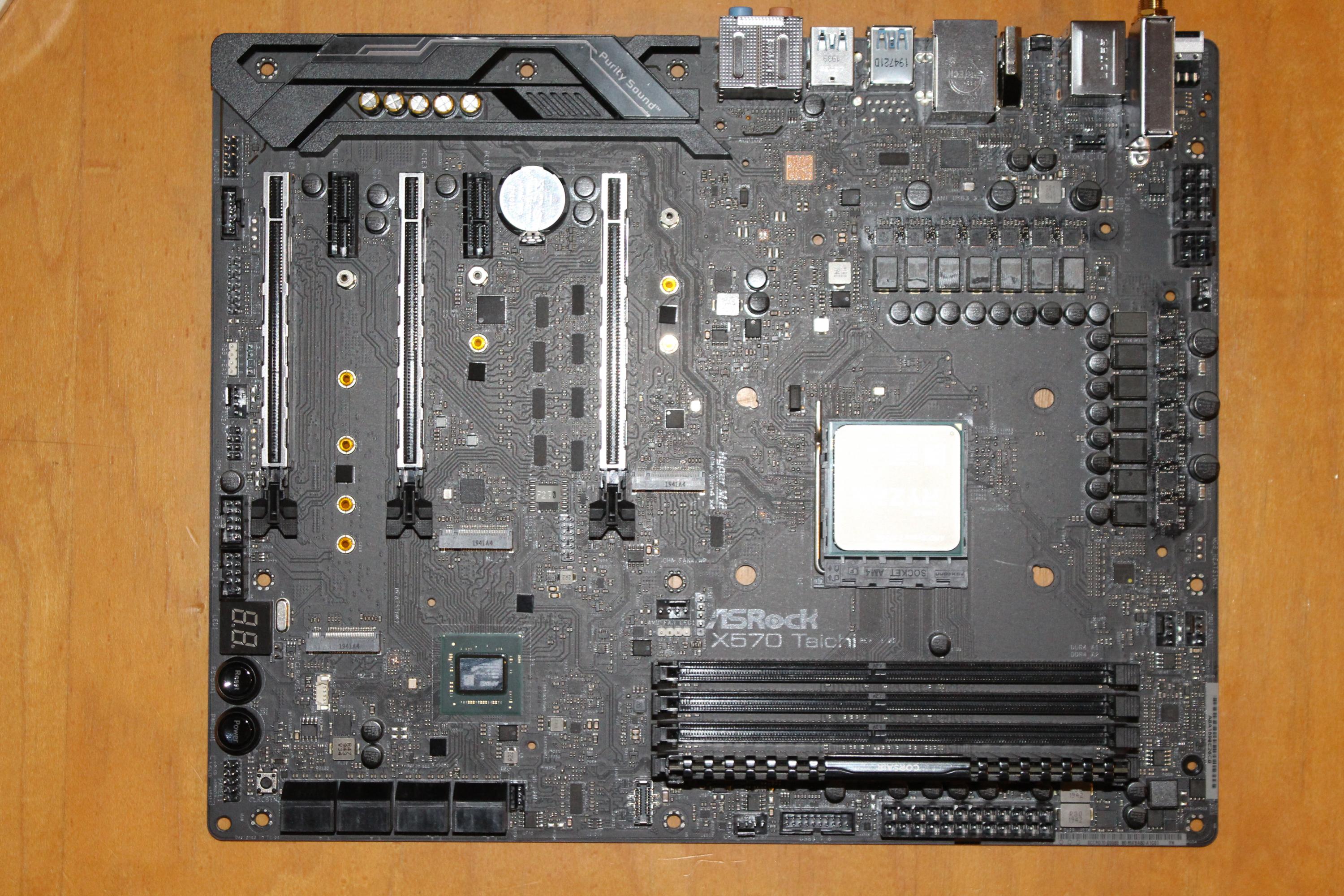

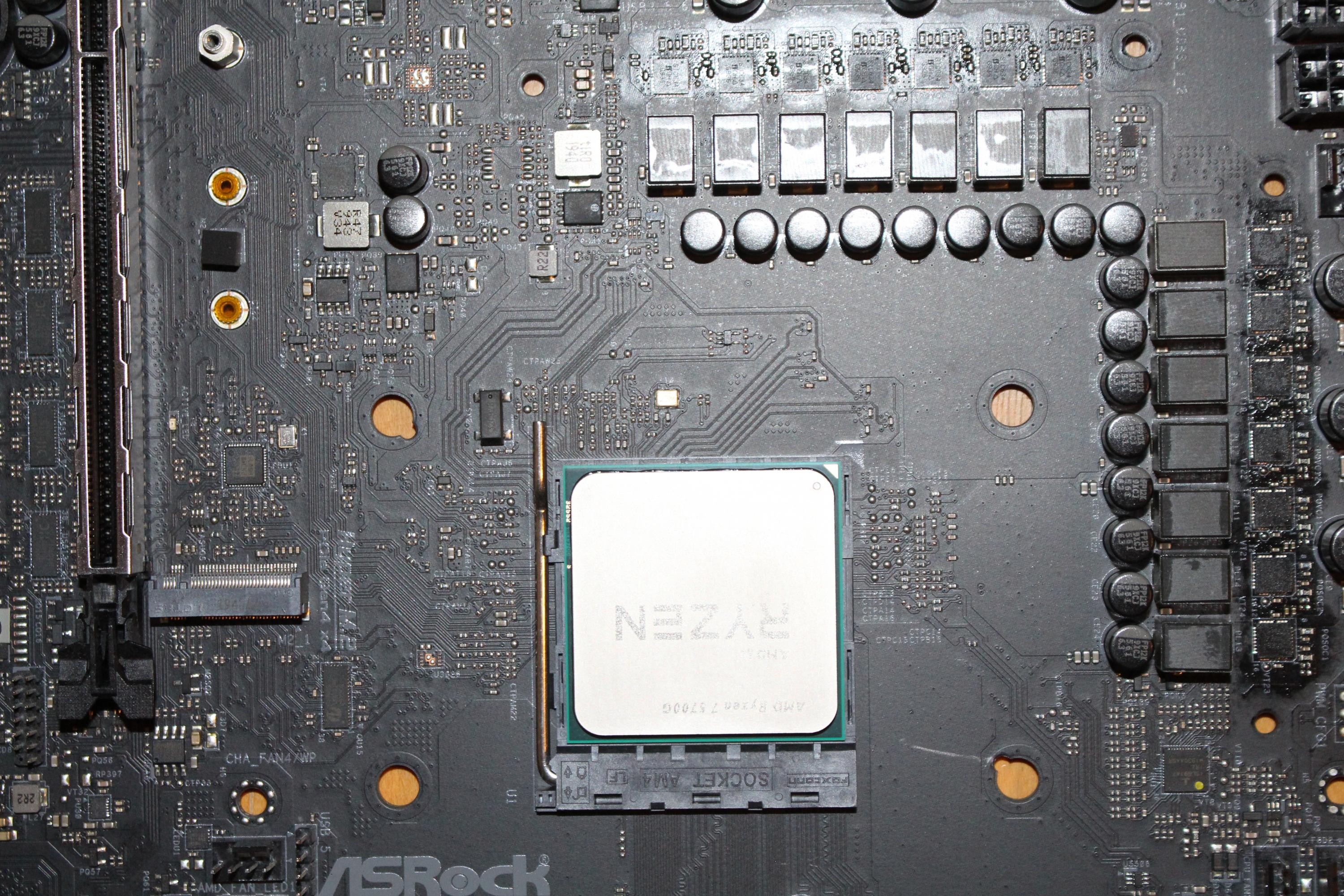

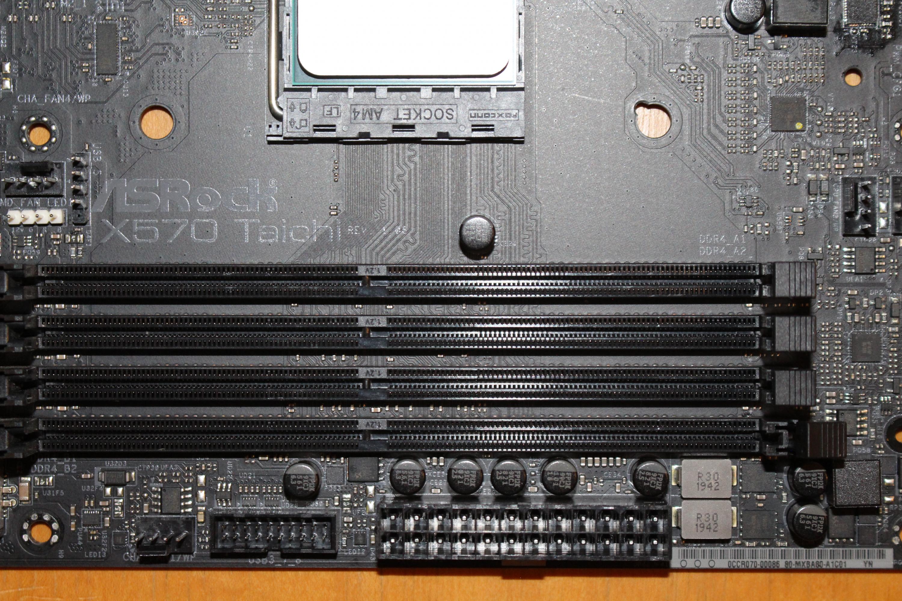

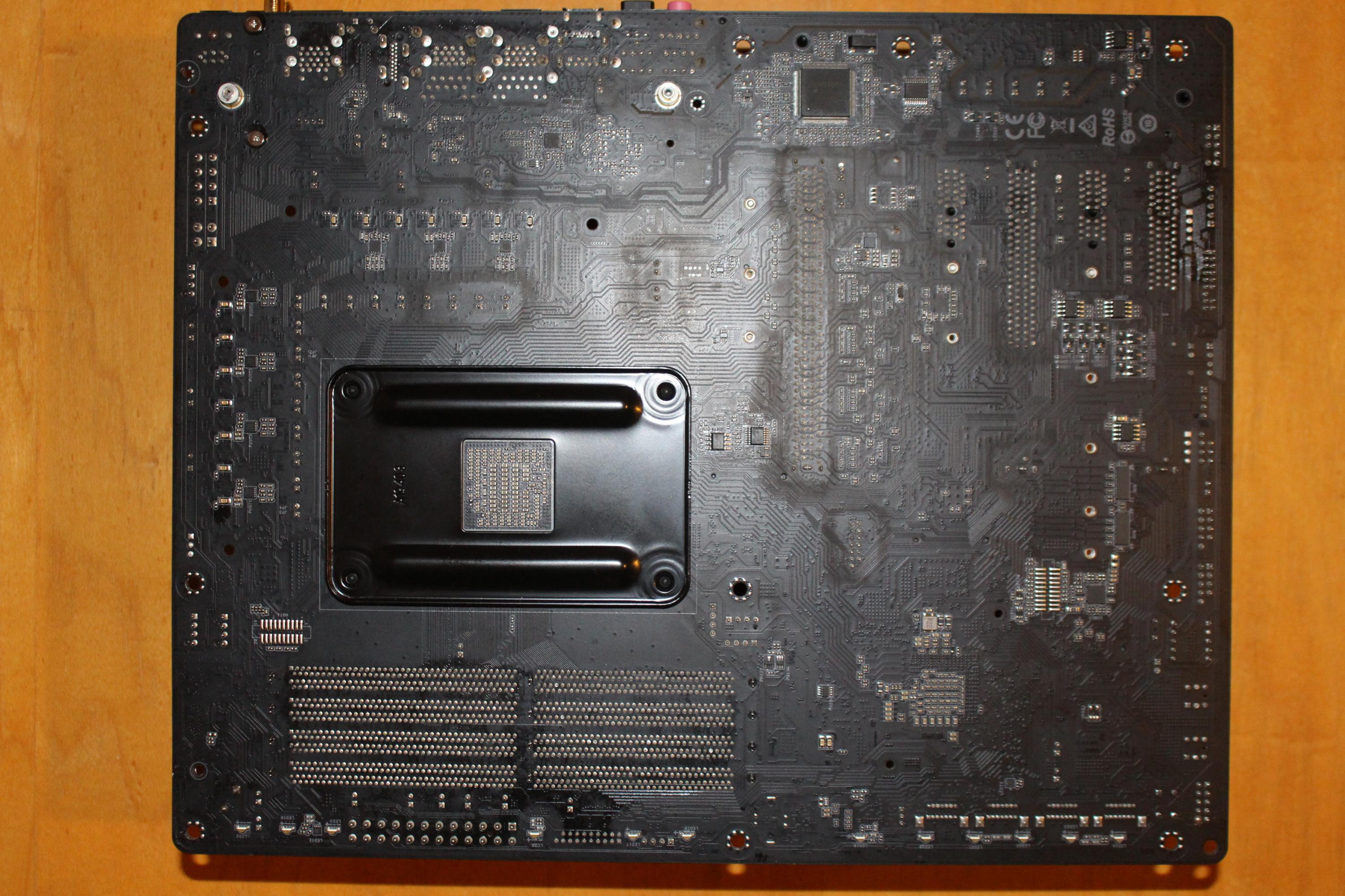

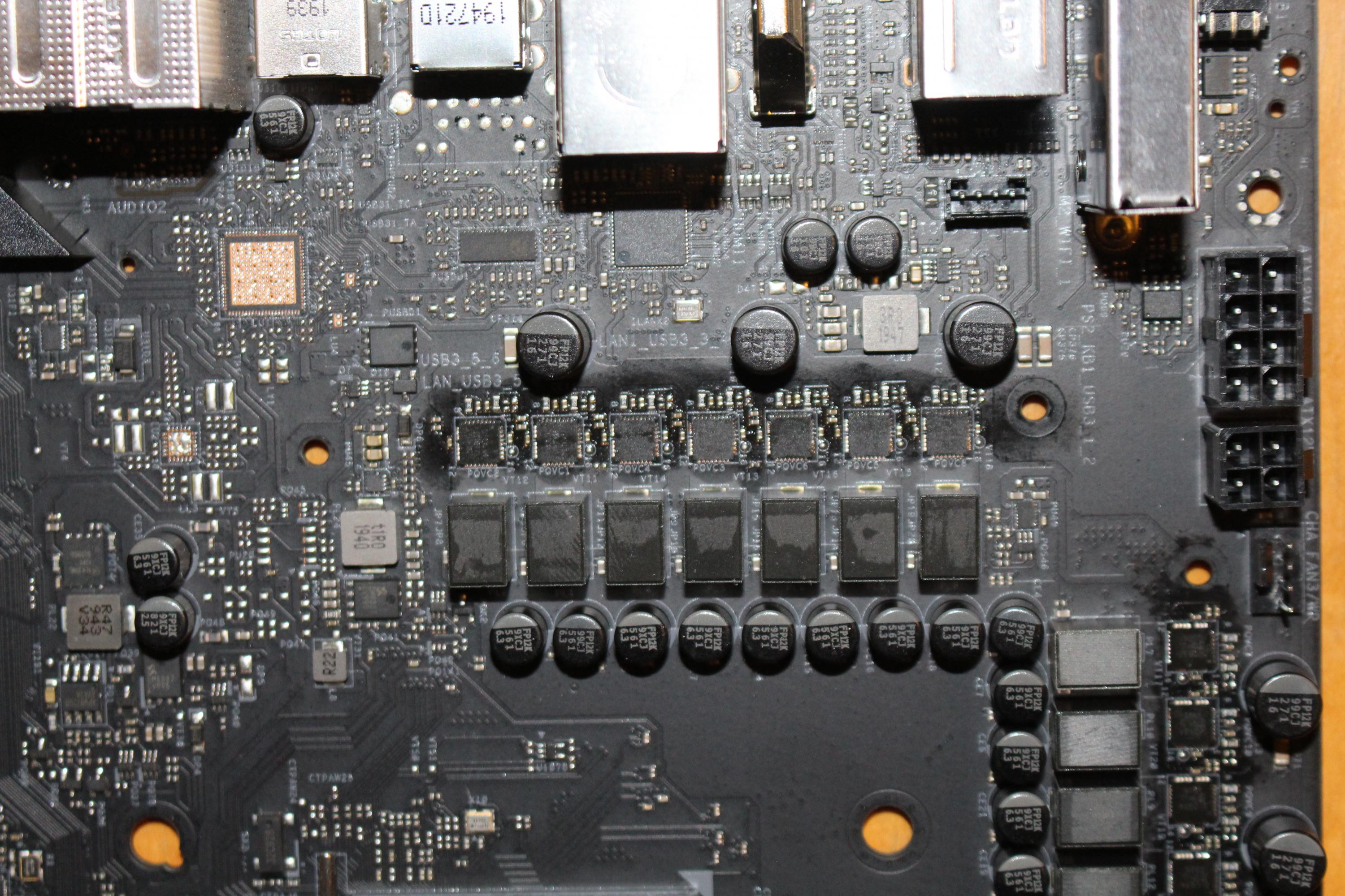

Then we move onto inspecting the board for damage. Here are some pictures. The compression made the images pretty blurry. I can upload closer shots of any specific area.

There is a cluster of 5 capacitors near the CPU power connectors (seen in image 3.) The negative leads all read 0 ohms and the positive around 12 ohms. The resistance across each of these capacitors is also around 12 ohms (touching COM to the negative lead). The resistance isn't rising like you'd expect when the capacitor is charging. Is the 0 ohm read indicative of a short on the board?
There is a line of 6 capacitors by the motherboard connector (seen in image 5.) Probing these gave similar results. All the negative leads read 0 ohms. Two of the positive leads read 3 ohms and other four read 12 ohms. This has me confused, because the motherboard can power the lights, CPU fan, and the BIOS chip. Is 0 ohms on the negative lead of a capacitor normal? Am I measuring it wrong? Or are the capacitors unrelated to the parts of the board receiving power?
Lastly, I probed the 17 capacitors surrounding the CPU (seen in image 2). Again, their negative leads all read 0 ohms. The positive leads read 2 ohms and the resistance across the capacitors also read 2 ohms. As a sanity check, I probed random capacitors around the board. And some of them had reasonable resistances on the negative lead between 10-20 ohms.
