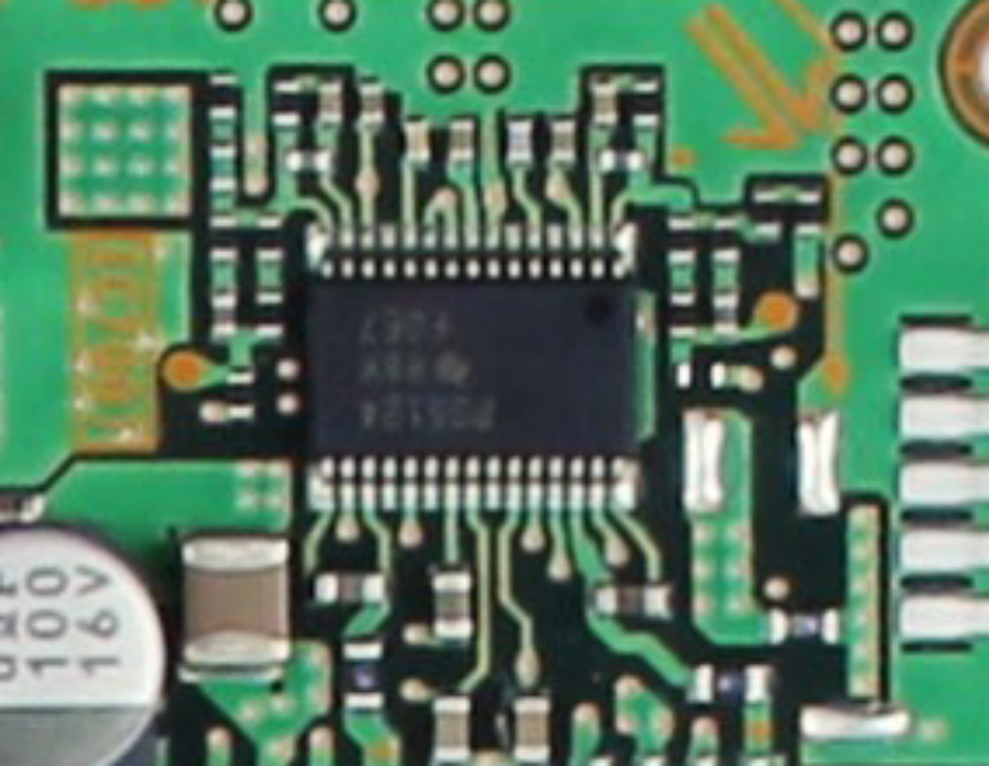

        So I finally found it - Transfer chip/Regulator (lC7001) in the BU Board.
        It took me a while, but the KDL-32s20L1 uses a secondary power supply (Protection line) in the BU Board that will draw the Stand-by 3.3vdc to ground - when it sees an output voltage irregularity (grounding switch).
        The regulator chip failed - resulting in the lack of enough voltage to hold the grounding switch open. The end result is that the 3.3dcv was running to ground Before it could make it to the Microprocessor - Triggering the DC Alert-1.
        Since I have neither the tools or ability to do this kind of micro-surgery, I'll look into a replacement board - if it's even possible (Protected/Locked) ???
        Not sure how this may help you - but I certainly hope it does.

          Could you post a pic so I can see what it looks like? I may have the same problem.

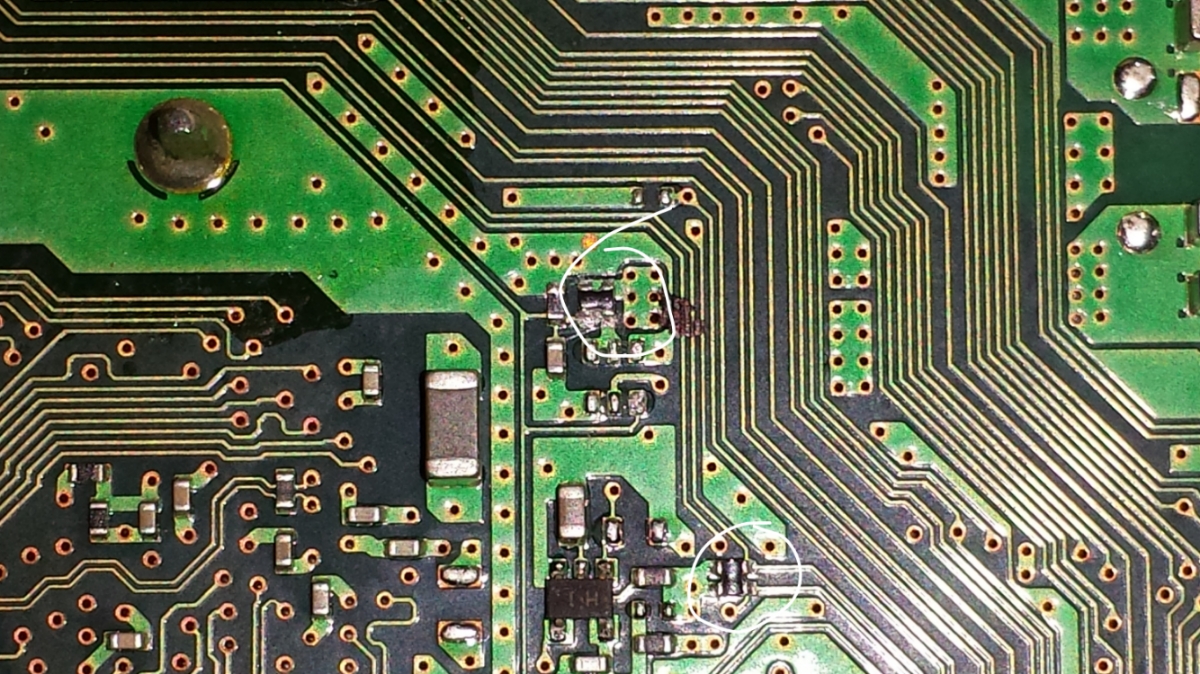

                                No doubt now that its the BU board. Its not Q7012 though. I figured out pretty much how it works. I'm getting the signal from the gate drivers on IC7006. I get 3.3v output. I have 3.3v to almost every place on the board its supposed to be. I've attached a pic. I don't know what this thing is but it might be the problem. I get 3.3v to the top of it but only about 3.0v on the bottom. A third of a volt doesn't seem like much but I guess its enough to set this thing off. Resistances top to bottom are about 9k left and 10k right. There's 2 circled in the pic. Resistances are same on both but the bottom one has 3.3v on all 4 pins. I don't know if its just 2 resistors in one package or what. After the voltage leaves the bottom left pin of the top one it makes its way to IC3001which controls the protect circuits. Voltage there was about 3v.
                                ------------signature starts here------------
                                • lookimback
                                  • Aug 2013
                                  • 1489
                                  Re: Sony Bravia KDL-40W4100 wont turn on. Error code red LED blinks 3 times.

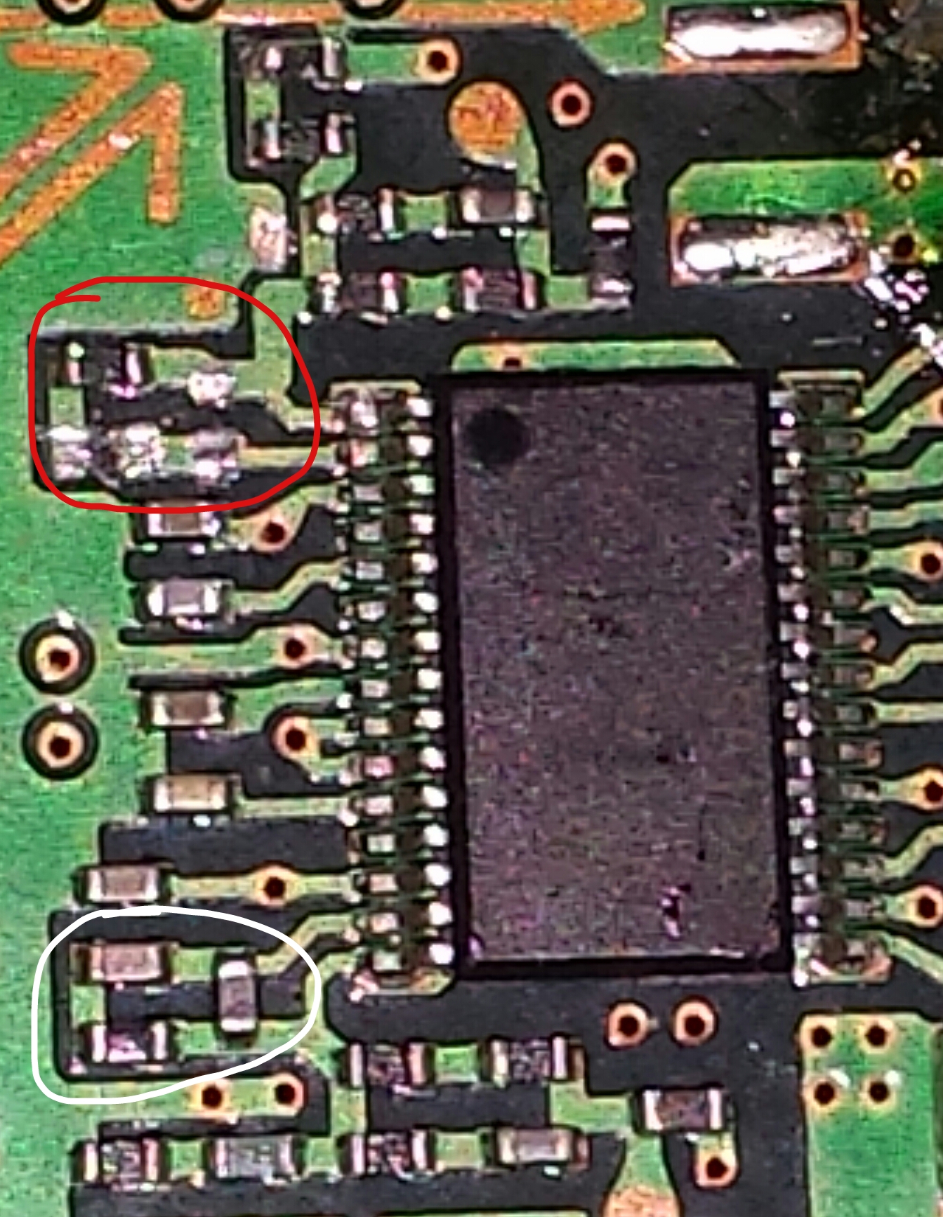

                                  OK I figured out what I think I got it. I don't know how its possible but it looks like I have 2 missing SMD caps. See the attached pics. First one is my board. Red circle is missing caps. The caps go between pin 1 (INV1) and pin 2 (FB1) on IC7007. White circle shows pin 14 (FB2) and pin 15 (INV2). As you can see, caps are present there. Can't see why they would be there and not at 1 and 2. Schematic from service manual shows them as C7051 and C7065. C7051 is 33pf 5% 50v and C7065 is 0.001uf 10% 50v. Pics 2 and 3 are cropped from Shopjimmy pics of both versions of this board. One is very clear and those caps are there. Other is not as clear but you can see one of the caps. My only question is where did they go?
                                    On post 16, does it look like that or some one had worked on that section?
                                    • lookimback
                                      • Aug 2013
                                      • 1489
                                      16 only looks like that in the pic. I think someone must have worked on this before though. Its had been opened before because screws were missing. Those 2 caps were definitely there at one time because there are depressions in the solder. That was how I noticed it. They didn't look smooth and rounded like other places on the board where there are unused pads with solder on them.
                                        IC7007 needs to have those components back in place, the IC is the dual SMPS (1V and 3.3V): https://cdn.badcaps-static.com/pdfs/...435ea58698.pdf
                                        Is the fuse F7006?
