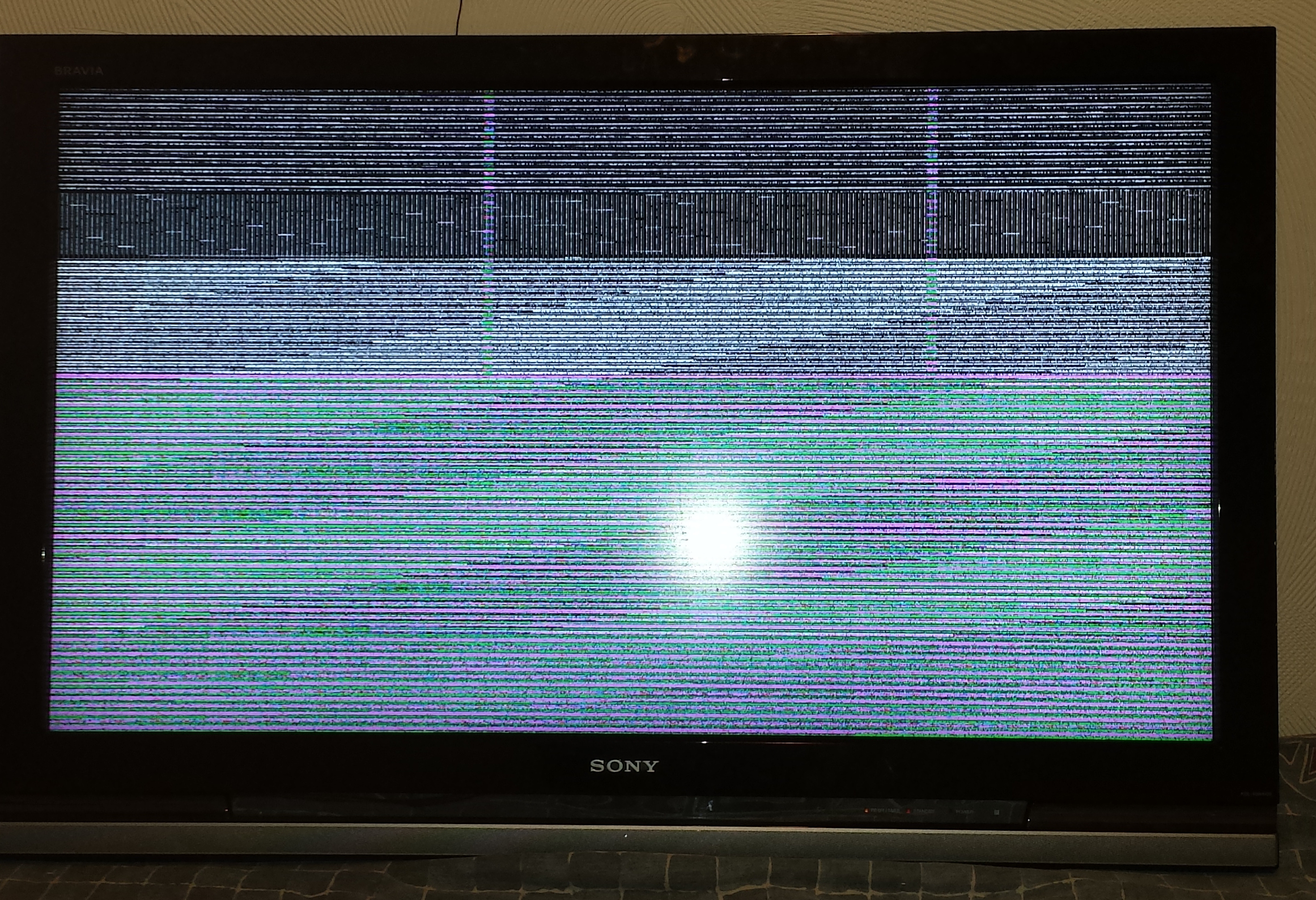

              Never going to believe this. The backlight problem is solved. There was a wire harness coming from the balancer which goes to CN6701on the power board. Someone worked on this before I got it. The harness was wedged up under the power board. So, now the backlights come on. New problem. The attached pic is what it does when first plugged in. If I turn it off then back on it is just a black screen. Once it went to a grey screen. Backlights are on though. Also, the pic/timer light and the standby light are both on.
