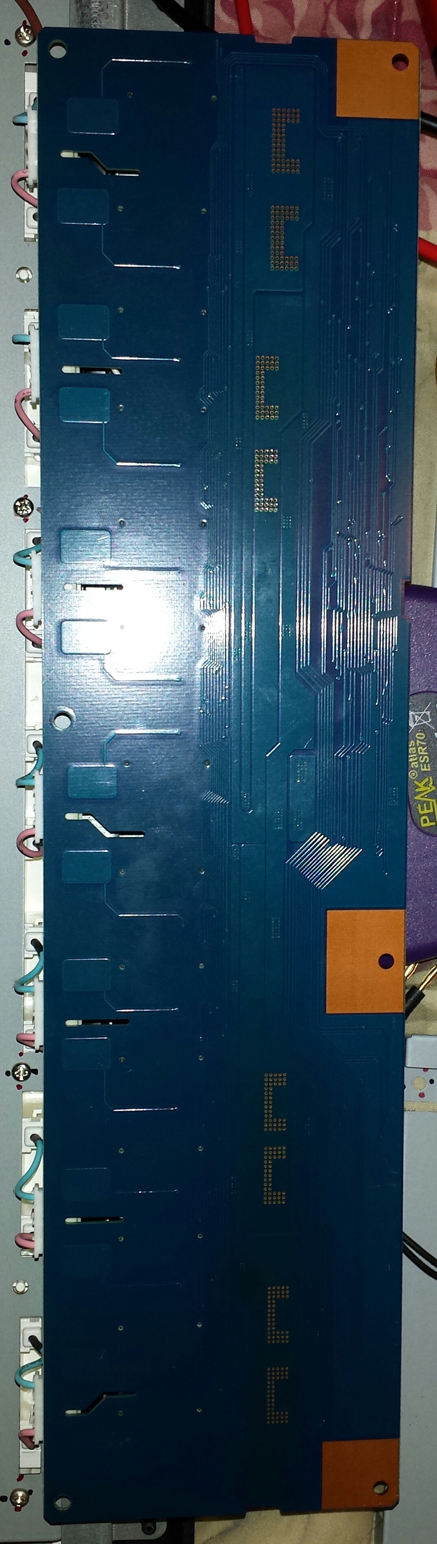

    Picked this up today and couldn't wait to open it up. It gets sound but no picture. Backlights aren't coming on at all. I have 24v to all 24v terminals on inverter board. About 4.5v to inverter on pin. About 3.5v to pdim. So inverter is getting power and turn on signal. As per post 51 of this thread I tested all transformers between pins 4 and 5. Readings are as follows:
    1) 1018 ohms
    2) 1004
    3) 1006
    4) 1010
    5) 1011
    6) 1005
    7) 1018
    8) 1008
    9) 1005
    10) 1003
    11) 994
    12) 1021
    13) 1011
    14) 999
    I also removed all 4 electrolytic caps and tested them. ESR was between 0.04 and 0.06 on all. Only reading that seemed off was the capacitance. They are all 35v 270uf but all had readings of around 290-293uf. Again, they were tested out of the board. I've never encountered caps with capacitance over the specified value so I don't know what to make of it. Any help will be appreciated. Thanks. I'm taking a pic of it now.

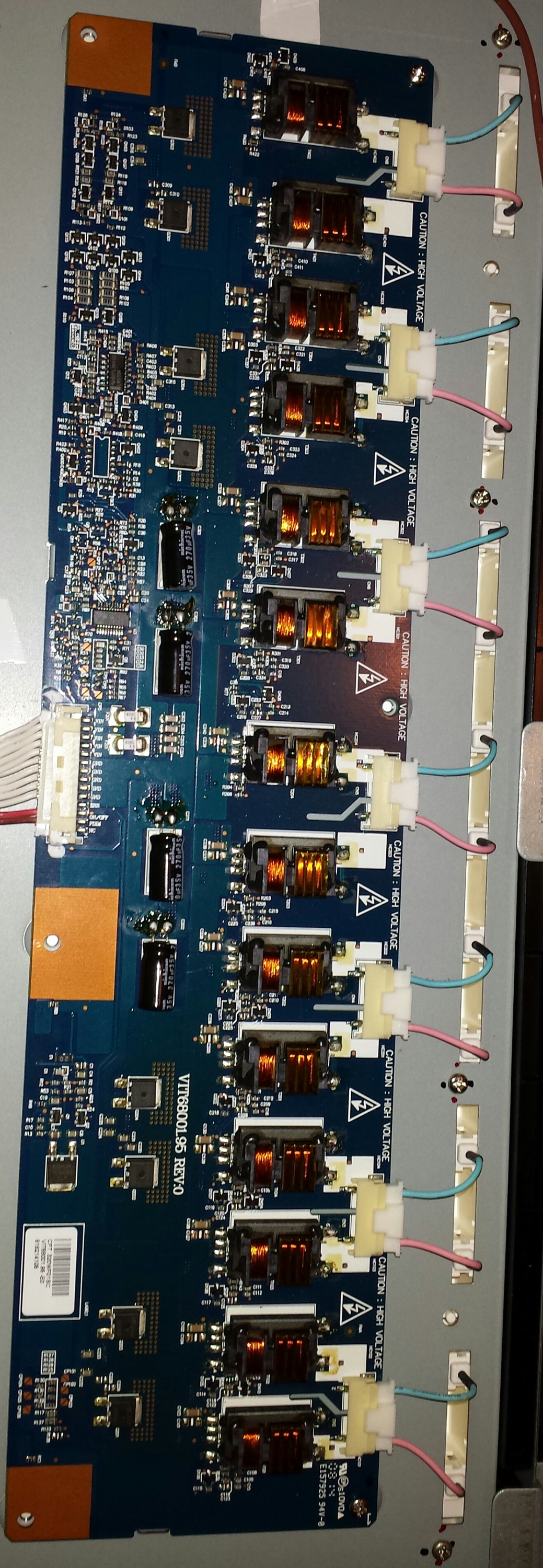

    Here's the pics.

      Check that small black fuse F3? with "20' on top, It is very commonly failed fuse, poor quality fuse. 1A fuse 76V you can use PICOII fuse with higher voltage rating.

        Re: Dynex DX-LCD32-09 no backlight
        I had tested F201 and F301. I didn't even see that fuse. That's it too. Thanks! I think if you ever come to Buffalo, I probably owe you a lunch or 2. My Mouser order came today too. Got one busy night planned. Parts for 2 TVs and 2 furnace boards.
          If that little fuse is open, you can just jump it for now or use .47~1 Ohm 1/4W resistor in its place to try out. More likely that is all it needs.
                          Yup, lights came on. I jumped it with a single strand from some stranded wire. Only let it stay on for about 1 second then unplugged it. Didn't want to burn anything up. The fuse you suggested will be in my next order from digikey.
                            Well, I finally found time to fix the inverter board. I soldered in the replacement fuse and it worked like a charm. Getting ready to move into new apartment on the 1st so not much time for the hobby. Can't wait until I get there and can turn the spare bedroom into my shop. That's when the real fun will start.
