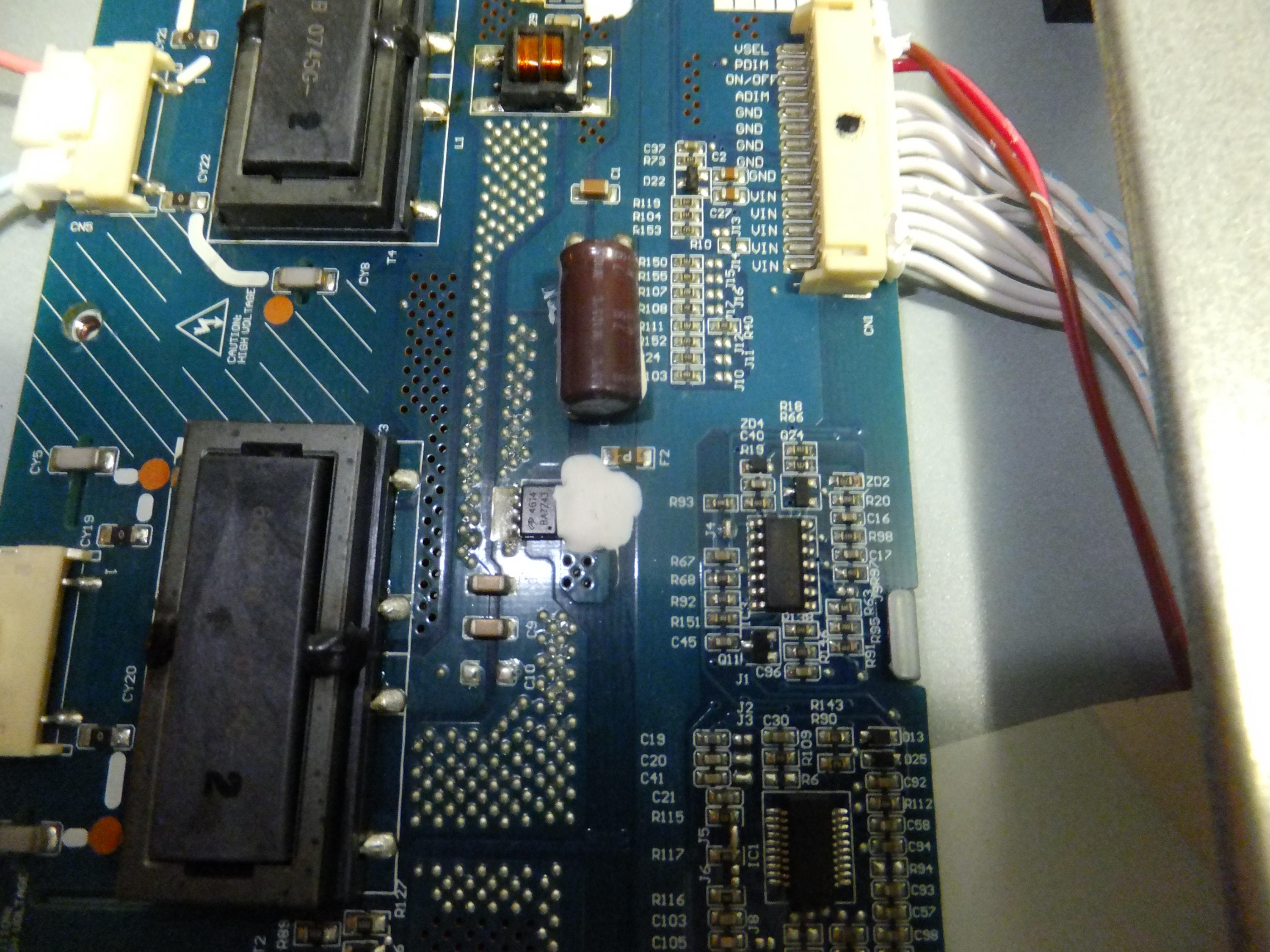

Dynex DX-LCD32-09 no backlight

    @shane, please up load the pictures of your inverter board.
      Re: Dynex DX-LCD32-09 no backlight
      OK, I will get them uploaded within 24 hours.

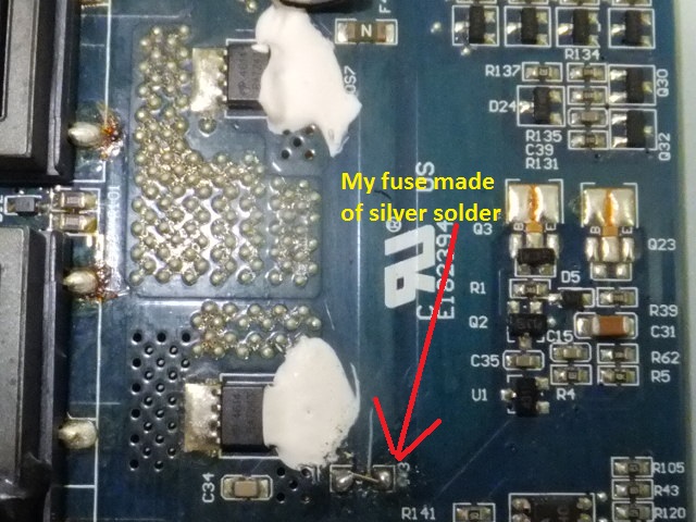

      I have been playing this TV for over 3 hours now and no problems. I just might leave the solder as the fuse.

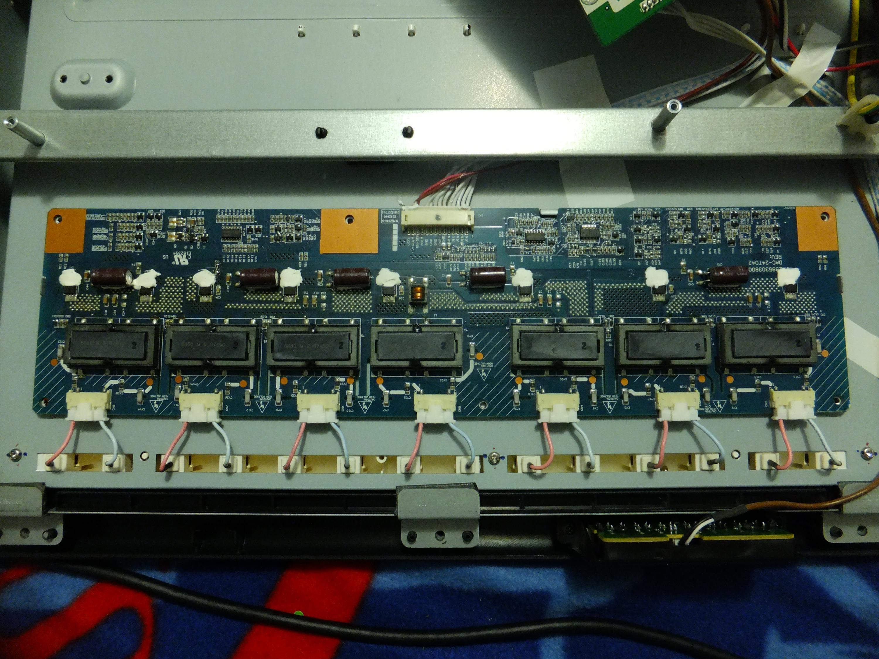

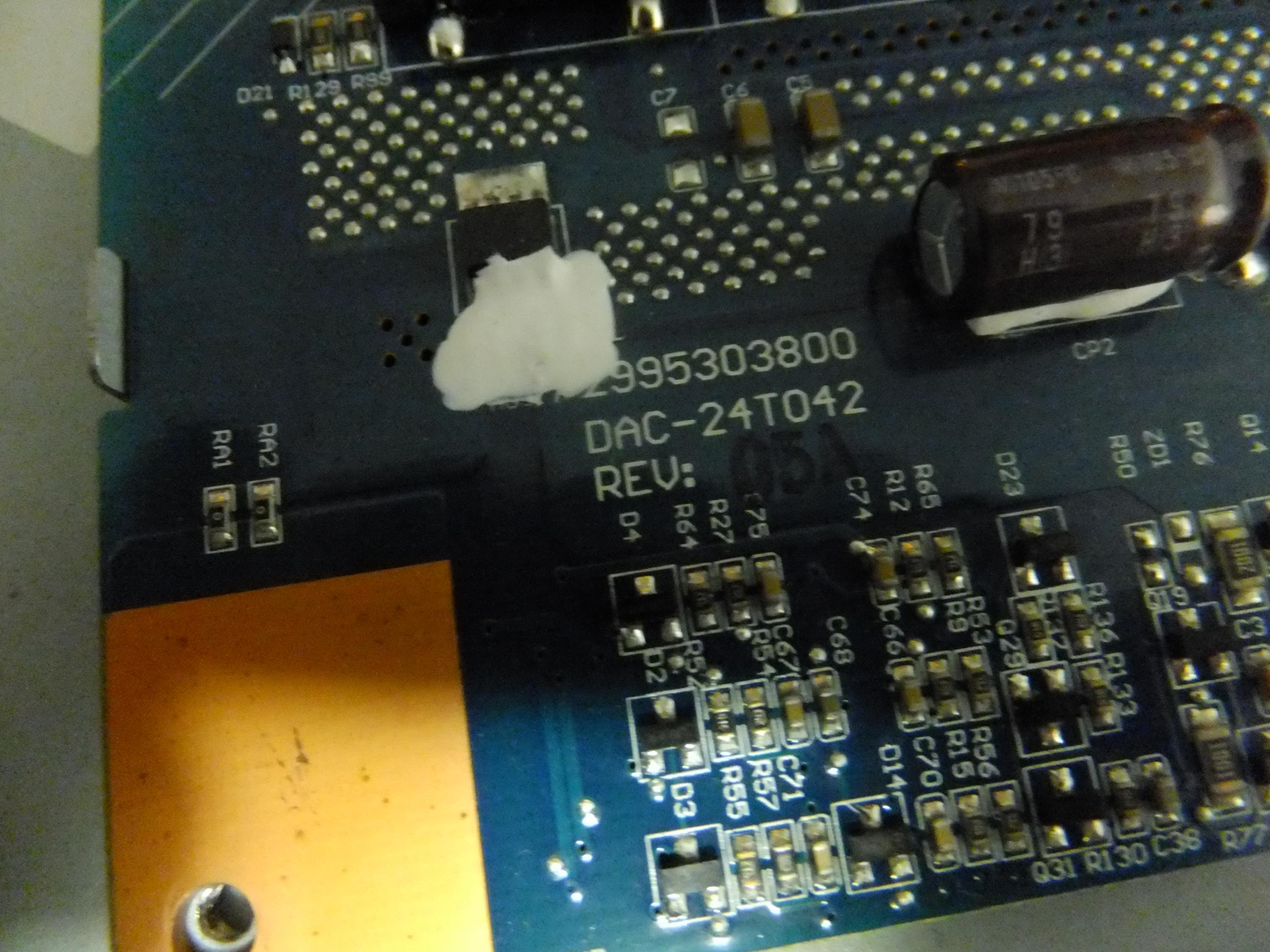

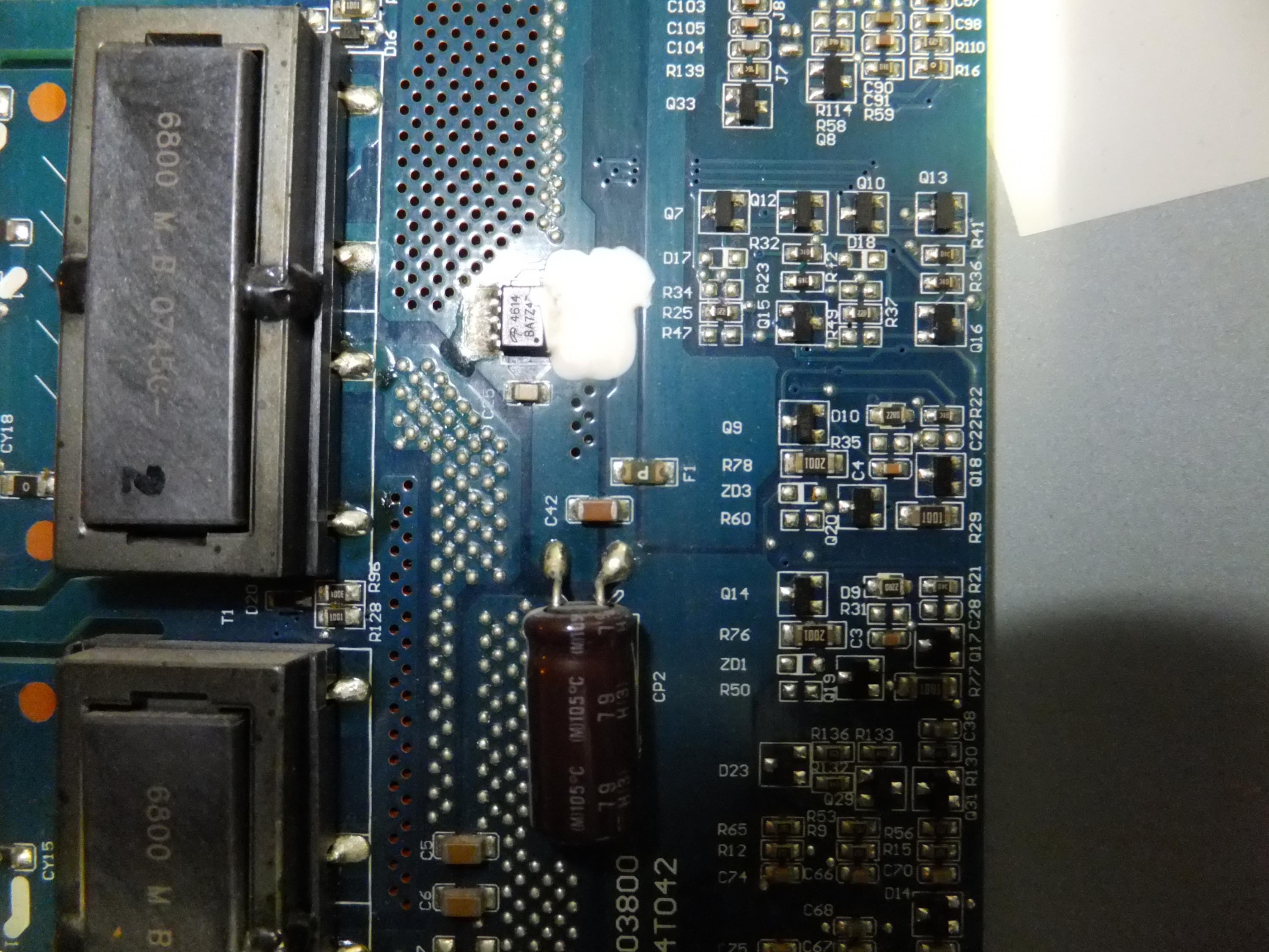

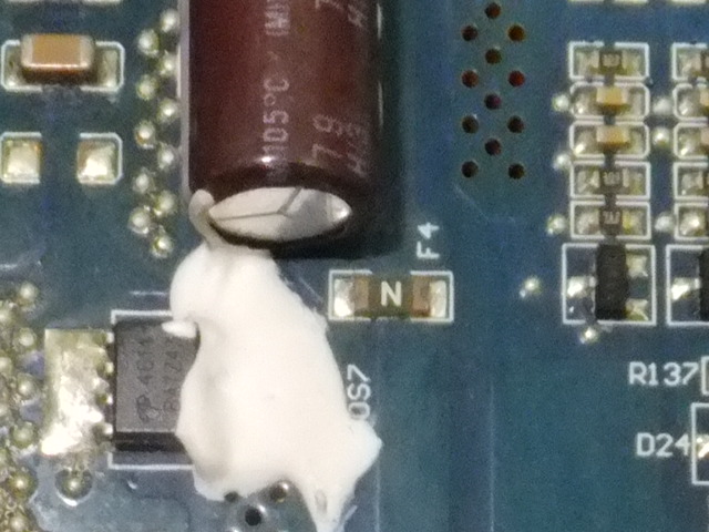

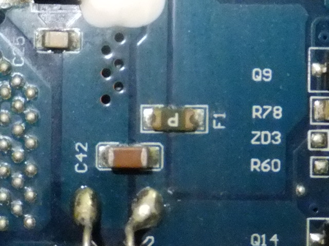

        So here are 7 pictures that should tell you everything I was talking about
          Since the letter as printed on top on the fuse is not standardized (not all fuse companies use the same codes), you can put your DMM in DC A mode to check the current draw when the backlights are set to the maximum, then double (you can try 50% higher too) the reading to get the fuse size you need.
