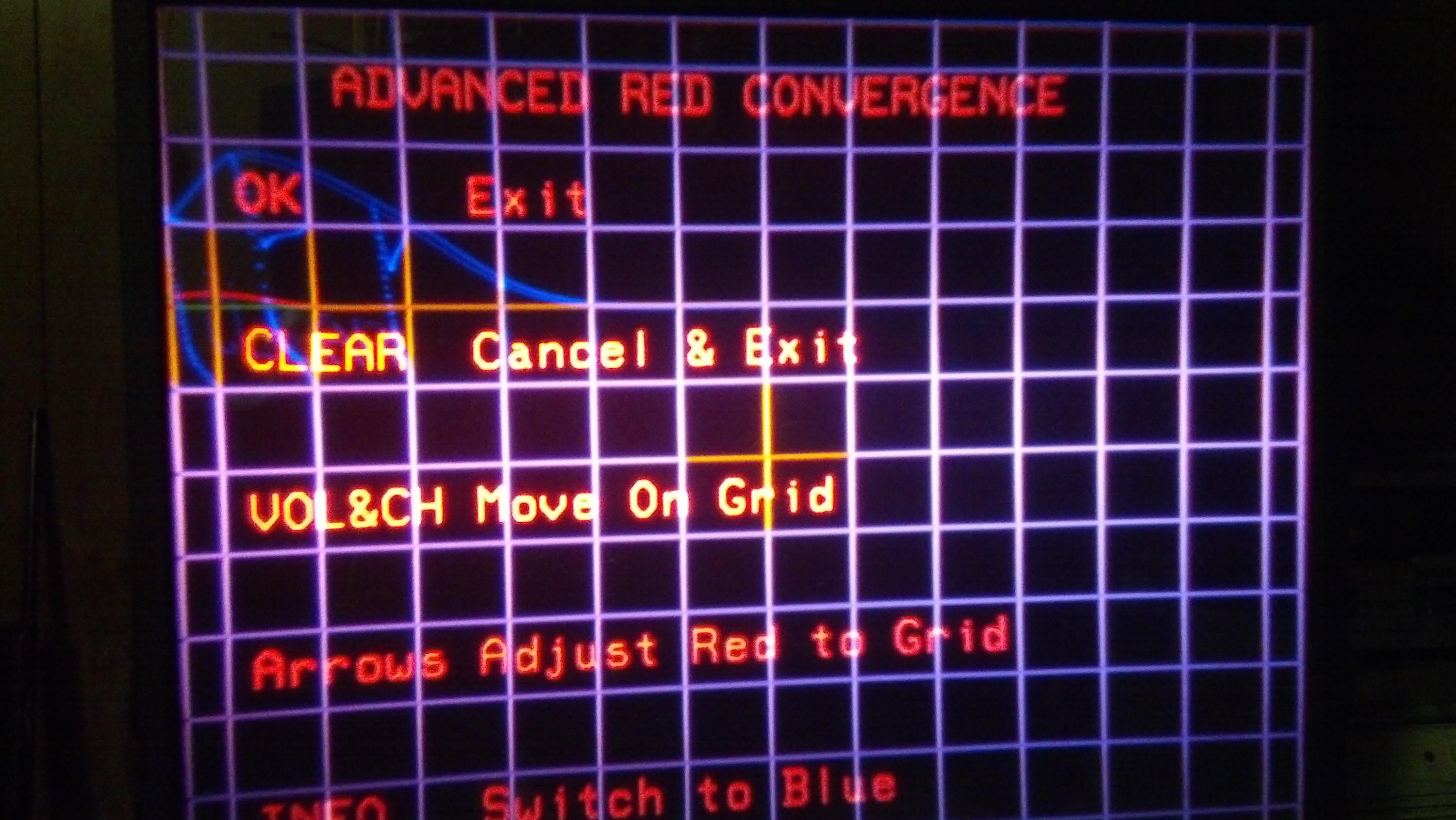

    I have a strange convergence issue with my old 2002 RCA big screen, Does anybody out there who tinkers with the older CRT big screens have any info on the convergence power supply board (number POWR-530), or the Digital Convergence Main Board (either DIGI-970 or DIGI-980) for a 2002 RCA p52937 with chassis PTK195M4B?
    I know about the convergence power supply board usually going first, but the thing is, I have the advance convergence menu still, and its only the left side of the picture thats bowed/off slightly. Its adjustable to perfection on the entire screen, even where its bowed except for a 5x12 spot on the screen where blue and red lines make a crazy swirling net shape that doesnt move. In the included pics, its all that stuff over the patriots logo, and the words below are supposed to be white. You can really see the bad spot when in the advance menu, as i have included pics of the screen in both red and blue adjustment modes.
    I am wondering if since my convergence power board still shows voltage on all 5 output wires that are supposed to have, if its just the convergence main board thats shot, and not the power supply. I can unplug the input power from the PSB and it makes the screen look completely HORRIBLE, and the advance convergence menu is no longer available like this. Also the wild spot on the screen is not there with the psb unplugged (it looks horrible but you can tell the odd bad spot isnt there anymore.
    I have only seen one other pic on an online thread of a ptk195 chassis tv screen with my issue, and interestingly enough, its in almost the same spot on the screen as well. Everybody giving info on what to test was up in arms as to whether it was the PSB or the mainboard, and it ended with everybody agreeing on replacing both boards to be safe. I can get both now from ebay, but I dont want to shell out (and take out of circulation) a part that I dont really need.
    As mentioned, the output voltages on the psb are about 2-3 volts higher on the first two pins that have to be read with the meter probes reversed (its a negative vdc reading), and the other 3 pins past the chassis ground pin read about 2 volts lower than whats specified, but I have been told that its close enough to be in spec still. I am no expert in that regard, and am not sure if the voltages should be dead-on, or within a given amount. All I know is the peoples experiences that I have followed who needed just the psb have always had a very low or no voltage situation on one or more of the output pins that are supposed to be hot. They also lost the customer advance convergence menu (or if it remained, they couldn't get any of the colors to remotely converge, it was totally off). I still have all of the previous, with no other symptoms or misbehavior from the tv itself as a whole.
    Thanks in advance for any insight or info at all,
    Bob.
    MORE INFO: I just swapped the connectors for the yokes on the convergence board. Even though it distorts the screen from where the guns are on different rack positions, when swapping the red with the blue yoke you can tell the red lines take on the odd warped distortion pattern of what the blue was doing previous to the swap in the spot thats screwed up. Hopefully its just the convergence board, and not the convergence psb or the flyback.

    Seems like you have a convergence IC that's just starting to go. Or you have a resistor that's failed.
    Those IC's, usually labeled STK-something or other control convergence across the screen, which is divided into sections. Looks like one of those sections has either failed or is not getting power.
    Step 1 would be to remove the board that the convergence IC's are on.
    Step 2 is examine and test all the resistors that feed the convergence IC's.
    Step 3 may involve replacing both IC's, the resistors that feed them, and any pico fuses, if there are any.

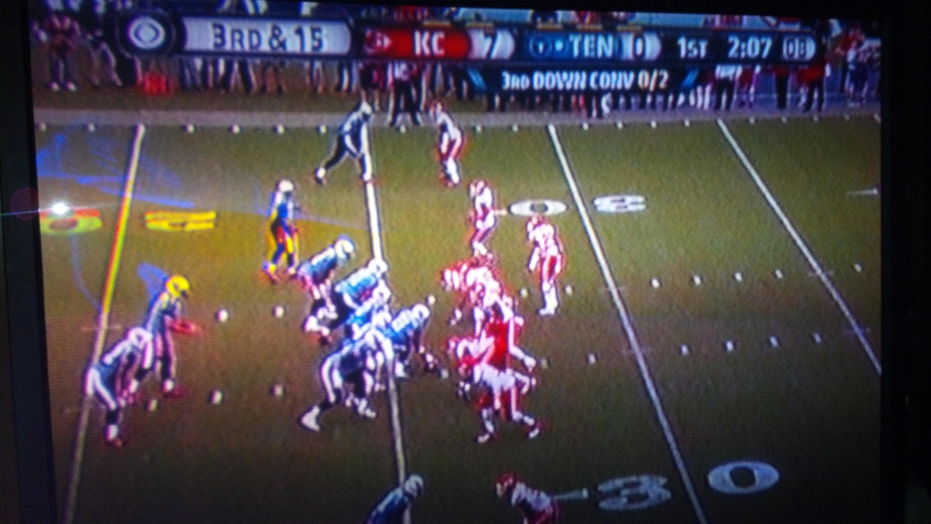

          Well i lost, I got the power supply, and it made no difference, BUT I did manage to fix the pincushion problem (along with bad news about my convergence boards and the one i got off ebay...) It turns out the pincushion problem I had was a bad MUR460 diode and a solder break down from the diode in the pin amp circuit on the main deflection board. I put a new diode in, fixed the solder break and now the screen is square, but I realize now that I have had other issues I didnt know about previously.
          I have 3 separate convergence boards now counting the ebay board, all exactly the same and failed the same except for one difference. I have swirls of blue and red with all 3 boards like what is shown in the first pics from my OP, except the spot(s) are in different areas of the screen with each board.
          As I was adjusting one of the sets' convergence, suddenly another spot of convergence let go and left another wild tangle of lines on the screen. I heard absolutely no noise when this happened, so I assume the vertical transistors stopped switching in all 3 of the vertical color circuits at once, or at least partially.
          Does anybody know if the 3 vertical circuits share a common transistor or something of that nature? I find it odd that all 3 colors came out of convergence all at once and in almost the same pattern that last time. If not, Ill have to see if one of the television board r&r companies can rebuild one of my boards to new condition. It may not be worth it to some people, but I would rather spend $300 to rebuild my current tv vs buying an new one.

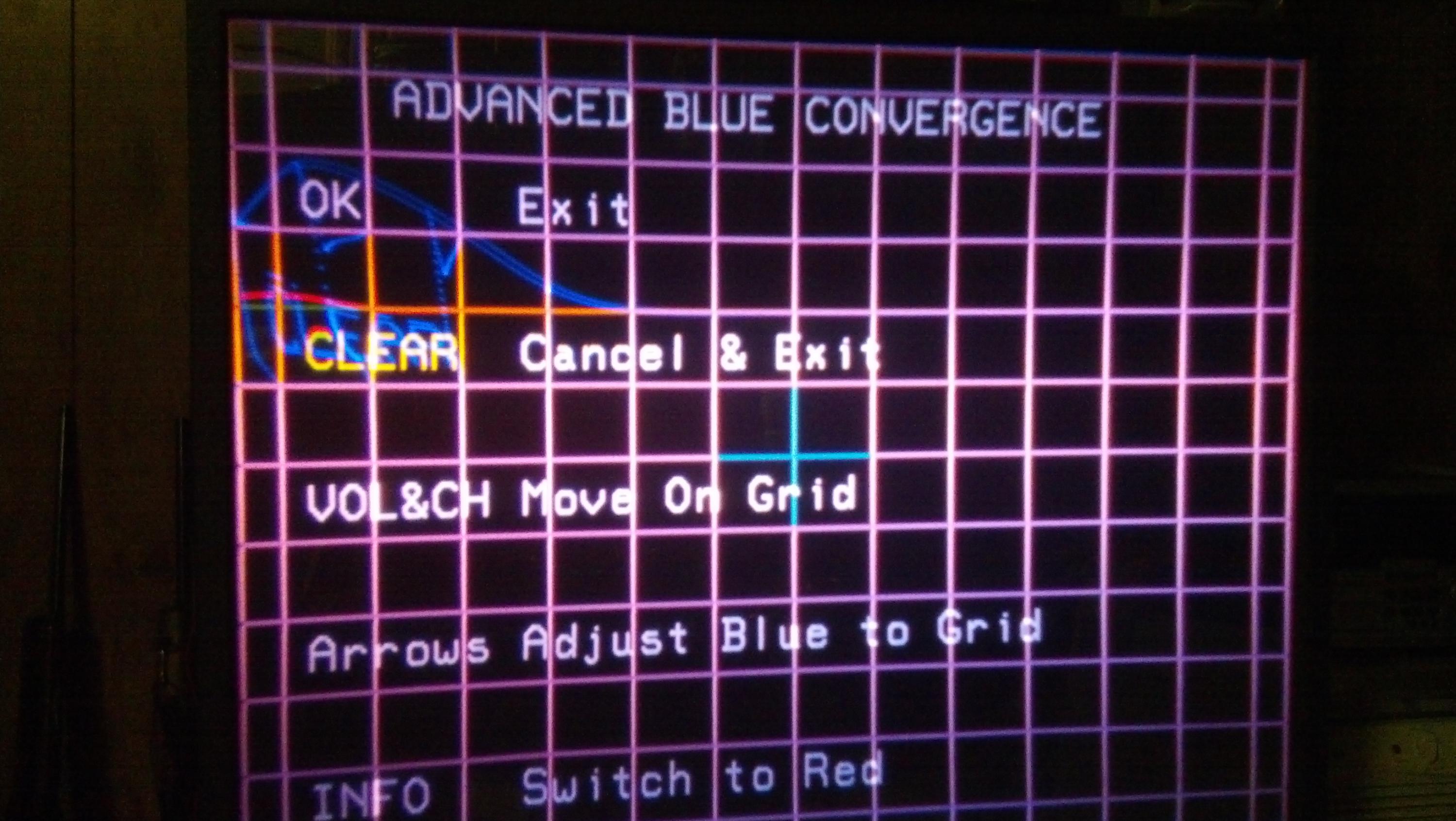

            Well I feel like an idiot now. I have figured out what causes those spots I had showing on my displays...
            For some reason, the convergence memory chip on each board fragged out for a split second, and lost the setting for those particular spots as I was adjusting the convergence, resulting in a birds nest of blue and red lines on the screen concentrated in one spot. I was able to adjust and "straighten" the wavy lines back out with the customer convergence menu.
            It took around an hour and a half each set, due to the entire blue and red grids having to be pulled back straight. There was some tough spots that I didnt realize where the lines were actually pulled up, overlapped and folded in the opposite direction.
            The only catch is, if the green has moved or went wild, theres no way to fine-tune/adjust it back, so I am SOL in one small spot on the 52" chassis. The blue and red distortion is gone though. It will do for now, the 61" is my choice of boxes to use anyways, so the board with the green distorted spot will stay in the 52". I tried the ebay board again just to check, and it still acts like its not compatible , or was malfunctional upon arrival (it never worked right imo). I am not gonna hold anything at all against the seller, as I needed a good core to send off to moduslink for rebuilding anyways. I know the nature of these old board things, and the power supply I got from him is working great so at least I feel like I broke even, with both tvs functional now (for the most part lol).
