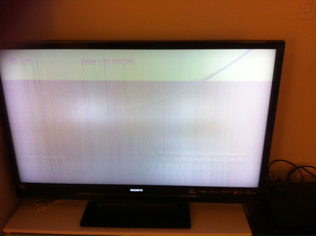

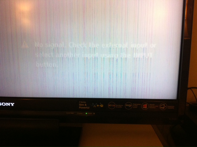

    Sony KDL-46Zxxxx "white" screen
    I have found this TV, with this white screen and I'm wondering, if it could be only a bad T-con board the problem, or it can be a bad panel also?
    Re: Sony KDL-46Zxxxx "white" screen
    Could be GAMMA IC but to my knowledge no 46" Sony has ever had an AUO or CHIMEI panel which have gamma IC problems. So it may be panel or t-con. Wouldn't pay much for it, too much risk.
