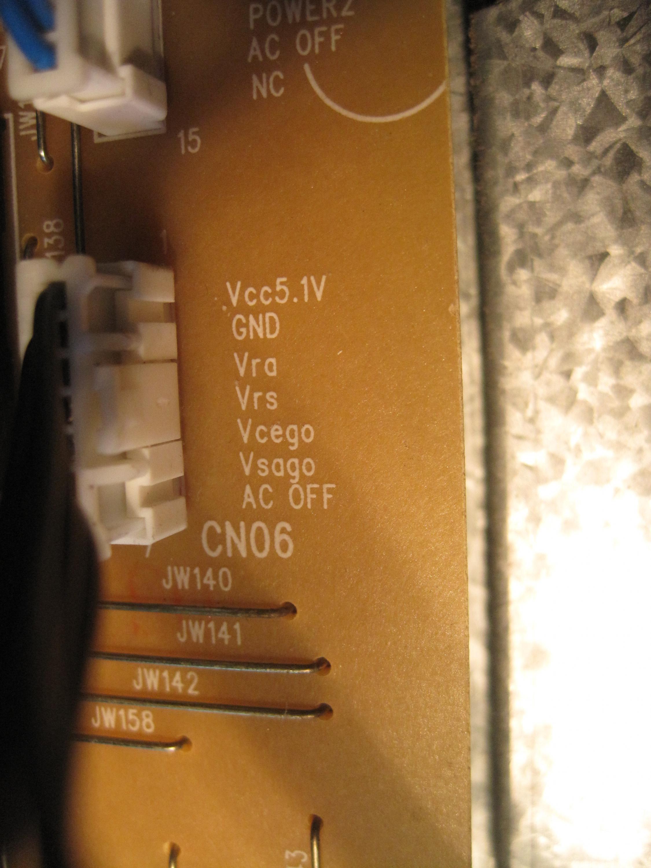

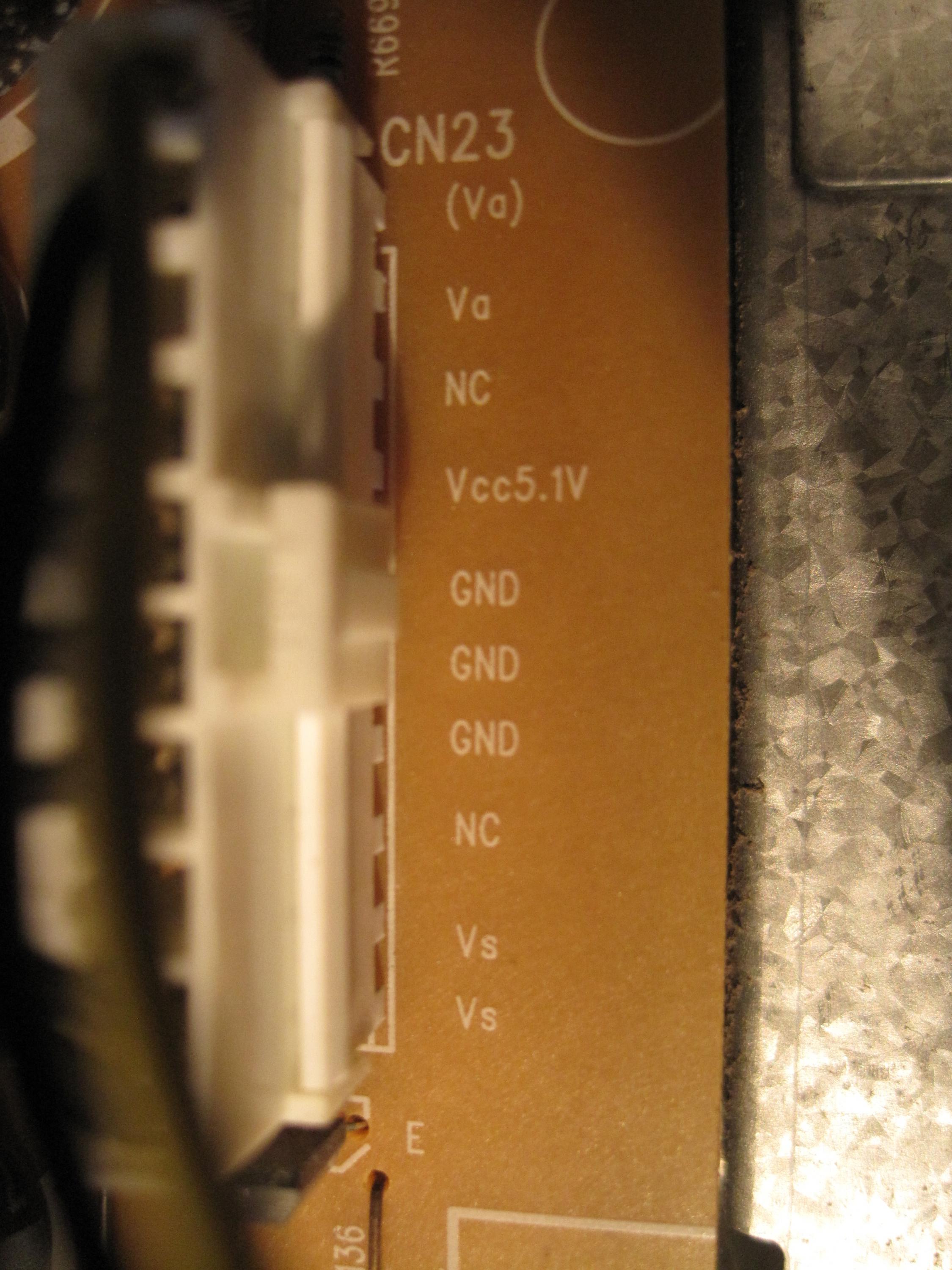

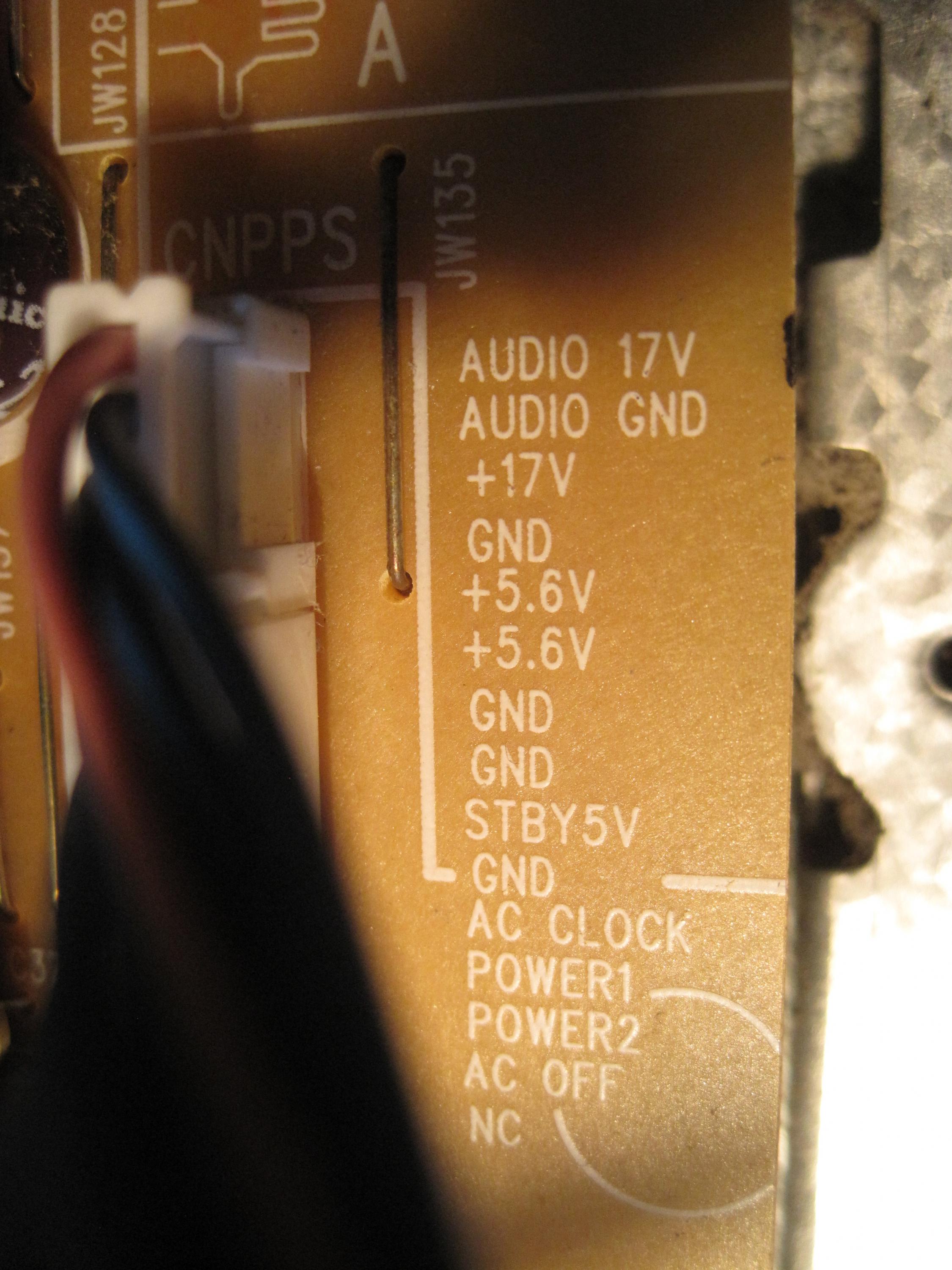

      Re: Hitachi P50S602 Plasma Power Supply Testing?
      No, other than the power in, the connectors are CN23, CNPPS & CN06, as follows:
      (from top to bottom)
      CN23 - Va, Va, NC, Vcc5.1V, GND, GND, GND, NC, Vs, Vs
      CNPPS - AUDIO 17V, AUDIO GND, +17V, GND, +5.6V, +5.6V, GND, GND, STBY5V, GND, AC CLOCK, POWER1, POWER2, AC OFF, NC
      CN06 - Vcc1.5C, GND, Vra, Vrs, Vcego, Vsago, AC OFF
        OK, I think the signals are POWER1, POWER2, Vsago, Vcego.
        You want to have the power supply connected and power the set up, check the various voltages on these pins, and see how they change when the power button is pressed. If they drop out, then the power board is probably OK and the main board is shutting down.
          When I press the power button, the connections go from 0V to as follows:
          POWER1 - 4.3V even after fans stop (shuts itself off) MAIN
          POWER2 - 3.2V even after fans stop (shuts itself off) MAIN
          Vcego - 3.0V until fans stop then 0V LOGIC
          Vsago - 3.0V until fans start then 0V LOGIC
          I could not read the connections from the PSU Board so I read them from the MAIN & LOGIC Boards.
            OK, this indicates the logic is shutting off the power, which is likely because it detects a fault on either YSUS or XSUS board.
