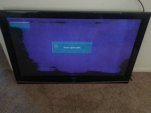

    Samsung hp-t5054
    Is this tv repairable or a bad screen?
  • capkid
    • Oct 2010
    • 1339
    Re: Samsung hp-t5054
    I'm thinking possibly a faulty X-main. I'd do a voltage check to confirm they're in line with the panel label spec.
