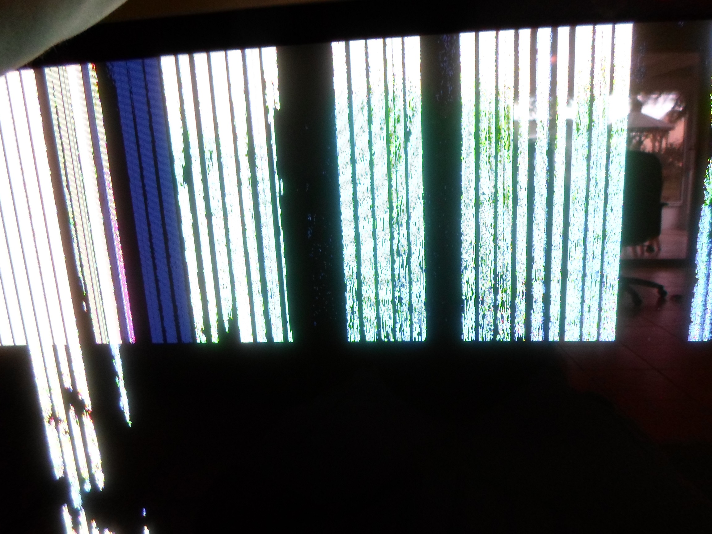

    I just picked up this old plasma with Chassis FTP2.2U AA, which is Samsung based. It turns on but all I see is colored lines where any display would be. If I adjust the volume I can see where the OSD would be but it is completely distorted. I was not able to get volume because I cannot see what input Im on, but it seems like everything else is OK.

        Can you show a picture of the problem? Poor Vscan could cause that.

          Re: Philips 42PF9966/37 Plasma No Pic
          This is when I hit Menu button, otherwise it's just some lines in the top left of screen.

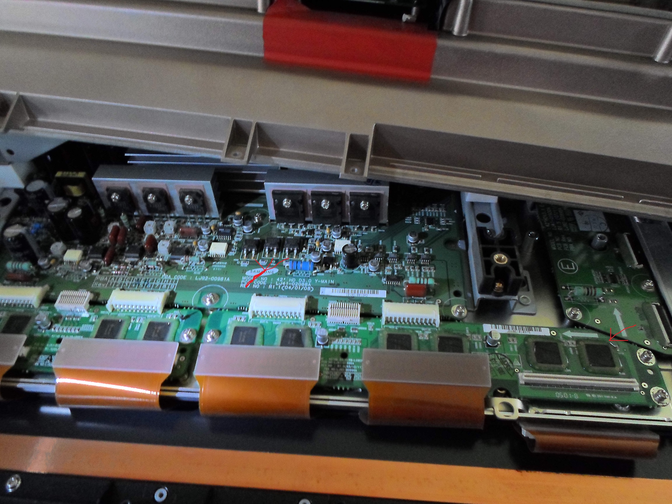

            Poor VScan is caused by what? Ill do that test pattern soon I have to dig down into it to get to the logic board.
              Poor Vscan can be cased by bad Y-buffer or fault on Y-sus or sub power/main power board (if that generates -Vsc). Check with buffers removed. Does the Y-sus power connect include -Vscan/-Vsc pin? If so, then the sub power/main power may cause the fault, try w/o Y-sus connected.
                    I disconnected Y-Main and -Vscan went normal (-55V). So I delved further into the TV and the bottom chip on the lower buffer had a slight bubble. It showed short as did the 3 mosfets on the Y-Main. Everything else seems OK.
                    Is it likely I can get away with replacing the lower buffer and those 3 (or whichever one is shorted) ICs?
